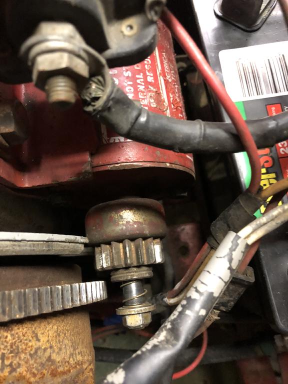

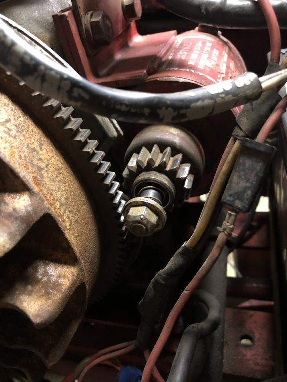

LengerichKA88 1,885 #1 Posted November 28, 2018 So, now that I’m a RS supporter (Santa Comes early round here 😂) I can post my videos and pictures to show you guys what’s going on, and hopefully get it corrected. It spins, but it doesn’t travel horizontally left to right like it’s supposed to. Buddy of mine told me to take the tin off and see it it was gunked up, but it doesn’t appear to look all too bad. Video and pictures attached, any guidance on how to tackle this would be greatly appreciated. E656C381-49F0-48A5-8D35-41CDFF393622.MOV Share this post Link to post Share on other sites
ebinmaine 77,840 #2 Posted November 28, 2018 Okay so A-1.... Safety. Disconnect your negative battery cable. Now get in there and pop that starter off of the tractor and get it on the bench. You see the nut on the end of the shaft near the small gear. Take that nut off and there's going to be a few things that come off in your hands. There's a small spring and a clip or a washer or something. Don't lose those things. That gear rides out on a shaft that has semicircular grooves cut into it. The odds are very very high that all that is wrong is the assembly is dirty and sticky. Take those pieces out and check for broken parts and then just clean them all up really really good. Get some dry powder graphite lube and coat the pieces as you put them back together. Do not use a liquid or paste of any form as your lubricant. It will attract and hold dust and create paste which is what your problem likely already is. 1 4 Share this post Link to post Share on other sites
roadapples 6,987 #3 Posted November 28, 2018 While you have it off blow it out good with compressed air... 1 3 Share this post Link to post Share on other sites
LengerichKA88 1,885 #4 Posted November 28, 2018 @ebinmaine, I disconnected the battery completely, just to be doubly safe. I almost tagged you in on it, but I figured you’d find your way here sooner or later haha. I’m going to go out and try and get it off here in a few, I just didn’t want to progress farther than needed, or too far without knowing what I’m doing and then getting lost. @roadapples I gotta dig out my attachment, but I will blow everything off to help get any last bits of hunk outta there. Thanks fellas. Share this post Link to post Share on other sites

LengerichKA88 1,885 #7 Posted November 28, 2018 Perfect! Thanks @ebinmaine! Now to get it out to the bench and broken down. Updates (probably in the form of questions😂) to follow. Tell your boss I said you could have the rest of the day off, any problems give me a call 3 Share this post Link to post Share on other sites
LengerichKA88 1,885 #8 Posted November 28, 2018 @ebinmaine, @roadapples You are gentlman and scholars 0F0F77D3-260C-4474-A578-A630C21B4E6C.MOV 2 1 Share this post Link to post Share on other sites
ebinmaine 77,840 #9 Posted November 28, 2018 Well done Sir 1 Share this post Link to post Share on other sites
