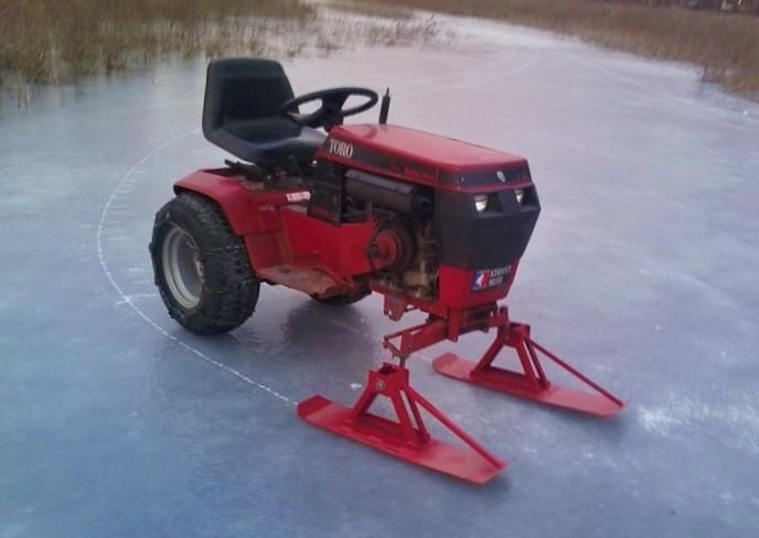

ebinmaine 81,000 #1 Posted November 13, 2018 @Mows4three I'm calling you in on this one Dave. It's your "fault" I'm even processing this thought. The title kind of speaks for itself. Dave got me thinking that it would be some kind of practical and useful for part of the Season up here in Maine to have a tractor that had some nasty chains on the back and some sort of steering skis on the front. Thoughts or pictures or information on Other makes would be acceptable but it's a Wheelhorse that I would be thinking of doing this to. @wallfish John my friend I'd love to see what kind of designs you have in mind here. 2 1 Share this post Link to post Share on other sites

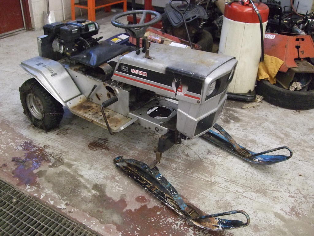

LengerichKA88 1,885 #5 Posted November 13, 2018 This could be interesting lol. Found this while googling 8 1 Share this post Link to post Share on other sites
ebinmaine 81,000 #6 Posted November 13, 2018 Norman at I save tractors built a half track green one. Share this post Link to post Share on other sites

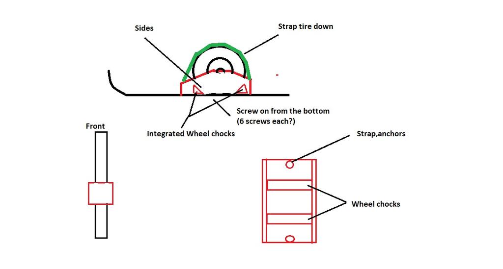

wallfish 20,700 #11 Posted November 13, 2018 (edited) 4 hours ago, ebinmaine said: @wallfish John my friend I'd love to see what kind of designs you have in mind here. Off the top of my head. I'd prefer to keep it simple and an easy swap back and forth. Build small boxes which attach to some child size skis or cut some big ones down. Basic idea is to attach them directly to the front wheels and held on with ratchet straps. Use 2 sides of 3/4 plywood (so the wheels can turn them) and attached to a bottom piece that gets attached to the ski. Some wheel chocks to hold the tire in the correct place and also used to hold the 2 sides together. Maybe double up skis, 2 per side so it's wider??? Edited November 13, 2018 by wallfish 9 1 Share this post Link to post Share on other sites

AMC RULES 37,260 #20 Posted November 14, 2018 4 hours ago, wallfish said: Off the top of my head. I'd prefer to keep it simple and an easy swap back and forth. Build small boxes which attach to some child size skis or cut some big ones down. Basic idea is to attach them directly to the front wheels and held on with ratchet straps. Use 2 sides of 3/4 plywood (so the wheels can turn them) and attached to a bottom piece that gets attached to the ski. Some wheel chocks to hold the tire in the correct place and also used to hold the 2 sides together. Maybe double up skis, 2 per side so it's wider??? Appears as if your idea is sound John. 5 Share this post Link to post Share on other sites
