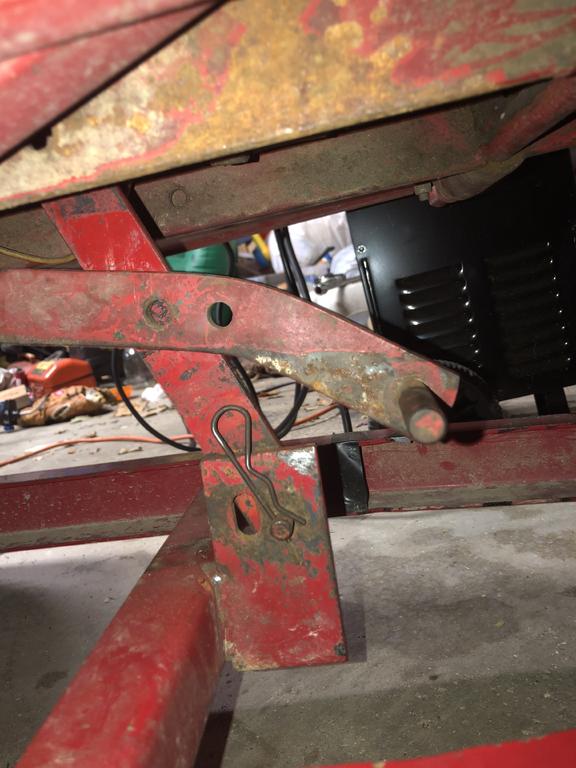

peter lena 10,090 #3 Posted November 10, 2018 very good basic blade and mounting set up, I use spring clips in the two small holes on the rear axel lever arms, you don't want the rear part of the frame suddenly coming out of the lever arms. I also bolt on center lift point , with bolt /washers ,and elastic lock nut, again preventing a noisy/ sloppy fit and ensuring it all stays in place. Lubricate lower blade swing arm triangle to frame, also lubricate the steering quadrant and angle pin slide. the lubrication detail will make for effortless blade swing , the bolt on linkage will make things work like they are supposed to . the detailing is my own experience, you do not have to do this, hope it works out for you , pete 1 Share this post Link to post Share on other sites

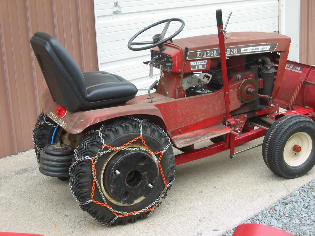

pfrederi 21,222 #8 Posted November 12, 2018 I use cable. Easier to adjust as needed and also lets you lay the angling handle down flat (with out bending \dislocating the solid rod) so you can roll the tractor right into position to hook up. Of course I no longer mount /demount the blade... Stays on full time. Can't get a better pic at the moment as the snow horses are still napping in the storage shed 1 Share this post Link to post Share on other sites

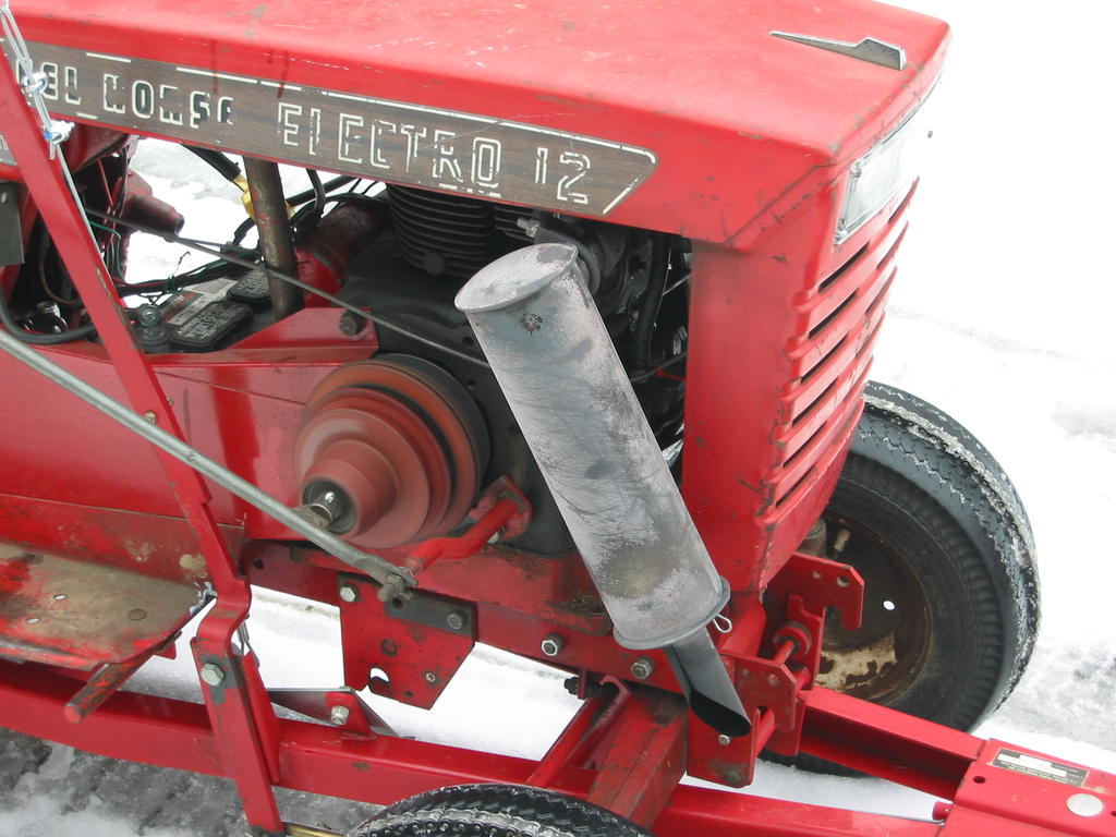

LengerichKA88 1,885 #9 Posted November 16, 2018 On 11/12/2018 at 10:14 AM, pfrederi said: I use cable. Easier to adjust as needed and also lets you lay the angling handle down flat (with out bending \dislocating the solid rod) so you can roll the tractor right into position to hook up. Of course I no longer mount /demount the blade... Stays on full time. Can't get a better pic at the moment as the snow horses are still napping in the storage shed That’s not a bad idea! I’ll have to talk withbthe FIL, we may have the stuff laying around to do that! I do have another plow related wiestion though: have i I hooked this up wrong, or am I supposed to just keep that arm out of the way? It wouldn’t fit through the hole onnthe plow, so I figured it was specifically for the mower deck, but then it got wedges against the cotter pin and wouldn’t let the blade travel upward. I currently have it zip tied up and out of the way. (Picture below) Share this post Link to post Share on other sites
ebinmaine 80,930 #10 Posted November 17, 2018 15 hours ago, Lengerich8 said: have i I hooked this up wrong, or am I supposed to just keep that arm out of the way? There are 2 ways to hook up a Wheelhorse plow. One is to have a chain or links from the lift lever to the bar you show which is also used for the mower. This set up gives the plow the weight of it's self by gravity only. It appears you have a solid bar which is known as a down pressure bar. That hooks directly from the lift handle to the plow frame allowing you to push down on the plow when in use. I found that to be very handy when plowing my gravel driveway yesterday. You did right to tie that other lift link out of the way. @pfrederi thanks for the idea of changing the solid rod to a cable. On 11/10/2018 at 12:47 PM, peter lena said: I use spring clips in the two small holes on the rear axel lever arms, you don't want the rear part of the frame suddenly coming out of the lever arms*************** . Lubricate lower blade swing arm triangle to frame, also lubricate the steering quadrant and angle pin slide. the lubrication detail will make for effortless blade swing , the bolt on linkage will make things work like they are supposed to . the detailing is my own experience, you do not have to do this, hope it works out for you , pete Good info there. What do use for lube in cold weather?? 1 Share this post Link to post Share on other sites
