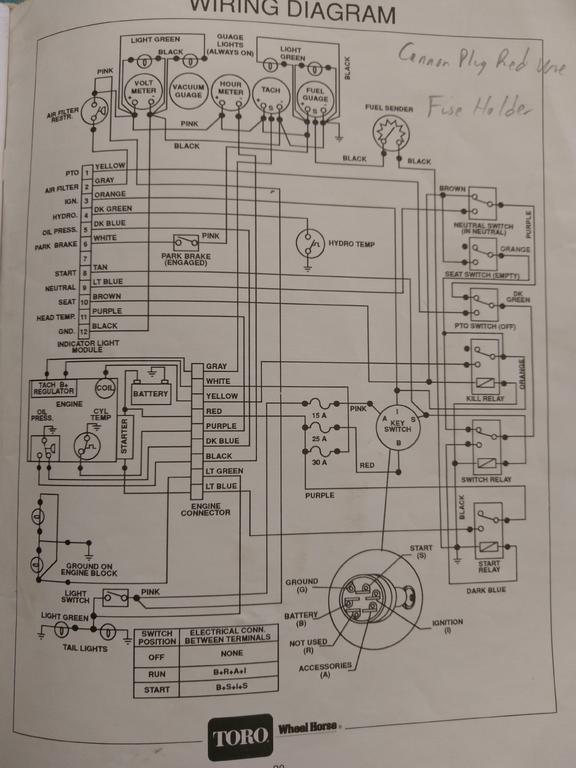

Goldann520 242 #8 Posted November 7, 2018 Got him running tonight, oh, that onan sound! All 5 gauges work, wow! Thats a 1st. Noticed a drip of fluid under high pressure line under trans. Needs a little electrical work. (No lights and amp gauge not showing proper charge. Between red and yellow on gauge. Any ideas?) @WVHillbilly520H, @Vinylguy. Took forever to get the fuel system primed, no gas in it anywhere. Pto stuck and won't engage. Normal stuff. 1 Share this post Link to post Share on other sites
gwest_ca-(File Mod) 11,528 #9 Posted November 7, 2018 A good set of wiring diagrams for this tractor Garry 1 Share this post Link to post Share on other sites
WVHillbilly520H 10,376 #10 Posted November 7, 2018 9 hours ago, Goldann520 said: Got him running tonight, oh, that onan sound! All 5 gauges work, wow! Thats a 1st. Noticed a drip of fluid under high pressure line under trans. Needs a little electrical work. (No lights and amp gauge not showing proper charge. Between red and yellow on gauge. Any ideas?) @WVHillbilly520H, @Vinylguy. Took forever to get the fuel system primed, no gas in it anywhere. Pto stuck and won't engage. Normal stuff. The voltage regulator would be my first guess after double checking all electrical plugs/connections... 1 Share this post Link to post Share on other sites
