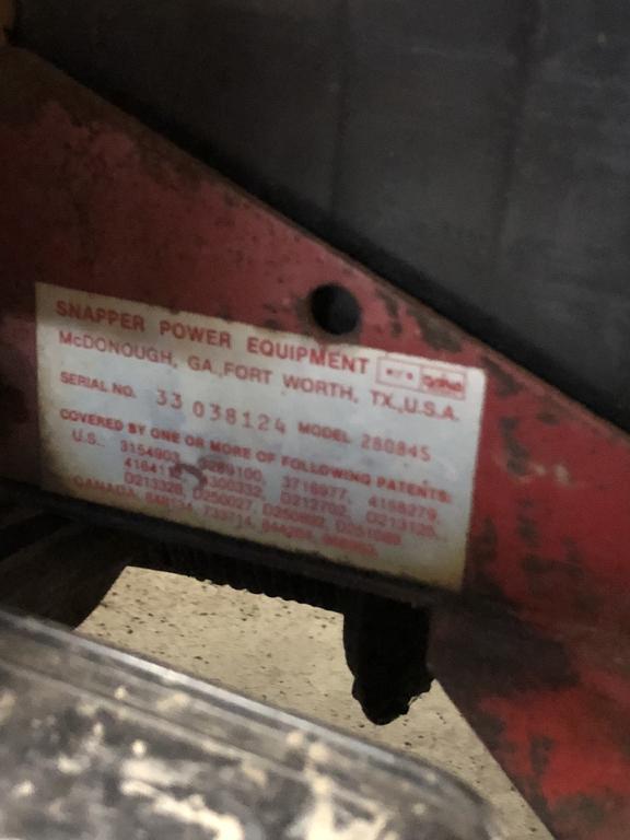

LengerichKA88 1,885 #1 Posted October 28, 2018 (edited) Figured there has to be a Snapper Guy here too, they are red after all... Just picked up my grandpas old snapper from my aunts farm, found the model number and go to Google a manual and I can’t find anything. Okay, no worries, google “Snapper Model List”, I don’t see 280845 listed in the model list. I was trying to find 1) a manual, 2) an estimated value/ age, 3) parts avlibility 4) did it have a name like the “Comet” model🤷🏻♂️ I know nothing about snappers, but I’d like to know if it’s be worth to fix up, restore a bit and sell as a machine, parted out, or just canablize it. Edited October 28, 2018 by Lengerich8 3 1 Share this post Link to post Share on other sites

gwest_ca-(File Mod) 12,296 #3 Posted October 28, 2018 The model number may be 28084S https://www.partstree.com/parts/snapper/mowers-rear-engine-riding-lawn-mower/28084s-snapper-28-rear-engine-rider-8-hp-series-4/ Garry 1 1 Share this post Link to post Share on other sites

LengerichKA88 1,885 #6 Posted October 28, 2018 4 hours ago, gwest_ca said: The model number may be 28084S https://www.partstree.com/parts/snapper/mowers-rear-engine-riding-lawn-mower/28084s-snapper-28-rear-engine-rider-8-hp-series-4/ Garry That is it! Now that the lighting is better, coffee in my veins, I see it. I just thought it was a dirty “5” 😂 Thanks @Garry! @ebinmainemy aunt and uncle used this to mow 2.5 acres for a long time lol. It only looks the way it does cause it’s been in a barn the last few years (they sit on about 11 acres now, so he mows with a Farmall H) @SylvanLakeWH I was thinking about calling it Forest, but it’s not a Comet, and I’m sure it’s not he first one named forest lol. Thanks fellas, I greatly appreciate the help!! 1 Share this post Link to post Share on other sites
