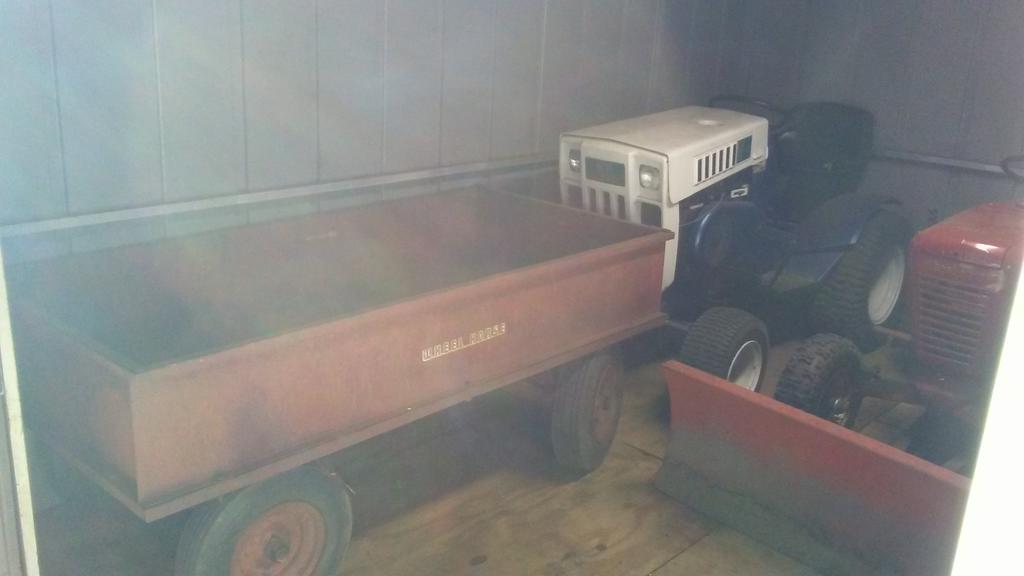

Cetan08 311 #6 Posted October 23, 2018 27 minutes ago, C-85 said: I hope you find a carb and get this running! I liked the old cast iron B&S engines and thought they were great! I'm curious what it came off? I think I remember that Simplicity and Gilson used them, but I'm not sure who else, maybe Sears/Roper? I had always wondered why they stopped making them, I think they were nearly as good as the Kohlers at that time. Anyways, that should be a good engine, I hope you can get it running again! C-85 Not sure what it came off of. I was called by a friend and was asked to clean out an abandoned storage unit. I saved it and a very nice wood burning stove. Going to put it on an older WH. 2 Share this post Link to post Share on other sites

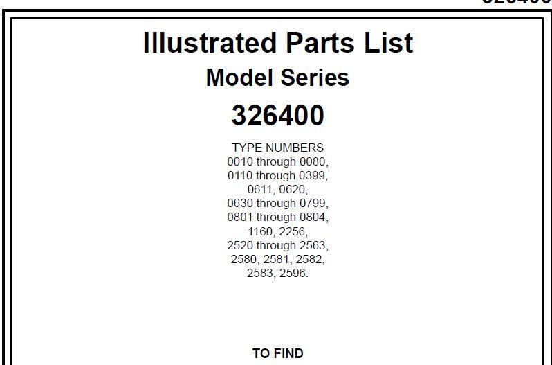

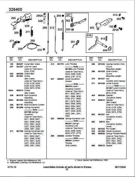

pfrederi 20,895 #11 Posted October 24, 2018 (edited) I have the IPL for your engine. Need anything?? I "Think" I uploaded the whole IPL to the manuals section Edited October 24, 2018 by pfrederi 1 Share this post Link to post Share on other sites

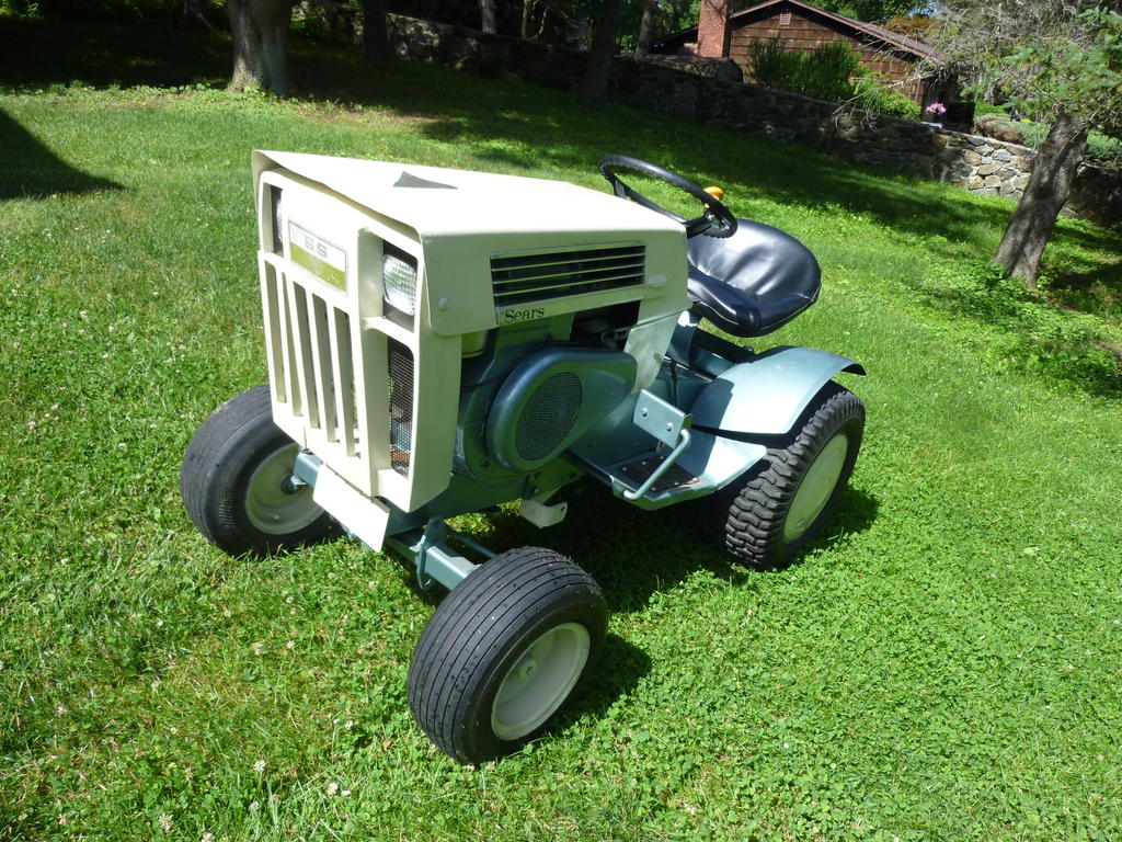

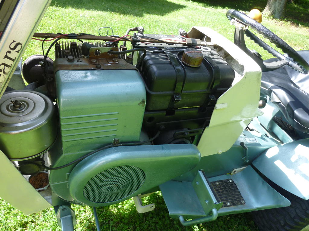

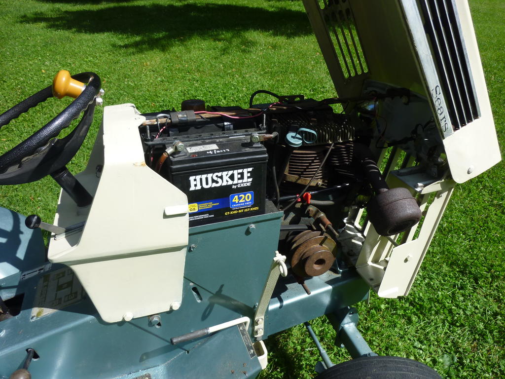

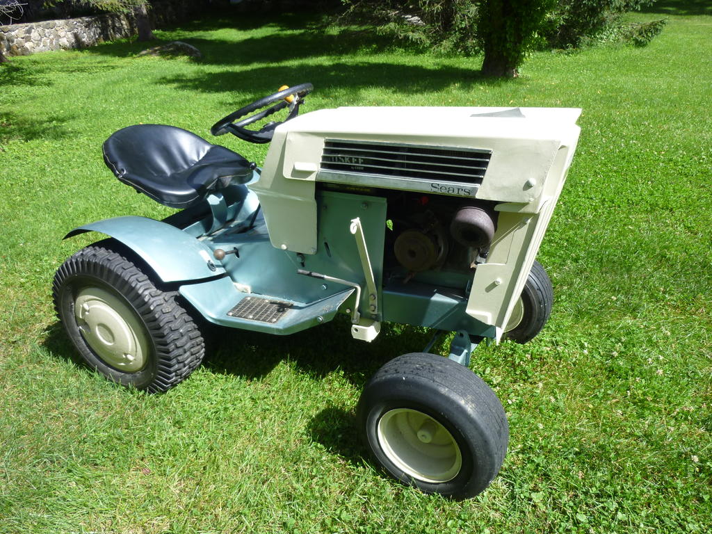

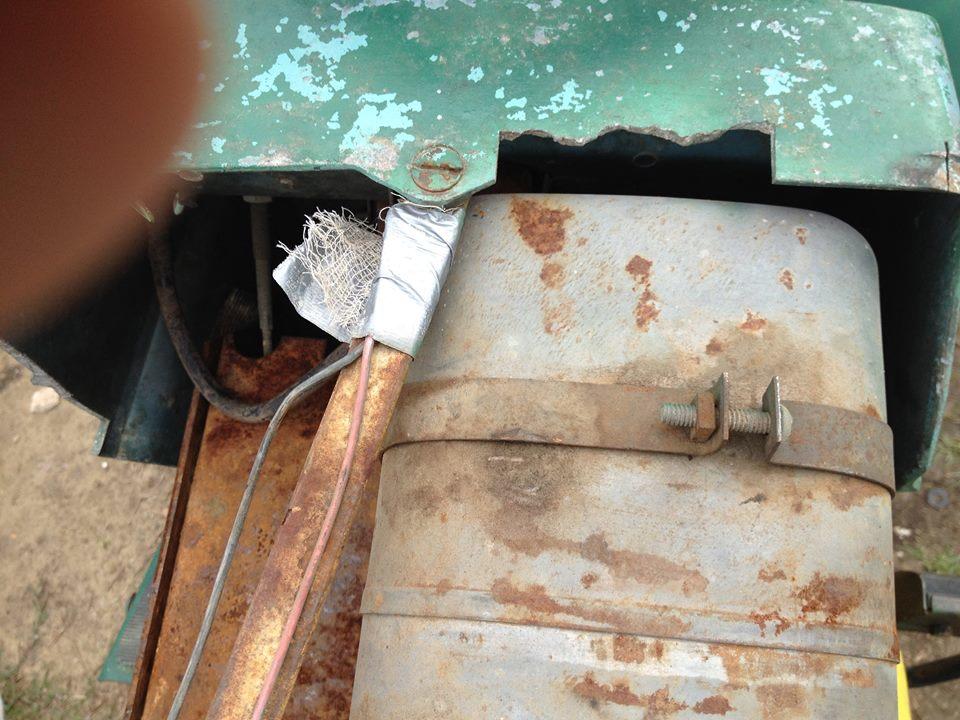

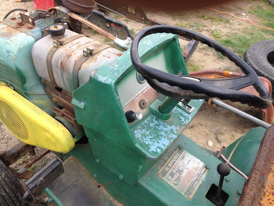

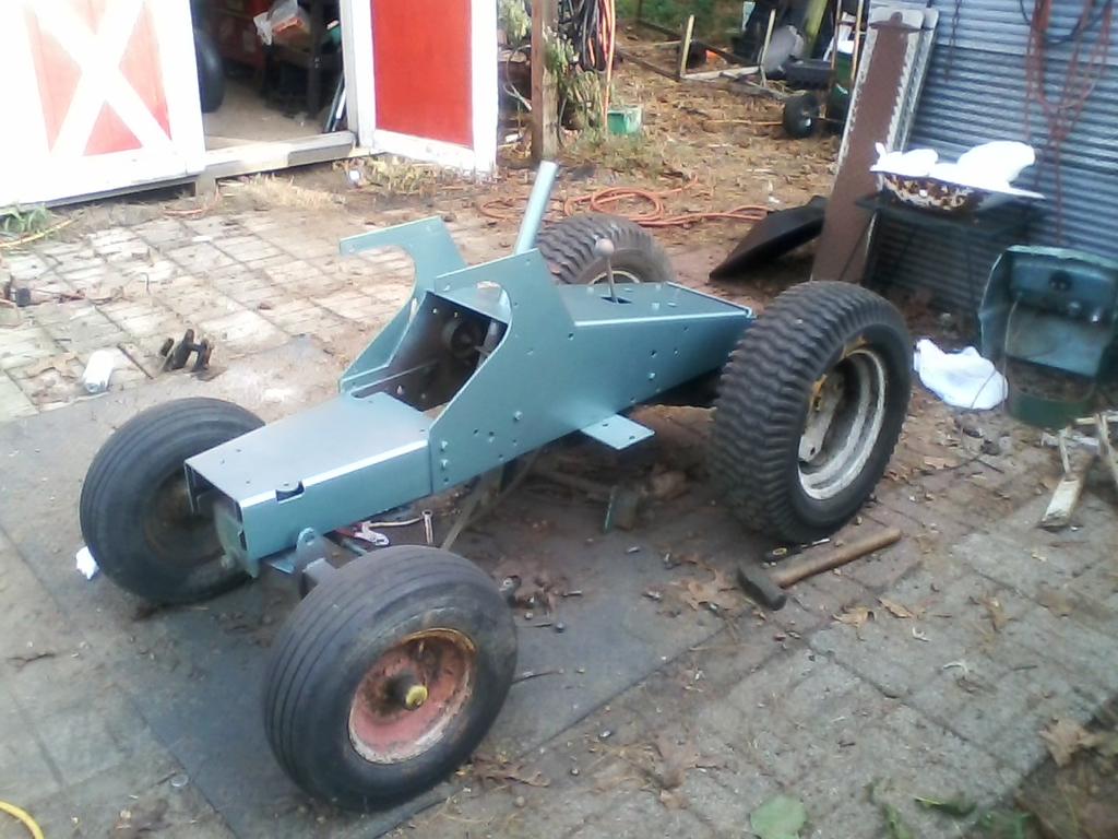

Rob R 989 #13 Posted October 29, 2018 Like craftsmanmower I have B&S 15HP Thumper on my Suburban SS15 great, great engine was in the woods covered for a number of years took me a while to get it going.... I had all kinds of spark issues and could not get a good spark with it until I found a NOS original coil (non electronic) put that puppy on and she mated with the existing flywheel & 50 year old magnets and the spark was super.... then came the carburetor you are correct these engines have the LARGE flow jet Carbs the mile long fuel atomizer rod which if you can get out make sure you say a special prayer to your favorite saint.. mine would NOT so I carefully drilled it out without damaging the seat replaced the rod, cleaned the rest of it thoroughly ….. that was five yrs ago and to this day is the best starting and running tractor I have loves to take my abuse and the sound the engine makes is the closest to a John popper I know.... attaching some befores and afters. 6 Share this post Link to post Share on other sites
WHX?? 57,470 #14 Posted October 29, 2018 Wow Rob...talk about a labor of love... 2 Share this post Link to post Share on other sites
PeacemakerJack 11,022 #15 Posted October 29, 2018 Well done Rob...thanks for sharing all those it is great when you invest time and effort into something and you get to reap the rewards and benefits of that labor expended! @ebinmaine something looks vaguely familiar with that air cleaner 1 Share this post Link to post Share on other sites
ebinmaine 79,740 #16 Posted October 29, 2018 1 minute ago, PeacemakerJack said: @ebinmaine something looks vaguely familiar with that air cleaner Hmmmmmmm........ Wonder where I got that from...... 1 Share this post Link to post Share on other sites
PeacemakerJack 11,022 #18 Posted October 29, 2018 Boy...I love that picture. Calendar worthy for sure...two horses going to work! 1 Share this post Link to post Share on other sites

Rob R 989 #20 Posted October 29, 2018 58 minutes ago, Cetan08 said: That turned into a really nice tractor. I have spark when turning by hand. Nothing to write home about. Shocks me pretty good when I hold the plug wire so hoping it works. I will report on the carb. When it gets here. The other thing I did which may be helpful to you and worked out great is replace the gas tank with a plastic one since the original was to far gone, also the small vacuum fuel pump (simply blocked off the existing vacuum line) .... I intended to install a later model B&S later but tried to eliminate it first what I did is install a very small elbow fitting at the tank which raised the overall gas gravity feed by at least an inch and added an old style bowl filter right next to the carb..... works so well I have never touched it since and I have a LOT of hills at my house..... 1 Share this post Link to post Share on other sites

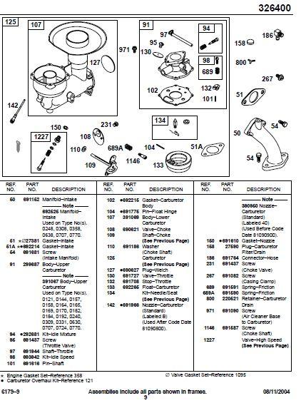

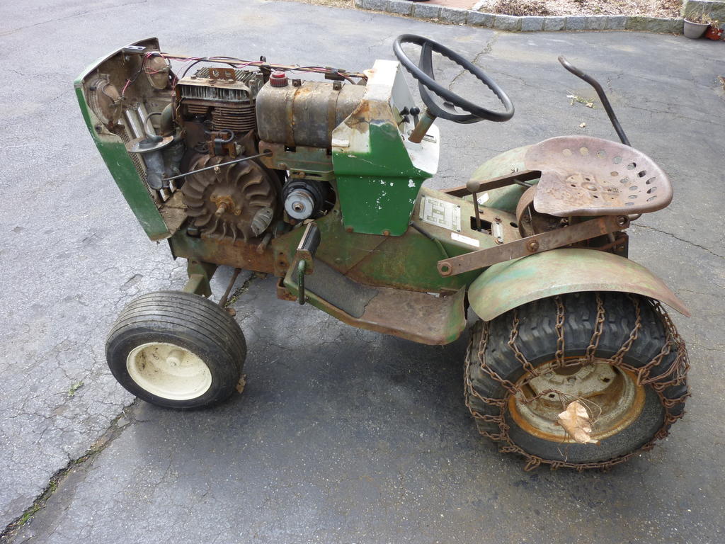

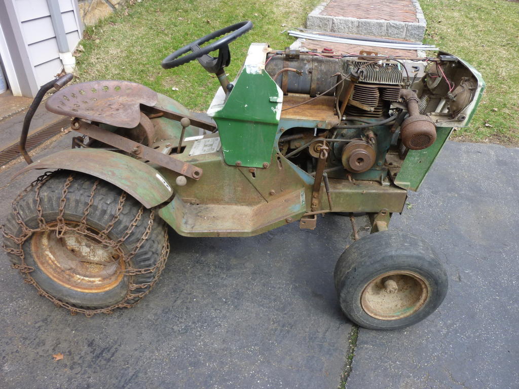

DarylJ 49 #21 Posted October 31, 2018 (edited) Beware of a potential catastrophic problem with this engine’s carburetor design. As you will see on the diagram above, there is a Welch plug used to plug the end of the main horizontal venturi (airway).This Welch plug has the potential to wiggle loose due to engine vibration, then fall out completely leaving the airway wide open, causing the air cleaner to be bypassed entirely! Evidently this carb can be used with different air cleaner orientations, so the Welch plug is used to plug the non-used airway. This happened to my cast iron single cylinder 16HP Briggs & Stratton (exact same engine as yours) twice, both times completely unseen due to it’s barely visible location, causing dust and dirt to be drawn into the carburetor and directly into the cylinder, causing the cylinder wall to become scored, necessitating a .030 rebore once and a new short block after the second mishap. After the second time, JB Weld was used to permanently affix the Welch plug into the carburetor venturi. Since doing that, no more problems. Other than the Welch plug fiascos, the Briggs 16 has been an awesome, bullet proof engine. For me, it powers a Toro Groundsmaster 52 that I have had since new in 1983 for weekly mowing of a 2.5 acre rolling lawn. Just keep changing oil regularly, and change out the air filter as needed, too. Edited October 31, 2018 by DarylJ 1 Share this post Link to post Share on other sites

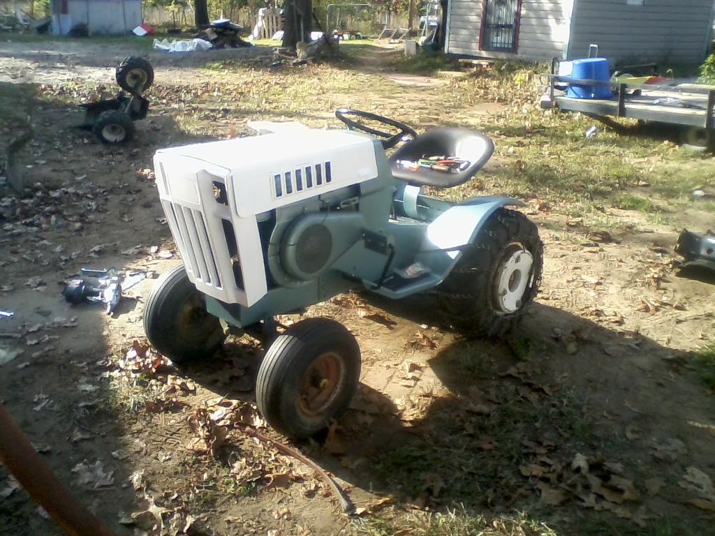

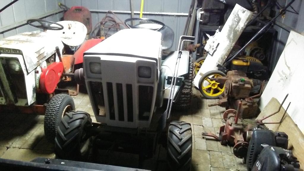

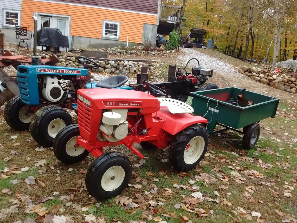

Elkskin's mower junkyard 1,117 #22 Posted October 31, 2018 (edited) my ss14 lol @Rob R Edited October 31, 2018 by craftsmanmowerfreak 1 Share this post Link to post Share on other sites
Rob R 989 #23 Posted October 31, 2018 WOW similarities with your build craftsmanmowerfreak is unreal..... LOL and congrats...…. no problems with my welch plug to date but think I will get a little epoxy on it....p.s. did you ever finish the front rims? Share this post Link to post Share on other sites
Elkskin's mower junkyard 1,117 #24 Posted October 31, 2018 27 minutes ago, Rob R said: WOW similarities with your build craftsmanmowerfreak is unreal..... LOL and congrats...…. no problems with my welch plug to date but think I will get a little epoxy on it....p.s. did you ever finish the front rims? Put different rims on. I also had to change engine earlier this year the 16hp I put on it last year let go now it's got a low hour 14 go from another ss14. My 15 is in corner of a shed doesn't get out much lol ss15 is dark blue one 1 Share this post Link to post Share on other sites
Cetan08 311 #25 Posted October 31, 2018 I put a carb on today and got the engine to fire a couple of times. Using a rope to start it is to much for this old man. I am looking around for a starter. I checked the numbers on the engine and they are : 326437 0174 01. There are teeth on the flywheel but the nose of the starter would need to be long. My engine has a piece on the front that you would wrap a rope around and pull it to start it. I notice that many of these engines have a starter generator on them. No place for a belt on mine. I am wondering what I have here. Any ideas sure would be appreciated. I will get some pictures. Share this post Link to post Share on other sites
