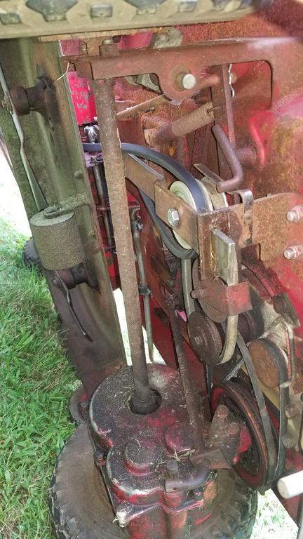

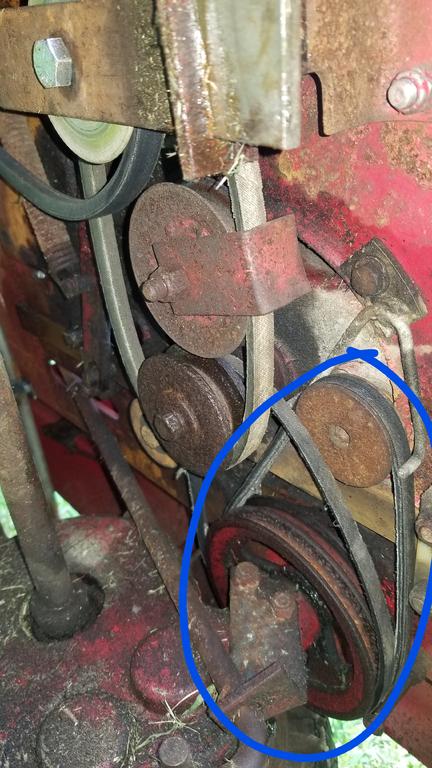

AMC RULES 37,260 #5 Posted October 6, 2018 Did it stretch, and throw it's old dried up, crusty fwd, reverse belts? Easy enough to tip up on it's right side and inspect. 2 Share this post Link to post Share on other sites
SylvanLakeWH 32,823 #7 Posted October 6, 2018 Does it roll in neutral? When it is running and you shift - does it shift easy? do you hear any binding / squealing? AMC is on to another possibility... Also - I would check and see if there is something wedged in there like a stick, bound belt etc... Start easy before tearing apart the tranny... Share this post Link to post Share on other sites
D_Mac 9,339 #8 Posted October 6, 2018 No all the belts are fine. It does not roll. My friend was driving it and he stopped to engage the blades and thats when it decided not to move again. I can shift the lever easily between high neut and low but the rear wheels do not spin. The machine is in such great shape. It didnt get much use. Sat unused in a barn for many years. It even still has the little paper label around where you put the gas in. All original 1 Share this post Link to post Share on other sites

gwest_ca-(File Mod) 12,535 #15 Posted October 6, 2018 See there are 5 Woodruff keys used and the one on the outside is at the driven pulley. Make sure that pulley is not spinning on the shaft before you get real serious. Garry 2 Share this post Link to post Share on other sites

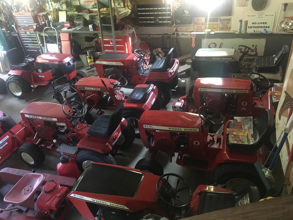

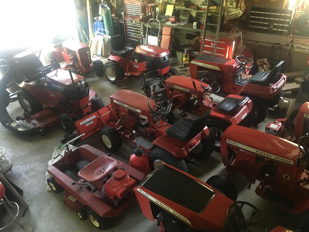

c-series don 12,656 #25 Posted October 10, 2018 Here is my garage, I'm clearly running out of room. I could probably squeeze in one more if my wife doesn't notice! Share this post Link to post Share on other sites
