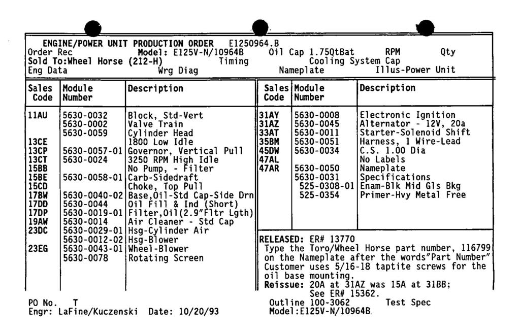

Tractorhead 9,214 #14 Posted October 9, 2018 14 hours ago, onanparts.com said: A PM will work. The E125V spec #'s that kit # 102-1433 is correct for are any of the following: 11217, 11294, 11315, 11326, 11330, 11474, 11536 and 11537. If you locate any of these spec numbers on the tag, you are in luck! As far i can read a bit of i got followed nombers: E125V N/10964B part no: 116799 hmm what is it ? My Wheelhorse was a "European modell" as far as i found out. will it fit? Share this post Link to post Share on other sites
onanparts.com 185 #15 Posted October 9, 2018 5 hours ago, Tractorhead said: As far i can read a bit of i got followed nombers: E125V N/10964B part no: 116799 hmm what is it ? My Wheelhorse was a "European modell" as far as i found out. will it fit? Yes it will. There are about 40 more spec numbers for the E125V! In the kit are the following gaskets: 1 Ea. 110-3598 valve cover 1 Ea. 110-3588 oil base 2 Ea. 146-0486 carb 1 Ea. 146-0484 carb 1 Ea. 140-2329 carb/air cleaner Here is the Onan Production order for your model. Share this post Link to post Share on other sites

Tractorhead 9,214 #18 Posted October 9, 2018 13 minutes ago, onanparts.com said: Yes it will. There are about 40 more spec numbers for the E125V! In the kit are the following gaskets: 1 Ea. 110-3598 valve cover 1 Ea. 110-3588 oil base 2 Ea. 146-0486 carb 1 Ea. 146-0484 carb 1 Ea. 140-2329 carb/air cleaner Here is the Onan Production order for your model. Let me say like 10cc in dreadlock holiday Because i wan't it, i like it, 1x gasket set and intake valve stem seal please Share this post Link to post Share on other sites
