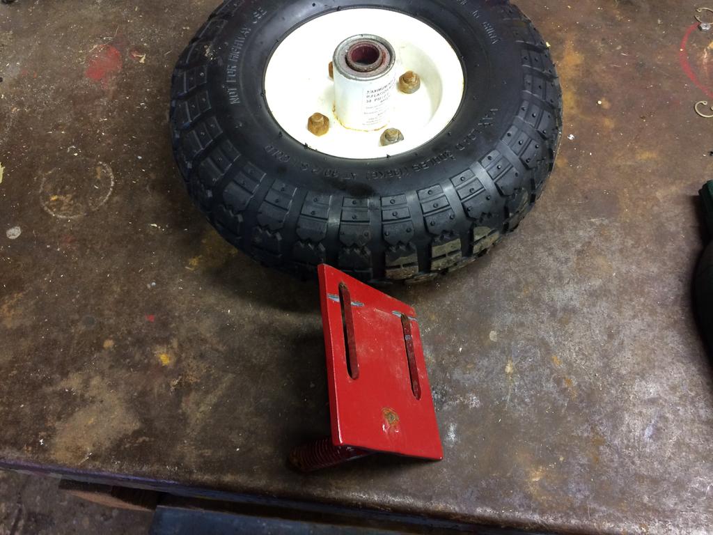

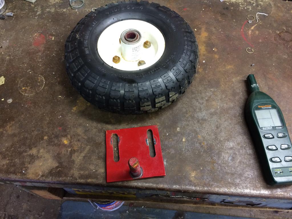

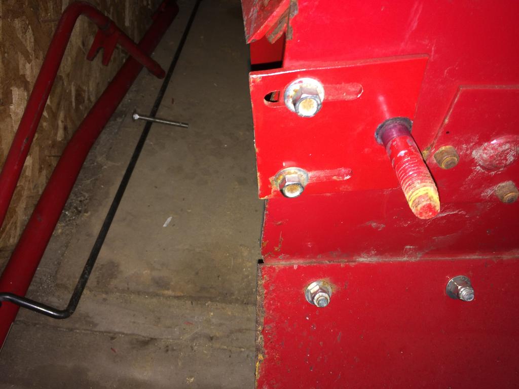

pfrederi 21,246 #51 Posted October 6, 2018 (edited) 2 hours ago, squonk said: Good timing Paul. I happen to have taken off one of the mounts so another pair can be made for @rjg854 A plate copied from the original skid with a bolt welded to it and a cotter pin hole to hold the wheel on. It just depends on what size axle the wheels your going to use are. My tires are 4.10 X 3.50 X 4 with 5/8" axle hole. just picked up 2 new ones at TSC for $20 My metal working and welding skills are sub-optimal but since it will be hidden by the wheel i am going to make a pair!!! Thanks Edited October 6, 2018 by pfrederi 1 1 Share this post Link to post Share on other sites

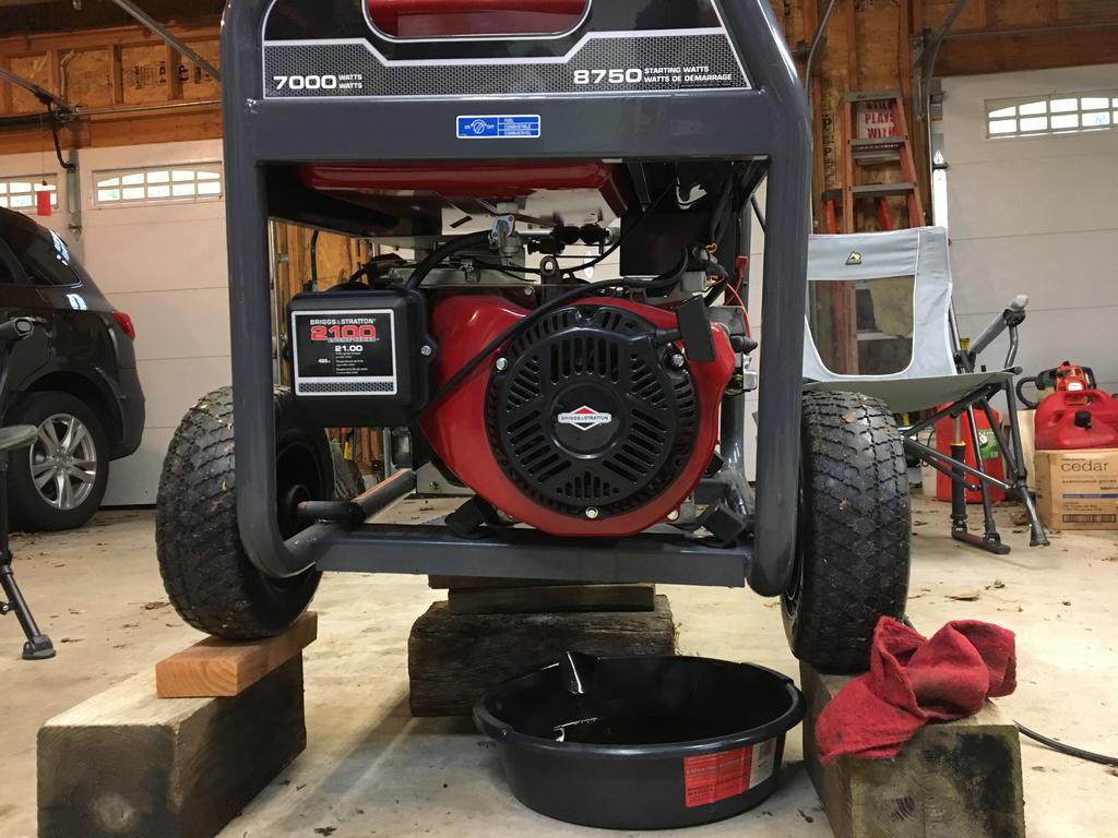

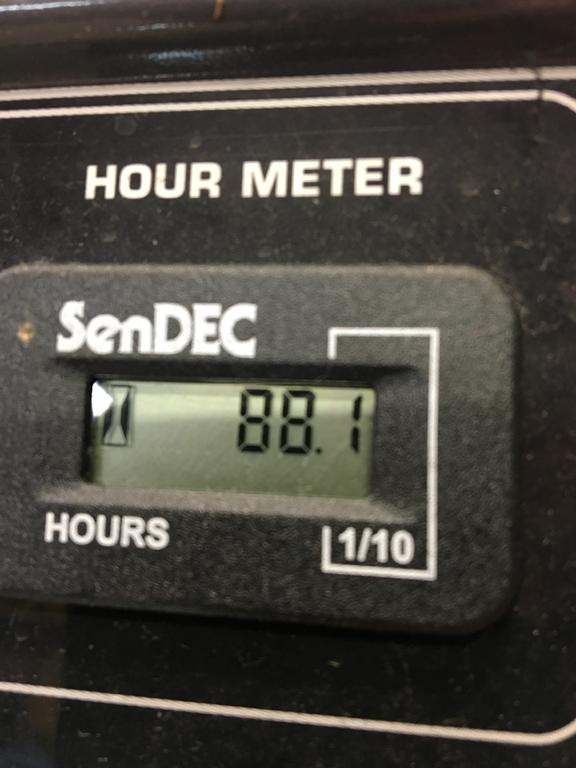

Sparky-(Admin) 26,565 #53 Posted October 7, 2018 It was generator maintenance day here for me. I love my gen but the oil change is a pain. The drain plug is way to low for any of my oil catch pans so up on blocks it goes “redneck style”! 5 Share this post Link to post Share on other sites

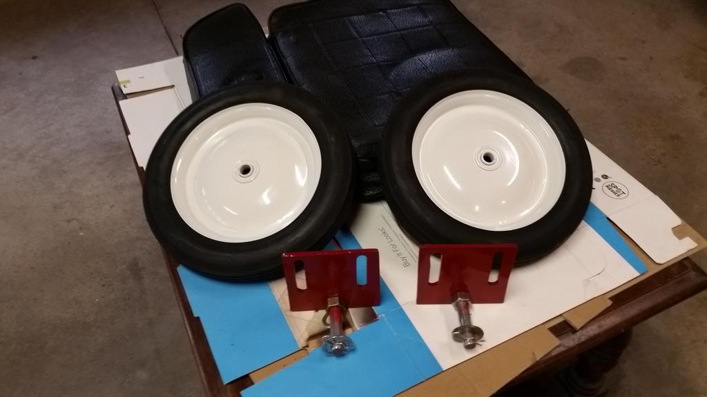

rjg854 13,406 #54 Posted October 11, 2018 On 10/6/2018 at 1:02 PM, squonk said: Good timing Paul. I happen to have taken off one of the mounts so another pair can be made for @rjg854 Got the plates painted and ready for the wheels once they are mounted on the snow blower 1 Share this post Link to post Share on other sites
