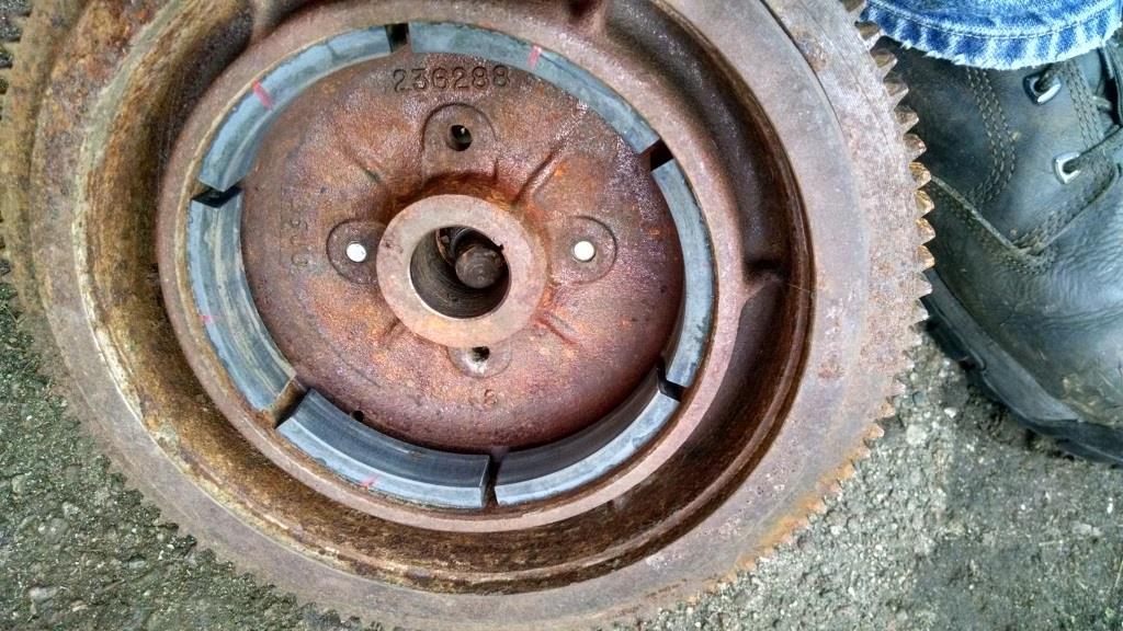

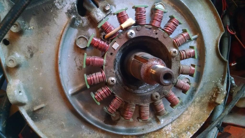

Achto 32,260 #32 Posted October 30, 2018 I had a little time to get back to this conundrum last night. I removed the fly wheel to do a visual inspection of the stator & the magnets on the flywheel. I also pulled the stator wires through the bearing plate to inspect them for damage. My results????? NOTHING . All looks as it should. I put every thing back together, plugged the regulator in & it charges at 14.3vdc. By this time it was dark already so I did not get a chance to drive it around to see if the issue remains. Took a couple pics, let me know if you see something that I might have missed. Tonight (if the weather allows) I'm going to try @pfrederi's suggestion & isolate the ignition circuit to see if it still stalls out. Will probably run the ignition on a separate battery to make sure that the charging sys can't effect it. 2 Share this post Link to post Share on other sites

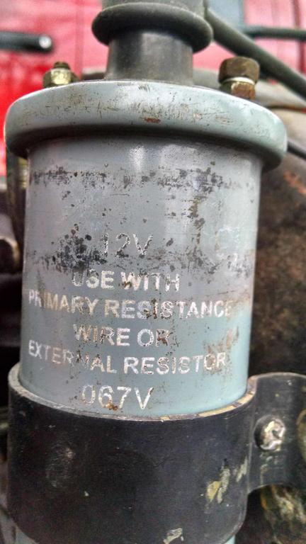

Achto 32,260 #33 Posted October 31, 2018 Back at the head scratching. For some reason I decided to take a look at the ignition coil & may have found the issue. This could not be read while it was in the clamp. Now please correct me if I'm wrong, but this does not seam to be the right coil. Shouldn't it have a coil with an internal resistor when using a points ignition? 2 Share this post Link to post Share on other sites
Howie 900 #34 Posted October 31, 2018 (edited) I think it should have the internal resistor, but that one could be used with an external resistor. Think it is harder on points without the resistor. Edited October 31, 2018 by Howie 2 Share this post Link to post Share on other sites
WHX?? 57,644 #35 Posted October 31, 2018 Good point Howie but why? I always thought the condenser took the brunt of points open/closing off the points. My understanding is resistor loaded coils were used with later mag ignitions and trigger ignitions? I could be dead nuts & bolts wrong there tho. Truth be told fellas I am not too sure this is even an ignition related problem. But on the other hand why does it fire right back up after self shutdown. That's the kicker. Have we ruled out a fuel supply related issued? Say the bowl runs empty but then somehow fills itself after shut down? Weird I know but just trying to to think outside the box here. Correct me if wrong Dan but battery fired points ignition here right? I CRS.... 1 Share this post Link to post Share on other sites
Howie 900 #36 Posted October 31, 2018 I am not sure on the why part but do remember that would happen on the 60's cars with point ignition and the wrong coil was used. This ignition system is no different, operates the same. 2 Share this post Link to post Share on other sites

953 nut 68,175 #38 Posted October 31, 2018 Eureka! You solved the problem. The external resistor on points ignition dates back to the mid '50s when 12 volt systems replaced 6 volt. The solenoid on all Ford products had a small "I" terminal that went to the coil to supply 12 volts while cranking and paralleled the wire from the run position on the ignition switch which had a resistor. GM and Mopar did similar things with two wires from the switch to the coil one of which went through a resistor for normal running, the other bypassed the resistor for starting. Throw that coil in the trash and get a VW coil that has the internal resistor. 1 2 Share this post Link to post Share on other sites
Achto 32,260 #39 Posted October 31, 2018 (edited) 9 hours ago, WHX21 said: Correct me if wrong Dan but battery fired points ignition here right? I CRS.... Correct Jim. 9 hours ago, Howie said: I think it should have the internal resistor, but that one could be used with an external resistor. Think it is harder on points without the resistor Kind of wondering if this coil works fine at 12vdc but malfunctions once the battery voltage exceeds 13vdc. An external resistor would keep the voltage down to a usable level for the coil, or a coil with an internal resistor would also accomplish this same thing Edited October 31, 2018 by Achto 2 Share this post Link to post Share on other sites
Achto 32,260 #40 Posted October 31, 2018 15 minutes ago, 953 nut said: Throw that coil in the trash and get a VW coil that has the internal resistor. Thanks!! I'll throw a new coil on tonight & see what shakes out. It is still really strange how the engine would seem to go under load before it snubbed out. Wondering if it may have been firing way too soon, causing severe pre-ignition? 1 Share this post Link to post Share on other sites
953 nut 68,175 #41 Posted October 31, 2018 1 hour ago, Achto said: coil works fine at 12vdc but malfunctions once the battery voltage exceeds 13vdc. An external resistor would keep the voltage down to a usable level for the coil, or a coil with an internal resistor would also accomplish this same thing It was probably heating up due to excessive current flow at twelve volts and higher voltage and resulting current flow pushed it over the edge. With a resister in line the coil will see about two amps of electrical flow, but without one it is doubled to four amps and with higher voltage applied it would be two and a half to three times as much flow as it was designed to handle. 2 1 Share this post Link to post Share on other sites
WHX?? 57,644 #42 Posted October 31, 2018 Sure gotta be ... that's why she ran with a faulty reg.... just running off the battery. Once the reg was replaced and the battery was seeing 13.5 + volts the coil was shutting down. I bet that is a coil a PO just had laying around and threw it on not knowing what we now know. So the motor would fire right back up because the voltage dropped back down to regular battery voltage. Are you saying Richard our coils have an internal resistor? I got a bunch of coils laying around if you need one Dan... and if I can find them! 3 Share this post Link to post Share on other sites
pfrederi 20,997 #43 Posted October 31, 2018 (edited) Kohler Coils and for that matter " most" modern coils are internally resisted. If not you need to use a ballast resistor (and since they have problems of their own i wouldn't recommend it by a correct coil. They are usually marked like the picture above if they are not internally resisted. also any coil marked 6 v can work with a 12 volt system but must have a ballast resistor. Edited October 31, 2018 by pfrederi 1 2 Share this post Link to post Share on other sites
