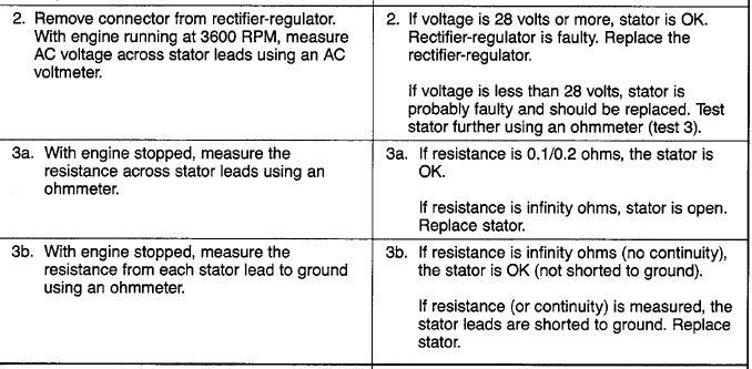

WHX?? 58,226 #21 Posted October 8, 2018 (edited) Here's that thread I mentioned. Probably won't help with the problem but an interesting if not humorous read. Sure wish this member was still active Rectifier-Regulator Autopsy from OLD Redsquare forum.pdf Here another one that may or may not help IF the problem is electrical. Still not a bad idea keeping this on file. Stator business info starts about page 21. 07 - Engine Electrical Systems.pdf This was out of that manual for a 15 amp charger Edited October 8, 2018 by WHX21 1 Share this post Link to post Share on other sites

WHX?? 58,226 #23 Posted October 9, 2018 (edited) Yup Richard, did it at the tractor show and thought problem fixed...charging looked good and voltages correct till extended? seat time. I say pull the tins and flywheel just to check things out. Would be interesting to see what voltages crop up when it does it's thing, possibly with a ac voltmeter clipped to to the stator. I am just not convinced this is a electrical draw problem. To stop a mighty 14 in it's tracks takes alot of power. Its just weird that unplugging the reg problem goes away. Note the very small resistance on the stator Dan .1/.2 ohms?? I would have thought that meter would have been able to read that small? OK the up side might mean more diagnostic seat time! Edited October 9, 2018 by WHX21 2 Share this post Link to post Share on other sites
