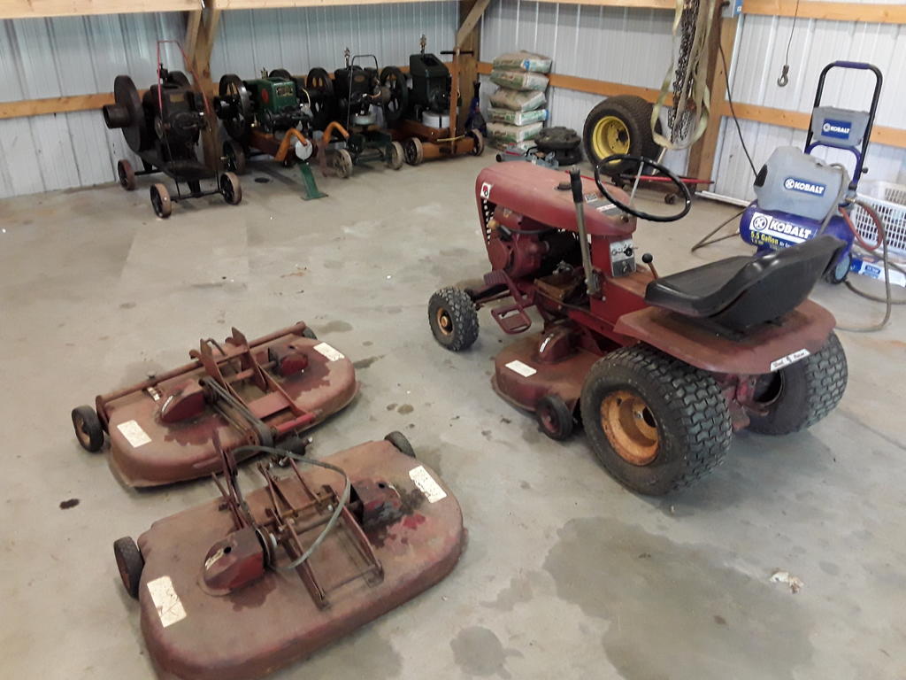

Great find.  Just being nosey, is that a hit and miss engine collection?
  • Like 2
mhlmeader
  Thankyou, and yes it is, i like to watch them spin")

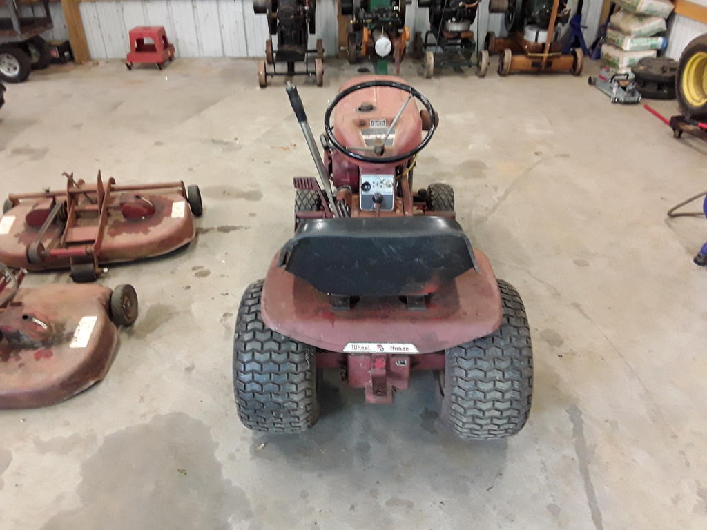

KC9KAS
Nice looking Lawn Ranger.
Some boiled linseed oil on that nice patina will be the icing on the cake!

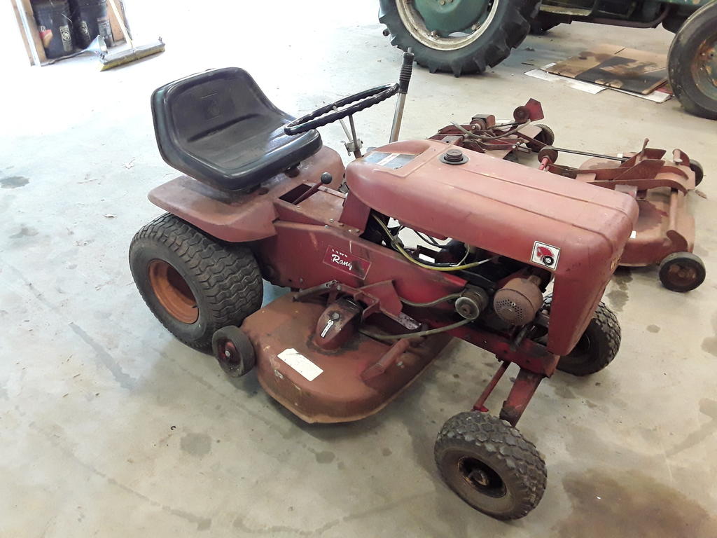

Look for an ID plate riveted to the top of the rear hoodstand just below the hood. Should have the model number and serial number stamped into it. Don't know where else it could be.
Some of the model numbers are on this page. 1965 model L-155, 1966 model L-156 and 1967 model L-157 are missing. These 3 are electric start models.
https://www.partstree.com/parts/search/models/?searchTerm=lawn+ranger
The numbers off the engine may identify the tractor.
Garry
  • Like 1
953 nut
10 hours ago, mhlmeader said:
is there a specific model number for this tractor.? Range of year of manufacture?
There should be a sticker or tag with a model number and serial number on it. Appears to be a 1964 to 1967, but I am no expert on the Lawn Rangers. The steering wheel will probably pin it down. If @Lane Ranger comes along I'm sure he will know.
  • Like 1
mhlmeader
1 hour ago, 953 nut said:
There should be a sticker or tag with a model number and serial . If @Lane Ranger comes along I'm sure he will know.
Actually i just found that tag this morning. L-156.

The 1967 "L-157" is essentially the same tractor, this manual may come in handy.
Lane Ranger
It has to be a 1965, 1966 or 1967.  If no tag on left side of tower by lift handle the  need to be looked at closely for metal tags.  Two spoke steering wheel on these models.   Same basic tractor for three years.   The gear driven mower deck may provide clues if they have tags.   RM-115 is 1965, RM-116 is 1966 , etc

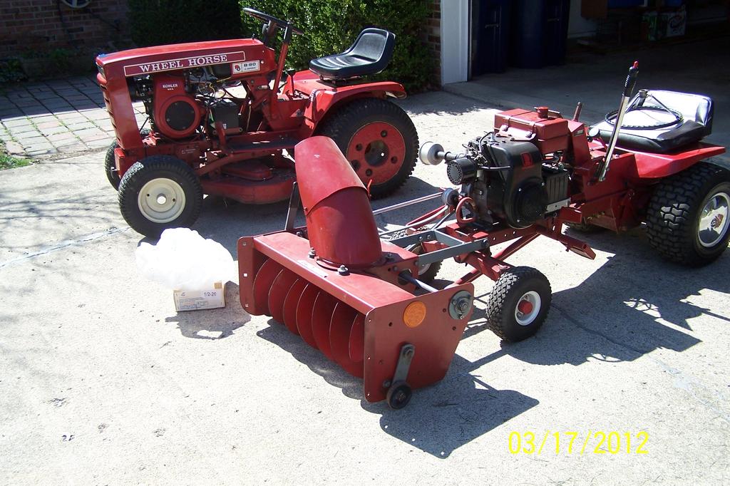

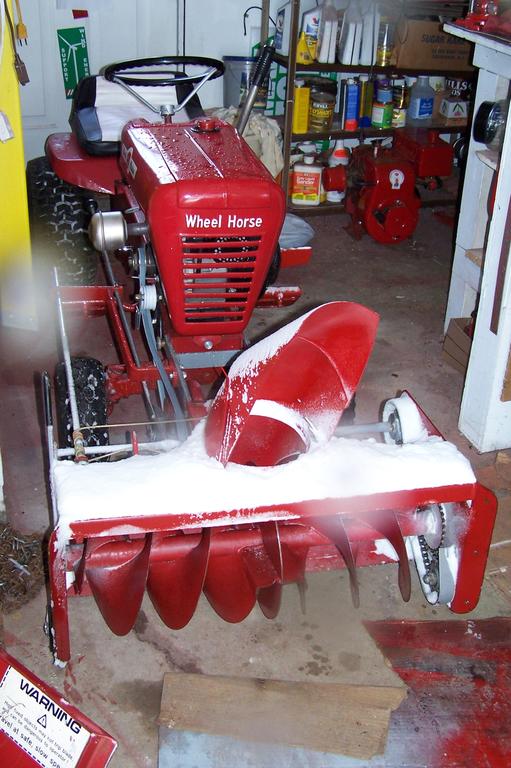

My 1967 has a ST-324 Wheel Horse snowthrower on it that I use almost every winter!
  Does not throw the snow thirty feet like more powerful motors but the 6 HP motor does a good job and I do not normally have to shovel the drive!

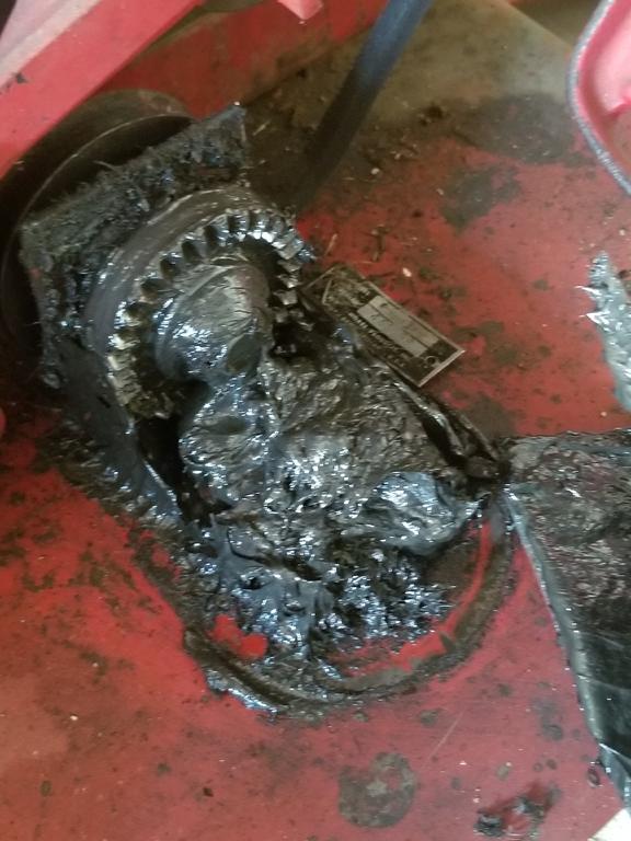

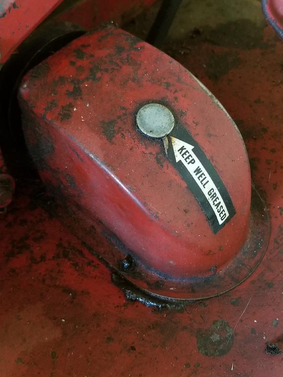

Hi sir I have a dumb question about my lawn ranger deck, I removed the spindle cover and it was full of grease, is this correct? I was thinking it's just an access hole to grease the spindle
  • Like 1
stevasaurus
@D. McKinley...you are correct. Under that grease you will find a grease fitting.  It is a little hard to hit when you pull that plug, but that is what is going on.  welcome to Red Square.  Next time, it would be better if you started your own post on a subject, and not add on to one that is over a year old.  :occasion-xmas:  You will get more members to see your thread.
