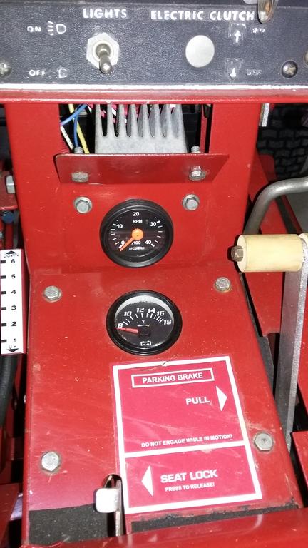

BOB ELLISON 2,983 #5 Posted September 25, 2018 What model and year do you want to put the tachometer on and do you want a hand held or it mounted on the tractor ? I did a post for a mounted tack that I still have on my C160. Works great still . Share this post Link to post Share on other sites

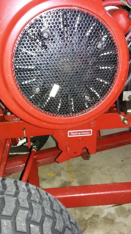

elcamino/wheelhorse 9,363 #10 Posted September 27, 2018 On 9/24/2018 at 8:43 PM, BOB ELLISON said: Google digital tachometer and you'll get everything you need. I got this one from Harbor freight and it works good. https://m.harborfreight.com/digital-photo-sensor-tachometer-66632.html @BOB ELLISON Where do you mount the reflective tape on the drive pulley ? Share this post Link to post Share on other sites
Kurt-NEPA 756 #11 Posted September 27, 2018 On 9/24/2018 at 8:43 PM, BOB ELLISON said: Google digital tachometer and you'll get everything you need. I got this one from Harbor freight and it works good. https://m.harborfreight.com/digital-photo-sensor-tachometer-66632.html I'm using the same tach that Bob mentioned. Works great. I put the tape on the pulley on my 520H, and on the drive shaft of my 522xi. 1 2 Share this post Link to post Share on other sites
BOB ELLISON 2,983 #12 Posted September 27, 2018 7 hours ago, elcamino/wheelhorse said: @BOB ELLISON Where do you mount the reflective tape on the drive pulley ? On flywheel screen. Or in the dash. I like my in dash tachometer works great 2 1 Share this post Link to post Share on other sites
WHX?? 58,310 #13 Posted September 27, 2018 How accurate is that in dash one Bob? @BOB ELLISON Share this post Link to post Share on other sites
elcamino/wheelhorse 9,363 #14 Posted September 27, 2018 1 hour ago, BOB ELLISON said: On flywheel screen. Or in the dash. I like my in dash tachometer works great I need to check out your thread on the dash mount. Share this post Link to post Share on other sites
BOB ELLISON 2,983 #15 Posted September 27, 2018 2 hours ago, WHX20 said: How accurate is that in dash one Bob? @BOB ELLISON Very accurate Share this post Link to post Share on other sites
BOB ELLISON 2,983 #16 Posted September 27, 2018 @elcamino/wheelhorse Here's the post 1 1 Share this post Link to post Share on other sites

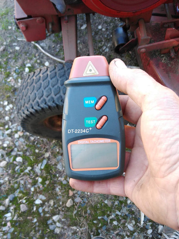

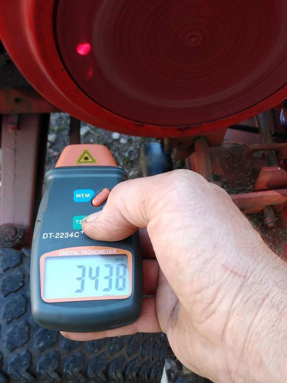

kasey54 305 #17 Posted October 4, 2018 I bought a non contact photo laser tachometer, how ever it seems in correct. I cut a piece of the provided reflective tape and put it on a good running 1725 rpm baldor motor and it consistently reads 4960 rpm. That isnt right. Share this post Link to post Share on other sites
kasey54 305 #18 Posted October 4, 2018 Are there any pit falls? I thought maybe the the keyway may have been acting as a second reflector, so wrapped the shaft with masking tape, painted it black and put another piece of reflective tape on, and had the same results. Thoughts please. Share this post Link to post Share on other sites
WHX?? 58,310 #19 Posted October 5, 2018 The one I got off ebay is kinda like that Kasey. Real inconsistent .... the non contact works for crap but you can also use it for contact as it came with a rubber tip you can put on the end of a shaft. Still a little inconsistent but (sometimes) useable. I think they saw me coming. Share this post Link to post Share on other sites
kasey54 305 #20 Posted October 6, 2018 Upon redoing my test I discovered (read instructions) the device gives three readouts. Highest, lowest, and final rpm. The final , or 3rd readout seems spot on. It also wants .8 seconds of read time. Im much happier now! 2 Share this post Link to post Share on other sites
edgro 680 #21 Posted September 15, 2019 this came from ebay, less than $10 delivered. Not necessarily a recommendation, but within my cheapskate budget. it seems to do a lot of hunting to find is mark, but it did work, and I was able to adjust the governed speed. (it was around 3800) 1 Share this post Link to post Share on other sites
