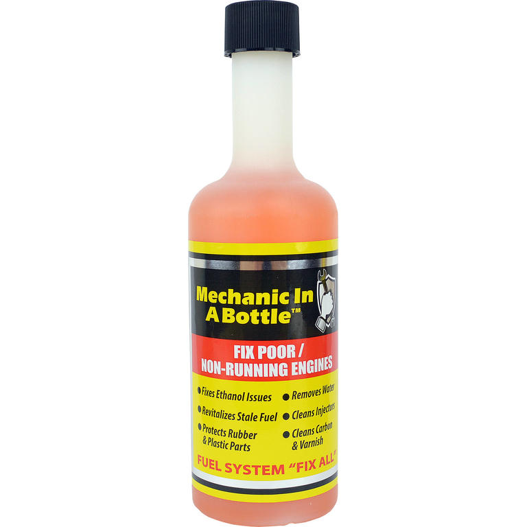

ol550 867 #7 Posted September 18, 2018 Maybe get this little guy to crawl in there and see what the problem is. 2 1 Share this post Link to post Share on other sites
