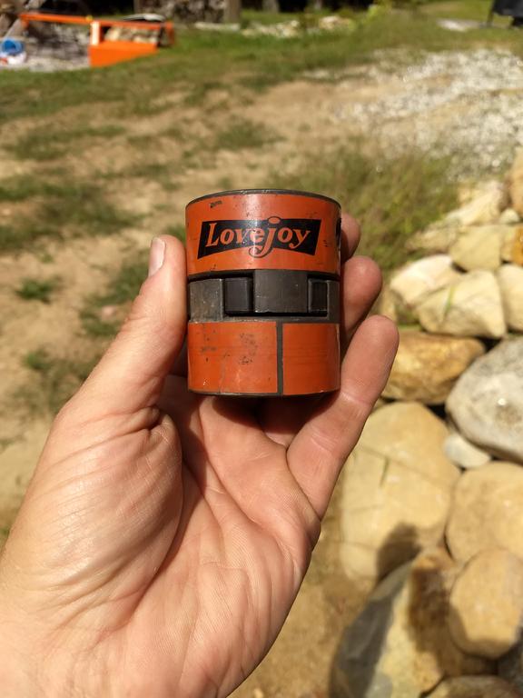

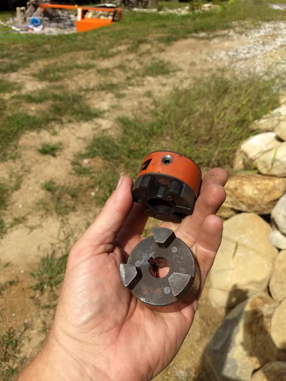

ebinmaine 81,000 #1 Posted September 8, 2018 (edited) I found this the other day in the pile of auction take home stuff. The gentleman that passed away was a professional machinist and did a lot of mechanical repairs and had a full-service machine shop. I gather that it is some kind of a coupler but what is it for? Edited September 8, 2018 by ebinmaine 1 Share this post Link to post Share on other sites
19richie66 17,937 #2 Posted September 8, 2018 We use them to couple engines to pumps. It absorbs some of the vibration between the two and it can be slightly out of alignment and not hurt either of the shafts. 5 3 Share this post Link to post Share on other sites
ebinmaine 81,000 #3 Posted September 8, 2018 Makes sense. Very small shaft diameter for anything that a Kohler would have used. Only 5/8". I wonder what this guy had this thing for?? Share this post Link to post Share on other sites

Ed Kennell 47,685 #15 Posted September 8, 2018 Yep, a shaft coupling that is very forgiving to misalignment and vibration. Easy inexpensive replacement of the rubber spider by sliding the halves back. 1 Share this post Link to post Share on other sites

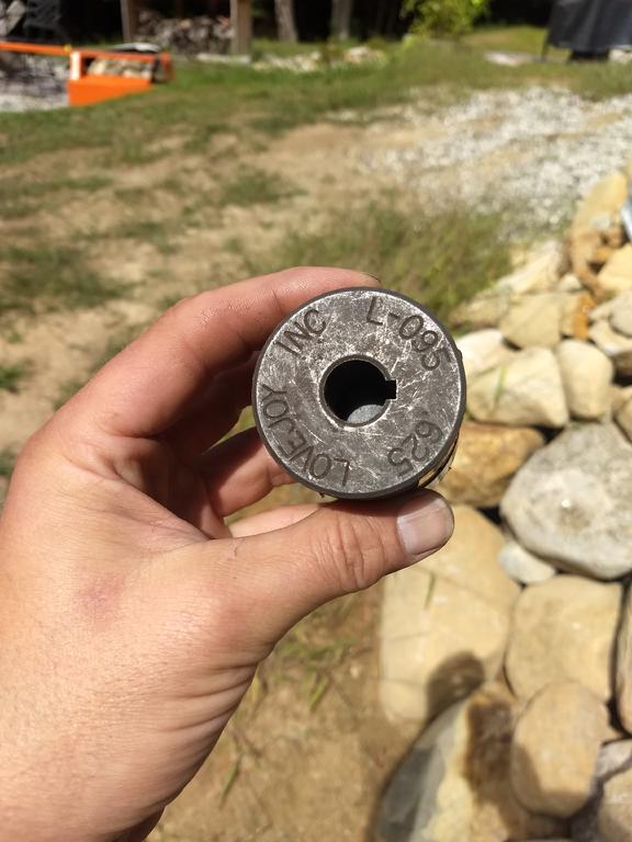

ebinmaine 81,000 #20 Posted September 9, 2018 18 minutes ago, oliver2-44 said: @ebinmaine What size is the shaft hole in that coupling. I’m slowly acquiring parts for a tractor driven Ice cream maker. I need a way to “easily” couple and uncouple it to a reduction drive off the tractor In the picture that shows the end you can see it stamped .625. I haven't physically measured this piece but according to online listings that means it should have a 5/8 inch bore. Share this post Link to post Share on other sites
