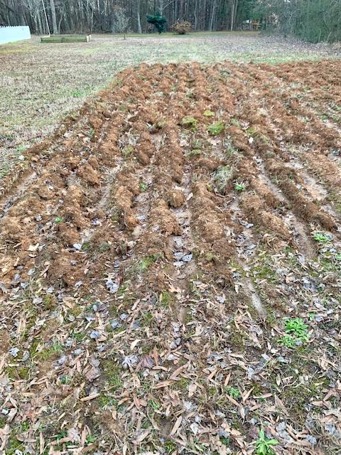

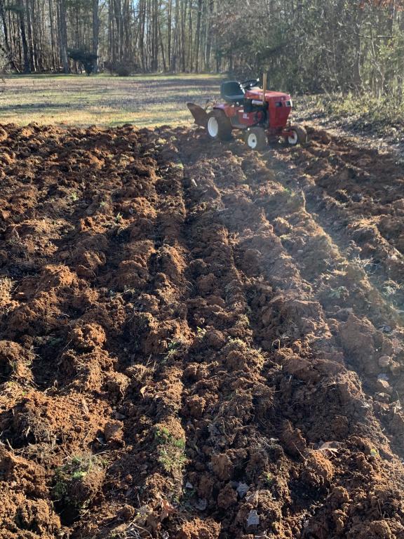

Greentored 3,221 #153 Posted February 24, 2020 Ok plow guru's, help the noob! Now that the garden has sat a bit after plowing, an obvious issue can be seen much easier. There is a good 6 inch 'gap' of untouched ground between each furrow. If you look at the marks at the end of the furrows where the plow point was lifted/dropped, this gap is approx one foot. I ran the right side tires in the previous cut on every pass. The Sleeve hitch pin fits a bit loose in the hitch, and even looser in the plow, I can rock the plow around quite a bit. In a previous post I mentioned that it almost appeared that the plow was 'laying over' (twisting) and not cutting a nice vertical 'wall'. This is the only thing I am questioning. Could this be caused by that loose attachment/pin? 1 Share this post Link to post Share on other sites
Stormin 9,988 #154 Posted February 25, 2020 (edited) How deep have you gone? Looks to me as if you've ploughed shallow. You need to be about 5"-6" deep. A bit of sway is ok, just in case you hit a large stone. A photo of your set up would help. Edited February 25, 2020 by Stormin Share this post Link to post Share on other sites
Pullstart 71,215 #155 Posted February 25, 2020 If you cut a new furrow, then go back over that same one again, does it get deeper? Is the tractor limiting the depth, or is the plow point leveled out and not digging? 1 Share this post Link to post Share on other sites

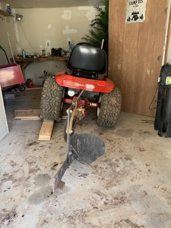

Greentored 3,221 #156 Posted February 25, 2020 (edited) Pardon the crappy quality, but I took this the day I was plowing. Sure looks like the plow is 'twisted'- as in the main frame is not perpendicular to the tractor? You guys might be able to spot something else im not aware of. I have the landslide a good 2.5" off the ground with the tractor level and dont believe the hitch is preventing it from dropping further. Depth was about 4-5", id definitely like to bury this thing, theres gobs of power to spare, and traction was adequate- its pretty clean dirt. Perhaps moving the plow to the right one position would help as well? Edited February 25, 2020 by Greentored Share this post Link to post Share on other sites
Stormin 9,988 #157 Posted February 25, 2020 The plough is swinging to far to the left. It should be straight in line behind the tractor. What hitch have you got? 1 Share this post Link to post Share on other sites
Pullstart 71,215 #158 Posted February 25, 2020 There’s a set screw on the for lack of the proper term... Tail. It should help steer the plow to turn it in a bit 2 Share this post Link to post Share on other sites
Achto 32,637 #159 Posted February 26, 2020 Brinly says to leave the bolts on the hitch loose so that the plow will swing free from side to side. I find that mine works much better if I tighten those bolts up so that the plow will not swing side to side. This keeps the plow strait behind the tractor. 4 1 Share this post Link to post Share on other sites

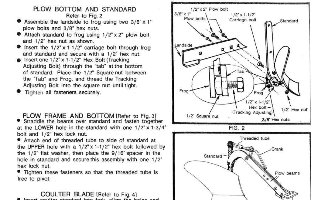

Razorback 1,370 #160 Posted February 26, 2020 (edited) 6 hours ago, pullstart said: There’s a set screw on the for lack of the proper term... Tail. It should help steer the plow to turn it in a bit Are you talking about the tracking adjustment on the "frog"? Brinly plow manual Edited February 26, 2020 by Razorback Share this post Link to post Share on other sites
Pullstart 71,215 #161 Posted February 26, 2020 1 minute ago, Razorback said: Ar e you talking about the tracking adjustment on the "frog"? Brinly plow manual Yep, that’s the one! The frog adjusts the landside. Why didn’t I remember that? Share this post Link to post Share on other sites
Razorback 1,370 #162 Posted February 26, 2020 (edited) 2 minutes ago, pullstart said: Yep, that’s the one! The frog adjusts the landside. Why didn’t I remember that? It's not that I'm a genius...... I just went and read my manual...... I had forgotten about that adjustment. Edited February 26, 2020 by Razorback 1 1 Share this post Link to post Share on other sites
Greentored 3,221 #163 Posted February 26, 2020 @stormin I have a brand new WH sleeve hitch with adjusting/stabilizer bolts. @achto Glad to know I can snug those stabilizing bolts even though the manual says no haha, that seems like exactly what this needs, and it would also eliminate the slop I have between hitch, pin, and plow. As far as a 'frog', I have no idea what the heck it is and will go back and read the setup manual now We are not far off from planting beginning here in NC so ill be spending some time getting things ready. Will update with pics and a vid when I do. Thanks guys! Youre a lifesaver for this plow noob! 3 Share this post Link to post Share on other sites
PeacemakerJack 11,060 #164 Posted February 26, 2020 Your plow was doing something that I like to call “chisel pointing”. If the geometry of the plow is off, everything gets wacky pretty fast. If you start at the first post in this thread and slowly walk down through it, you will see much of this explained. —If your tractor isn’t sitting as deep in the furrow as it needs to be, your plow beam will be tipped to the land side and won’t have correct geometry —If your plow has too much suck, meaning the suck point is tipped too far down and the tail of the Landslide is off the bottom of the furrow more than an inch, you won’t have correct geometry —If your plow is loose and free to move side to side, especially toward the land, you won’t have the correct geometry —If the soil is too hard and you can’t get the plow to suck in, thus riding high and shallow, you won’t have the correct geometry When any or all of these are present, it won’t allow for decent plowing. I have faced these at different times over the years and had to learn from them. My recommendation is that you block up your tractor as mentioned in this thread earlier on and recheck your initial suck point setting. Then as Achto mentioned, tighten up those bolts while eyeballing the main beam of the plow. It should be in a straight line with your tractor not swinging to the left (when viewed from the back, a little movement to the right is acceptable). As far as choosing the correct hole in the plow hitch, check out your Brinly manual for that. They have a whole system of measurement in there based on the spacing of your back wheels. That should help you out... Good to see you playing in the dirt while the ground is frozen and snow covered here. Thanks for the video👍🏻 3 Share this post Link to post Share on other sites
Greentored 3,221 #165 Posted February 26, 2020 @PeacemakerJack Ya know whats funny (not really, but...) aside from hard dirt, every single thing you just noted was a problem Not moving fast enough to roll the furrow, therefore driving on top of it half the time- check. Suck point set WAY too far down, tail in the air, attempting to dig deeper- check. Plow flopping all over the place- check. I am going to go back, read this entire thread, take the advice you and the other plow guru's have given, then start from square one. The farmer up the road has 50+ acres of clear land right behind my house that he has not yet planted this year- if I can get his permission, that will be an excellent place to dial her in, versus a 40x40 plot. Thank you- You guys rock!!! 2 1 Share this post Link to post Share on other sites

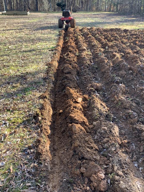

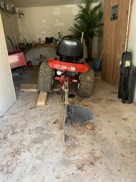

Greentored 3,221 #167 Posted February 27, 2020 I snuck out of work early and went to work on this plow issue. Set it up on 6” of blocks. 1. Landslide was WAY too high. I kinda knew this but it wasn’t digging deeper. Although the hydraulics had more travel, the rock shaft and chain were in a bind, preventing the plow from dropping fully. Drilled a new hole, made some adjustments, it now digs deeper AND is not dragging the ground when transporting. 2. Far too much slop/play. Bought a 5/8” pin, squared the landslide up with the wheels, and snugged the stabilizing bolts. Shes diggin’ now! Front tires are barely touching and she’s grunting a hair more. How’s the re-plow look to you guys? I do notice the ‘cut’ edge of the furrow is still not nice and vertical, and think those 10.5 tires just aren’t getting down into the previous cut enough to tip the tractor? All in all a day and night difference thanks to you plow dogs!!! 4 Share this post Link to post Share on other sites
PeacemakerJack 11,060 #168 Posted February 28, 2020 Looking much better! I love the fact that you took the tractor back to the “drawing board” started from square one and rechecked and reset everything. Honestly, I’ve had to do that a couple of times over the years even with one of my tried and true plow mules. I’ve gotten into a field that was particularly hard to plow and I messed around with so many adjustments hoping to make it plow better...In the end it wasn’t my rig, the conditions just weren’t good for plowing and no matter how much adjustment or finagling that I did, it still wouldn’t plow good. Tom @Shynon said it a couple pages back, when conditions are like that, don’t radically adjust your plow, it won’t do much good. All in all @Greentored it looks much better and more complete. You still have a little trail of dirt up on the landside that I’m not sure how it is getting there without a video of the plow in action. The furrow looks much sharper and more square. Well done for a second stab at it! You’ll be a plow dog in no time...I can tell it😉 3 Share this post Link to post Share on other sites

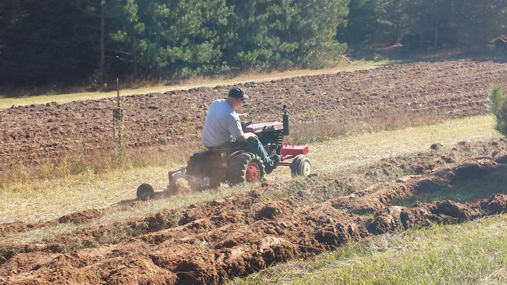

PeacemakerJack 11,060 #172 Posted February 29, 2020 I don’t know if we posted this picture before (circa 2018) but my man @Achto took this one and I love it! Plowing conditions that day weren’t good at all but we were still having fun. My youngest, Zach, is such a plow dog that he was willing to even walk and observe the furrow quality, or lack thereof. This last fall, he was plowing and I was walking the furrows behind him... they grow up fast! 6 Share this post Link to post Share on other sites
