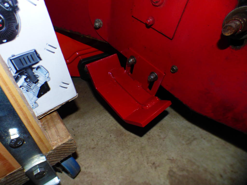

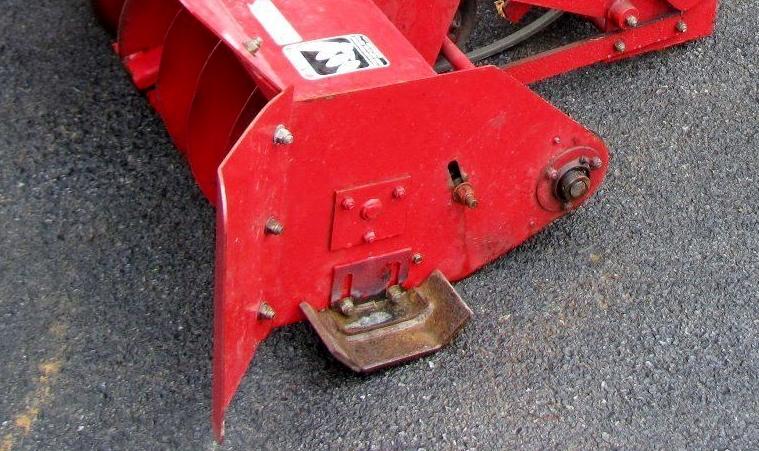

shallowwatersailor 3,213 #4 Posted September 2, 2018 (edited) I'm originally from Illinois and use to spend summers when I was a kid in Durand. My step-son currently lives in Ashland so I am familiar with your snow conditions. I never have had a two-stage snowblower for a 5xi but given the fact that you don't have PS might be a drawback. One thing I will suggest is not to use ags. I bought my 523Dxi with a pair of loaded ags installed. Because they were loaded, I thought that they would provide decent traction. I kept them on the first season but had to be careful with loss of traction at times. Turfs with metal chains ( because you have gravel) would be the best. Another improvement would be to install a wider skid shoe. My single-stage snowthrower had them and I really think they would work even better on gravel. Plus a couple of my videos of thew 523Dxi. Edited September 2, 2018 by shallowwatersailor 2 1 Share this post Link to post Share on other sites

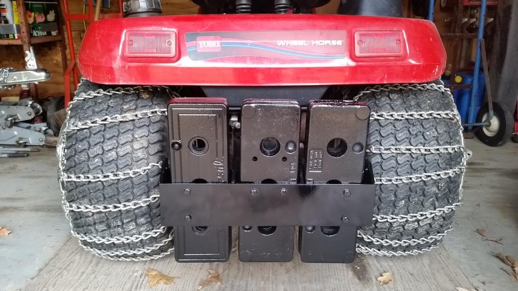

stumplifter 8 #5 Posted September 3, 2018 15 hours ago, gwest_ca said: 4 different model numbers for the 520xi so don't want to lead you astray. Go into our manuals section and look for your tractor model. There will be a D&A file there for it and the A is the attachment list. There is a 42" single stage snowthrower and a 44" 2-stage snowthrower. The 2-stage requires a rear hitch on the one I looked at. Once you find the model number of the snowthrower you can go to them and download the manuals for it. If you need help post your tractor model number and serial number. Garry Thanks Garry, It is model # 73542 sn 200000204. @shallowwatersailor awesome videos, the cab feature is smart. Currently with our atv it is a snow suit, Sorel's and a headsock. Last time out I almsot had to don my full faced motorcycle helmet to keep the snow spray off my glasses. @peter lena I ass-u-me the extra weight in the back assists with traction? Thanks all for the quick replies and solid advice! Share this post Link to post Share on other sites
gwest_ca-(File Mod) 10,444 #6 Posted September 3, 2018 Click on the picture Garry 1 Share this post Link to post Share on other sites
