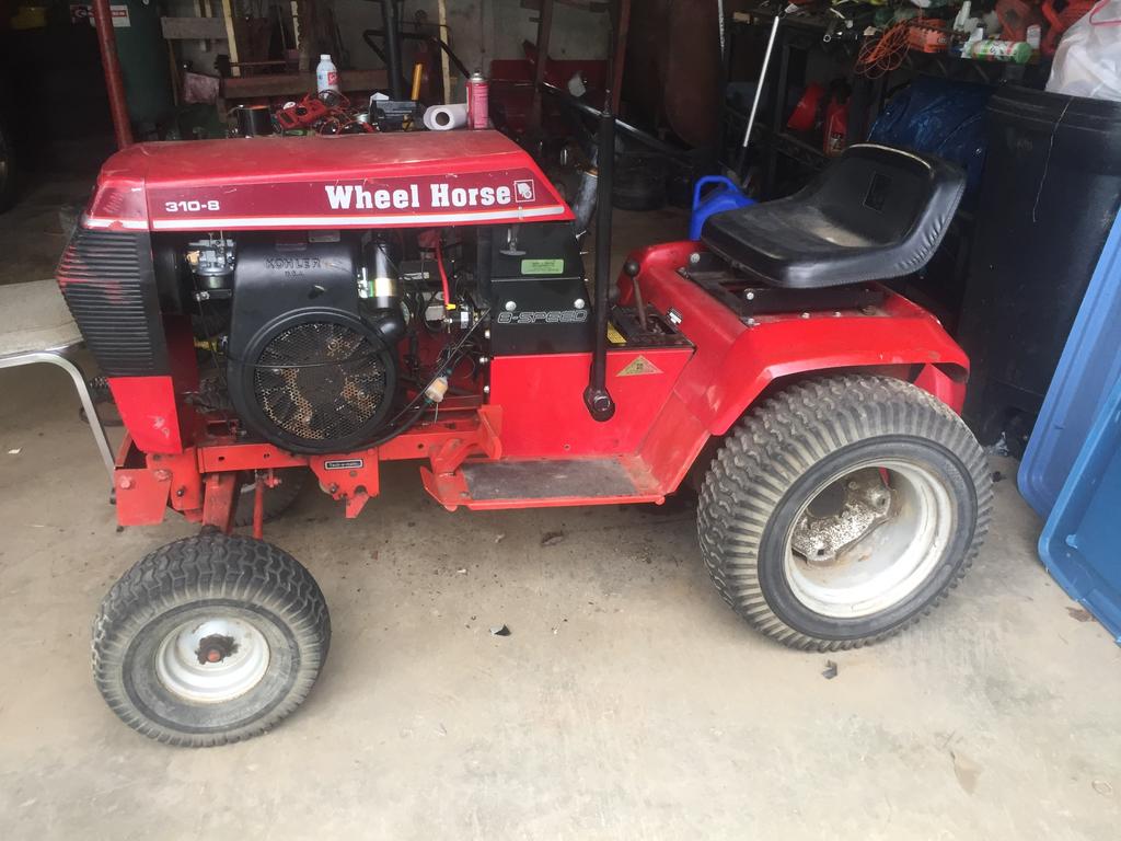

FatJackDurham 318 #1 Posted September 1, 2018 (edited) I finally got the 310-8 running. PTO switch was the issue. I bought this tractor with another for $100, hoping to turn it around and sell it, as the previous owner obviously didn’t care enough about it. It was badly dinged up, no starter, sitting at the bottom of his yard. I straightened the metal, got a starter, replaced the carb, coil, condenser and points, fixed the PTO switch, replaced the interlock and seat switch, and not it runs strong and seems electrically sound. Total investment, not including purchase, About $170. With the $50 purchase, $230. Now, the first time I put it in drive, it doesn’t move. Before I consider doing anymore work on this, I have to ask for advice. Should I pul the plug? I don’t need this tractor, I have a 416-8, a 520H and a GT14 that are my working tractors. I was hoping to put a deck on this and sell it, but now I need to replace the bearings on the deck I was going to use. I don’t think I can get more than $350 for this tractor with a clean deck in this area. There is a 310-8 with a deck and wagon for sale nearby for $275, that’s not moving. I could try selling parts out of it. It’s got a good engine, seat, and a couple other items. The body tin is not bad, I could swap it out on my 416 which looks like shiste. Or, I could sell it here for cost to someone that wants to pick up the banner or who wants one of this model for their collection. Give me your thoughts on this. Edited September 1, 2018 by FatJackDurham Share this post Link to post Share on other sites

gwest_ca-(File Mod) 12,483 #3 Posted September 1, 2018 Don't throw the towel in yet. Start it one more time and put it in low gear. Be ready to control it if it happens to take off. Get under the right footrest and see if the driven transmission pulley is spinning on the input shaft. Next check the ends of each axle to see if an axle is spinning in the hub. There is a Woodruff key at each location and only one has to fail to lose all drive. May be the reason it was parked in the first place. Garry 1 Share this post Link to post Share on other sites
953 nut 69,120 #4 Posted September 1, 2018 Yep, a good buy is only a good buy if it fills a need for you or there is a prospect of turning a profit. I have to agree with jim on the greatest return being as a parts tractor. 2 hours ago, FatJackDurham said: I put it in drive, it doesn’t move. Check the clutch spring and belt. Could be a key like Garry said. I would put it up on jack stands to check the things garry is talking about. 1 Share this post Link to post Share on other sites
buckrancher 2,697 #5 Posted September 1, 2018 Check all of the above suggestions and be sure the hi and low range lever is in gear as the tractor will not move if you are not in hi or low range brian 2 Share this post Link to post Share on other sites

gwest_ca-(File Mod) 12,483 #7 Posted September 1, 2018 Have another thought. The dog-point set screw goes into a hole in a donut shaped ring on the shifter. The donut can be welded or secured to the shifter rod by a roll pin. If the weld or pin break it allows to donut to rotate on the shifter rod. When that happens all you are doing is rotating the shifter because of the bend in it. It won't select a gear. If you pull the boot up you will see the top of the donut. See if the shifter rod will turn in the donut. It should not. Garry Share this post Link to post Share on other sites

FatJackDurham 318 #13 Posted September 3, 2018 On 9/1/2018 at 7:23 PM, gwest_ca said: Have another thought. The dog-point set screw goes into a hole in a donut shaped ring on the shifter. The donut can be welded or secured to the shifter rod by a roll pin. If the weld or pin break it allows to donut to rotate on the shifter rod. When that happens all you are doing is rotating the shifter because of the bend in it. It won't select a gear. If you pull the boot up you will see the top of the donut. See if the shifter rod will turn in the donut. It should not. Garry YOu win the prize! Total repair cost $0.52! Thanks! 3 Share this post Link to post Share on other sites
