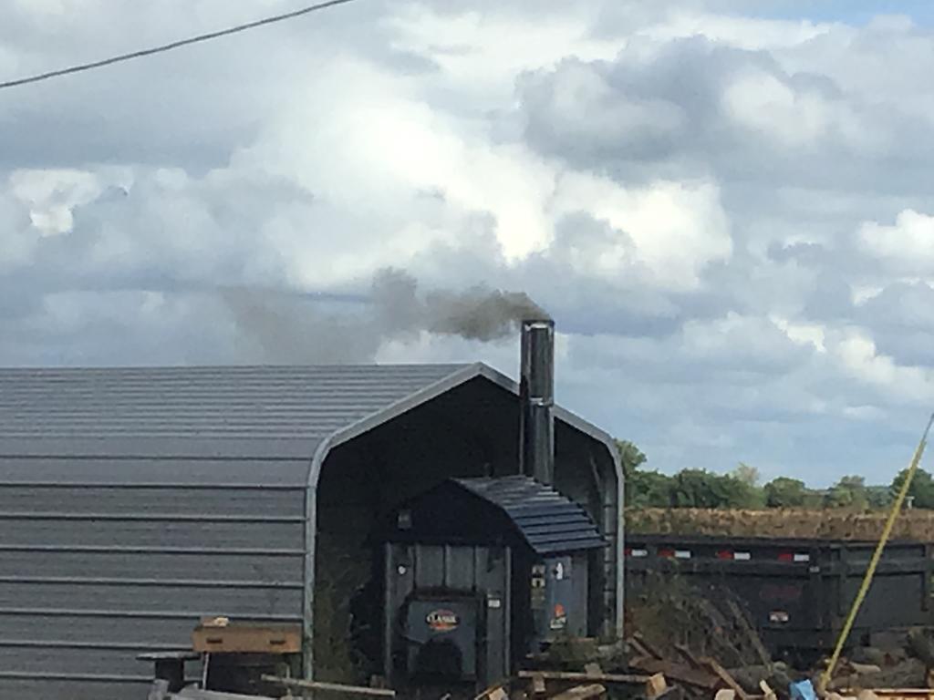

MikMacMike 494 #52 Posted November 26, 2019 On 9/25/2018 at 3:44 PM, pullstart said: Test run... a sign that fall really is here. This is the only day until mid Oct. that it looks like we’ll see temps over 70. I’ll run the boiler up to 150 while I’m out cutting wood for the next 2 or 3 hours, then check everything out in the firebox and surrounding. Now this is the ticket....expencive but whaaaaa, not only the shop but it'll heat the house too. A buddy of mine has one heating his Farm house and shop, he just put in the underground lines to the pool pump and next spring it'll be hooked to a full size underground pool. 1 Share this post Link to post Share on other sites
