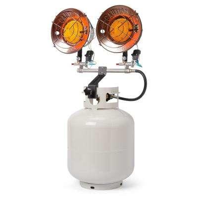

Retired Wrencher 7,019 #19 Posted August 27, 2018 (edited) The 24x24 years ago was fully insulted with 5/8 fire code sheet rock because it was joined with the house. I have a two burner and a three burner. the three burner has a 40lb tank and the two has a 20lb tank. I have had all kinds of heaters over the years I have found these to really well. No smell you clothes do not smell and the are easy to use. I use the three burner to warm up the garage then switch to the two burner to maintain the heat. I all so have two 48" celling fans reversed to keep the heat down to the floor. I use a grill ignitor to ignite the heater. Edited August 27, 2018 by Retierd Wrencher 1 Share this post Link to post Share on other sites

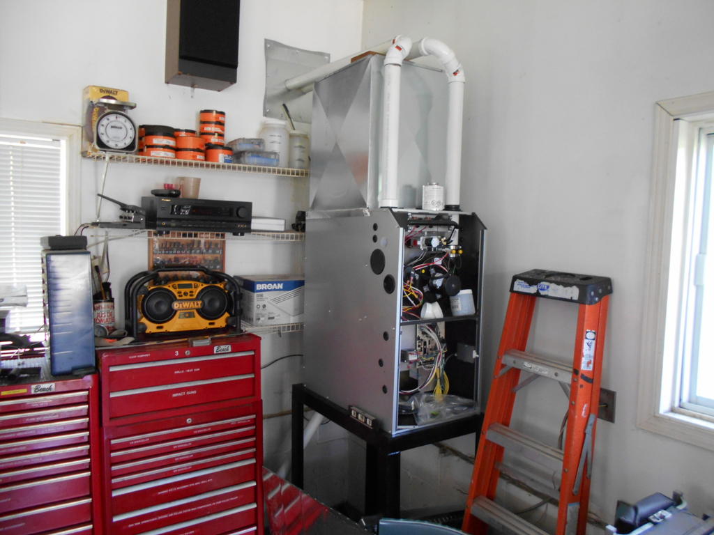

cleat 9,390 #23 Posted August 29, 2018 I had new propane furnaces installed in the house and shop last year to replace oil furnaces. They are high efficiency direct vent units. House unit sits just on patio stones on the basement floor. Garage furnace sits up on a steel frame that I made up to keep the fire up the proper amount to meet code. Also the garage furnace needed to be bolted down where the house furnace just sits on the floor. Here is the furnace being installed. Cleat 2 Share this post Link to post Share on other sites
