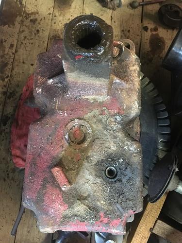

Mike in NC 342 #14 Posted August 28, 2018 Here is a pic of the case. Share this post Link to post Share on other sites
stevasaurus 23,861 #15 Posted August 29, 2018 That, my friend, is an 8 speed. From the information I can find...it is an 8 speed #5073 because of the 10 pinion LSD. Your brake drum is on the cluster gear shaft. 1 Share this post Link to post Share on other sites
