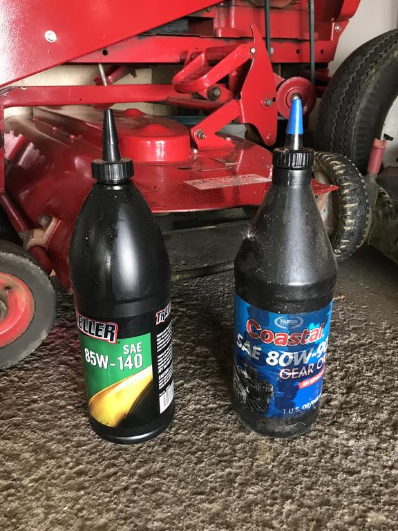

Al C. 1,474 #1 Posted August 20, 2018 This year I changed the brand of oil I’m using in my Wheel Horse 1067 8 - speed transmission. I have started getting small leaks around the rear axle seals - about a teaspoon of oil a month. Can it be related to the new brand of oil? I had formerly used Coastal and Lucas SAE 80W-90 Gear Oil with no problem. This year I’m using Traveller SAE 85W-140. Any thoughts? Share this post Link to post Share on other sites

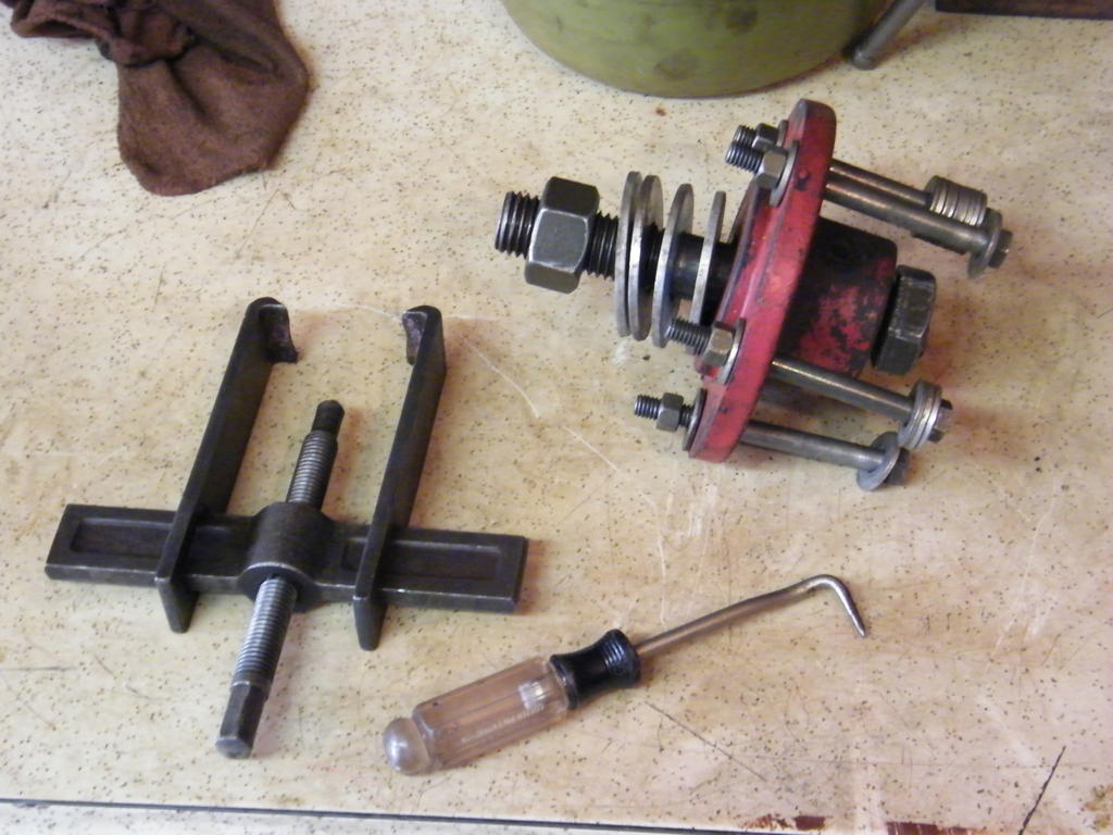

stevasaurus 23,763 #12 Posted August 21, 2018 I use a tool that is used to pull out carter pins. remember the seal is only 1/8" thick. Tool is lower right. I would try to tap the hubs inward 1st and try to file the end of the axle, rather then try to pull the hubs over any burrs. Share this post Link to post Share on other sites
Al C. 1,474 #13 Posted August 21, 2018 Steve, I really appreciate this! I get the tool you improvised for pulling the hub. Help me with the tool in the lower left of the picture. What do you use it for? (First-timer, here!) Share this post Link to post Share on other sites
pfrederi 20,924 #14 Posted August 21, 2018 cotter not carter 1 1 Share this post Link to post Share on other sites

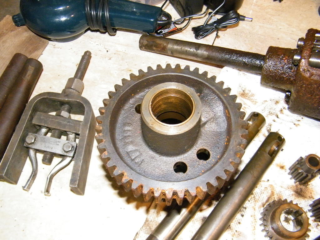

953 nut 67,657 #15 Posted August 21, 2018 7 hours ago, Al C. said: Help me with the tool in the lower left of the picture. What do you use it for? It is a bearing puller that can be used from the inside or outside of small bearings. Share this post Link to post Share on other sites
stevasaurus 23,763 #16 Posted August 22, 2018 It's a Carter Pin removal tool...the other was a TV show...Welcome Back Cotter. The other puller is a little large for pulling bearings...it is more for pulling hubs, brake drums, and pulleys. Here is an old time bearing puller..left of the bull gear. Here is a video of it doing it's thing. Share this post Link to post Share on other sites
