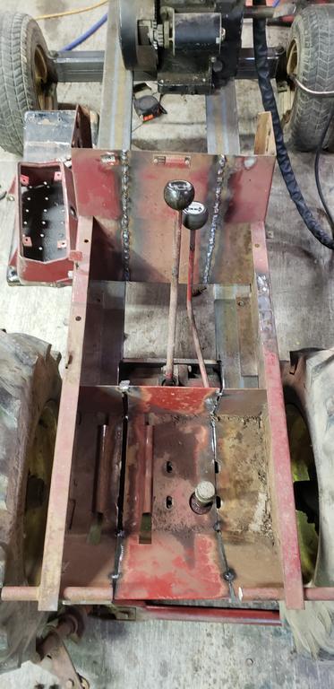

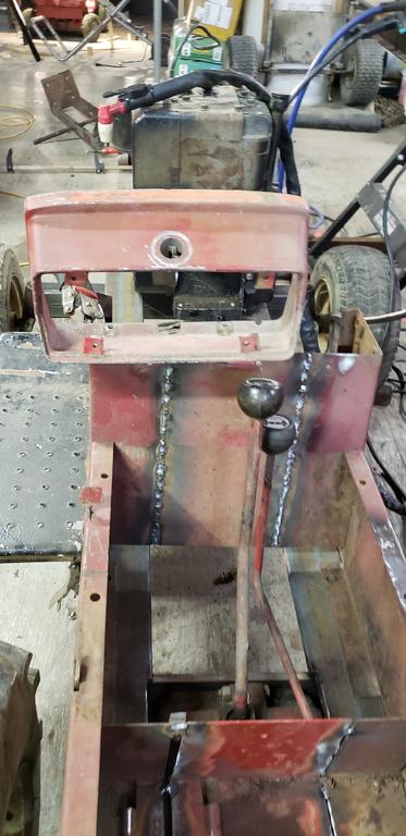

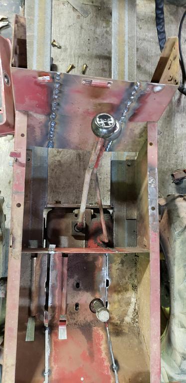

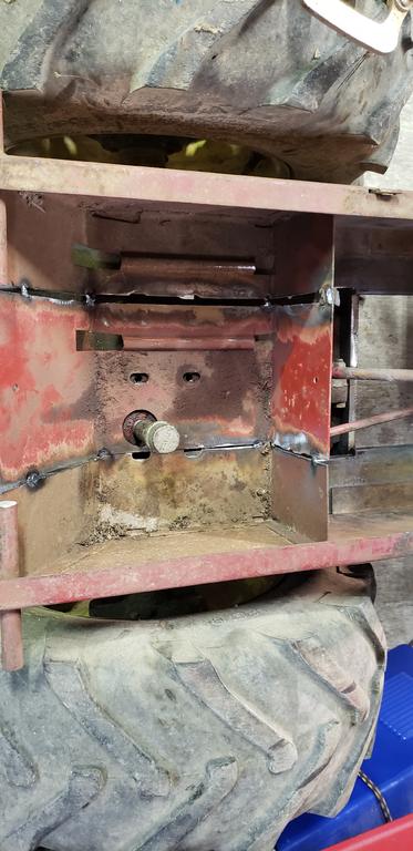

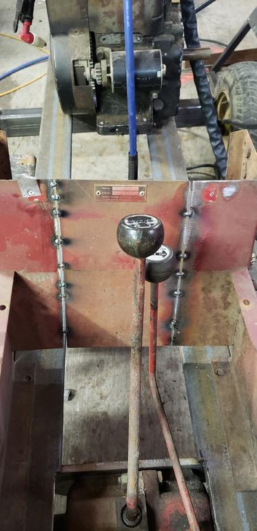

redbeard22 123 #61 Posted August 23, 2018 Got a little bit done 2nite added some pieces in to widen the center console. I know there is big gaps between the pieces but i have a piece of thick copper strapping to clamp behind and i can fill that in with the mig welder and grind it all smooth. Should look factory when im done. Anyone have any suggestions on widening the dash piece? I have 3 of them so i though of cutting a little off the end of 2 of them and having them welded together and drill a new hole for the steering shaft. If anybody has a better idea throw it out there. 1 1 Share this post Link to post Share on other sites
WHX?? 58,327 #62 Posted August 23, 2018 Cut the dash strait down the middle, then bolt the two pieces up to the right and left hood stand. Get a dim from there for the center line then cut the center from the extra dash to match the finnish cut of the bolted and cut dash. This may or may not mach the dims of the tunnell & hoodstand widening. Easy peasy assuming you have the moxy to weld AL AND the dash is weldable aluminium?? This would also give you dims for widening the hood. Smart guy would at this point allow for some kind of center upper dash bearing support for HD steering. 1 Share this post Link to post Share on other sites
redbeard22 123 #63 Posted August 23, 2018 6 hours ago, WHX20 said: Cut the dash strait down the middle, then bolt the two pieces up to the right and left hood stand. Get a dim from there for the center line then cut the center from the extra dash to match the finnish cut of the bolted and cut dash. This may or may not mach the dims of the tunnell & hoodstand widening. Easy peasy assuming you have the moxy to weld AL AND the dash is weldable aluminium?? This would also give you dims for widening the hood. Smart guy would at this point allow for some kind of center upper dash bearing support for HD steering. Sounds like a good plan to me. Although i can weld aluminum none of my welders are set up for aluminum so that is going to be outsourced to one of my buddys that has a nice tig setup. As far as a bearing support goes i plan to use a steering colum from the john deere 112 that i got a few other parts off of. It has an outer sleeve with a bushing atbthe top for the actaul steering shaft to ride against and it has a nice gearbox type action on the bottom side.i dont think the traditional wheelhorse steering gear setup would be enough for this size of a tractor unless i had a gear reduction unit like on a 520 or similar. Hopefully tonight i will get back out to the shop and see what else i can get done. I think the next step is to get the dash widened and that will give me the dimension of the hood at the rear and locate the top of the steering colum. 3 Share this post Link to post Share on other sites

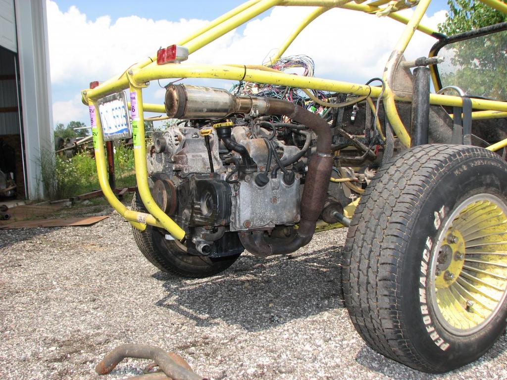

FatJackDurham 318 #64 Posted August 23, 2018 On 8/20/2018 at 8:50 PM, dells68 said: Catch one of the Harbor Freight 22hp Predators on sale and you'll never regret it. They are powerful and very stout! Only thing is they don't have thrust bearings on the crank. Not an issue if you don't need a PTO. If you do, you could always go the electric route. I out one in Emory's Christmas tractor and it is a beast. What do you mean about the thrust bearings on the crank for the PTO? Do you mean that if you use a manual PTO, it pushes the crank into the engine in an unhealthy way? And why would an electric PTO not do the same? Share this post Link to post Share on other sites

Sarge 3,473 #66 Posted August 23, 2018 If you plan to weld that aluminum dash - make sure the tig is capable of a lot of ac balance control, you'll need as much cleaning action as possible. I've welded up a few that were badly worn from the hood latch eating into them after a broken frame or dash stand, that stuff is some highly contaminated cast aluminum if I ever saw it. The more you talk of this build, the more I'd like to make one, lol. I considered at one time repowering a Work Horse with a Suzuki 1.3L Samurai engine - weighs less than the twin opposed K-482 and pulls 48hp. Not to mention a rpm range north of 7,000rpms, lol. Very small engine footprint, all aluminum and a ton of fun parts available. Sarge 1 2 Share this post Link to post Share on other sites
FatJackDurham 318 #67 Posted August 23, 2018 (edited) 53 minutes ago, pullstart said: I believe Kohler and Onans have a bearing designed for side load on the crank. A hydraulic pump or pto would not place the side load, like the traditional WheelHorse belt drive does. But in your photo ,you have a drive belt on. Doesn't that produce side load? Plus, I thought a thrust bearing was for endplay, like in a VW engine, not side load, although it does make sense that any belt driven motor would require bearings that could stand up to side load. Edited August 23, 2018 by FatJackDurham Share this post Link to post Share on other sites
redbeard22 123 #68 Posted August 23, 2018 47 minutes ago, Sarge said: If you plan to weld that aluminum dash - make sure the tig is capable of a lot of ac balance control, you'll need as much cleaning action as possible. I've welded up a few that were badly worn from the hood latch eating into them after a broken frame or dash stand, that stuff is some highly contaminated cast aluminum if I ever saw it. The more you talk of this build, the more I'd like to make one, lol. I considered at one time repowering a Work Horse with a Suzuki 1.3L Samurai engine - weighs less than the twin opposed K-482 and pulls 48hp. Not to mention a rpm range north of 7,000rpms, lol. Very small engine footprint, all aluminum and a ton of fun parts available. Sarge Thanks for the info i know welding aluminum can be a pain especially dirty low grade stuff, the suzuki engine sounds like a cool idea but would you mount it sideways or inline with the frame. If inline it would need some kind of right angle gear box or something but im sure i would have plenty of room for a small engine like that. Who knows by the time this project is done it mite have something like that mounted in the engine compartment. Did they make those engines carburated? I dont want to mess with a computer and huge wiring harness. Trying to keep it simple and reliable. 1 Share this post Link to post Share on other sites

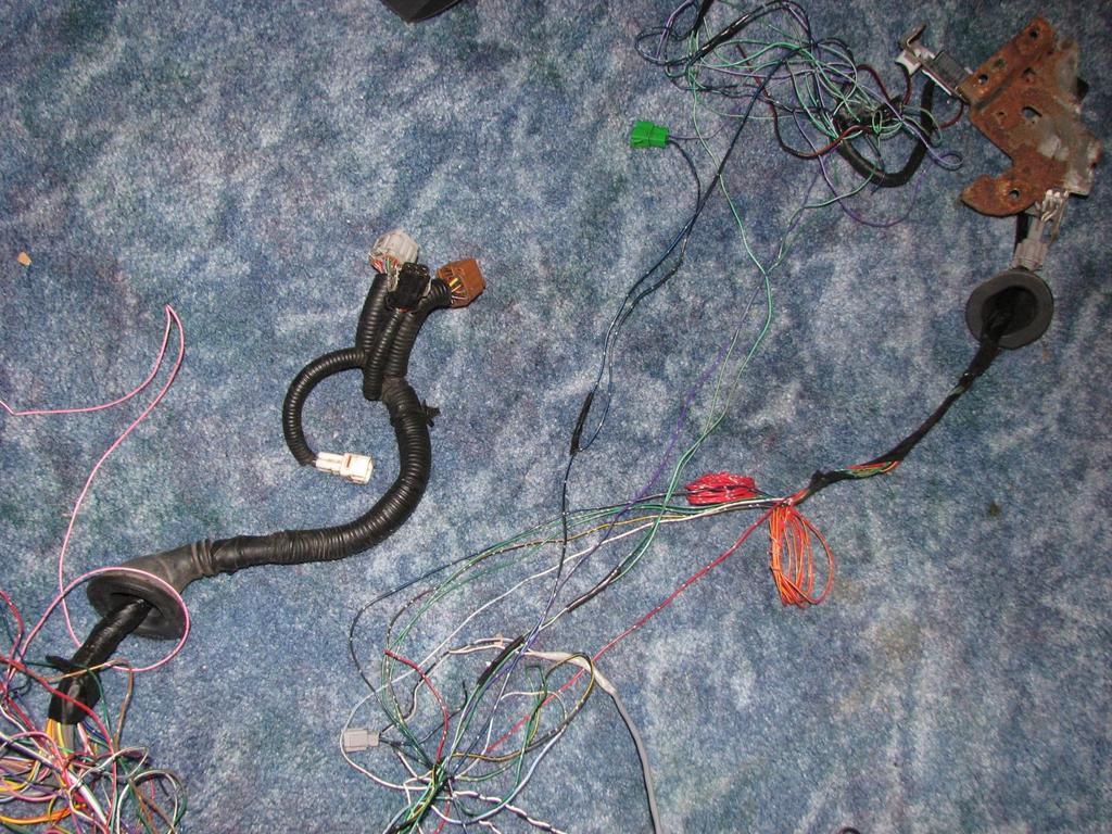

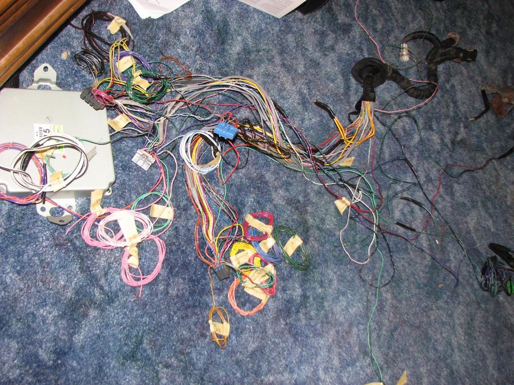

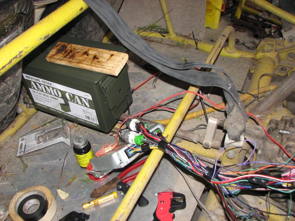

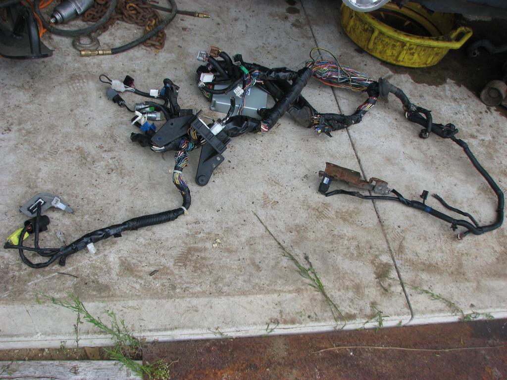

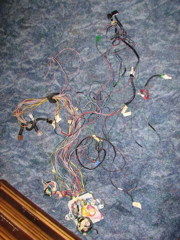

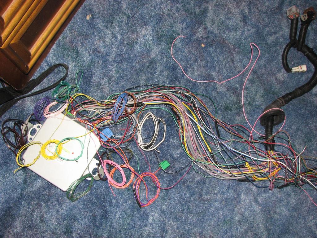

Pullstart 71,482 #69 Posted August 23, 2018 Modifying a harness isn’t all that complicated... if you take your time. Cut all the connections you don’t need, then trace the wires back through the harness and pull them out. I learned from a YouTube guy named Mick, his screen name is Busaru. I know it doesn’t apply to WheelHorse directly, but here are some snips of my wire harness hack in the buggy that may apply to a custom engine swap. 1 Share this post Link to post Share on other sites
Pullstart 71,482 #70 Posted August 23, 2018 48 minutes ago, FatJackDurham said: But in your photo ,you have a drive belt on. Doesn't that produce side load? Plus, I thought a thrust bearing was for endplay, like in a VW engine, not side load, although it does make sense that any belt driven motor would require bearings that could stand up to side load. Im not sure about the photo, I don’t have any Predator powered tractors at the moment. I do however have the 22 hp engine on my log splitter and it’s quite amazingly smooth! Share this post Link to post Share on other sites

WHX?? 58,327 #72 Posted August 23, 2018 43 minutes ago, FatJackDurham said: But in your photo ,you have a drive belt on. Doesn't that produce side load? Plus, I thought a thrust bearing was for endplay, like in a VW engine, not side load, although it does make sense that any belt driven motor would require bearings that could stand up to side load. I kinda think you are missing the power transmission boat here Fat Jack. The drive belt does not put a side load on the crank end (pushingthe crank toward the flywheel) A electric PTO does not either. A traditional WH PTO does. Nice work Kev, first pics looks like you got a real rat's nest there but it cleaned up. I assume the electronics is in the ammo box? 2 minutes ago, redbeard22 said: 22hp on a log splitter Really! you splitting Ironwood!?!? Share this post Link to post Share on other sites
Pullstart 71,482 #73 Posted August 23, 2018 I probably didn’t help with my explanation @WHX20, I think @FatJackDurham had the point but I didn’t. So the side load is essentially end play in the crank, that a traditional pto loads in OEM applications then? The harness work took about 3-5 days in the bedroom on the floor, before it made its way back to the shop. It all ended up in the ammo box, out of harm’s way. I tend to find mud and water quite often with my toys, I was trying to protect it from... well, me! The splitter I acquired with an 18 hp Briggs engine, with a magneto that powers foot or switch controls that run the ram in and out. The hp designation is surely overkill, but the charging ability was what I was after when the Briggs gave up the ghost. But yeah, it’ll split anything it wants ta’! (Add a Tim Allen grunt here) 1 Share this post Link to post Share on other sites
