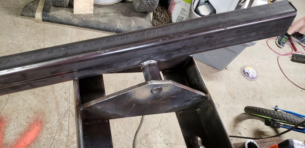

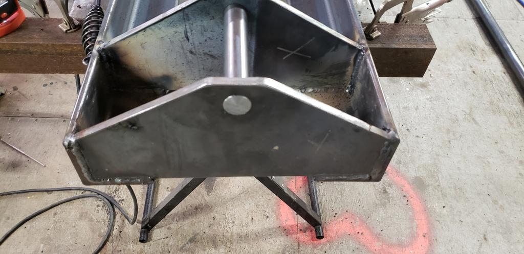

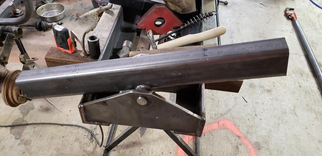

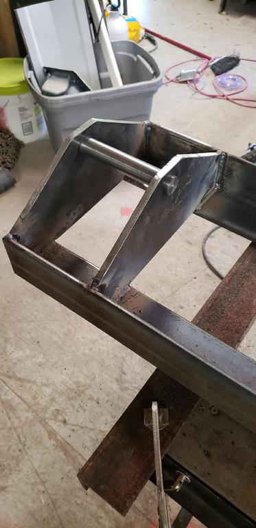

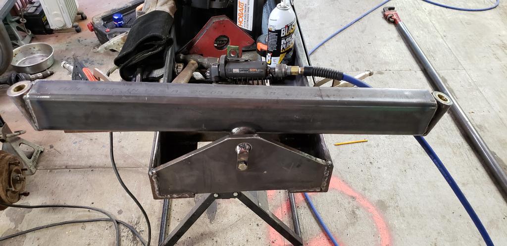

redbeard22 123 #8 Posted August 19, 2018 here is the front of the frame where the front axle attaches. the frame is 3x3 angle iron 3/8 thick the plates for the front axle are 3/8 thick and the axle pin is 1in 1 3 Share this post Link to post Share on other sites

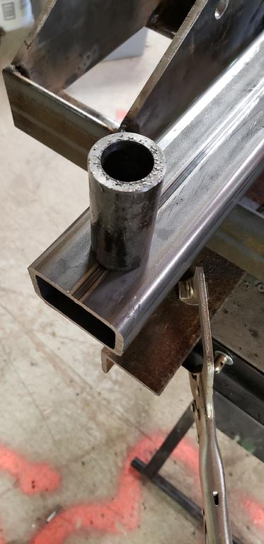

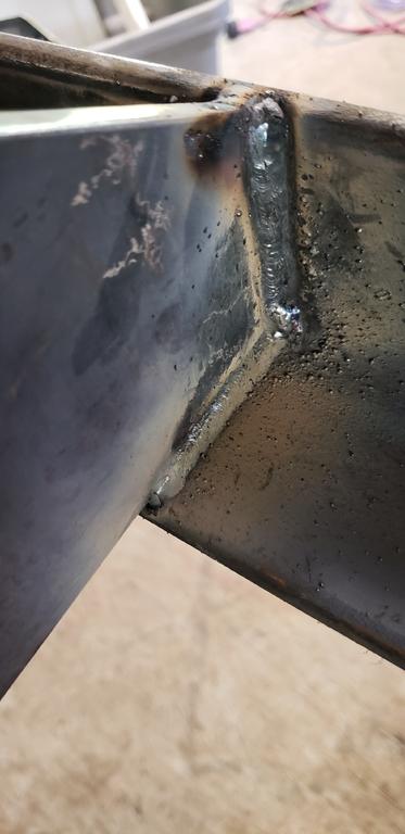

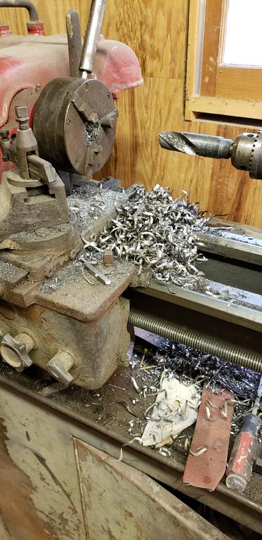

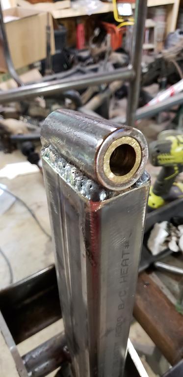

redbeard22 123 #10 Posted August 19, 2018 ok here we go now we are in business, I threw in a pic of my old clausing lathe from the late 40's early 50's before they were bought out by atlas I believe . its a model 100 mk1 I believe because the mk2 and mk3 had a quick change gear box for threading things mine has interchangeable gears on the end instead. anyway you can see the sleeves I bored out of 1.5 solid bar for the spindle shafts to fit into and I turned some nice brass bushings that were press fit into the sleeves so I don't wear out the sleeves or spindle shaft. I will be adding grease zerks on the sleeves before the project is complete. I will be using a set of spindles off a john deere 112. everything on this new frame has been welded with a Lincoln ac225 buzzbox with 7018ac rods. I am trying to base this frame design off of the tractors that have an angle iron frame this one is just going to be heavier duty. I plan to have hydraulics for a snow plow and 3 point hitch. if anybody has any questions or ideas lets hear it. hopefully later today I will have the plate don't and welded on to bolt the 6 speed trans in and I can have it setting on the tires and see what its gonna look like. 2 8 Share this post Link to post Share on other sites

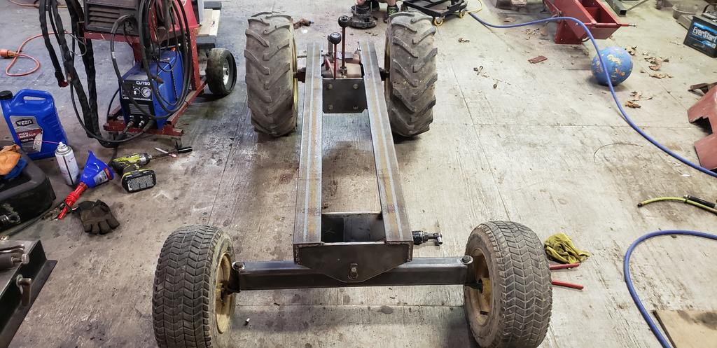

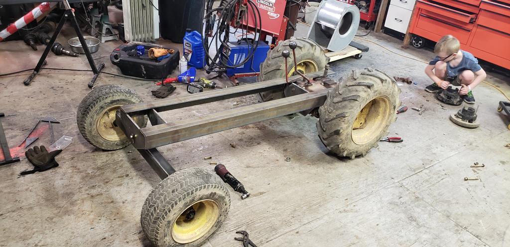

redbeard22 123 #15 Posted August 19, 2018 Ok i have an update got the plate for the transmission made and welded in bolted up a trans and slapped some tires on it. 9 1 Share this post Link to post Share on other sites

redbeard22 123 #17 Posted August 19, 2018 Now the front is 43 inches to thebbn outside of the tires which is rite where i wanted to be about the same as a d250 i think they are 44 but the back does not have the correct wheels and tires that i will be using i dont have them yet. I plan to use 26x12-12 on the rear probably bar tread as i will be using this tractor in the woods to pull my small dump trailer for firewood. Once i get the correct tires on the rear the frame will sit perfectly level front to back. Next is figuring out what to do about the sheetmetal. I was thinking of widening the original center console and dash to the new width of 13 inches but not sure how comfortable that will be. I will also be stretching and widening a hood and adding running boards 2 1 Share this post Link to post Share on other sites
redbeard22 123 #18 Posted August 19, 2018 The while objective behind this build is to have a tractor the size of a d250 or john deere x700 series. I saw one of the jd x700 at a local fair and liked the size but about had a heart attack when i saw the price. So here i am building one. I got all my dimensions from tractor data and found a d250 to be almost the same size as a x700 so i referenced dimensions from both. The choice of material for the frame was easy. Wheelhorse had a tough simple design that they stuck with for many years because it worked so all i did was figure since its going to be a bigger heavier duty tractor so should the frame so i just used angle iron and plate that i thought would be good enough to handle the job. 5 1 Share this post Link to post Share on other sites
