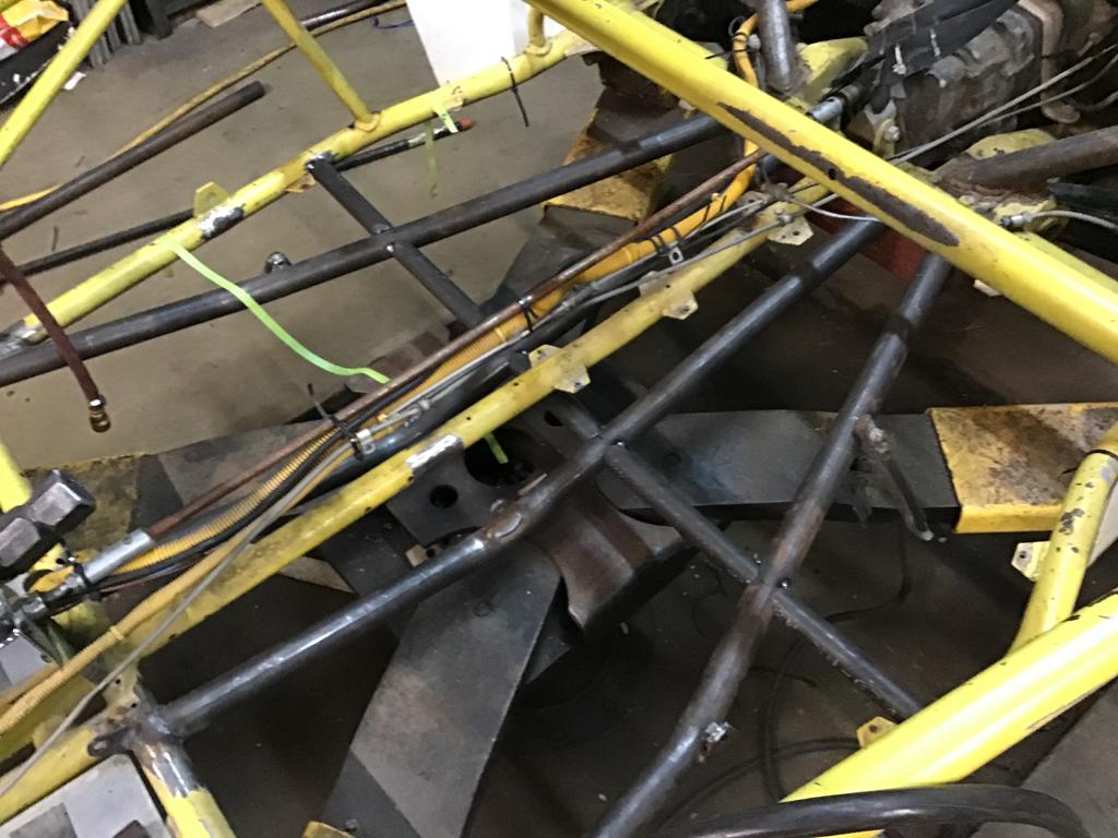

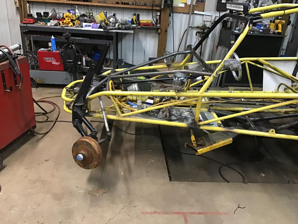

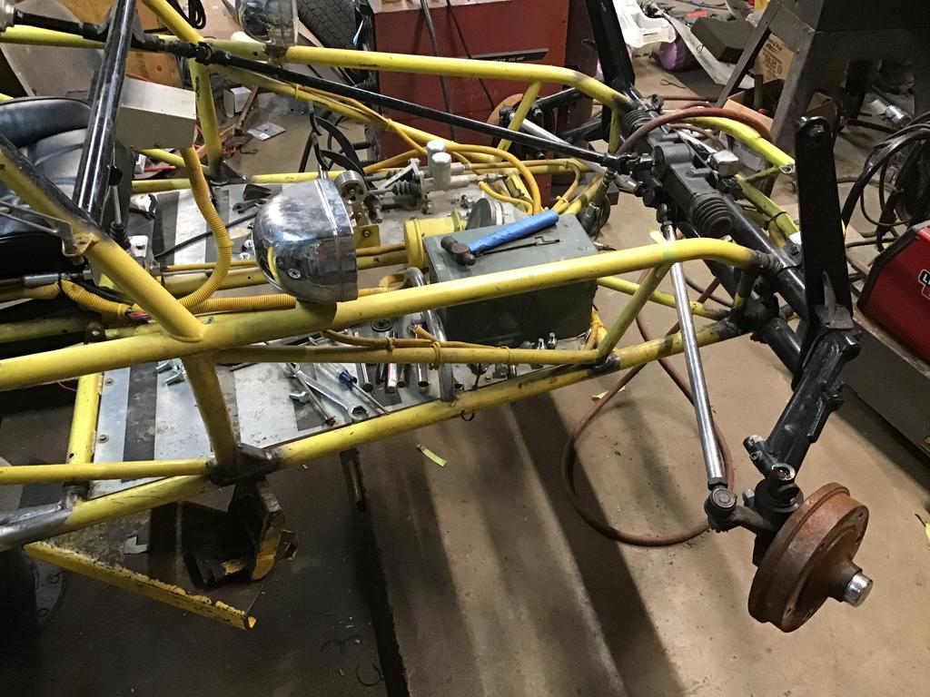

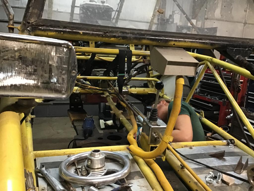

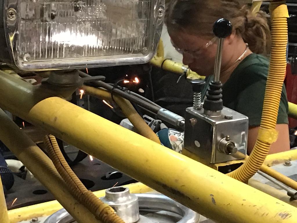

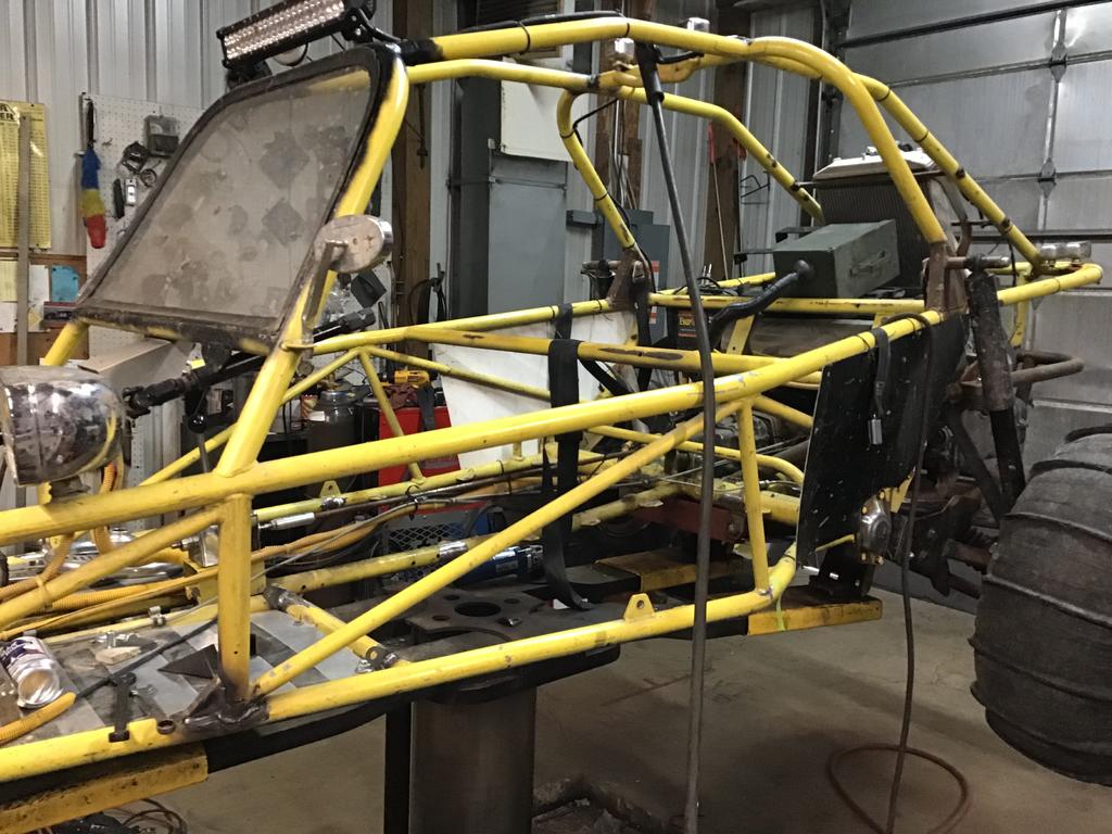

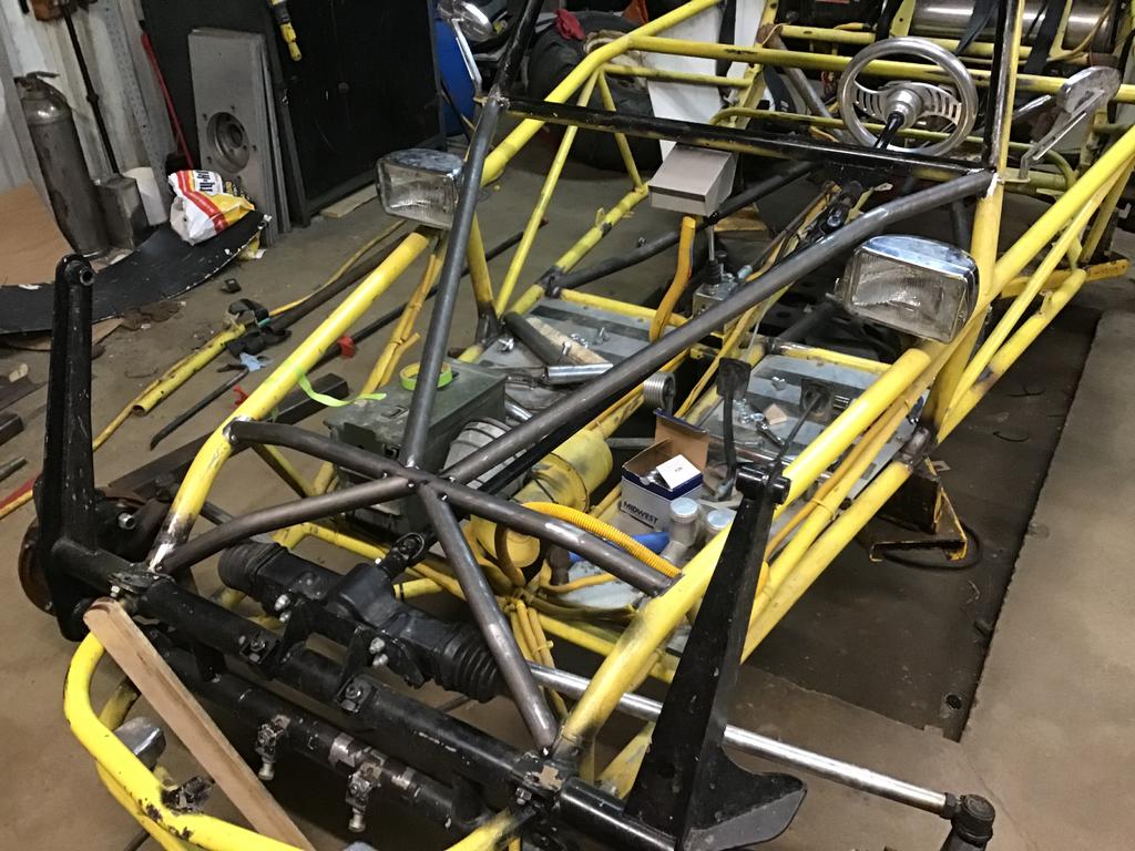

Pullstart 70,874 #1 Posted August 7, 2018 Taking a “bathroom break” for a couple days, on account of good behavior I suppose. My German kid Jil is in town for 3 weeks and she hasn’t been on the buggy for a couple years, since the suspension and Subaru upgrades. Well, I thought I had a couple cracks to take care of, ends up after I took the side panels off and started looking around, I don’t know how the front end hasn’t broken off the car! Doing a bunch of repairs this week, along with reinforcement to transfer power and suspension shock through the chassis a little better. After all, the car was built for about 40 horsepower, now there’s about 165 ponies out back. Everywhere that has green tape, along with some other prepped areas, need repairs. We are also prepping for the replacement front seats, going from fiberglass molded seats to suspension seats and 5 point harnesses. It’s good to have help in the shop this week! 9 1 1 Share this post Link to post Share on other sites
Pullstart 70,874 #2 Posted August 8, 2018 Oredered 2 sticks each of dom tubing yesterday through my father in law’s work, 1-1/2 .080 wall and 1-1/4 .065 wall. That should help get this thing a little more rigid! 2 Share this post Link to post Share on other sites

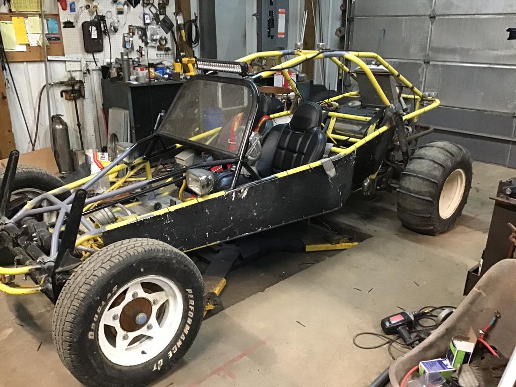

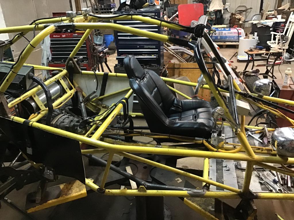

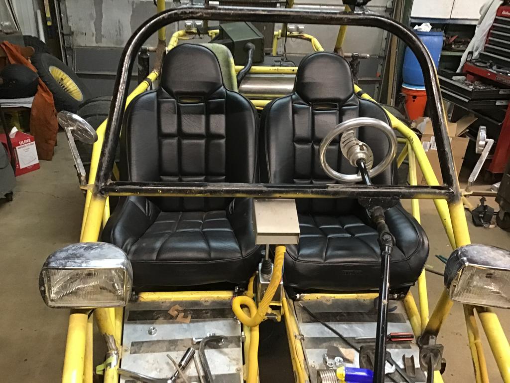

Pullstart 70,874 #3 Posted August 8, 2018 Seats are gonna fit, but they are snug! Driver’s side is mounted, passenger side front mounts are in but I wanted to verify fit. 1 Share this post Link to post Share on other sites

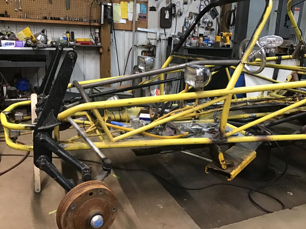

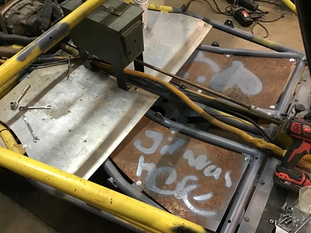

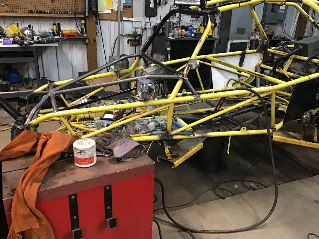

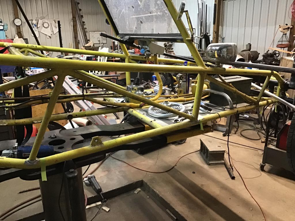

Pullstart 70,874 #4 Posted August 8, 2018 Three of the four main tubes for the seat mounts are in! I am mounting the rear of the tubes as close to the trailing arm mounts as possible to help transfer power through the chassis in a stronger way... or is the plan! I’m waiting on the tube order to come in to finish the 4th bar. 3 Share this post Link to post Share on other sites

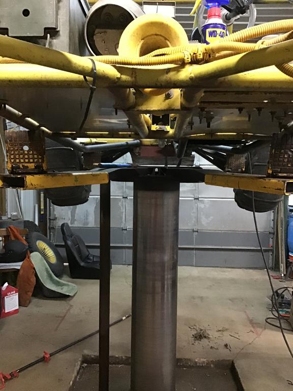

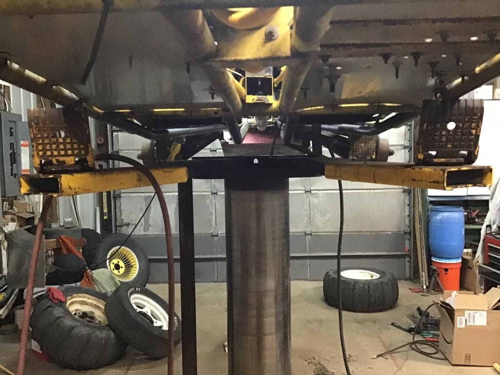

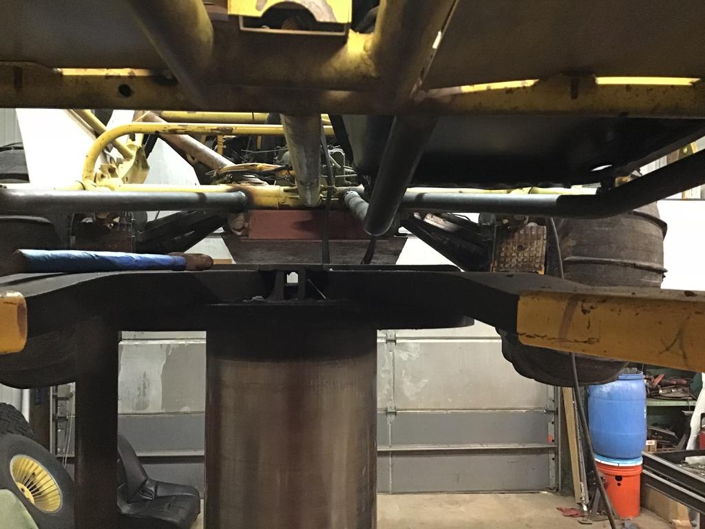

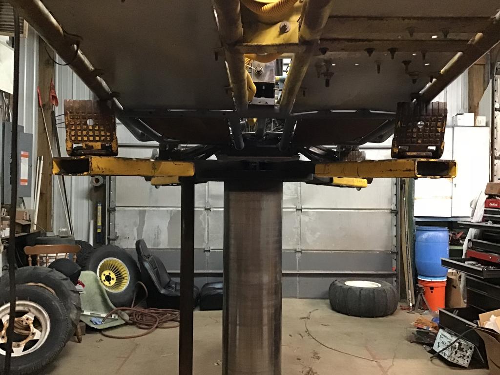

Pullstart 70,874 #5 Posted August 8, 2018 Everything hanging down will receive a steel skid plate too! 1 Share this post Link to post Share on other sites

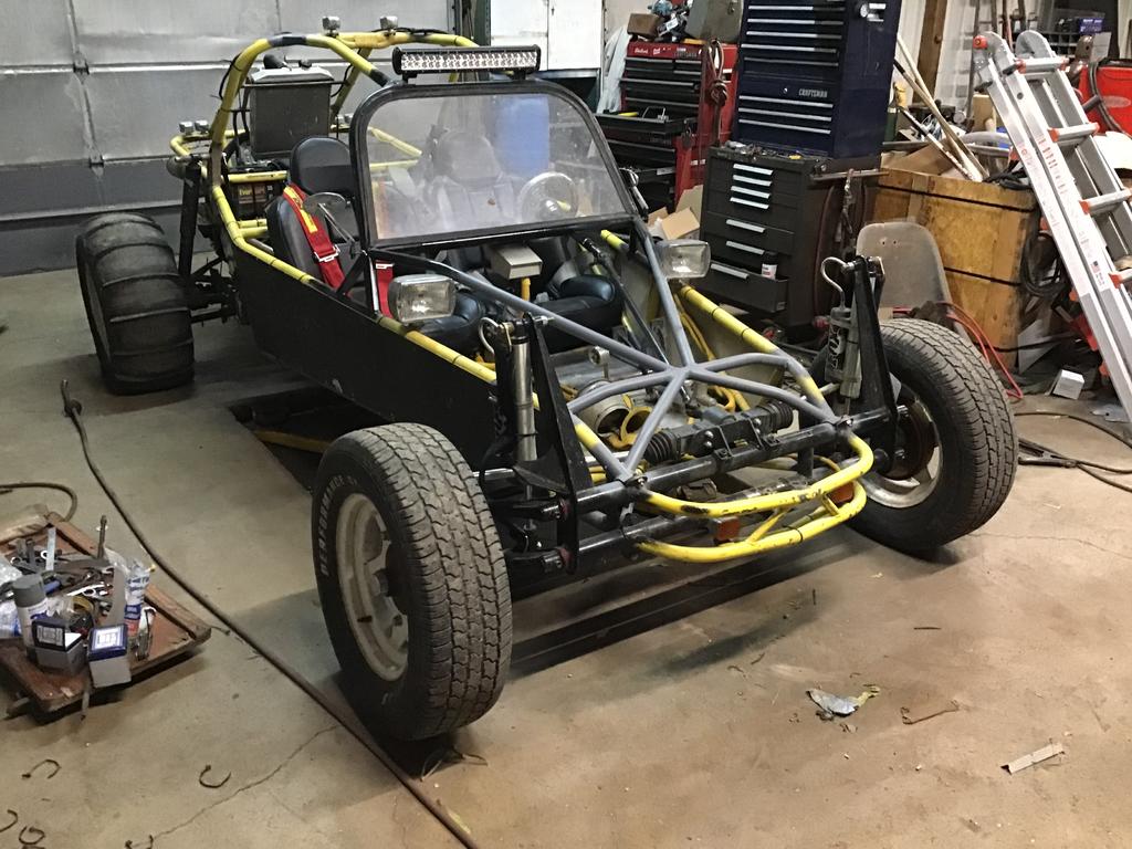

Sparky-(Admin) 26,018 #6 Posted August 8, 2018 That thing looks like a blast! Is that your shop? With a lift? Jealous 2 1 Share this post Link to post Share on other sites
Pullstart 70,874 #7 Posted August 8, 2018 Yeah, we bought the place a year ago from my in laws. He builds race cars, so the shop is wired for machines and welders, heated, cooled nd a lift! 2 1 Share this post Link to post Share on other sites

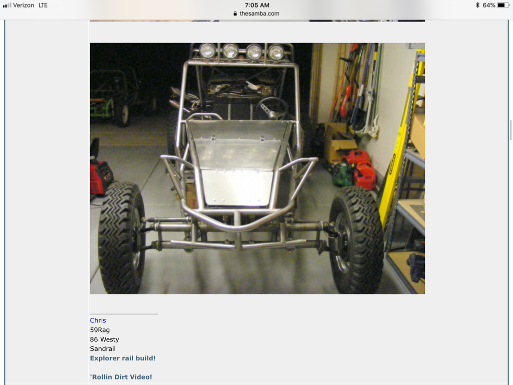

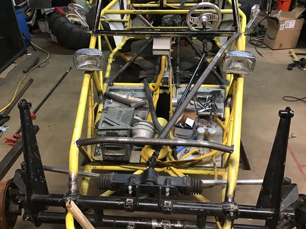

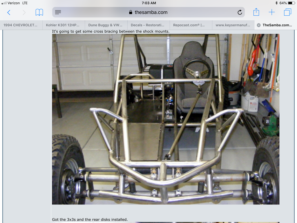

Pullstart 70,874 #8 Posted August 9, 2018 I think I have all the cracks welded... and now waiting for more tubing to come in. I found a rail online that I really like the basic front brace design, so I think I’ll do something similar. The yellow one is mine, the really nice one is not! Share this post Link to post Share on other sites

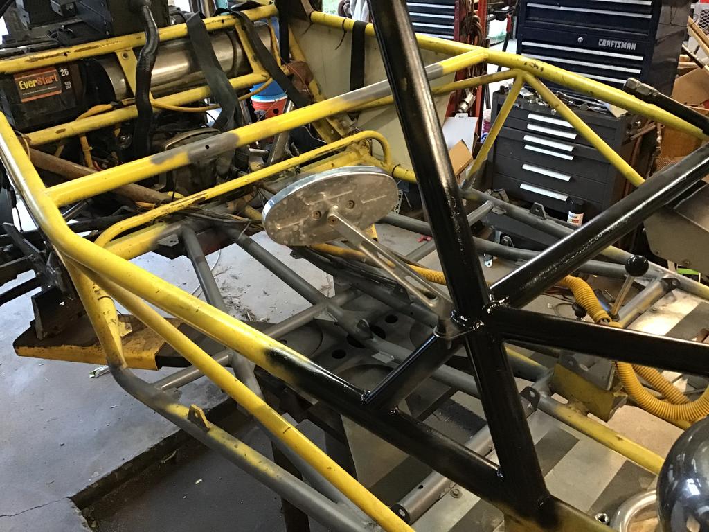

Pullstart 70,874 #15 Posted August 14, 2018 Got the last seat mount tacked in today Share this post Link to post Share on other sites

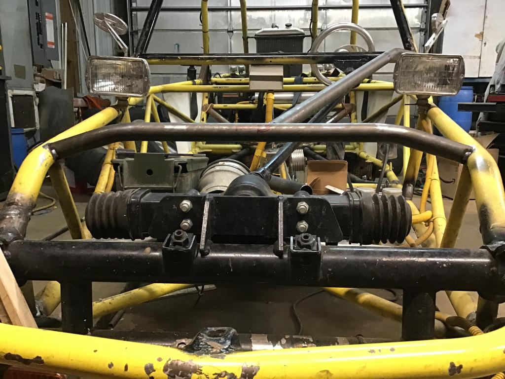

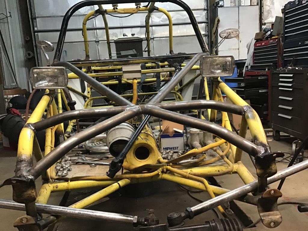

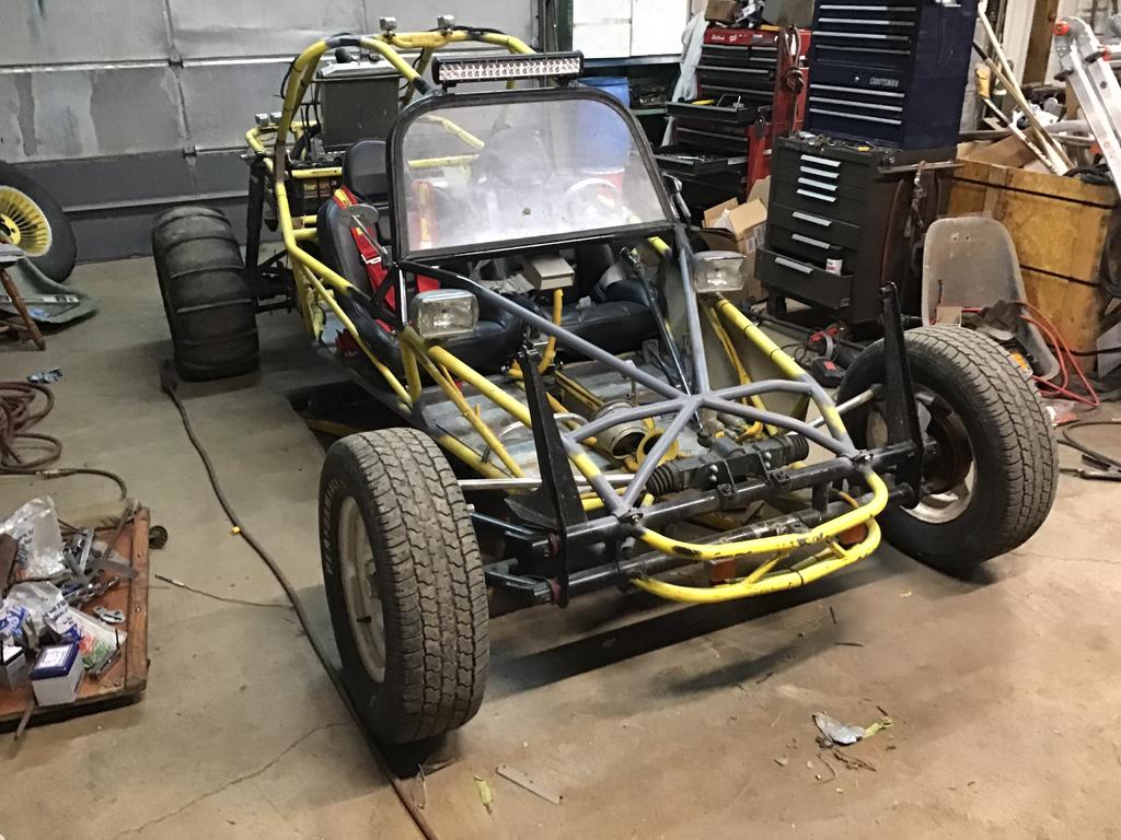

Pullstart 70,874 #16 Posted August 15, 2018 Getting somewhere with the chassis brace... it’s not like the car I found, but the whole base design is different. This is a bit more common of a design, and it’ll work. I need go before show! 1 Share this post Link to post Share on other sites

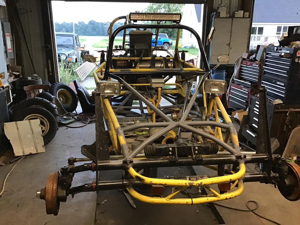

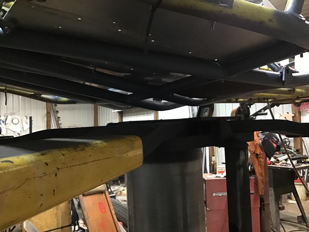

Pullstart 70,874 #17 Posted August 16, 2018 I think I’m getting the hang of this bendin’ and notchin’ thing. Tubes are tacked in, I have a couple other pieces to put in here and there, then I’ll suit up for long welding times. 1 Share this post Link to post Share on other sites
Pullstart 70,874 #18 Posted August 17, 2018 Getting closer! To do: re-run throttle cable through brake line for sheathing mounts for 5 point harnesses weld in the cross tubes Behind the seats build a floor/bottom skid plate clean/prime/paint reassembly beat the snot outta the buggy (just to test it out, ya know) Share this post Link to post Share on other sites
