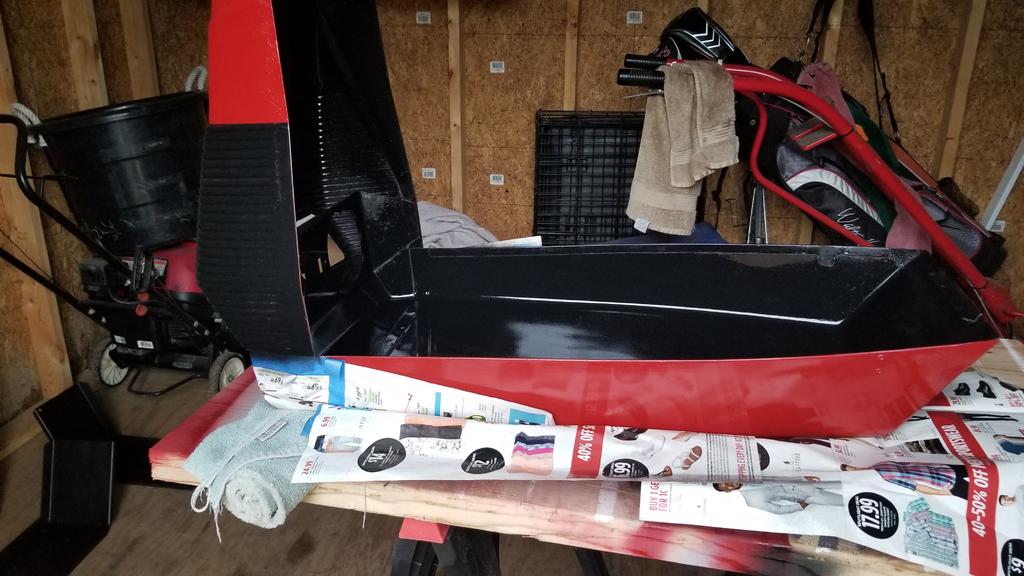

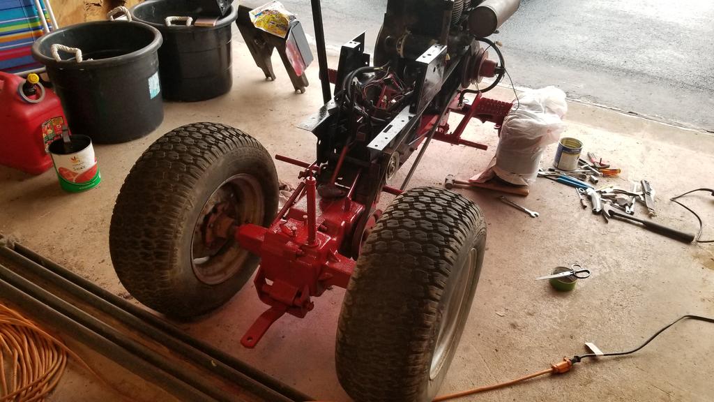

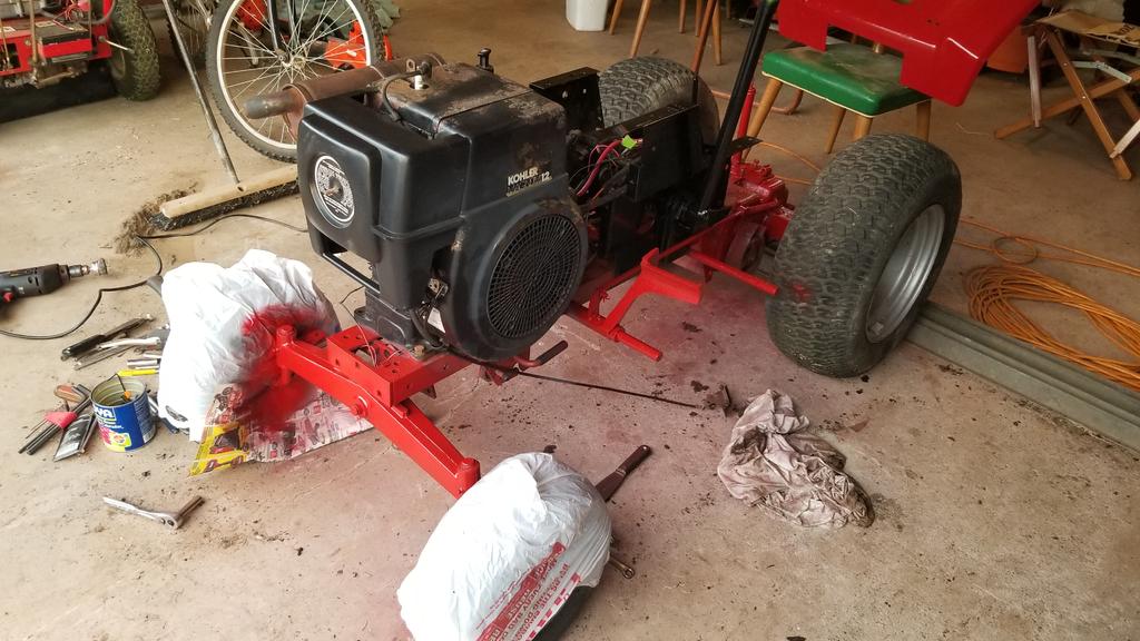

So I'm in the process of freshening up my 312-8.

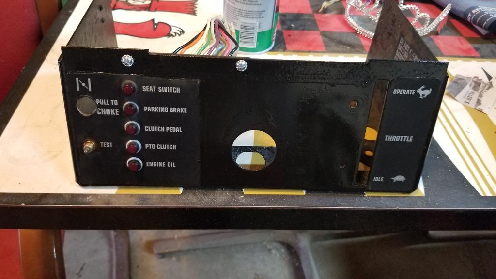

Taped off decals and gave a fresh coat of paint on dash.

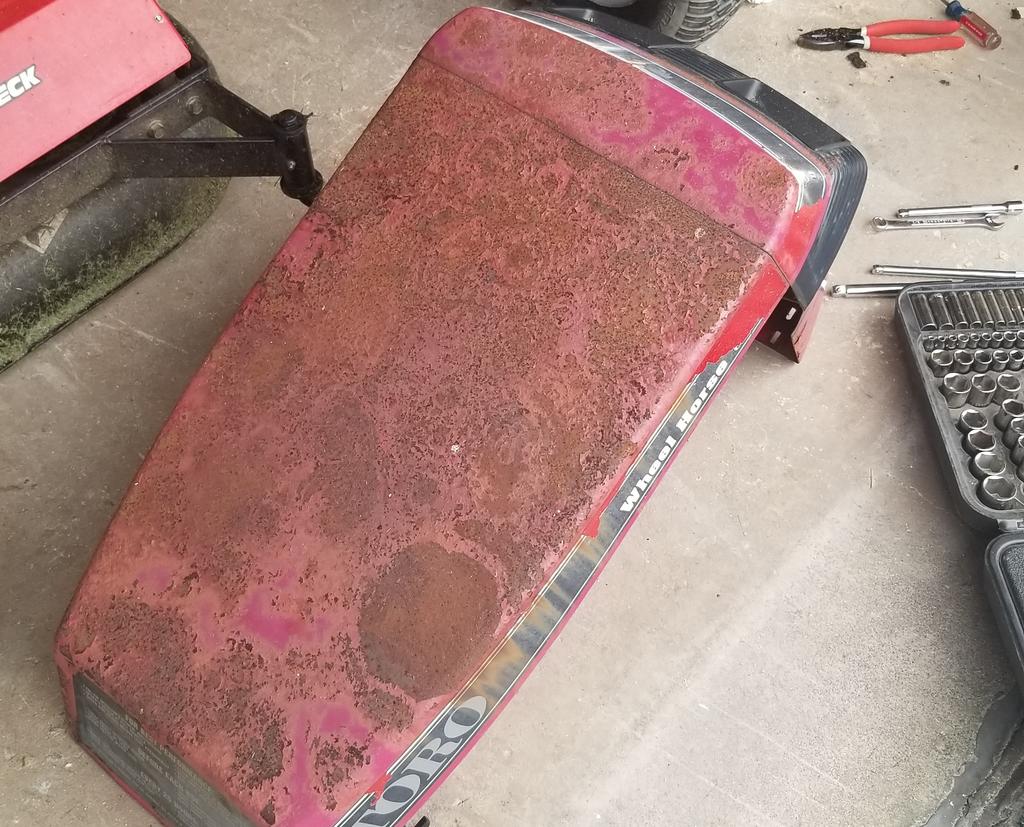

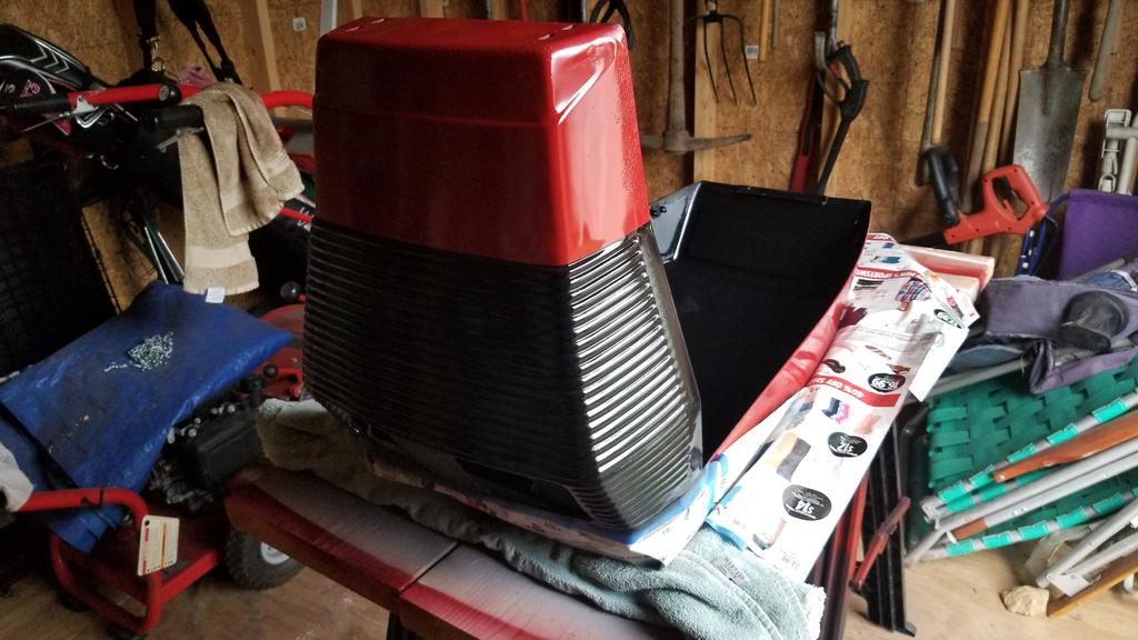

Bmaui24
Hood was a bit rough.

peter lena
good going on that refresh, that's good insurance to keep you horse up to date. In addition to detailing problem areas while open to this state , I found using flexible pneumatic tubing 5/16 to 3/8" as a wire runner really helped to eliminate  any chafing or faulting on electrical wire. also dielectric grease on wire connection areas , make things neat and secure. I used gas grille black satin finish
on my black hood, anything else was too shinny or bright. pete

Bmaui24
Thanks for the tips. Not sure how I will like the shiny. I used rubberized undercoating on foot rests and then sprayed over red. We'll see.
