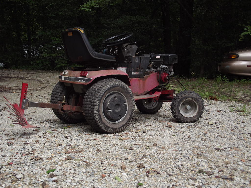

JAinVA 4,638 #10 Posted August 2, 2018 (edited) Here is the digger attached to Big Ugly. Edited August 2, 2018 by JAinVA 2 2 Share this post Link to post Share on other sites

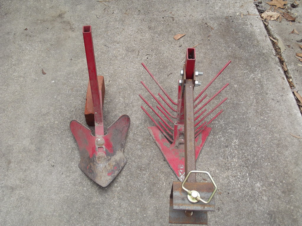

FatJackDurham 318 #14 Posted August 3, 2018 I used a rototiller attachment for the first time to break ground and mix soil for planting new grass. I had it on a 416-8. The comments about low first gear are absolutely true. It's so powerful, I was pulling up buried 3 inch cinderblocks, stones and breaking small roots. The thing jumped around something fierce, but nothing got damaged or bent and after a few passes, i upped my speed to second gear. Never used a real plow, though. What are those for? Sod busting? I'm interested in what you use to dig potatoes too. Is that what that one with the spindly tines was for? Share this post Link to post Share on other sites
