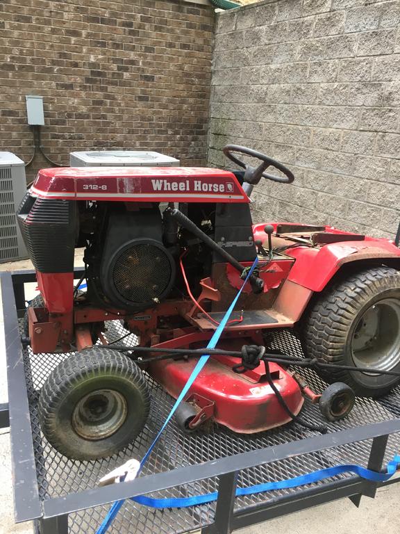

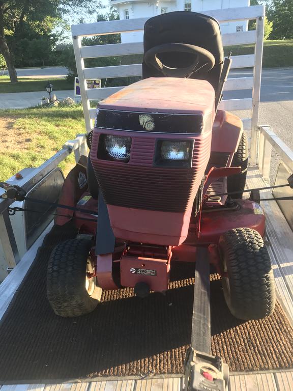

The Tuul Crib 7,354 #1 Posted August 1, 2018 Found this on craigslist the guy had two wheel horse tractors for sale. He had a 520 H and the 312-8 for $350. He wanted 150 for the 312 and when I got there it was in pretty rough shape I said no the best I can do it 100. Then he told me he was going to scrap it for 100 rather than to sell it for that . So I slowly started walking away and he said finally if you want it for hundred take it. It is a little rough but there has to be a silver lining somewhere. He still has the 520 H and it is still for sale if anyone wants it. I told him about red square here and that he should put it on the site for sale. It has a 20 horse onan and it it does run. It doesn't smoke and sounds good. 6 6 Share this post Link to post Share on other sites

The Tuul Crib 7,354 #3 Posted August 2, 2018 Yeah well I was there he tried to get it running but there was so much in the way of the flywheel and starter from rodents it wouldn't turn over. I'm gonna take it apart and clean it all out and try and start it . I feel good about that. It definitely was abused. 1 Share this post Link to post Share on other sites

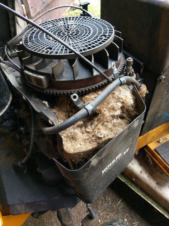

Machineguy 877 #8 Posted August 2, 2018 (edited) 11 hours ago, KC9KAS said: The ever dreaded mouse condo is probably in there! I picked up a 312-8 and the mice had eaten the spark plug wire off of the mag/coil...birty little dastards! I agree! Seems like a cowling is a magnet for them things! This was my most recent eviction! Mice suck Edited August 2, 2018 by Machineguy 1 1 1 Share this post Link to post Share on other sites
Pullstart 71,520 #9 Posted August 2, 2018 Just now, Machineguy said: I agree! Seems like a cowling is a magnet for them things! This was my most current eviction! Mice suck Doesnt look that cozy to me... maybe we should just lay a little pillow and blanket in the corner... shaped like a wedge of cheese with a mouth full of peanut butter. 1 3 Share this post Link to post Share on other sites

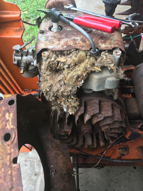

WVHillbilly520H 10,379 #10 Posted August 2, 2018 2 minutes ago, Machineguy said: I agree! Seems like a cowling is a magnet for them things! This was my most recent eviction! Mice suck Yeah I know what you mean...here's one of dad's cubs... 1 1 Share this post Link to post Share on other sites
Machineguy 877 #11 Posted August 2, 2018 (edited) @WVHillbilly520H That was an ambitious mouse there!! Quite the builder!! lol 😂 Edited August 2, 2018 by Machineguy 1 1 Share this post Link to post Share on other sites

The Tuul Crib 7,354 #13 Posted August 2, 2018 (edited) Yeah I couldn't think of this kohler going to shreds. It really would've hurt my feelings. I felt I had to step up and bring it home site on scene or running or not . And as far as the rodents go the little buggers had a huge nest ! Edited August 2, 2018 by The Tool Crib 3 1 Share this post Link to post Share on other sites

The Tuul Crib 7,354 #15 Posted August 8, 2018 OK it's been a couple of days since I brought this ole beast Home and I've been biting fingernails that it would start. Got home today new parts in the mail put them on. Points condenser and plug . Turn the key and Pa Pow! Started right up and sounds awesome! I got it to idle and rev and not a bit of white smoke out of the exhaust! Now to put the tires on it and check out the trans. Hopefully it is OK. I have heard someone say here on red square by using diesel fuel and running through the gears will help clean it out. Any ideas ? 2 1 Share this post Link to post Share on other sites
oliver2-44 11,819 #16 Posted August 9, 2018 When you drain the tranny lift up the front end to drai the oil trapped by the hump in the bottom of the tranny. Fill full with diesel and run in each gear for a while -0 minutes or so each gear. If it was really full of sludge or some water possible flush a second time. 1 Share this post Link to post Share on other sites

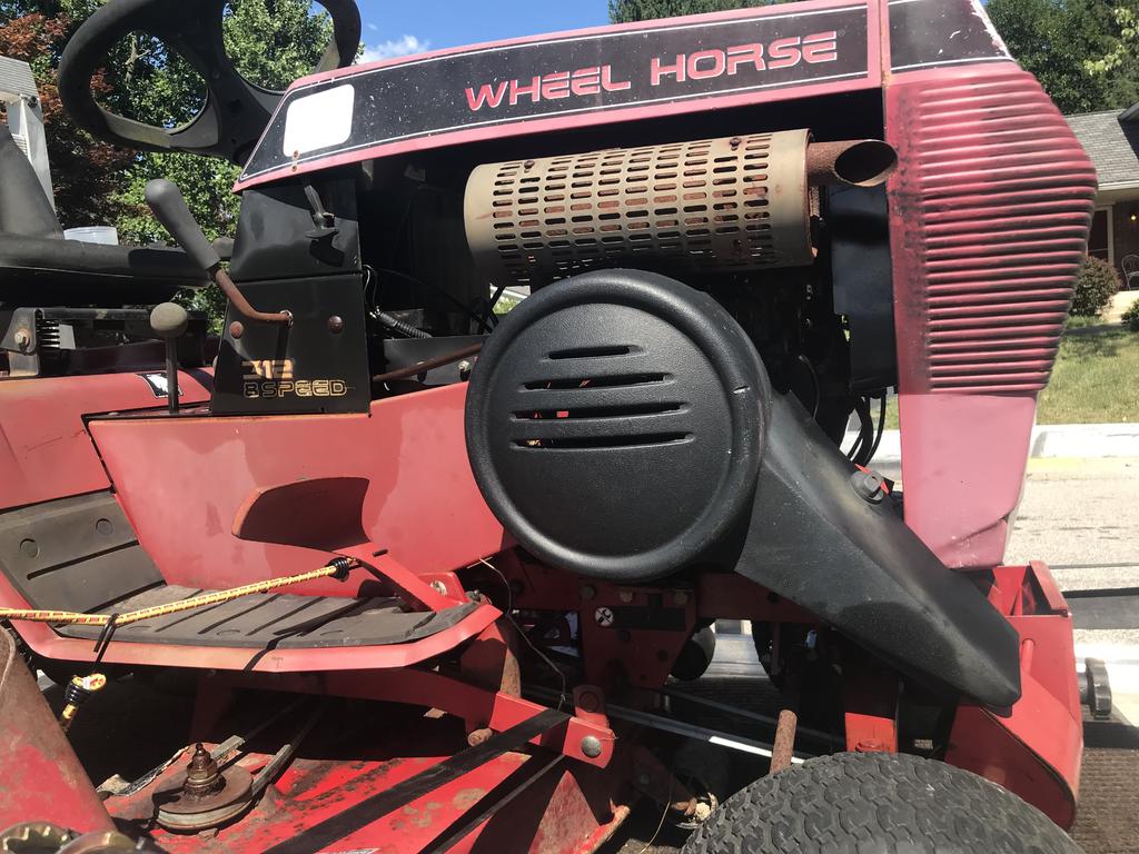

The Tuul Crib 7,354 #18 Posted August 9, 2018 What year did they start putting a cover over the clutch.? I've seen this A couple times here. Share this post Link to post Share on other sites
Lane Ranger 12,161 #19 Posted August 9, 2018 It had to be after 1993 as I have a 314 without it. Share this post Link to post Share on other sites
shallowwatersailor 3,222 #20 Posted August 9, 2018 (edited) 1 hour ago, The Tool Crib said: What year did they start putting a cover over the clutch.? I've seen this A couple times here. I believe it was 1996. The cover is there as Toro started using an electric PTO. This also required a change of one pulley and crank support due to the additional width on the single-stage snowthrower that became the 79362. Edited August 9, 2018 by shallowwatersailor Share this post Link to post Share on other sites
EricF 589 #21 Posted August 9, 2018 The plastic PTO covers definitely started in the mid-90's, as a concession to newer safety standards. (Personally, I always wondered how Wheel Horse managed to go so long without having to put a shroud over the PTO -- every other brand with a horizontal engine seemed to have one by the 1970's unless they used shaft drive!) Maybe someone can correct me, but I don't remember any electric PTOs on the 1990's standard Wheel Horses, at least not on the horizontal-shaft engines. Seems like Wheel Horse was one of the first to introduce electric PTO clutches way back in the '60s, but they kind of moved away from them as everybody else picked them up. Although the 5xi series used them again since they had the mowing reverse lockout, but those are hidden away since it's a fore-aft shaft drive engine setup. Share this post Link to post Share on other sites
