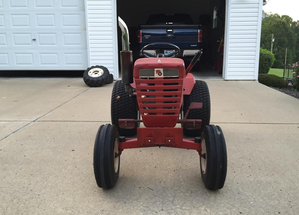

cschannuth 3,821 #4 Posted July 31, 2018 I’ve heard a lot of people dislike stacks because exhaust can blow back in your face. I have never had that experience with the stack that I put on my little rat rod. In fact it’s very short and does not interfere with anything and still I have never had any exhaust or fumes come near me that I can tell. I got my stack from Jim Kemp. They are inexpensive and heavy duty. 7 Share this post Link to post Share on other sites

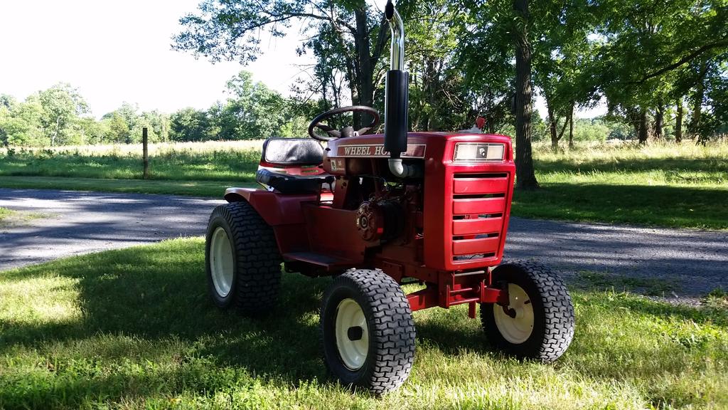

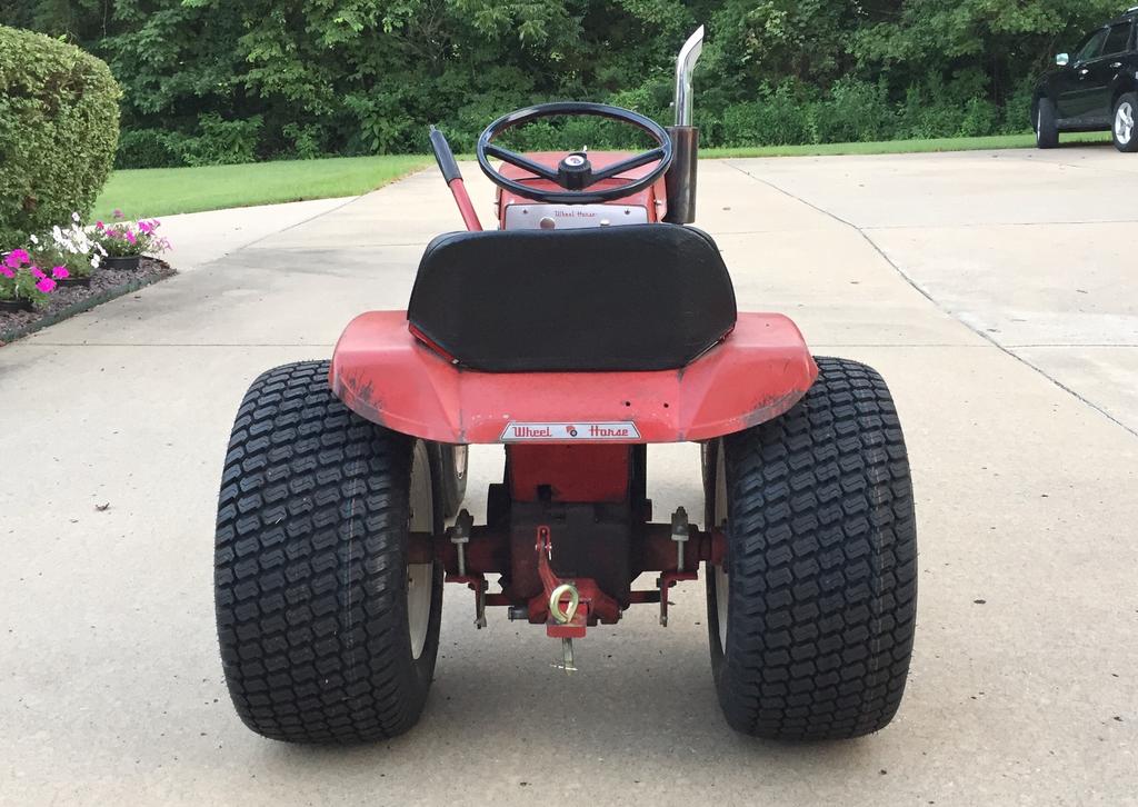

ebinmaine 81,150 #5 Posted July 31, 2018 One thing we want to be sure to mention is that if your exhaust has any extra weight to it you should put a bracket of some sort from the bottom of the pipe down to a bolt or bracket on the engine or frame to support the muffler so as not to crack the Block in the area where the exhaust goes in. Trees and bushes are definitely a concern for some. Especially those of you that use your machines to mow. We don't do that here. All of the area that we put our tractor is cleared enough that my 6 ft + tall self can walk around easily. I have a Jim Kemp Muffler here that I have yet to install on a tractor but it does appear to be very well built. The stack on my b80, Patriot horse, in the picture is sort of a home built. I made it out of a cub 10 horse Muffler and a piece of chrome drain pipe from the plumbing section. 5 Share this post Link to post Share on other sites

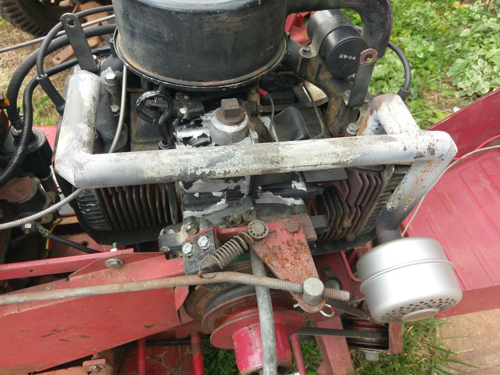

WVHillbilly520H 10,379 #8 Posted July 31, 2018 You could always go this custom route...i spotted this on a C175 Kohler twin, Jeff. Share this post Link to post Share on other sites
pfrederi 21,312 #9 Posted July 31, 2018 5 minutes ago, WVHillbilly520H said: You could always go this custom route...i spotted this on a C175 Kohler twin, Jeff. I think you would want hearing protection with that setup.... 3 Share this post Link to post Share on other sites
WVHillbilly520H 10,379 #10 Posted August 1, 2018 10 minutes ago, pfrederi said: I think you would want hearing protection with that setup.... I personally would have used one for each cylinder but I'll give the fella kudos just for actually getting it that far without cutting up the hood. 1 Share this post Link to post Share on other sites
