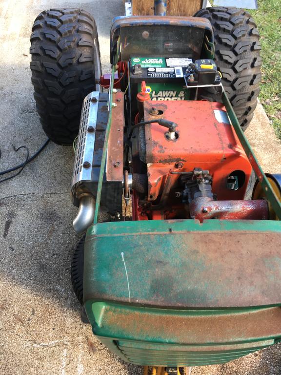

FatJackDurham 318 #1 Posted July 25, 2018 Hi, What kind of exhaust options are there for a GT-14 with the standard K321 engine? I don't think I'd like a vertical stack, though, I'd kind of like a horizontal muffler like the Onans on the 416. It'd be cool if it actually muffled the engine, too. Right now the can-thing that's hanging off the pipe doesn't really seem to make it any quieter, beyond eliminating the higher frequency pops. 1 Share this post Link to post Share on other sites

FatJackDurham 318 #4 Posted July 26, 2018 10 hours ago, Aldon said: For my GT16 Restomod I used the muffler off 400 series tractor with only slight mod to the mounting bracket. The 341 and 321 are basically same. So same set up would work on the stock GT14. Do you mean a 400 series that had a Kohler engine? Share this post Link to post Share on other sites

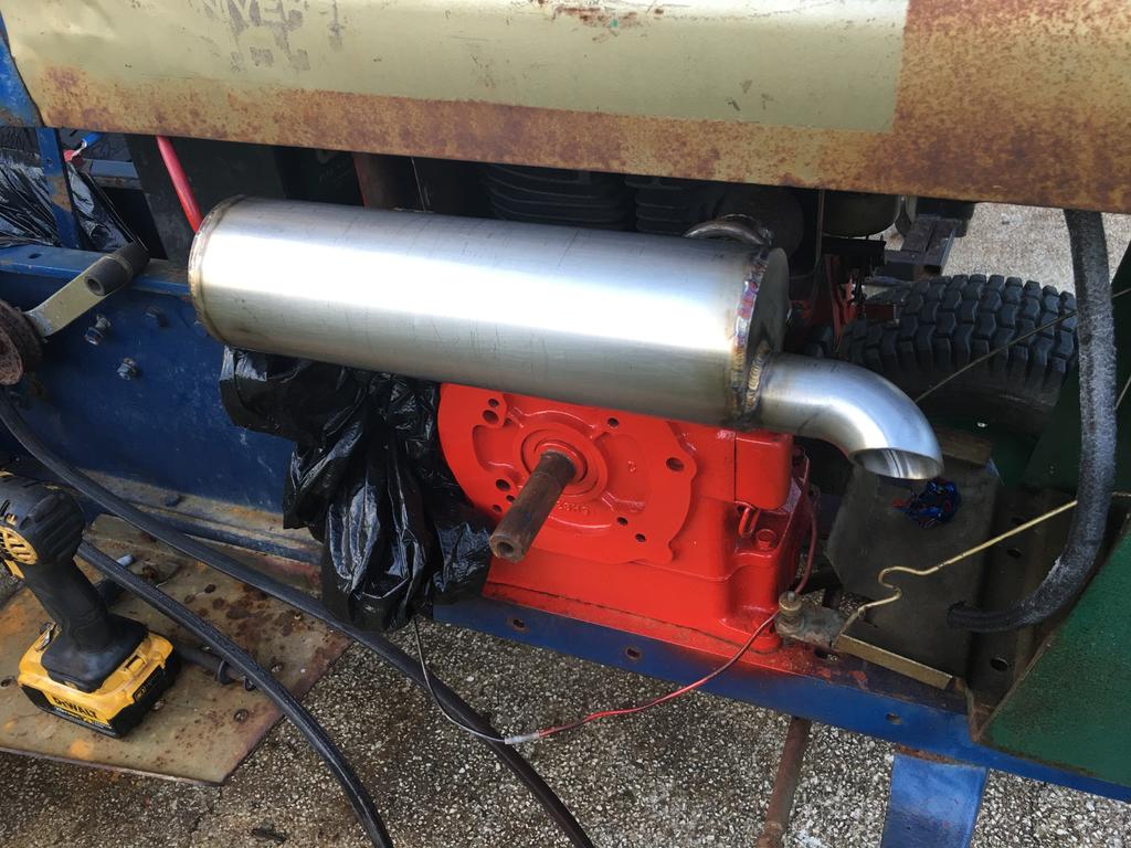

19richie66 17,936 #5 Posted July 26, 2018 Hate to answer for Aldon but I think that is what he used. I made my muffler(although not super quiet) modeled after the 418-a. Same length and diameter. Just no packing in it. 2 1 Share this post Link to post Share on other sites
