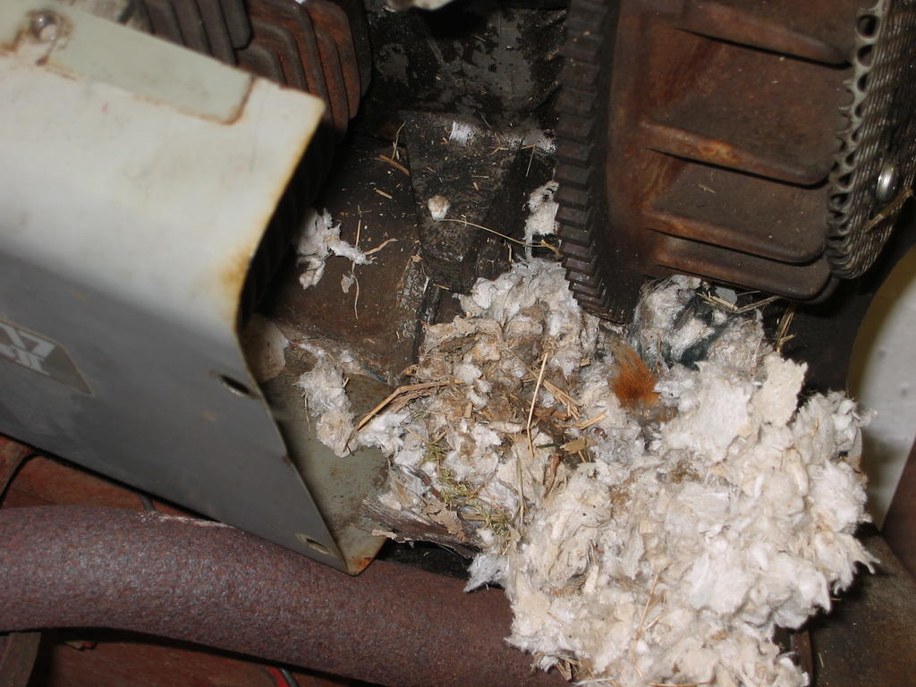

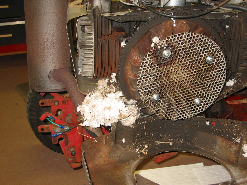

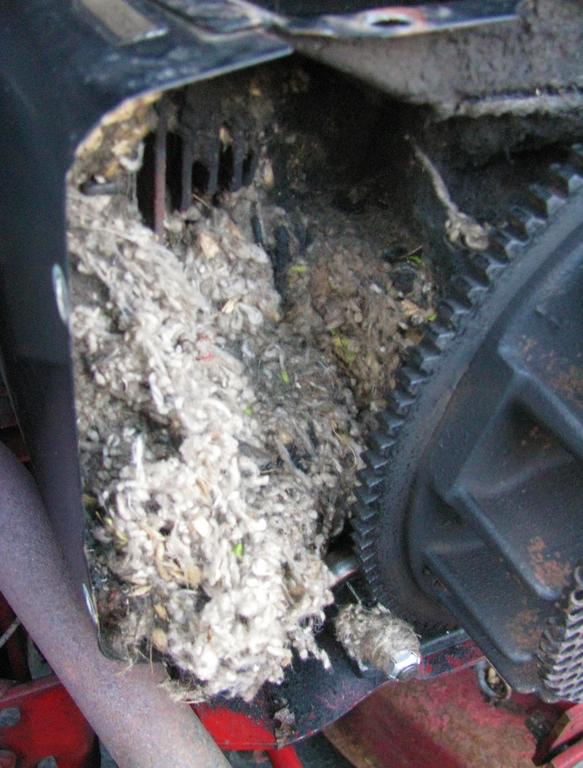

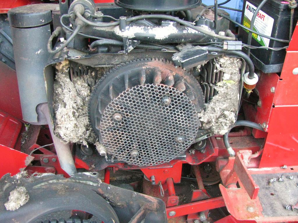

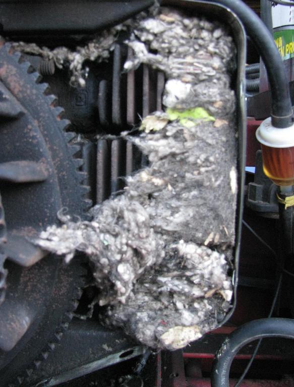

pfrederi 21,308 #1 Posted July 16, 2018 (edited) Went to start one of the C-175s this morning down in the barn. Turned over twice then stopped. Solenoid clicked but no crank. Jumped it off the D200 no success. Realized I couldn't turn the engine by hand. Also noticed some of the oil drip pads had been munched on. Saw some white stuff inside the blower housing Had to drag her up to the shop (too hot to work in the barn..really need to get a tow set up on the 3pt. I had to pick her up with straps frond the front axle to the FEL bucket...Then back all the way from the barn to the shop. Reminded AG tires are darn near worthless backing up hill even with the york rake hanging off the 3 pt as a counterweight. Took the shields off and found the stuff wrapped around the starter pinion jamming the fly wheel. Part of that mess is some dryer sheets pieces and they are really tough when you try to pull them off.... Guess mice appreciate me providing nice smelling dryer sheet for their construction projects. Edited July 16, 2018 by pfrederi 3 6 Share this post Link to post Share on other sites
