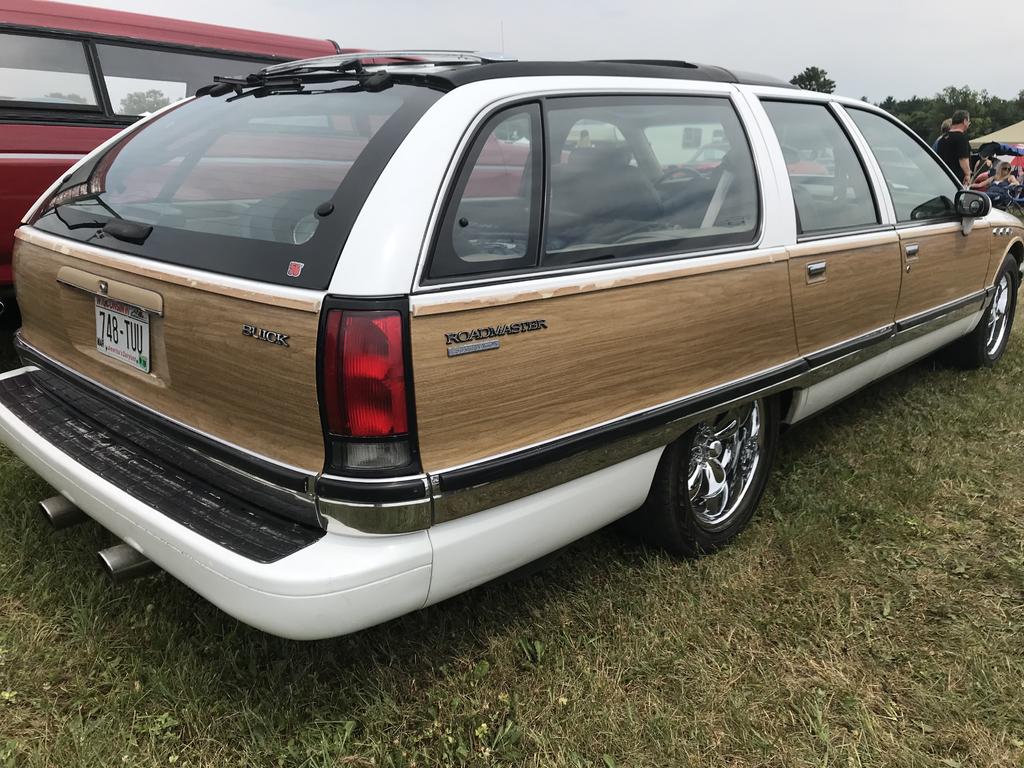

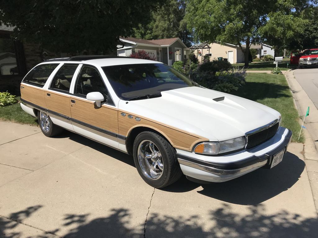

PeacemakerJack 11,039 #1 Posted July 15, 2018 Hey guys, my wife has always had a fettish for the wood panel side station wagons. I found out about the Buick roadmaster estate wagons of the mid 1990’s about ten years ago. Most of them came from the factory fully loaded with options. What made them very interesting is that they had the drivetrain from the Corvette including the 260hp LT1 motor. I found this one locally with 123,000 miles. Stock other than the hood, wheels, and exhaust. Comes with factory wheels and tires. it has a couple of small surface rust patches but overall seems to be in great shape. Question: have any of you ever owned one or know someone close to you that had one? Just wanting to know how reliable they are and what problems you have had if any? 3 Share this post Link to post Share on other sites

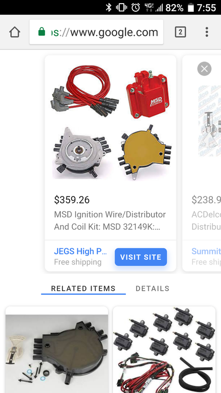

PeacemakerJack 11,039 #6 Posted July 16, 2018 3 hours ago, WVHillbilly520H said: the "opti-spark" distributor is a weak point it's mounted on the front of the engine behind the water pump and the factory original design would corrode from moisture build up, there is an aftermarket replacement that usually takes care of that Thanks Jeff! This is exactly the information that I’m looking for as we go to test drive it tomorrow. If we purchase the car, could you suggest an aftermarket brand or give me a link to the product that you would suggest? I know that you eat, breathe, and sleep BowTie products. Thanks for your input! 1 Share this post Link to post Share on other sites

WVHillbilly520H 10,379 #9 Posted July 16, 2018 8 hours ago, PeacemakerJack said: Thanks Jeff! This is exactly the information that I’m looking for as we go to test drive it tomorrow. If we purchase the car, could you suggest an aftermarket brand or give me a link to the product that you would suggest? I know that you eat, breathe, and sleep BowTie products. Thanks for your input! Like Richie said above read up on it, MSD and AC-Delco/Delphi are going to be your top choices for replacement, and I believe they need to be "vented" so the moisture doesn't build up inside them. 1 1 Share this post Link to post Share on other sites
