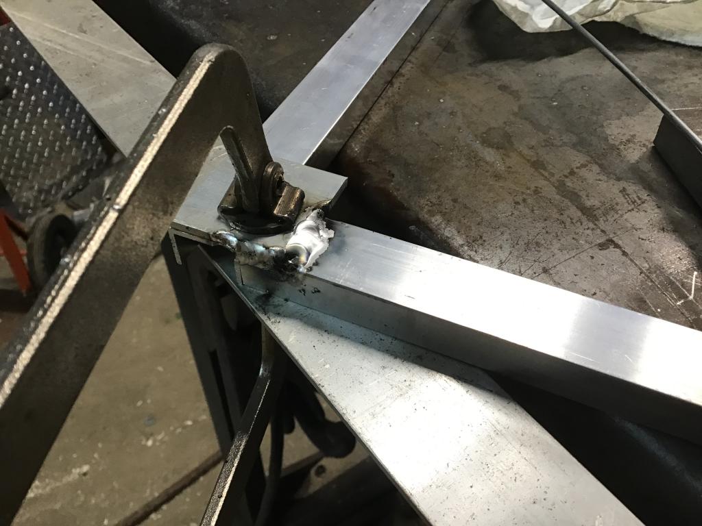

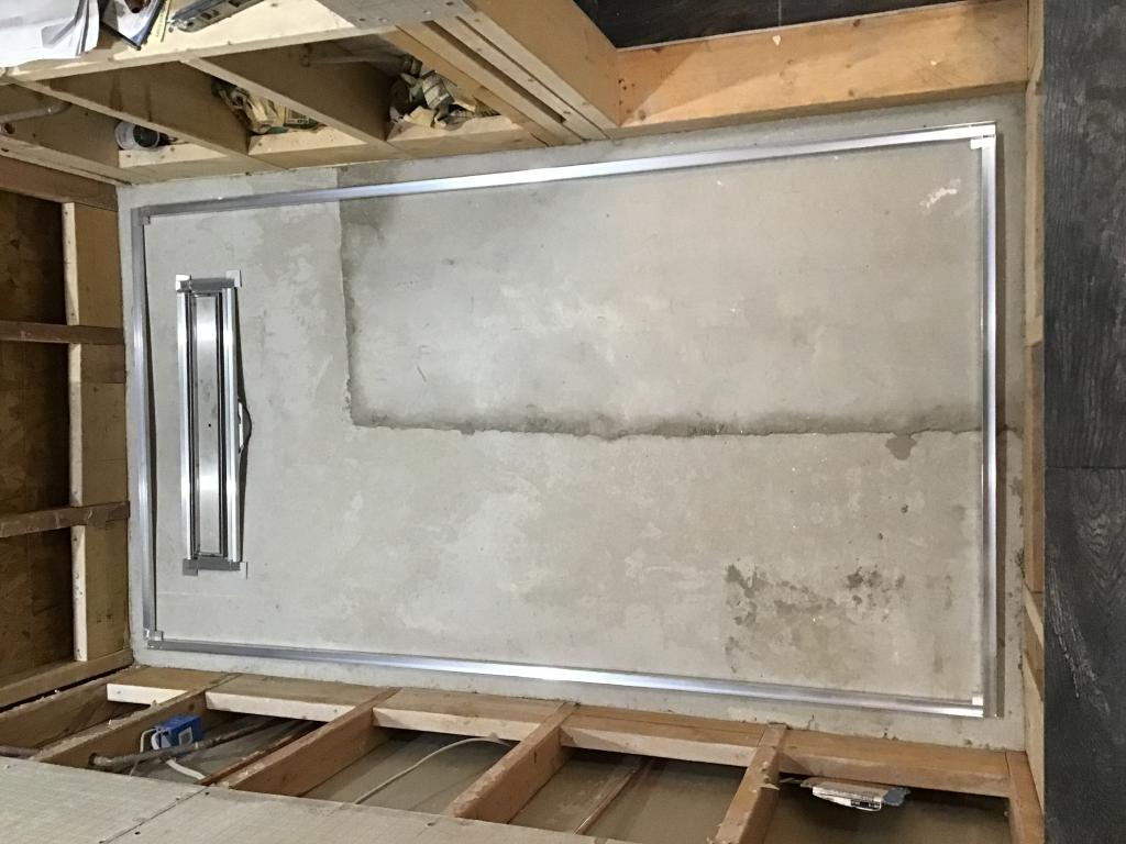

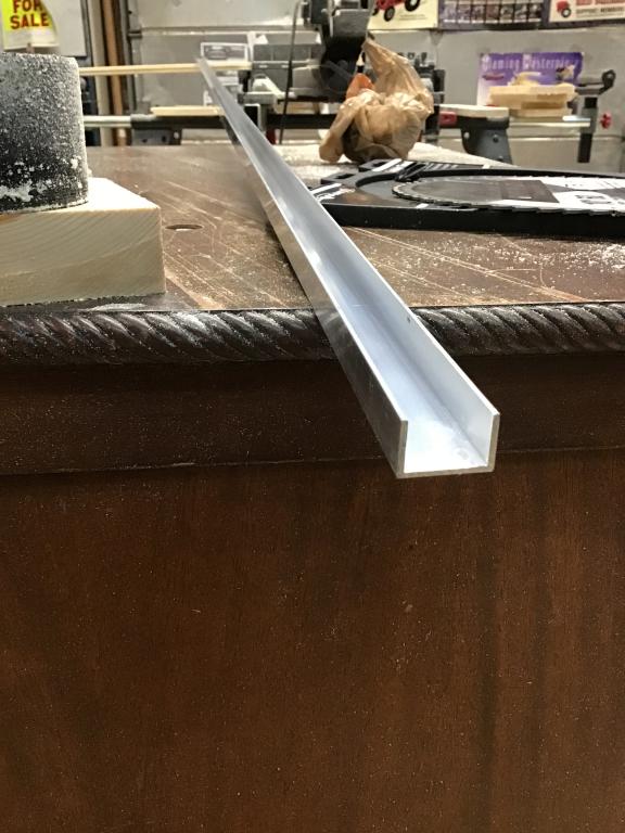

Pullstart 71,455 #178 Posted December 12, 2019 I picked up 6 pieces of this 8’ long C channel. I plan to build a little track guide to make my finish mortar bed the best slope possible. Share this post Link to post Share on other sites
Pullstart 71,455 #179 Posted December 13, 2019 It doesn’t have to be pretty, it has to get buried in mud. 1 Share this post Link to post Share on other sites

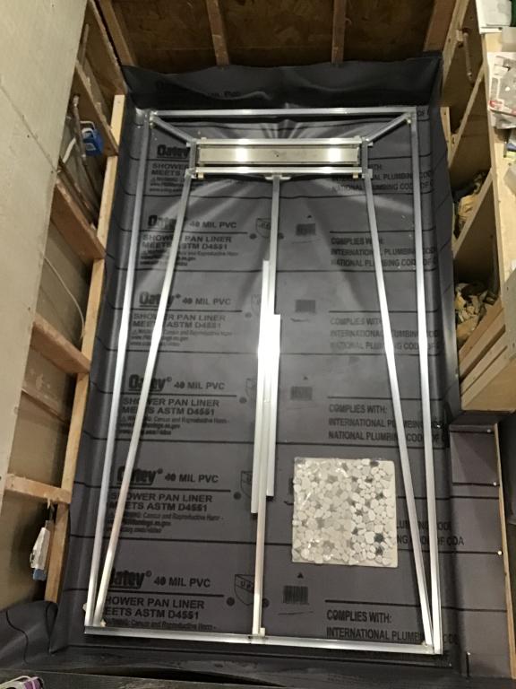

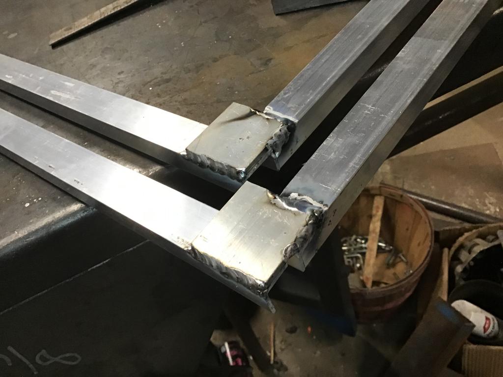

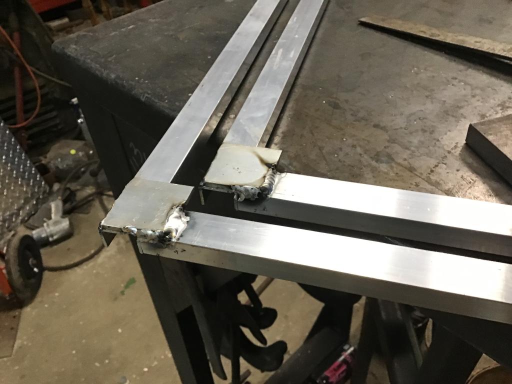

Pullstart 71,455 #180 Posted December 13, 2019 The track frame is welded up. I’ll likely lay the corner pieces in, tweak and go. The shower is the last part of the project, realistically. I had a goal of being complete by Monday and it’s Friday. Oh boy. Share this post Link to post Share on other sites

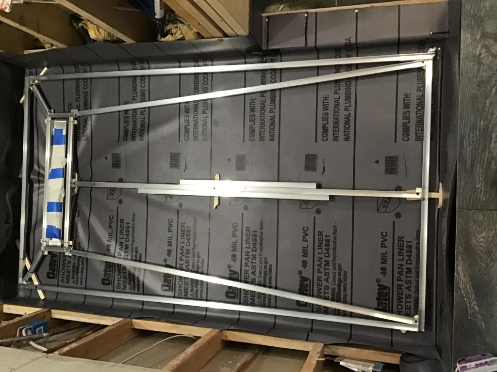

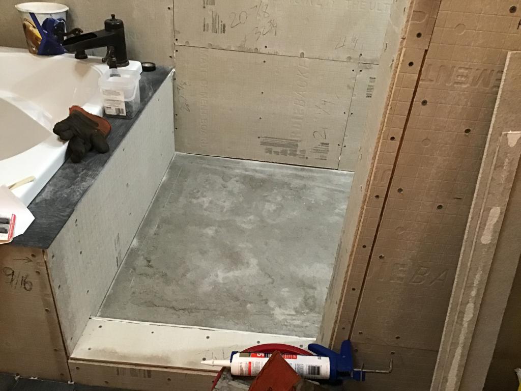

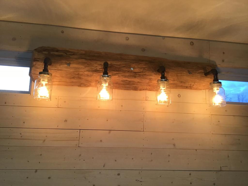

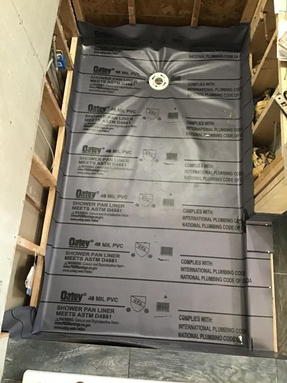

Pullstart 71,455 #181 Posted December 14, 2019 I installed the shower pan liner and tested to see if the water sheds in the right direction. Time ran out to mix up mud and pour the top coat, but I managed to complete the light fixture! 2 1 Share this post Link to post Share on other sites

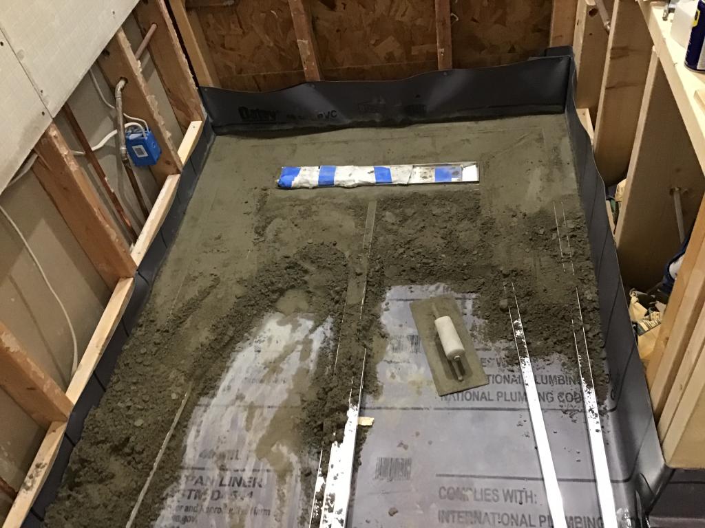

Pullstart 71,455 #182 Posted December 14, 2019 My funky looking cobbled track/guide system is done and leveled. I have a whole bunch of steel bar holding the drain down and I’m ready for final mud! 2 Share this post Link to post Share on other sites

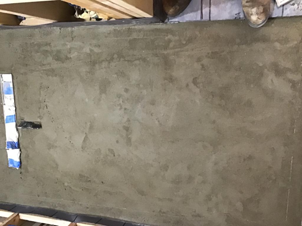

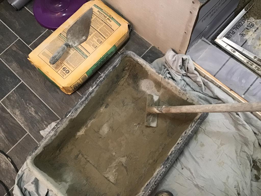

Pullstart 71,455 #184 Posted December 14, 2019 Mud is my slang, for drywall (Sheetrock) fill, for mortar, for anything really that I have any input for mixing wet and waiting for it to dry thanks for the compliments Norm! MUD (mortar) bed is in progress! I have 1-1/4 bags for mix left, hopefully it’s just enough! 2 1 Share this post Link to post Share on other sites

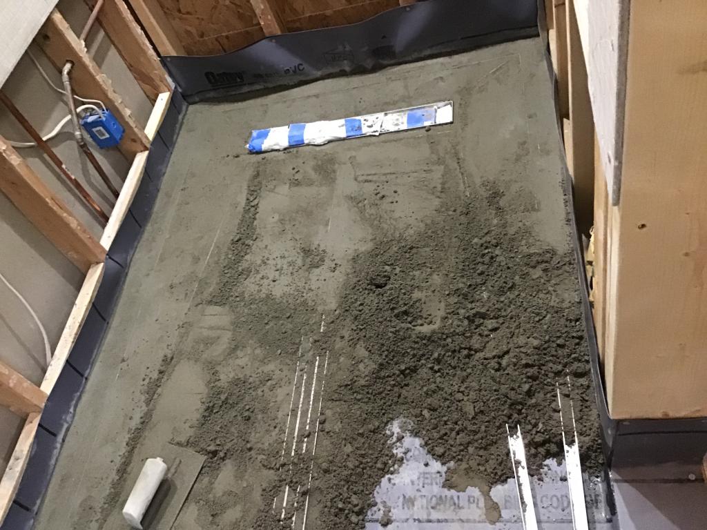

Pullstart 71,455 #185 Posted December 14, 2019 I didn’t like the way the center rib was creating a “spine” and raising up. I pulled one screw, stripped the other, so I cut it out. I am glad it was there for a guide but it would have been great to make it easy to remove. Oh well, the final mortar bed is done! I used a piece of steel to hold the remnants in, but a little bit of thinset will cover that area just fine. my hands are ready for an ice water bath... just as soon as my tools are cleaned off! 1 1 Share this post Link to post Share on other sites

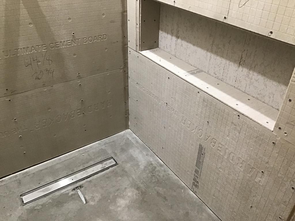

Pullstart 71,455 #187 Posted December 16, 2019 All the cement board is up! I need to waterproof with Redgard before tile! 1 Share this post Link to post Share on other sites

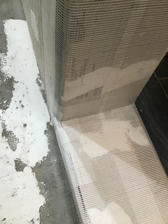

19richie66 17,937 #188 Posted December 16, 2019 Don’t forget the membrane for the corners and edges 1 Share this post Link to post Share on other sites
Pullstart 71,455 #189 Posted December 16, 2019 2 hours ago, 19richie66 said: Don’t forget the membrane for the corners and edges Yessir! It’s ready for what I’ve heard a stinky tomorrow! I read that it’ll smell in there for 2 days after it’s applied! Share this post Link to post Share on other sites
19richie66 17,937 #190 Posted December 16, 2019 The membrane I was referring to is the fiber mesh you use in the corners and the edges where the panels meet. The redguard isn’t too bad a smell. Just don’t get it on anything you don’t want it on. It does not come off. I’m sure you have it figured out but you have my number if you have any questions about how I did mine. Looking good Brother 👍 1 Share this post Link to post Share on other sites
19richie66 17,937 #191 Posted December 16, 2019 (edited) He uses Mapei water proofing instead of redguard. Either is good but the membrane fiber tape is what I was talking about. I watched this many times. Edited December 16, 2019 by 19richie66 Share this post Link to post Share on other sites
19richie66 17,937 #192 Posted December 16, 2019 (edited) Edited December 16, 2019 by 19richie66 4 1 Share this post Link to post Share on other sites
19richie66 17,937 #193 Posted December 16, 2019 1 2 Share this post Link to post Share on other sites

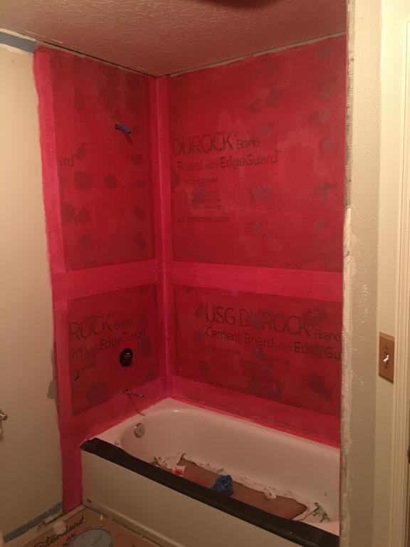

Pullstart 71,455 #194 Posted December 16, 2019 @19richie66 thanks for the links... and encouragement! I have the mesh tape and had seen that you can do the joints the same as the corners without the mud.... just waterproofing. That was my plan. Should I go find the other drywall looking cement board tape and thinset the butt joints? Share this post Link to post Share on other sites
19richie66 17,937 #195 Posted December 16, 2019 I did all of my joints with the backerboard mesh tape and thinset. You have to get backerboard tape as the alkaline content in the thinset will eat drywall mesh tape. I also thinset over all my screws. After that dried I went over all joints, corners and screwheads with redguard appling the fiber mesh tape in the corners/joints only and then coated the whole shower with two coats of redguard. I did it just the way he explained. One coat applied in horizontal strokes and one coat applied in vertical strokes. Overkill?...... I just wanted it right and not have to do it over later. 1 1 Share this post Link to post Share on other sites
Pullstart 71,455 #196 Posted December 16, 2019 6 minutes ago, 19richie66 said: I did all of my joints with the backerboard mesh tape and thinset. You have to get backerboard tape as the alkaline content in the thinset will eat drywall mesh tape. I also thinset over all my screws. After that dried I went over all joints, corners and screwheads with redguard appling the fiber mesh tape in the corners/joints only and then coated the whole shower with two coats of redguard. I did it just the way he explained. One coat applied in horizontal strokes and one coat applied in vertical strokes. Overkill?...... I just wanted it right and not have to do it over later. I just received a week extension on my inspection... so I’ll take another day to do it overkill... if you will! 1 Share this post Link to post Share on other sites

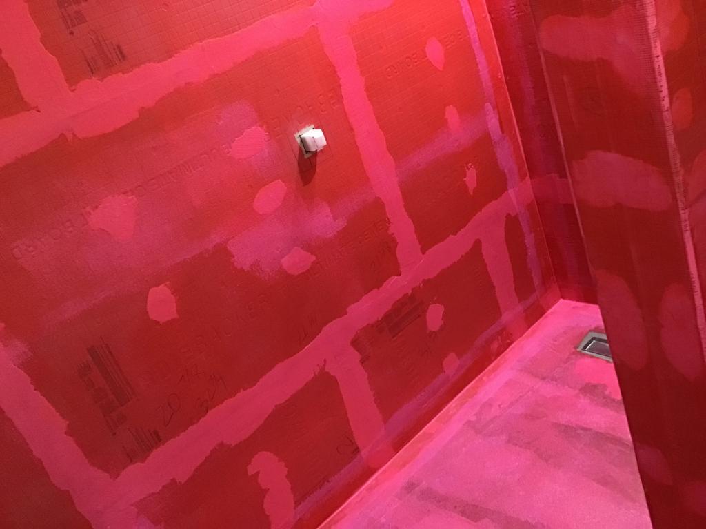

Pullstart 71,455 #197 Posted December 16, 2019 Against my better judgement... and with Richie’s... overkill progress! 2 Share this post Link to post Share on other sites
19richie66 17,937 #198 Posted December 16, 2019 Peace of mind knowing it’s right. At least as right as I could get mine. I had a friend that does tile come by as I progressed and he said I did a great job for a “non tiler”. He was impressed so I felt good about how I did. Believe me, the last thing I wanted to do was do it over. Once was bad enough. 1 1 Share this post Link to post Share on other sites
Pullstart 71,455 #199 Posted December 17, 2019 My first coat is done! I spent most of the afternoon trying to track down more mesh to lay in the Redgard. Ends up being they combined it with drywall tape and made it super sticky! It was nice dry fitting everything, except inside corners. It was much easier to lay in the fiber mesh when the Redgard was wet. My first layer was complete by about 12:30 or so this morning. Them saying it might have a strong odor is like saying the bathrooms at a tractor show might get used a few times! It stinks yet this morning, but it’s rock hard and ready for coat number 2! 2 Share this post Link to post Share on other sites
19richie66 17,937 #200 Posted December 17, 2019 (edited) Looks great. Right color.👍 The drywall mesh and the tile board mesh are two different materials. The mesh I used was grey. The fiber mesh (membrane) for sealing the corners is a fiberglass style cloth. Edited December 17, 2019 by 19richie66 Share this post Link to post Share on other sites
