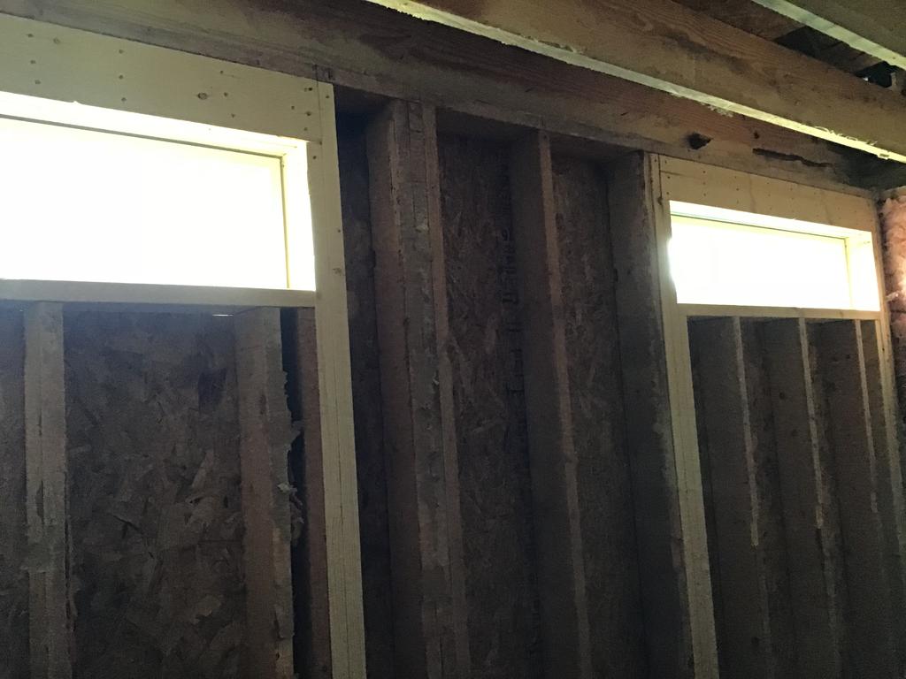

Pullstart 71,452 #26 Posted July 17, 2018 Any quality work I can do with a hammer, is a job for me! 1 Share this post Link to post Share on other sites

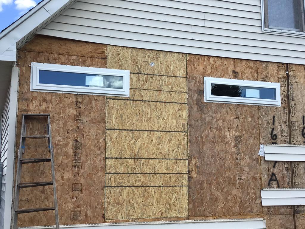

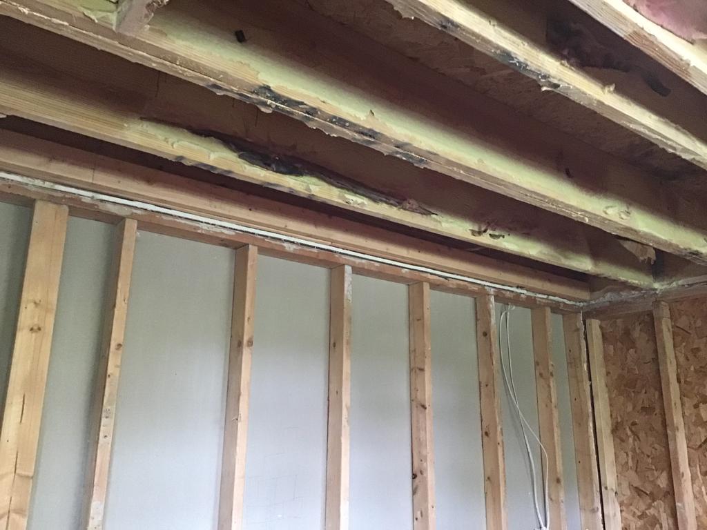

Pullstart 71,452 #27 Posted July 17, 2018 Like these windows have always been there... need to run up town and get some house wrap before patching siding back together! 4 1 Share this post Link to post Share on other sites

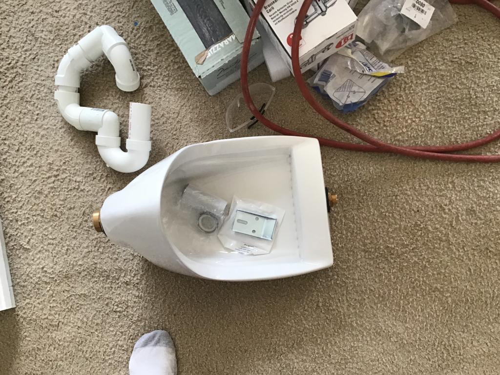

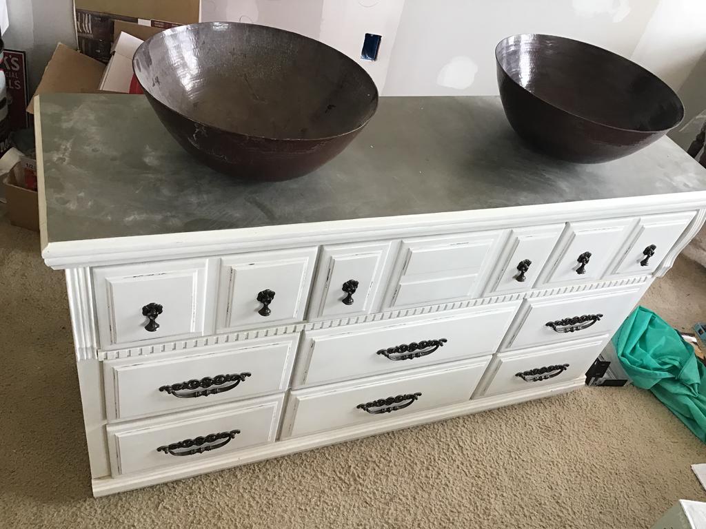

Pullstart 71,452 #29 Posted July 20, 2018 Got the house wrapped up with Tyvek before our much needed rain came, now Amazon Santa came! Got a urinal on Prime Day, and dig the vanity out of storage. 4 Share this post Link to post Share on other sites

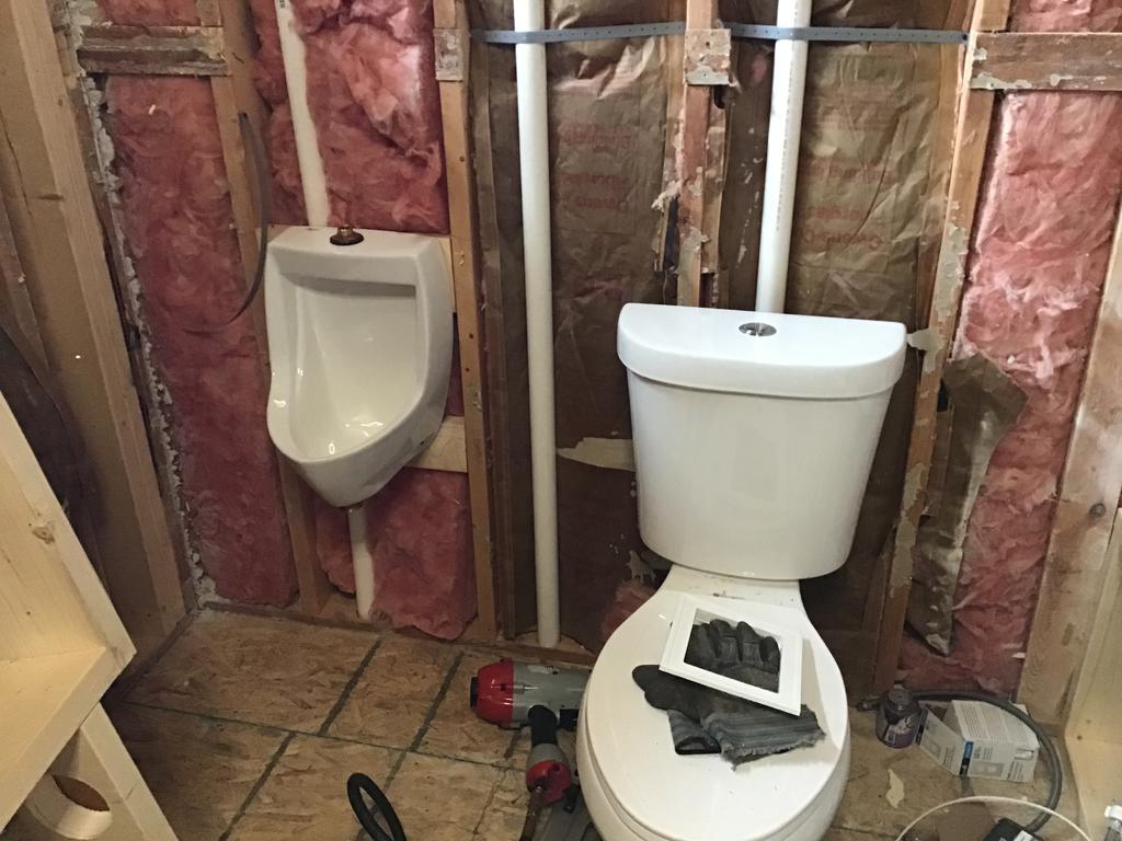

ebinmaine 81,001 #31 Posted July 22, 2018 3 hours ago, pullstart said: She also stole my WHCC round hood logo’d hat Oh .... You go march your self right into that new bathroom and get that sit down toilet right out of there. You tell her when she gives back that hat then she can have her throne back. 2 Share this post Link to post Share on other sites

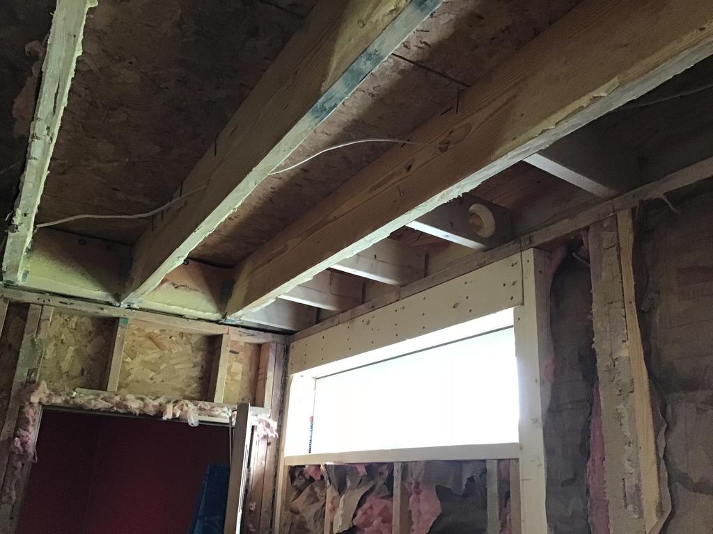

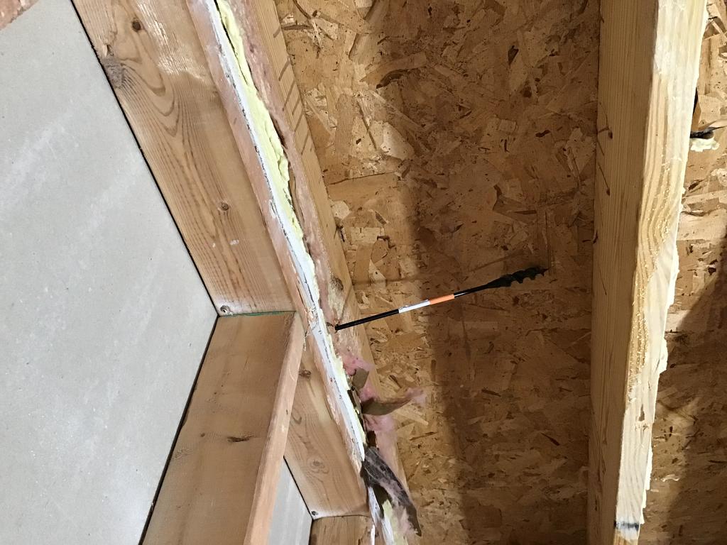

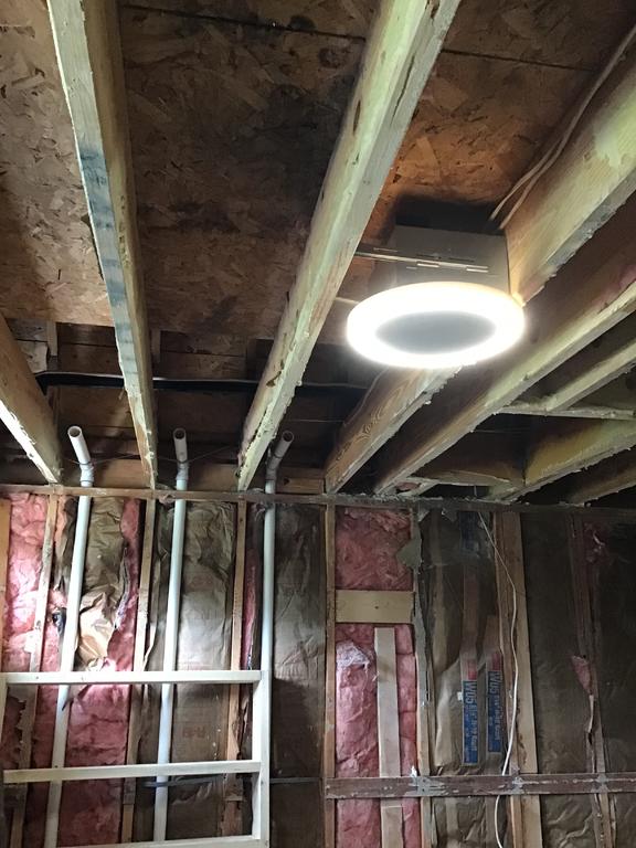

Pullstart 71,452 #32 Posted July 22, 2018 Did some wiring in the dining room for a wet bar, while the wall was open on the back side... cool flexible 54” long 7/8” drill bit made easier work if snaking wires! New LED Bluetooth bath fan too. 1 Share this post Link to post Share on other sites

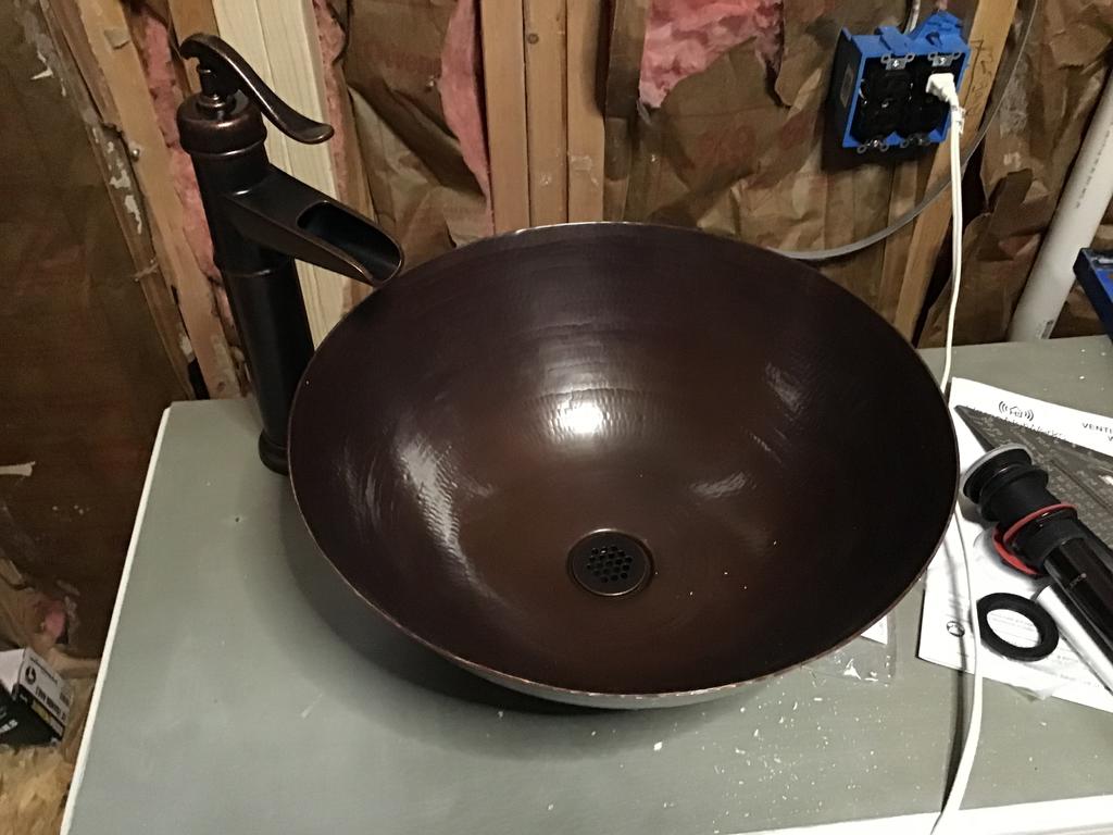

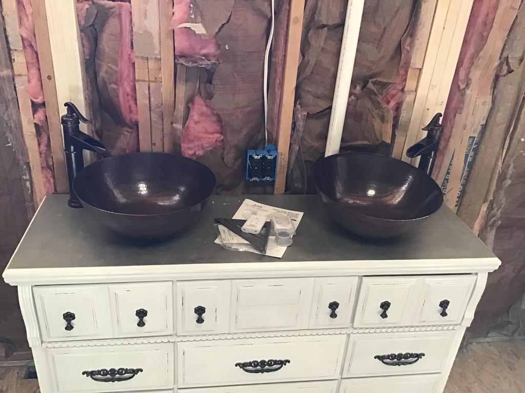

Pullstart 71,452 #33 Posted July 23, 2018 Got faucets and drains for the vessel sink vanity today... 2 Share this post Link to post Share on other sites
ebinmaine 81,001 #34 Posted July 24, 2018 Looks good so far Kev.... Might wanna throw something over the wall studs though? Like a wall. Just a suggestion.... But I don't even have a urinal. 1 Share this post Link to post Share on other sites

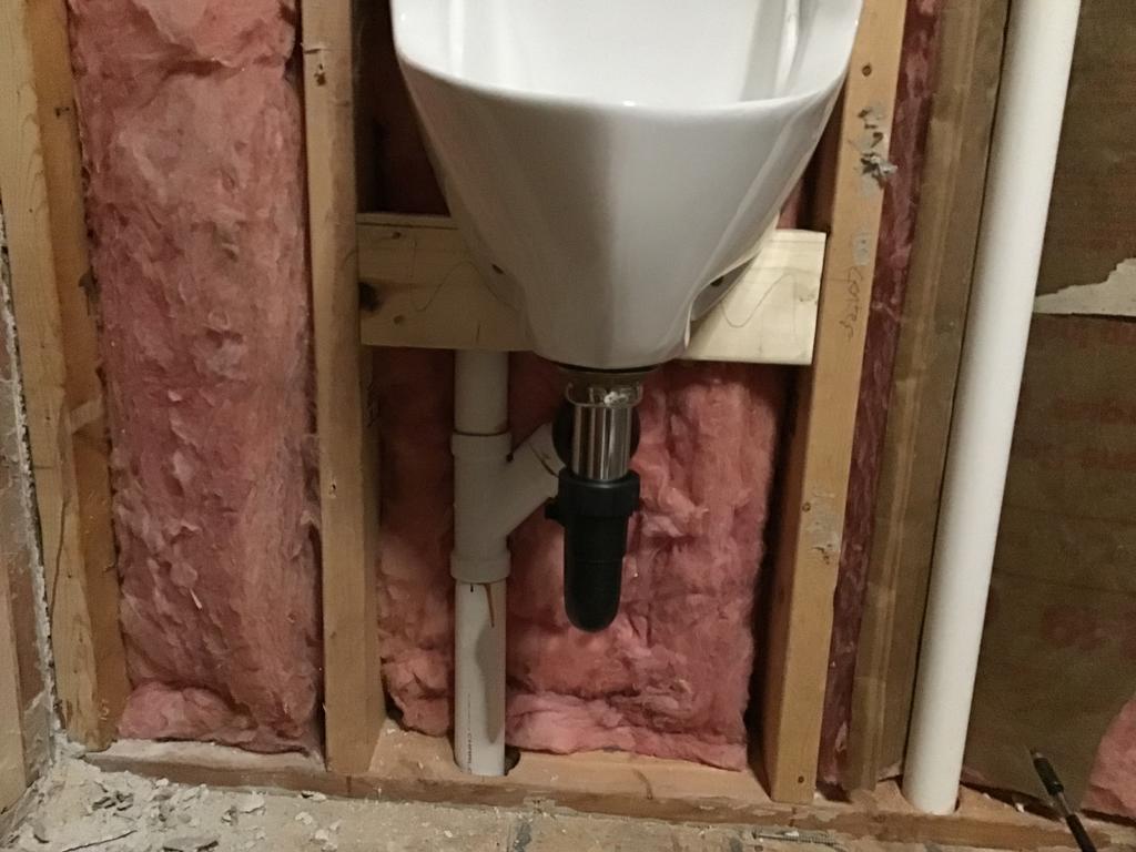

Pullstart 71,452 #35 Posted July 24, 2018 Installed a drain too... 1 Share this post Link to post Share on other sites
Pullstart 71,452 #36 Posted July 24, 2018 8 minutes ago, ebinmaine said: Looks good so far Kev.... Might wanna throw something over the wall studs though? Like a wall. Just a suggestion.... But I don't even have a urinal. Yer’ startin’ to sound like my wife! 3 Share this post Link to post Share on other sites
Jerry77 1,218 #37 Posted July 24, 2018 15 minutes ago, pullstart said: Installed a drain too... You could have saved some materials if you had drained it into the toilet -she let you go this far, shouldn't have been a problem.... 1 2 Share this post Link to post Share on other sites

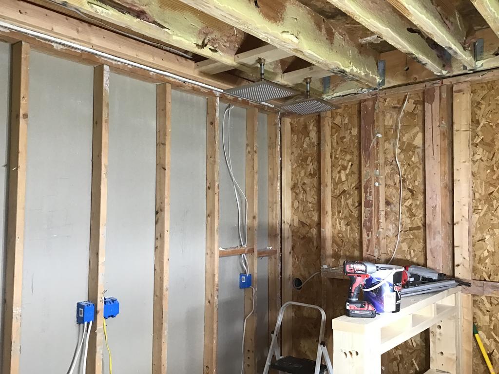

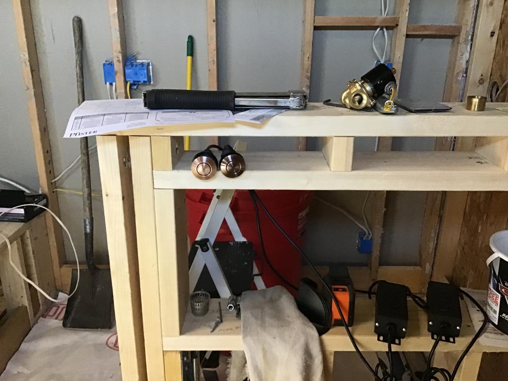

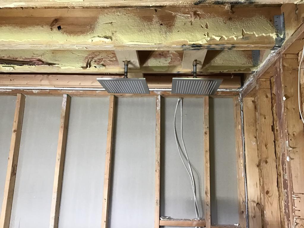

Pullstart 71,452 #40 Posted July 24, 2018 Got some more work done, shower heads positioned, both faucets installed in the vanity, more drains hooked up in the basement too. Shower will have push buttons on the outside of the half wall to turn on one or the other or both shower heads. They have nifty LED lights in the shower head too! 2 Share this post Link to post Share on other sites

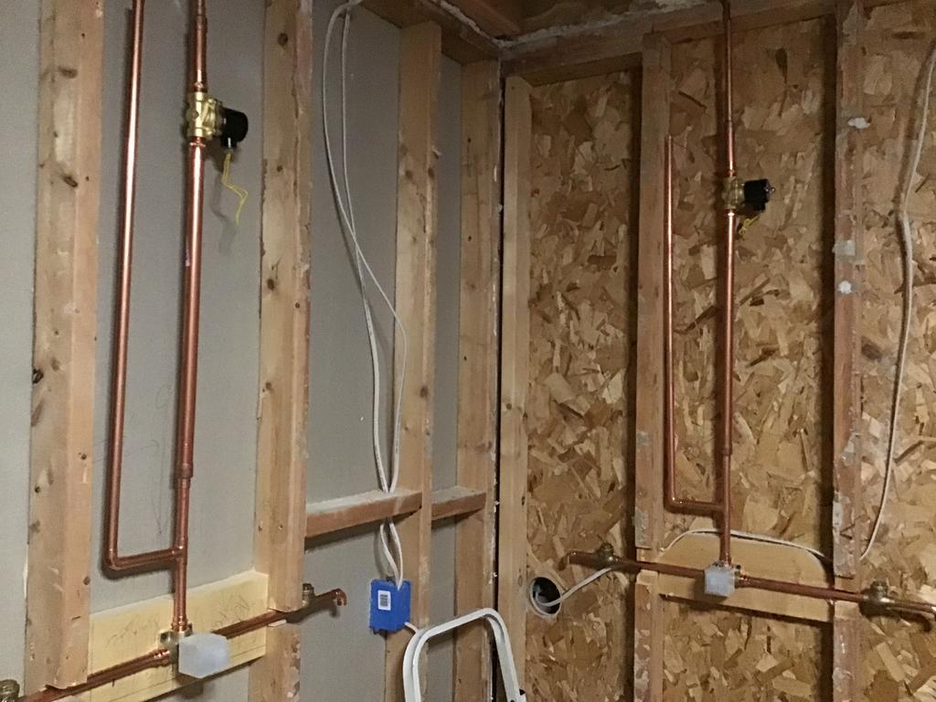

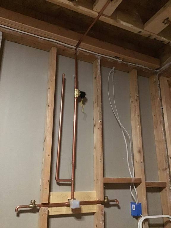

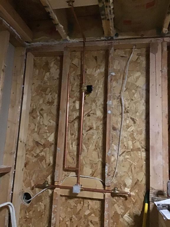

Pullstart 71,452 #41 Posted July 25, 2018 The shower, I’m hoping will be one of the real highlights of the project. Today I got my air switches. Think of a whirlpool pump switch, or for a kitchen garbage disposal. With the help of some swing check valves, I plan to leave the shower valves in mine and Mrs. desired temps, and the shower head will be activated by the switches through a solenoid valve. Yee haw no more dodging the cold burst when you turn on the shower! 1 Share this post Link to post Share on other sites

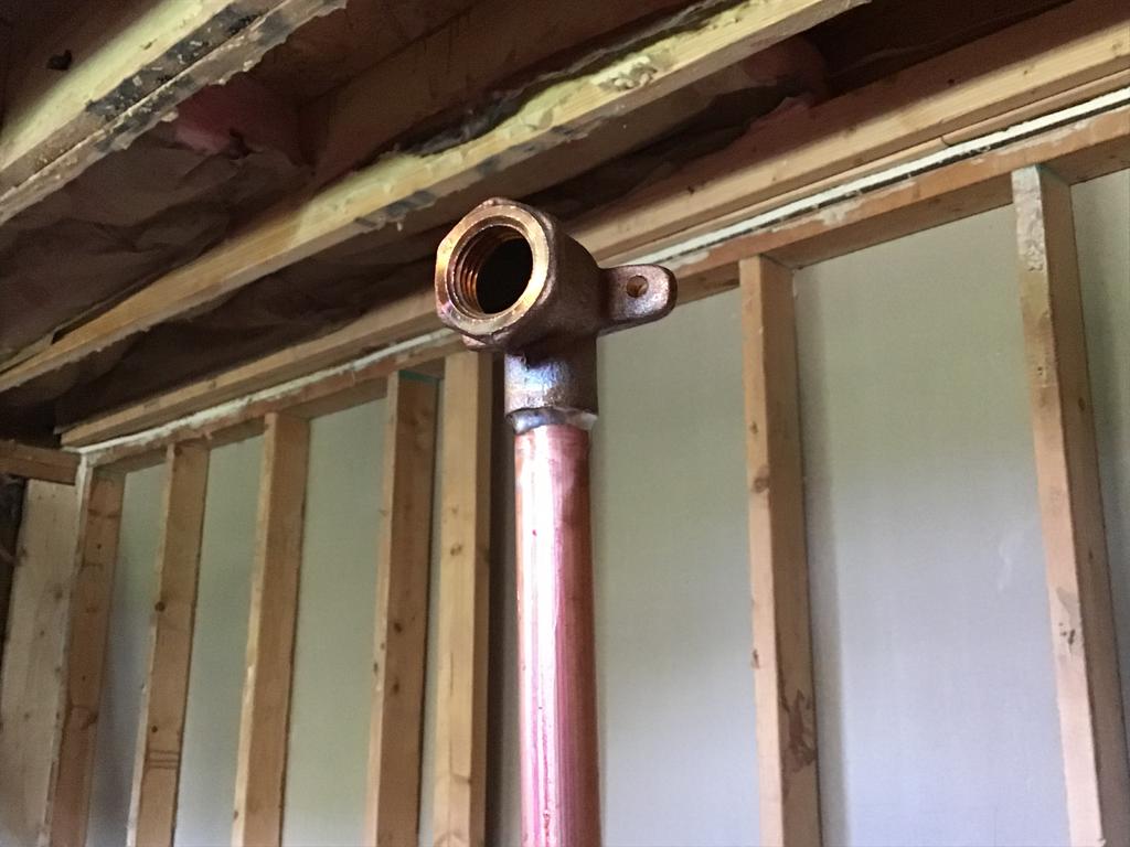

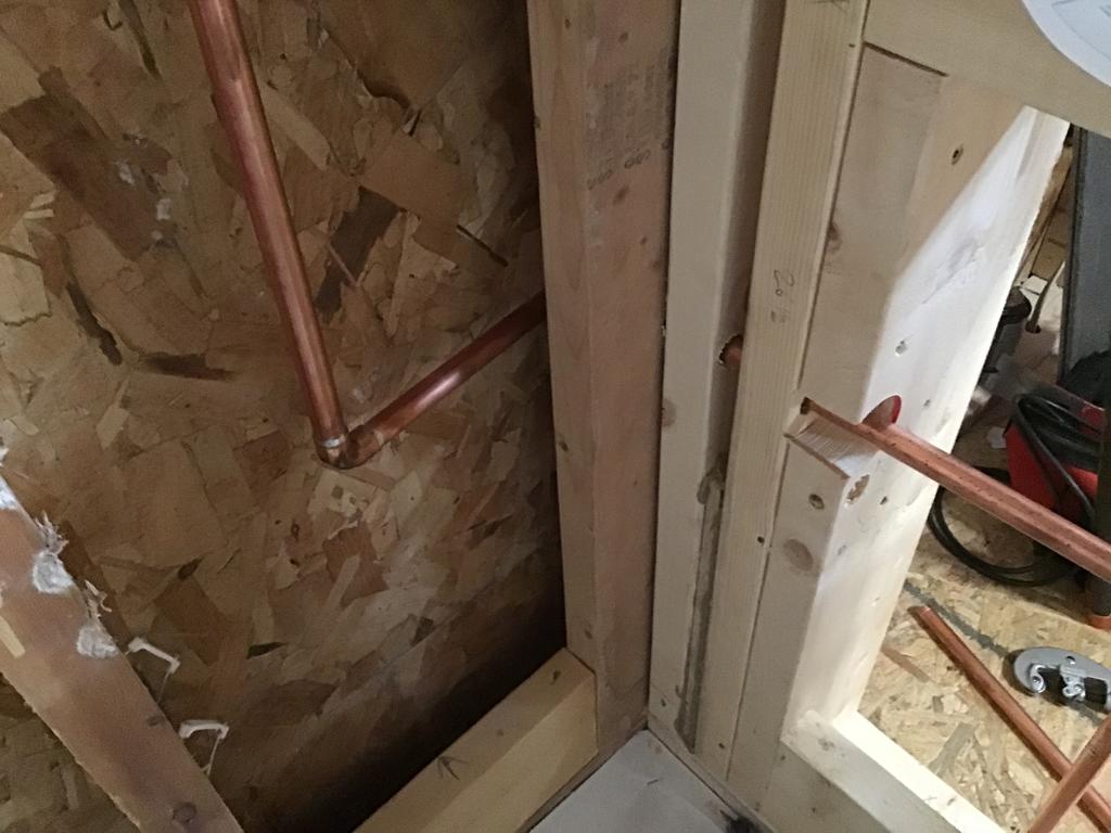

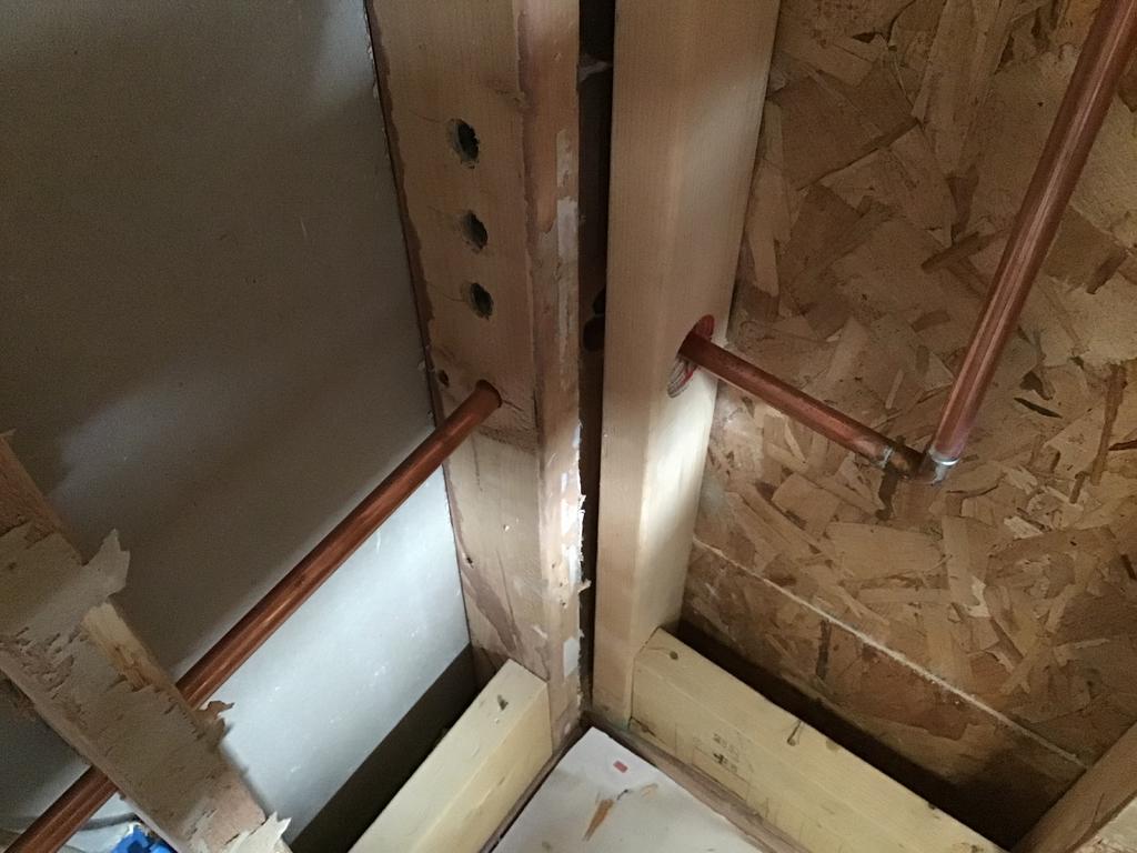

Pullstart 71,452 #42 Posted July 26, 2018 Got some roughing done with the shower plumbing, hoping my oversized hammer arrestor will prevent major hammer when the solenoids close. I’ll tear it all out in the morning, clean my joints and play with fire and lead. Woo hoo! 1 Share this post Link to post Share on other sites
Pullstart 71,452 #44 Posted July 26, 2018 I love me some copper. 1 Share this post Link to post Share on other sites
19richie66 17,937 #45 Posted July 26, 2018 I don’t like paying for me some copper. 2 Share this post Link to post Share on other sites

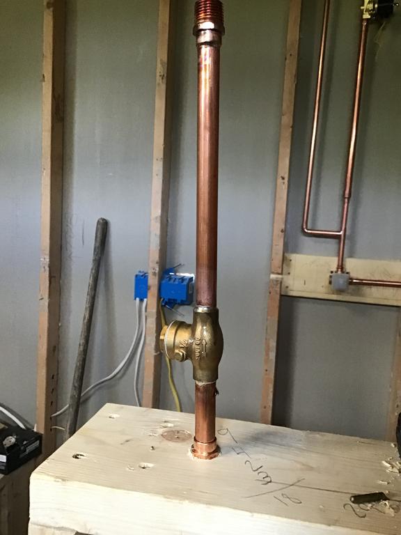

Pullstart 71,452 #46 Posted July 26, 2018 True, but for shower rough ins, I like it’s rigidity compared to plastic and pex. plus, I’ll be into the whole bathroom for about 10 sticks or less. I’m willing to settle for the quality on a small job, and maybe in the next 10 years, the small jobs will equate to replacing all the cpvc that’s in the house now. That stuff is brittle! one side is done with the sweat work Share this post Link to post Share on other sites

Pullstart 71,452 #49 Posted July 26, 2018 Sometimes, you gotta be thankful for modern technology. Today’s time saver is the shark bite press in fitting. Get through corners without hacking everything to pieces. 2 1 Share this post Link to post Share on other sites

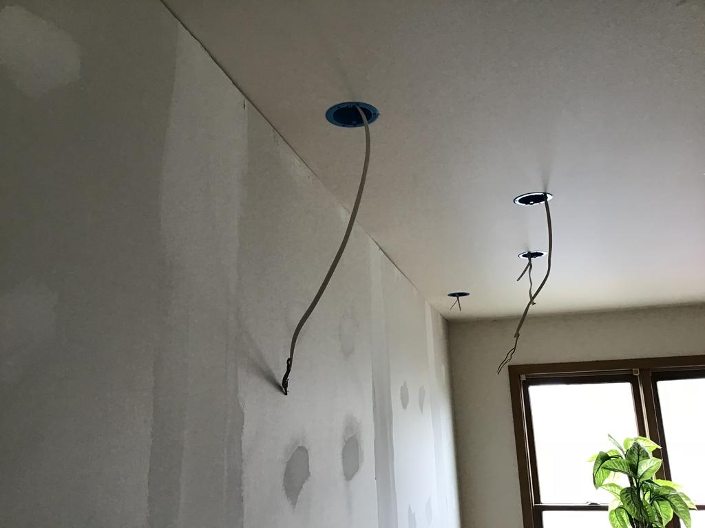

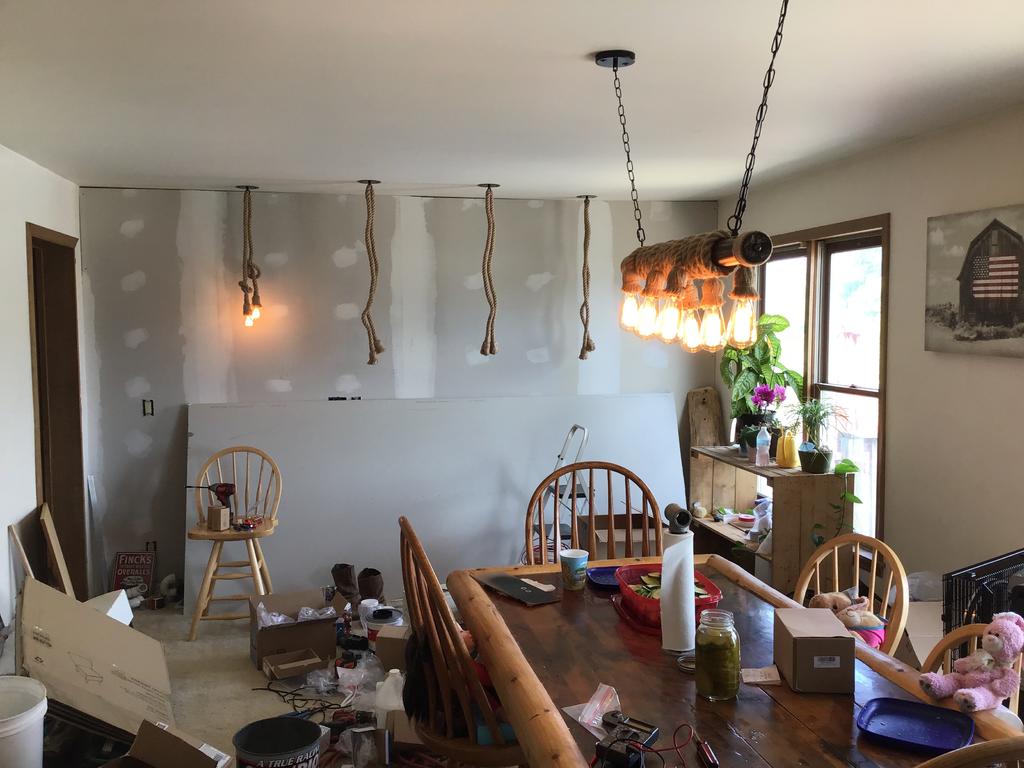

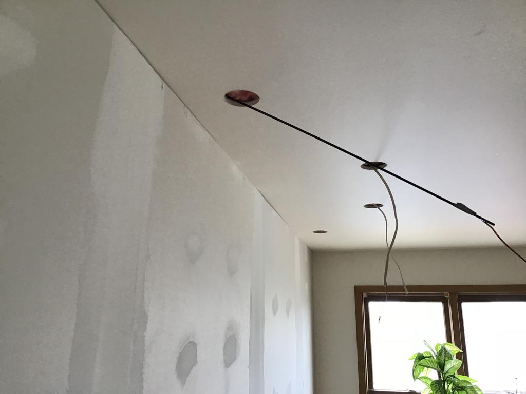

Pullstart 71,452 #50 Posted July 27, 2018 Finished new lights in the adjacent room, so I can keep moving on with Sheetrock... errr. Start with Sheetrock. Mrs. Pullstart needs to tie her knots in the ropes, then we’ll finish installing bulbs. 2 1 Share this post Link to post Share on other sites
