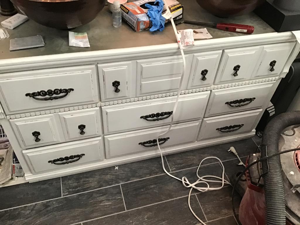

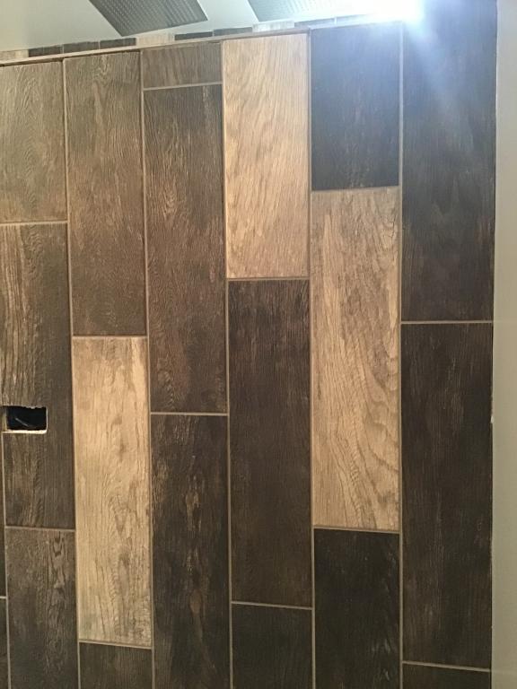

Pullstart 71,455 #254 Posted January 1, 2020 I finished all the drawers in the vanity the other day, now I’m working on grout. It’s so time consuming on the walls compared to the floor! 2 3 1 Share this post Link to post Share on other sites

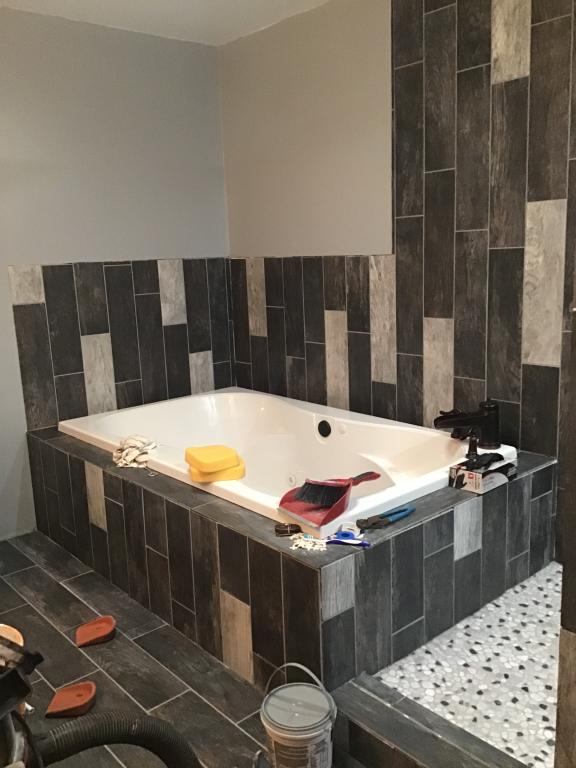

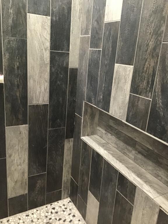

Pullstart 71,455 #256 Posted January 4, 2020 So close! I have just the outside of the shower and the curb to grout. 2 Share this post Link to post Share on other sites
dells68 7,499 #257 Posted January 4, 2020 Too bad you don’t live close to the big show Kevin - I know where I’d be booking my reservations! 4 Share this post Link to post Share on other sites

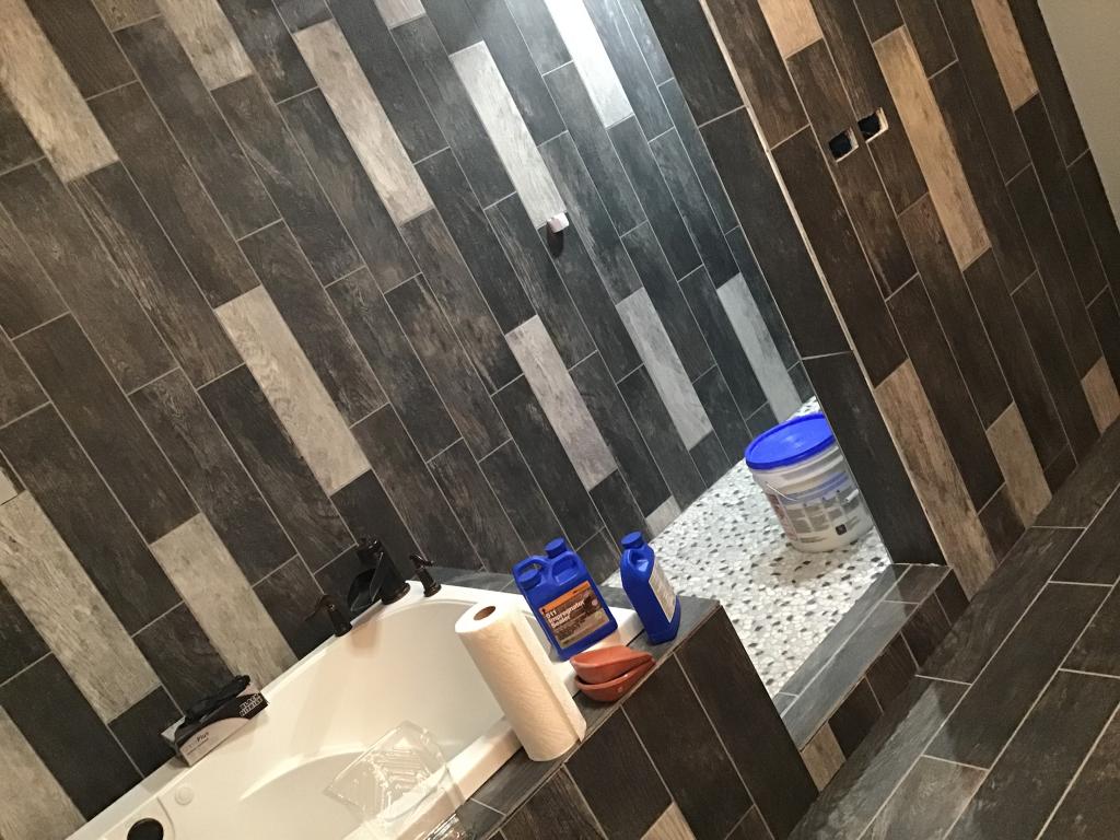

JCM 11,419 #258 Posted January 5, 2020 @pullstart That appears to be a whirlpool tub, I think I see 1 jet to the left of the waste & overflow. Just remember when you get all excited to use it for the first time don't use bubble bath, don't ask me how i know, 40 years ago it started heading for the door and out into the hall. 1 5 Share this post Link to post Share on other sites

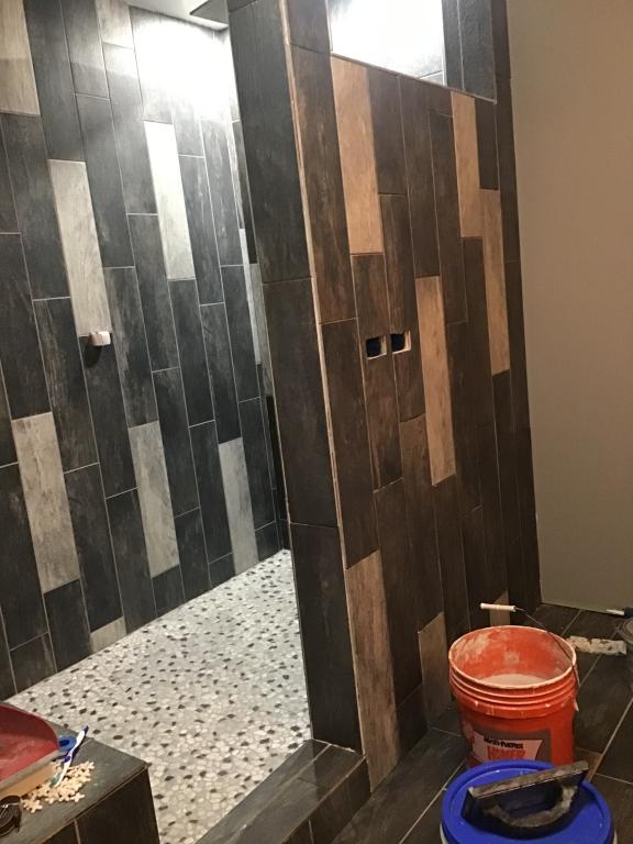

Pullstart 71,455 #261 Posted January 7, 2020 My grout lines are all finished! I am going to wet sand the whole thing to help cut any excess glazing on the tiles, dehumidify the room and start on sealing the grout! 1 1 Share this post Link to post Share on other sites

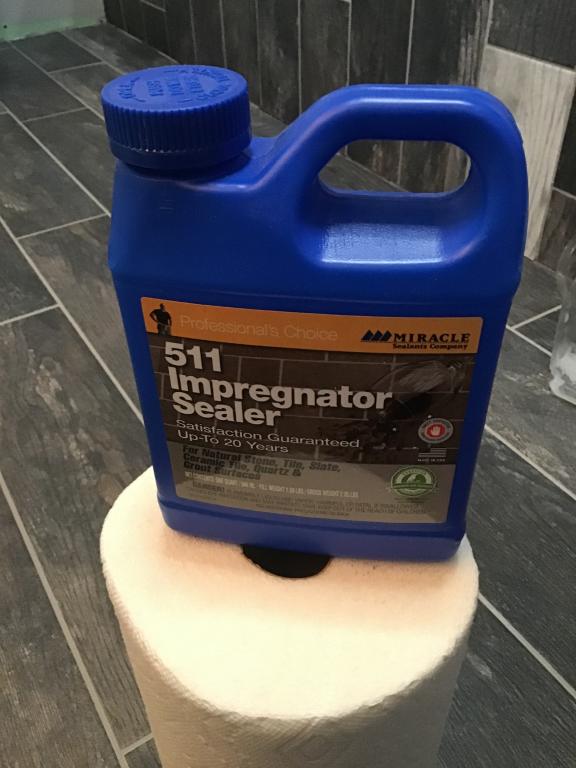

Pullstart 71,455 #266 Posted January 8, 2020 It’s time for grout sealer! I have the entire bathroom empty except for necessities and all the tile is scrubbed, swept and vacuumed! 4 1 Share this post Link to post Share on other sites

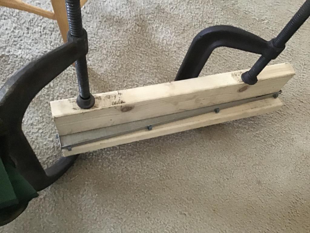

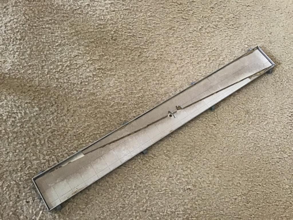

Pullstart 71,455 #267 Posted January 9, 2020 I used liquid nails to adhere some cement board to the drain cover. I’ll clean the squeeze out up and wait another day for it to fully harden, it’ll get the Redgard treatment. I’ll verify the drain weep hole is clear and open, then install the river rock. Share this post Link to post Share on other sites
Pullstart 71,455 #268 Posted January 9, 2020 I have a good coat on every wall grout line and two coats rolled on to the shower floor so far. This has the texture and smell of mineral spirits and seems to last a very long time. The guy at the store said my tiles should be sealed too, so the entire bathroom will get a rolled on coat too. I have three bottles and have used maybe half of one so far. 1 Share this post Link to post Share on other sites
The Tuul Crib 7,354 #269 Posted January 9, 2020 44 minutes ago, pullstart said: I have a good coat on every wall grout line and two coats rolled on to the shower floor so far. This has the texture and smell of mineral spirits and seems to last a very long time. The guy at the store said my tiles should be sealed too, so the entire bathroom will get a rolled on coat too. I have three bottles and have used maybe half of one so far. I would have thought the tiles would have already been sealed when they were made, 1 Share this post Link to post Share on other sites
19richie66 17,937 #270 Posted January 9, 2020 (edited) I used an epoxy additive in my grout that sealed the grout. No sealer needed. Did the floor though anyways just to be safe Edited January 9, 2020 by 19richie66 1 Share this post Link to post Share on other sites

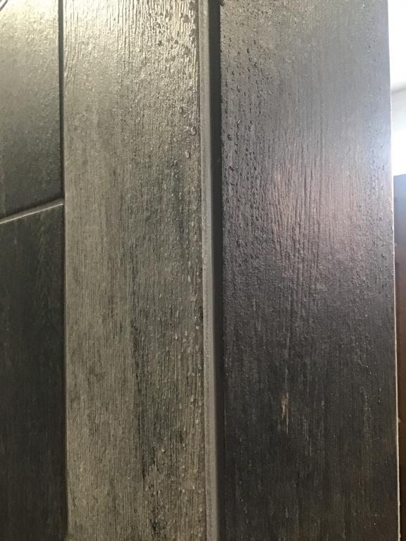

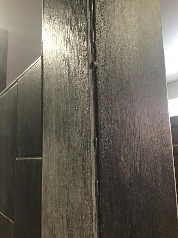

Pullstart 71,455 #272 Posted January 13, 2020 Maybe people know this, maybe I’m the only one that was in the dark. 100% silicone is a killer to get right! I found a video where the guy put the silicone into his joint, then spritzed the area with NON-AMMONIA glass cleaner, then proceeded to wipe with a glass cleaner wetted finger. What a difference this trick makes! 2 Share this post Link to post Share on other sites
