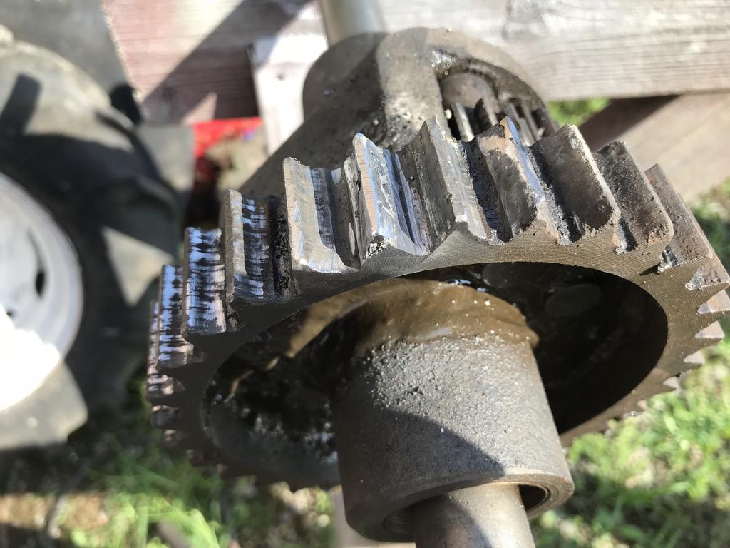

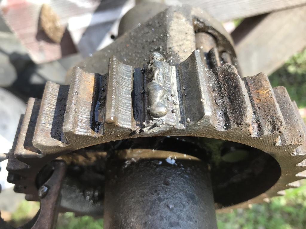

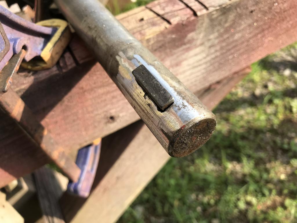

dells68 7,499 #52 Posted July 27, 2018 Had about an hour or so after mowing the yard this afternoon, so I decided to mess with the bull gear and worn axle key hole. Welded them up best I could. Welding cast is not my thing. The axle was easier. I've still got to clean up the gear a little with my dremmel. Think it will be ok? 8 Share this post Link to post Share on other sites
AMC RULES 37,259 #53 Posted July 27, 2018 Small application of JB weld... should take any remaining wobble outta that keyway now Dells. 1 Share this post Link to post Share on other sites

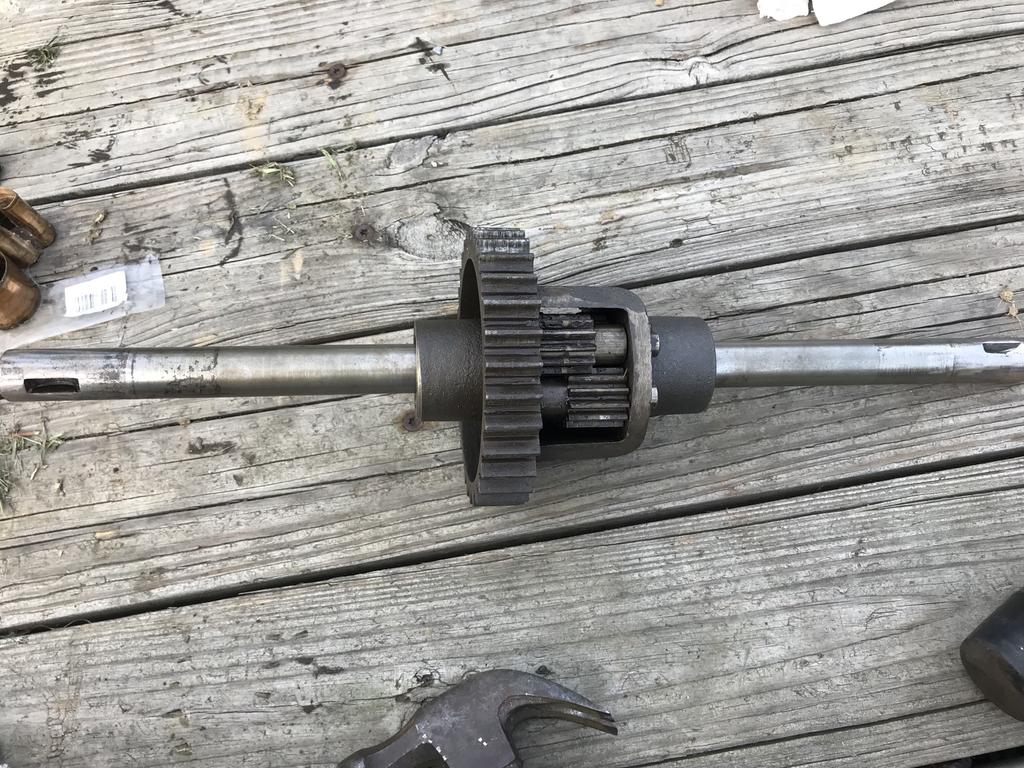

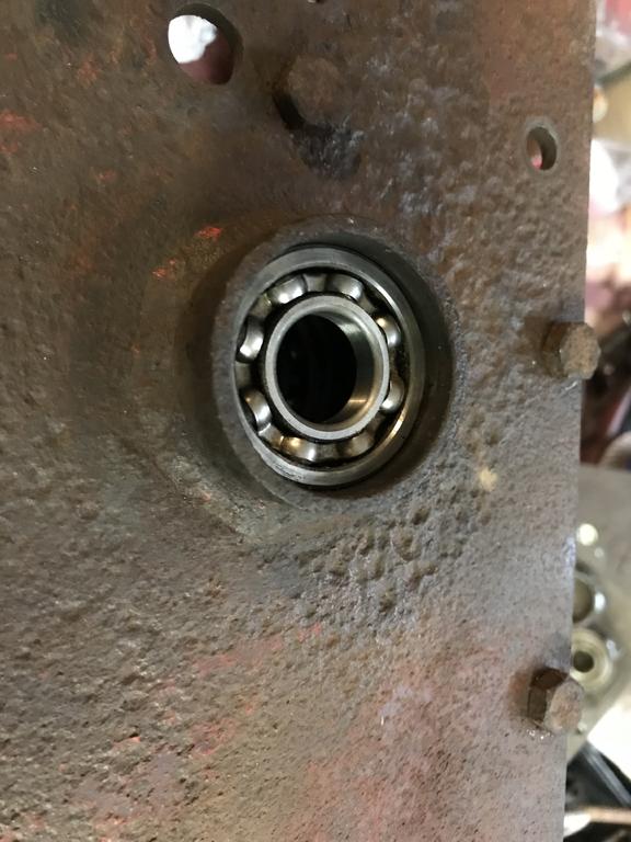

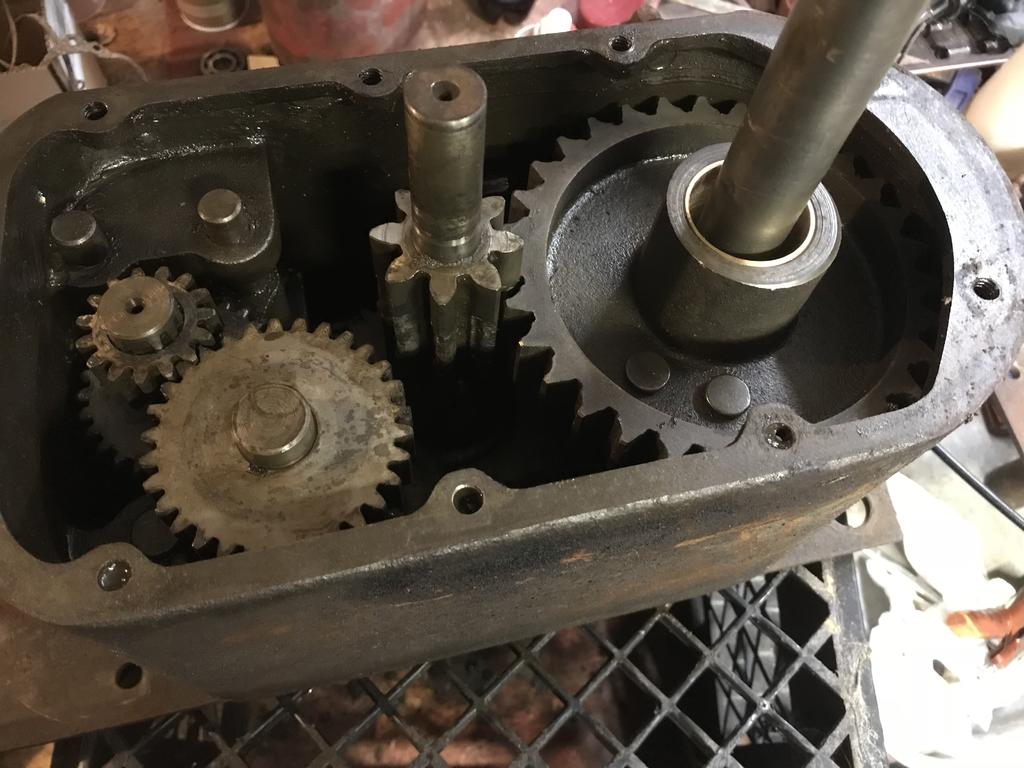

dells68 7,499 #54 Posted July 29, 2018 Worked on my tranny a little more today. I pulled the differential apart and installed and honed a set of Lowell's bushings. Went well. Pulled all of the old seals and got the axle bushings in and honed. Checked the bearings and oops! All three s8k bearings were full of crud and stuck. Managed to clean one of them up. The other three were good thank goodness! Managed to find two replacements on fleabay. This thing has had some serious abuse and corrosion inside. Check out the spider gears and the corrosion on them. Guess I've slowed down till next weekend when my bearings come in. 3 Share this post Link to post Share on other sites

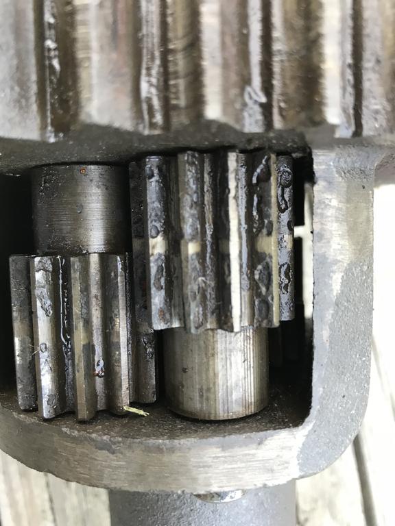

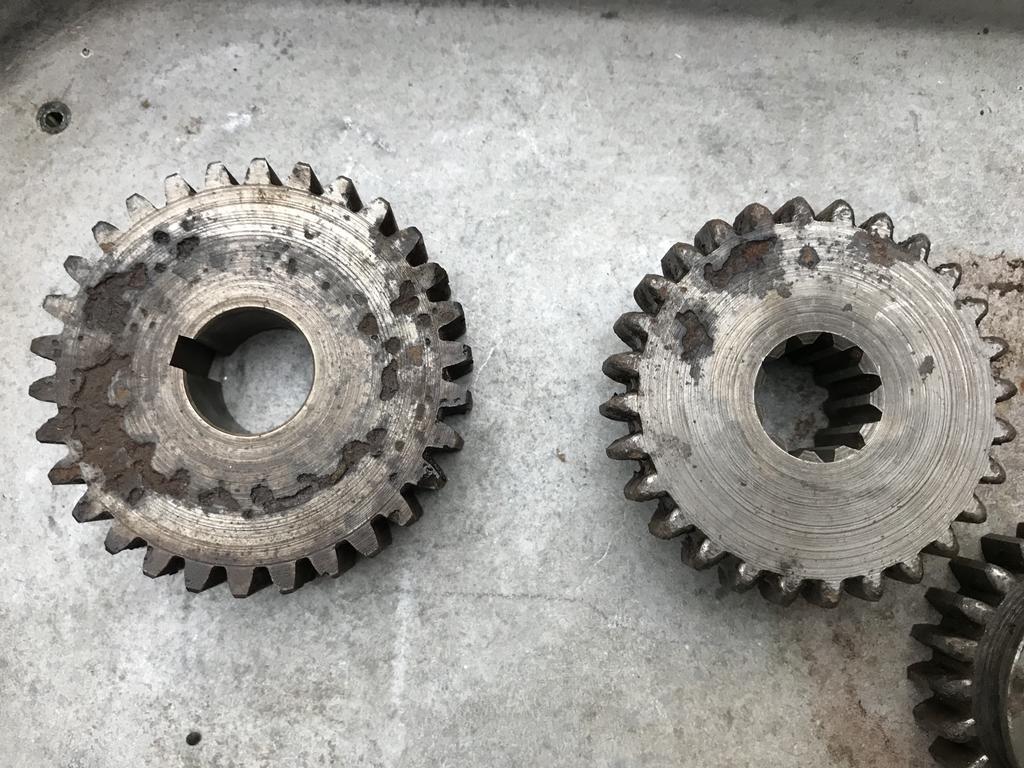

dells68 7,499 #55 Posted July 29, 2018 Pic of a couple of the gears and their damage. This thing must have had water in it for a long time! 2 1 Share this post Link to post Share on other sites

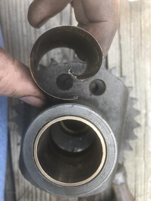

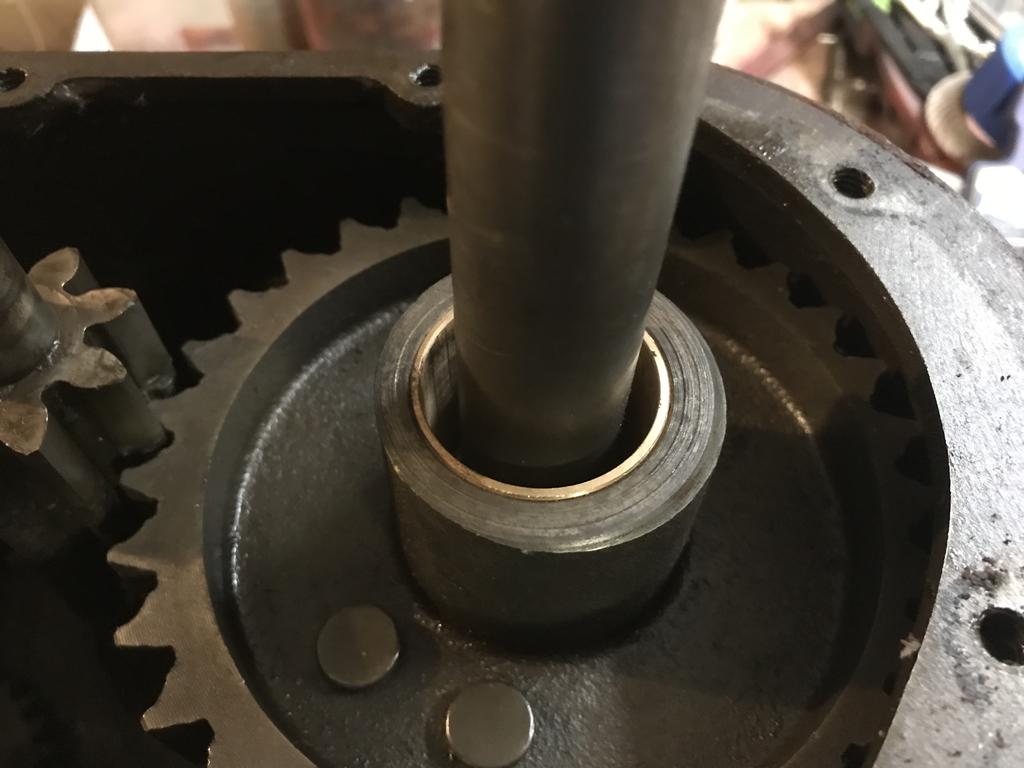

stevasaurus 23,704 #56 Posted July 29, 2018 The camera makes all defects look worse. Nothing wrong with those gears, and I think you are OK with that bull gear weld job. I think you may need to hone out that bronze bearing...you want a loose fit...not snug. If it is snug, when you tighten the case bolts, you may bind up the trans. 1 1 Share this post Link to post Share on other sites
dells68 7,499 #57 Posted July 29, 2018 Thanks @stevasaurus. I honed them till they move pretty smoothly on the trans sides. The part they slide onto is worn pretty good (deep grooves) and I plan on hitting them with some 220 to smooth them out and I hope that will leave me with enough play. I've opened other transmissions on Emory's suburbans and was able to get by with using the original bronze bushings in the differential, but these were worn way too thin. I really appreciate your help and knowledge and following along to keep me straight - Lord knows someone needs to!😂 2 Share this post Link to post Share on other sites
stevasaurus 23,704 #58 Posted July 29, 2018 Now that I know what you have going...I will help when I can and keep an eye out. Signal me if you need anything quick. Keep the good pictures coming. 1 1 Share this post Link to post Share on other sites
dells68 7,499 #59 Posted July 29, 2018 4 minutes ago, stevasaurus said: Now that I know what you have going...I will help when I can and keep an eye out. Signal me if you need anything quick. Keep the good pictures coming. Will do. I've rebushed and put seals in two of the suburban 3 piece transmissions, but have never had to go this deep into one. Guess there's a time to learn and just be thankful for the help we have here! What would we all do if we didn't have each other to lean on? 2 1 Share this post Link to post Share on other sites

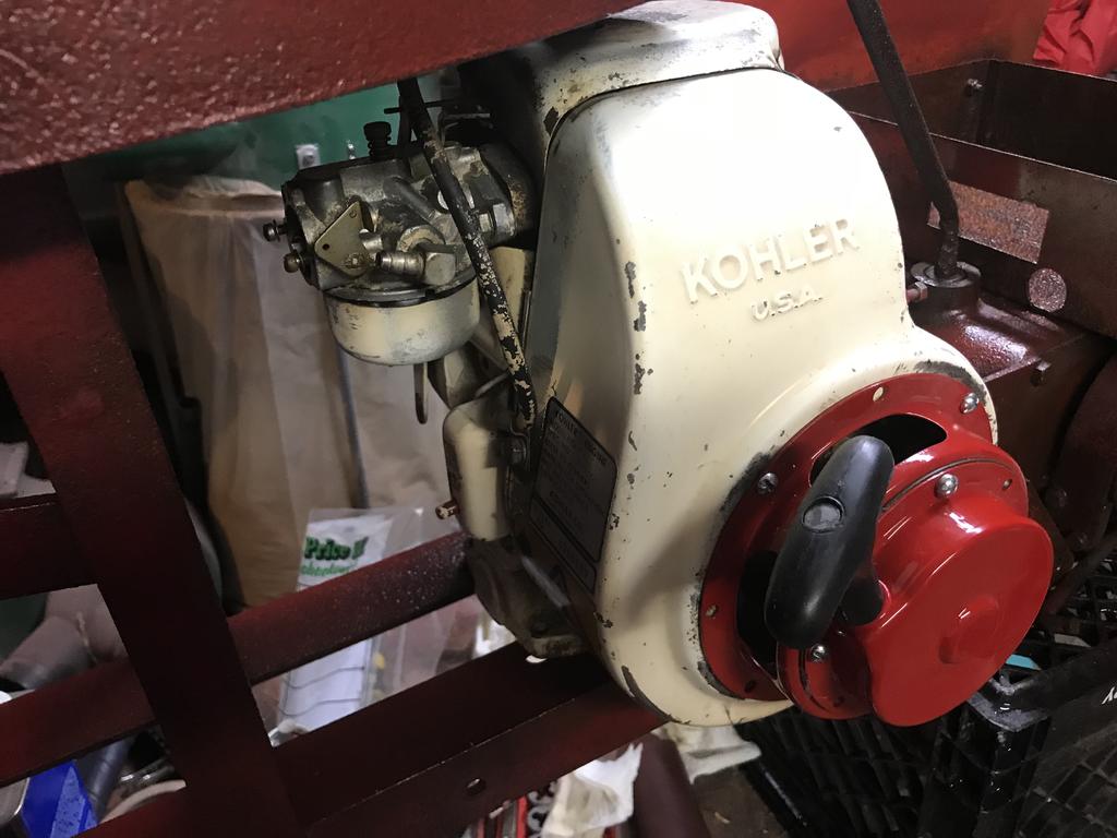

dells68 7,499 #61 Posted August 1, 2018 I decided to get out the little K91 that i got from @BOB ELLISON at the Big Show. I really can't believe how smooth this little guy runs. I can't wait to get it on the rj. I've got one of Jake's @Jake Kuhn Recoils for it. What do you think about the finish for the engine? Leave it white with the nice recoil on it? Paint the engine to match the recoil? Im not sure. Oh well, here's a video of it running to get your juices flowing😉. 1 4 Share this post Link to post Share on other sites
rjg854 13,072 #62 Posted August 1, 2018 Sure do sound nice 1 Share this post Link to post Share on other sites
BOB ELLISON 2,983 #63 Posted August 1, 2018 @dells68 I glad you like it. I know it ran sweet for me but I don't have anything to use it in. It idles as good as my c160. I would repaint it red like the recoil. Just don't paint it green or I'll come get it back. Haha 4 Share this post Link to post Share on other sites
ebinmaine 79,112 #64 Posted August 1, 2018 19 minutes ago, BOB ELLISON said: don't paint it green or ..... You're going to need an intervention 1 Share this post Link to post Share on other sites

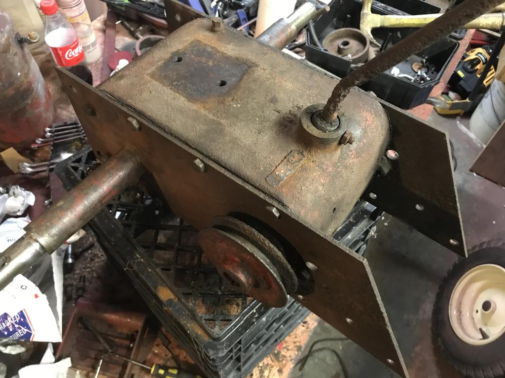

dells68 7,499 #65 Posted September 18, 2018 Well, thanks to Florence, I finally found a few minutes to work on the rj transmission. After about 2 hrs in the garage I have a working trans again. Check out the machining on the differential and how out of spec it is. Its got new bearings, new bushings, gaskets, and soon new shaft and axle seals. Heaven knows when I'll get back to it again after tomorrow night. I'll update you guys when I do get another chance to work. By the way don't be jealous of my spotless, pristine workspace😂. 5 Share this post Link to post Share on other sites

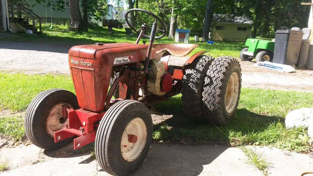

Chris G 3,373 #67 Posted September 18, 2018 Glad to see you got some more time in on the rj. Also I would say leave the engine white if the machine is gonna keep its patina. These are 2 of my suburbans that i had put white engines on. 2 1 2 Share this post Link to post Share on other sites
Pullstart 70,087 #68 Posted September 18, 2018 That’s a crazy casting center! Maybe it’s a counter balance for something! 1 Share this post Link to post Share on other sites

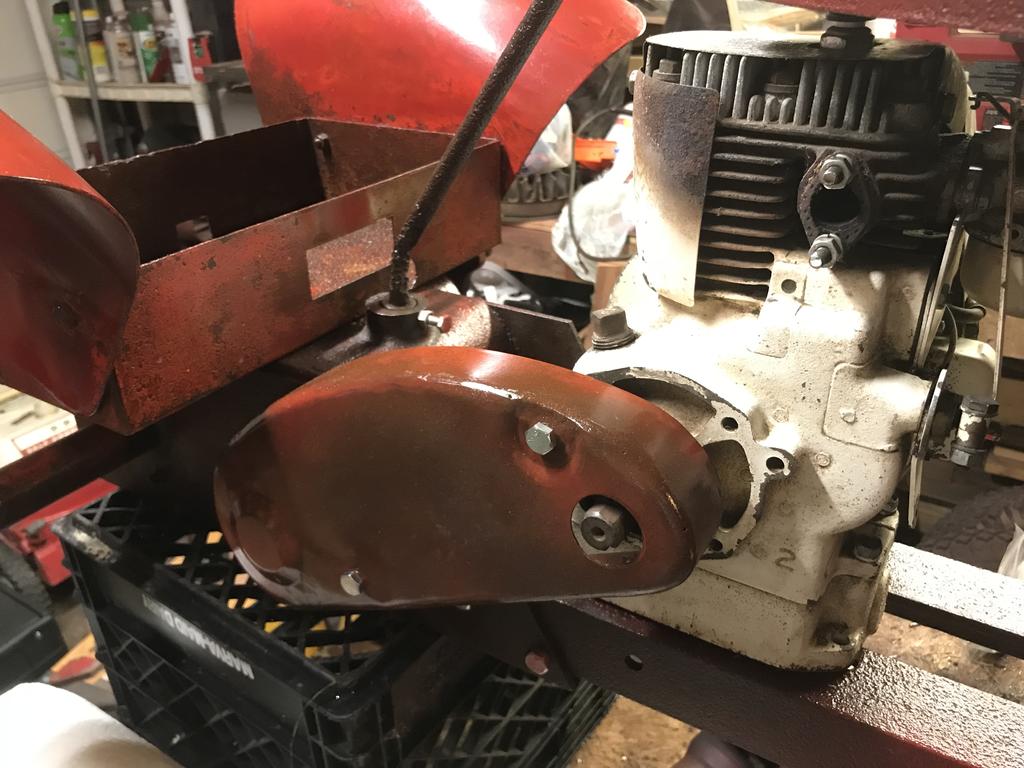

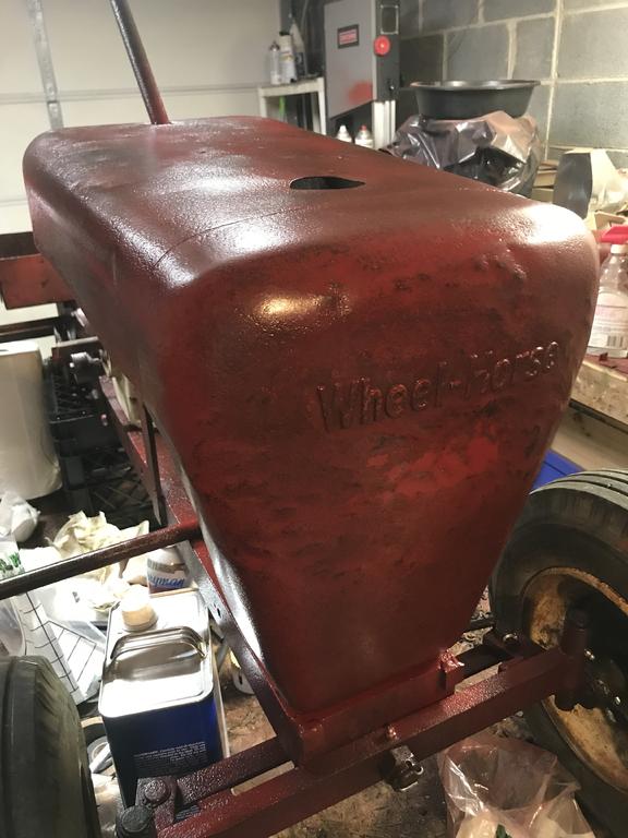

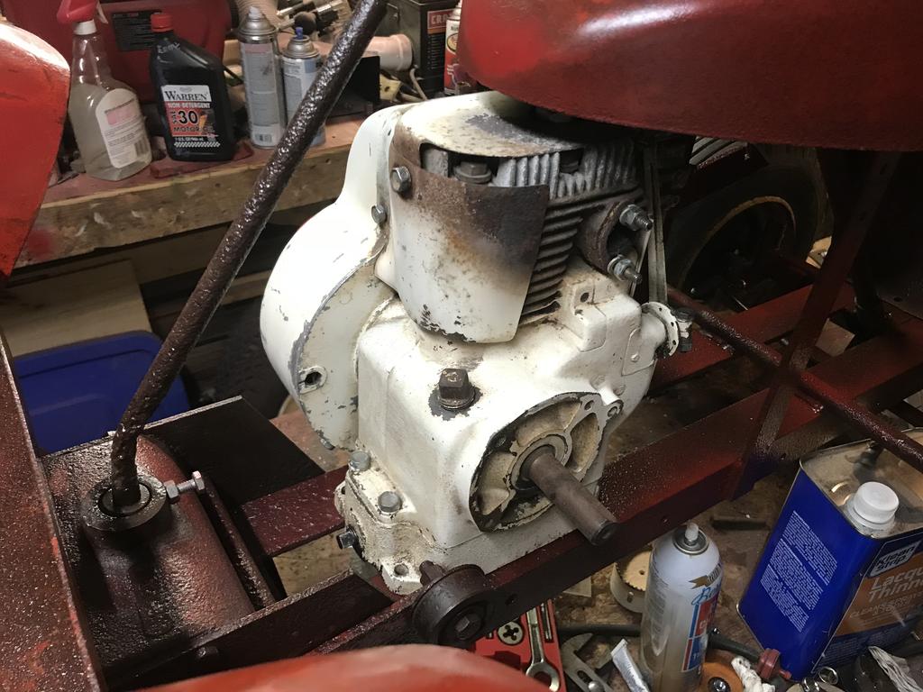

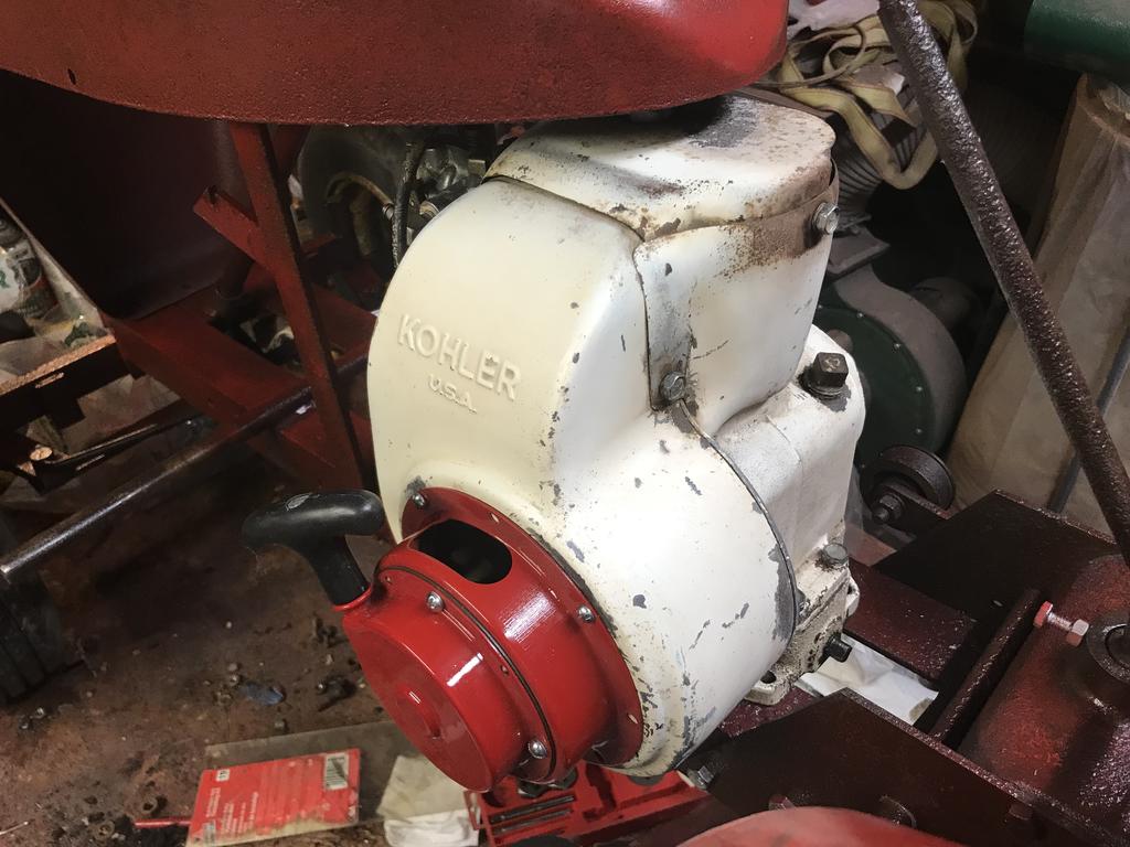

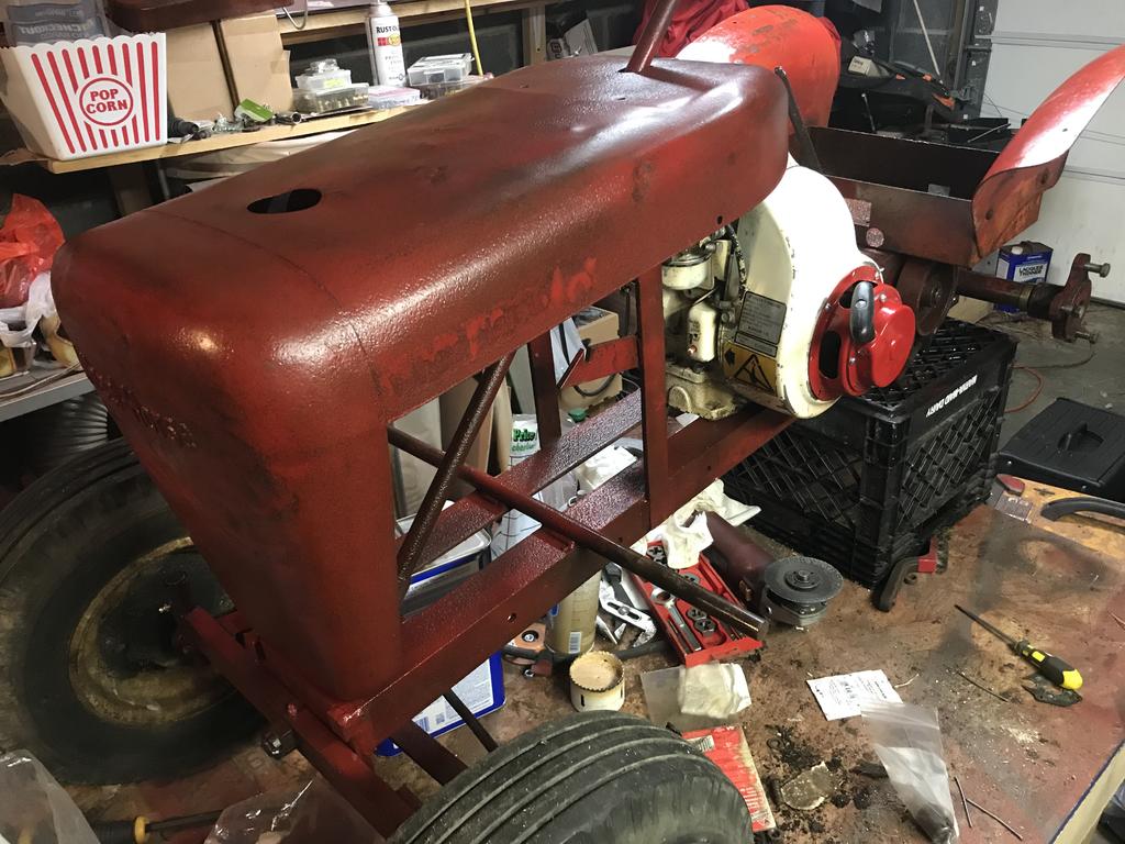

dells68 7,499 #69 Posted October 16, 2018 Well, I got a little more time to mess with the rj. I added a little red to the patina and wiped it with lacquer thinner and sanded with fine paper before clearing. I cleaned the engine with a little laquer thinner and the white pops. I tried the schnacke that I got from @Jake Kuhn, and loosely fitted my homemade belt guard, hood, and fenders to see how it will look. So far I’m pretty happy with how it looks and I’m thinking of clearing the engine to preserve that earned patina on the white. What do you guys think? Please ignore the mess in the garage! 5 1 Share this post Link to post Share on other sites
Chris G 3,373 #70 Posted October 16, 2018 It's looking great! The belt guard came out amazing and I would say a little clear on the motor, just to keep a even shine across the whole machine. But great job so far. It's really coming out nicely 1 1 Share this post Link to post Share on other sites
stevebo-(Moderator) 8,646 #72 Posted October 16, 2018 You did such a nice job with paint and distressing to patin look that you should keep going on the wnginw😳. You may be able to find a set of patina tins so you would only have to paint the block. I know it is more work but I think it would finish the project well. 2 1 Share this post Link to post Share on other sites
71_Bronco 1,072 #73 Posted October 16, 2018 Looks great so far, love the patina look. I personally like the white motor with the white wheels, gives a little contrast and doesnt look so monochromatic. 1 Share this post Link to post Share on other sites
dells68 7,499 #74 Posted October 16, 2018 Ok @71_Bronco, you’ve opened up another can of worms. I kind of like the white on the motor too, but I don’t know what to do with the wheels. I’ve considered painting them white, but then I like the black that @stevebo does too. If I stay with white wheels, I might leave the motor white, but black wheels would need a patina motor. I do have another original patina k91 that I could trade the tins for if I go that route. I would use that motor, but it needs a rebuild first. Also, white wheels, white seat. Black wheels, black seat. 2 Share this post Link to post Share on other sites
