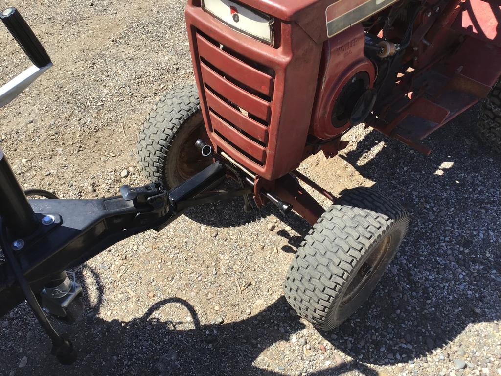

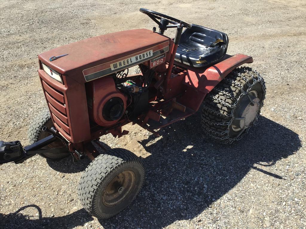

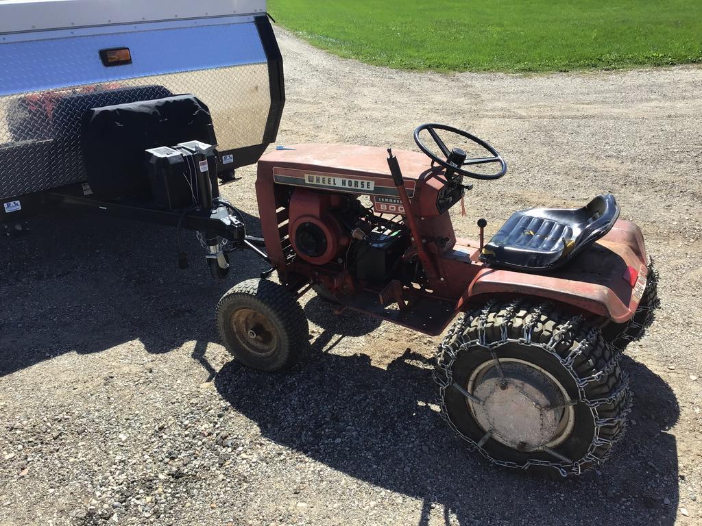

Pullstart 71,098 #30 Posted September 12, 2018 Did a little work on Screamin’ Jimmy, out of necessity. You see, Rylee’s behind is just too light! Plus, I promised my mom a spot in the barn for the winter for her camper. The rear tires and weights are from the Charger 12, I picked up the chains from @dells68 for a buddy but he’s getting by with my loaded ags for now, and put together a front hitch for moving trailers. 1 Share this post Link to post Share on other sites
ebinmaine 80,279 #31 Posted September 12, 2018 44 minutes ago, pullstart said: front hitch Looking good Kev. Like that front hitch. I should probably get one of them on one of the tractors I have here. That would give me an excuse...... uummmmm ..... Reason... To keep that tractor around. We're practical here you know. 1 Share this post Link to post Share on other sites
Pullstart 71,098 #32 Posted September 12, 2018 1 minute ago, ebinmaine said: Looking good Kev. Like that front hitch. I should probably get one of them on one of the tractors I have here. That would give me an excuse...... uummmmm ..... Reason... To keep that tractor around. We're practical here you know. Its pretty much a scrap pile special, cut up a 4 way lug wrench for the main frame, set the hitch on some wood blocks and started welding supports in where I saw fit. The 4 way fits the mule drive tach-a-matic just dandy 1 Share this post Link to post Share on other sites

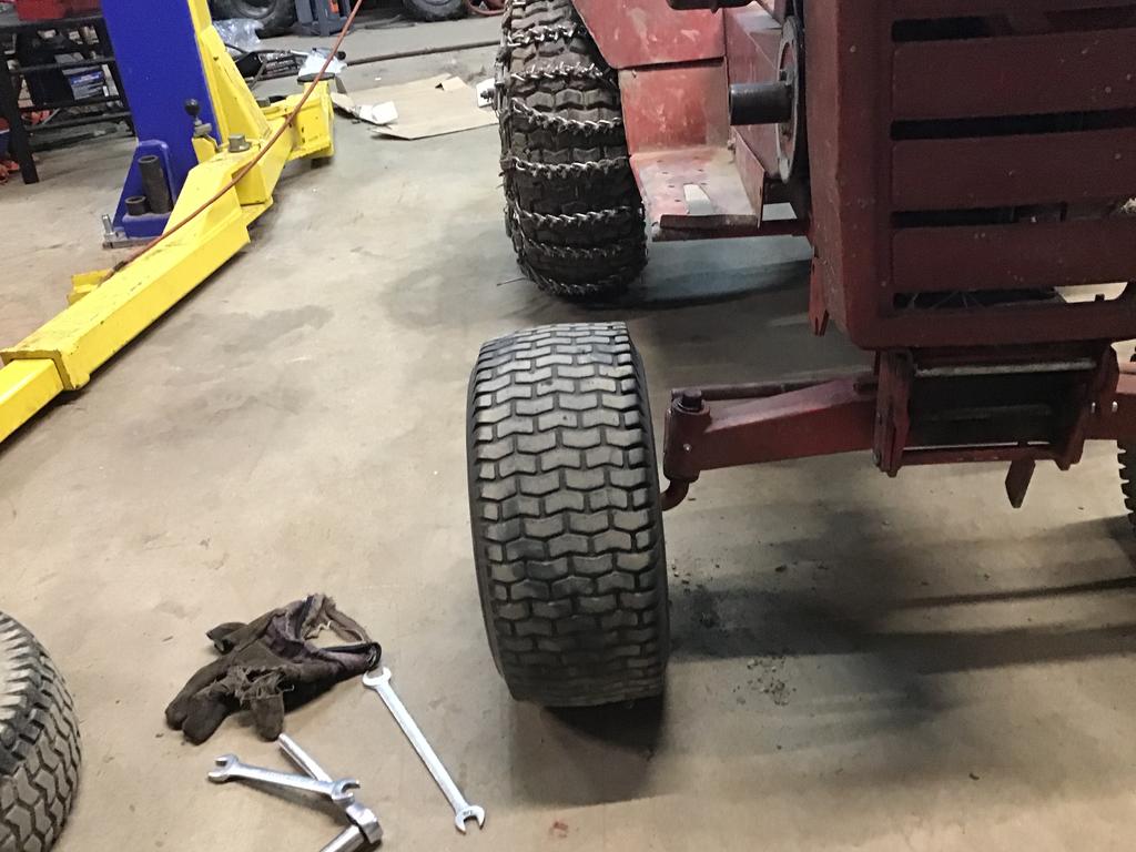

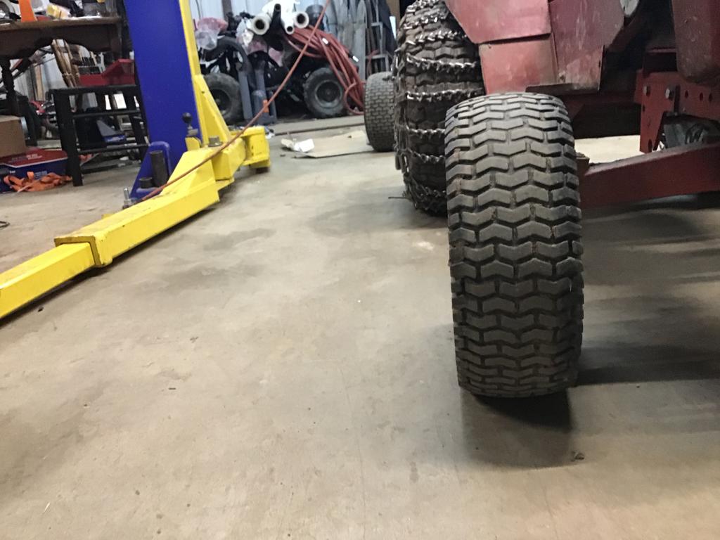

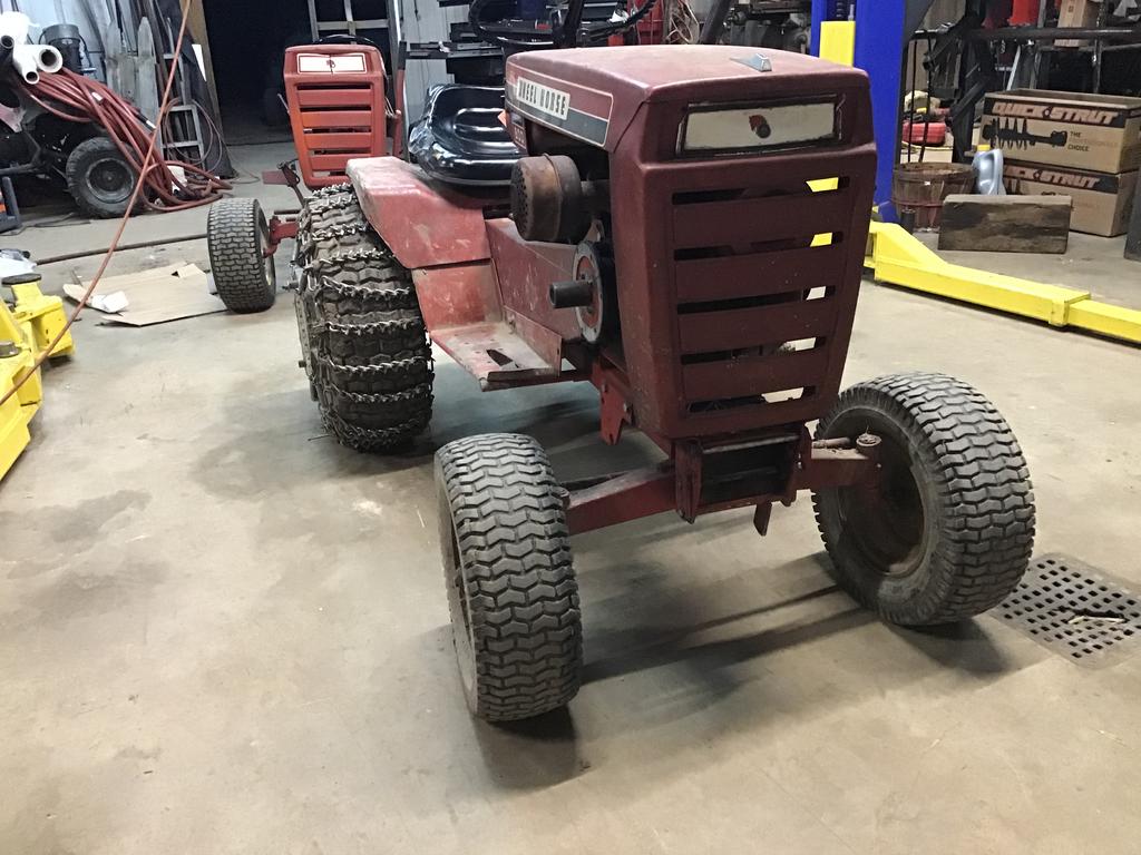

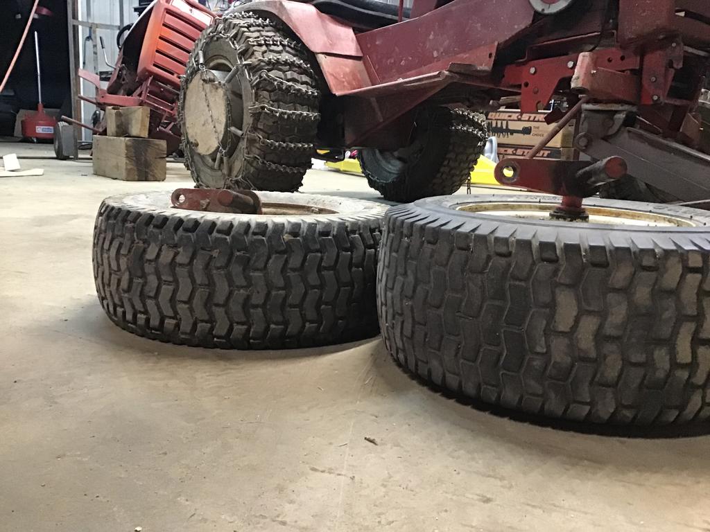

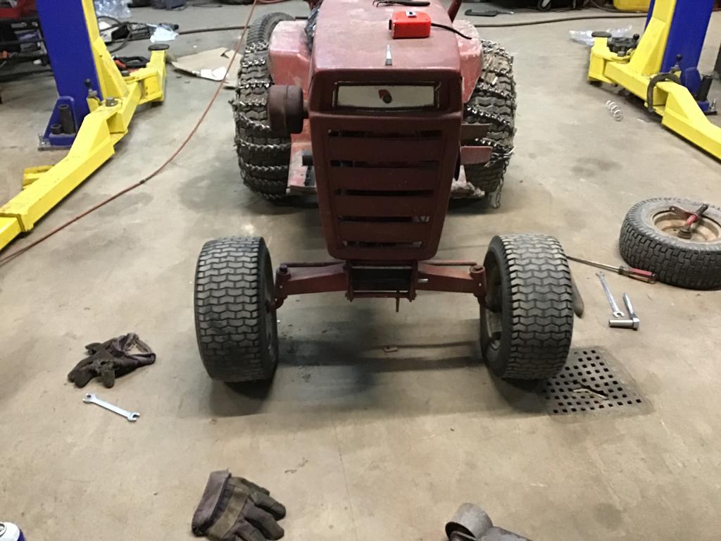

Pullstart 71,098 #43 Posted April 4, 2019 Earlier I posted a question asking for transition years and details in regards to steering and turning radius. Here’s some more detail... I want to widen Screamin’ Jimmy’s front end a bit. I believe these C-101 parts might just work out, but I might end up just swapping spindles. They measure the same width between the grease zerks. Share this post Link to post Share on other sites

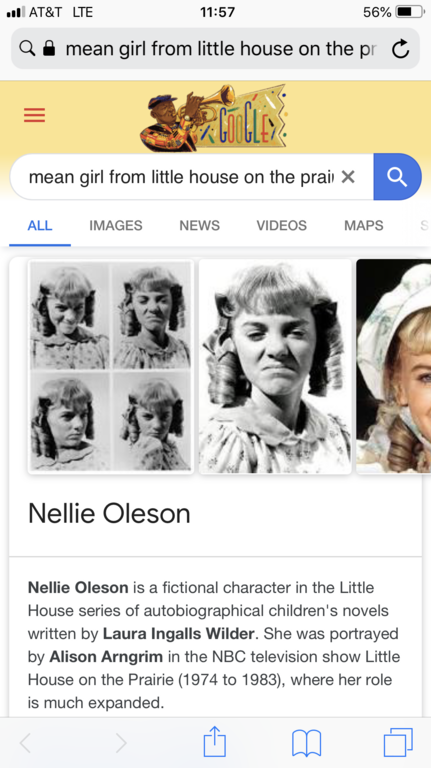

Pullstart 71,098 #48 Posted April 4, 2019 2 hours ago, LengerichKA88 said: As long as you don’t have the little girl who’s dad ran the general store... I don’t remember her name but I hated her 😂😂 Nellie Oleson. I’d had to smack her if she were mine. 3 Share this post Link to post Share on other sites
LengerichKA88 1,885 #49 Posted April 4, 2019 This is how I found her name earlier because it was bugging me 😂😂 2 Share this post Link to post Share on other sites
