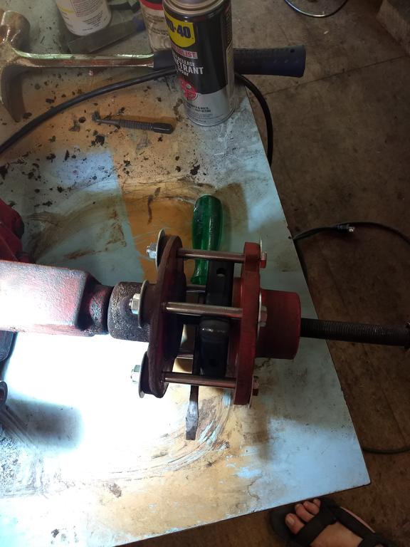

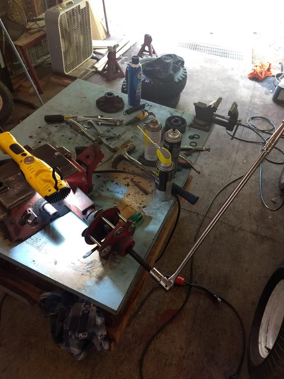

ebinmaine 80,438 #6 Posted June 24, 2018 13 minutes ago, Dakota said: Also what’s Lowell? I did a google search and couldn’t find anything Hehehe.... Lowell is a who, not a what. No worries. He's one of our listed Redsquare vendors... And a great guy. Look in our vendors section and go to Wheelhorse parts and more. I'd Highly advise calling and talking to him to insure getting the right parts kit. You'll need to remove all 4 things in front of the seals to change them. As for removal: The brake pulley uses a C-clip to hold it on and should come of fairly easily. The input pulley is held with a set screw and should pull off ok with a medium to large 3 jaw puller. The hubs now.... I can't stress this enough... They can be tough to remove and require A LOT of patience. The BEST way to remove a hub is to get a junk hub from @A-Z Tractor and set up a puller using that hub do as to Incorporate all 5 hub bolt holes. See the pics. 1 Share this post Link to post Share on other sites
