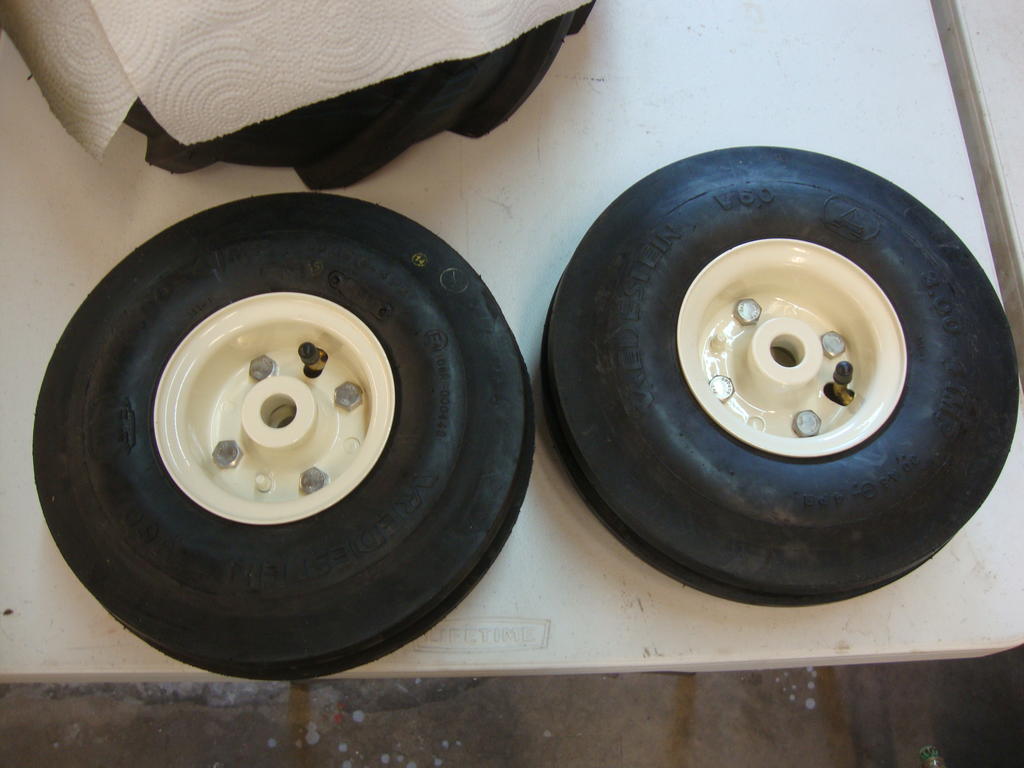

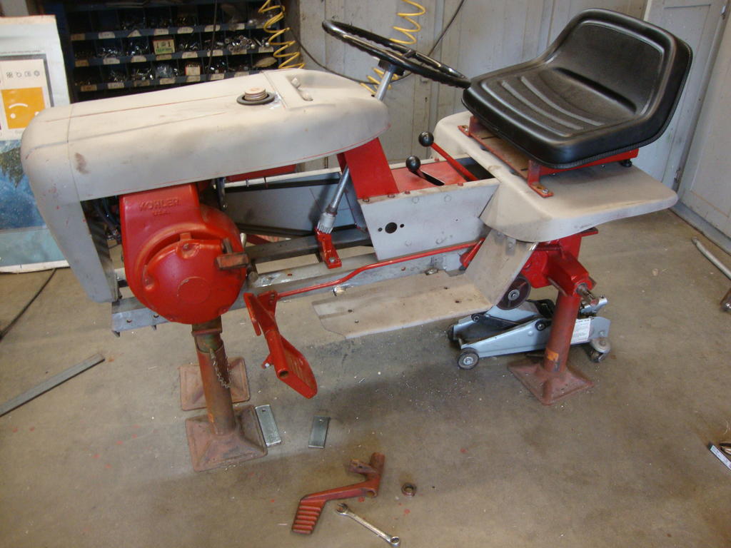

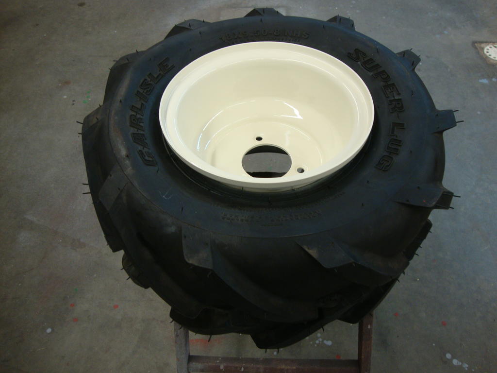

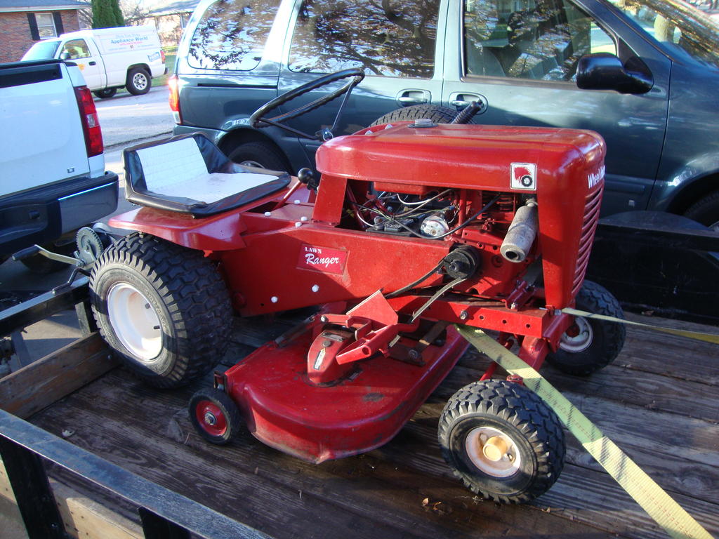

dclarke 4,113 #1 Posted June 16, 2018 (edited) I pick this Ranger up a few years ago with the intention of building something my grandkids can drive when they get a little older. I took it apart a while back (a long while back) and it's been sitting on the shelf. I've gotten rid of the Tecky and the mower deck, I have a K161 pull start Kohler I'm gonna put in it and I'm planning on adding a second clutch pedal so the kids can reach it as well as a set of running board style foot rests to keep their feet out of the back tires. I've also got an 8 speed tranny here so I'm going to see if I can make it fit too. This tractor is gonna get a rattle can paint job, it's just easier with my limited shop space and the kids will likely scratch it up anyway. I took a few parts to get blasted yesterday and got those back today, I think I'm going to mock up the frame, tranny, engine and seat pan before I paint those pieces. I'm going to need to add a 3/4" rod to the frame for the extra pedal and some kind of bracket for the foot rest and probably have to add a mounting tab to the drive belt cover so it'll fit the Kohler. I picked up a set of tires from Miller Tire and have those mounted, at this point I'm still painting the rear rims so I won't inflate those tires until the paint drys. Edited June 16, 2018 by dclarke 3 11 Share this post Link to post Share on other sites

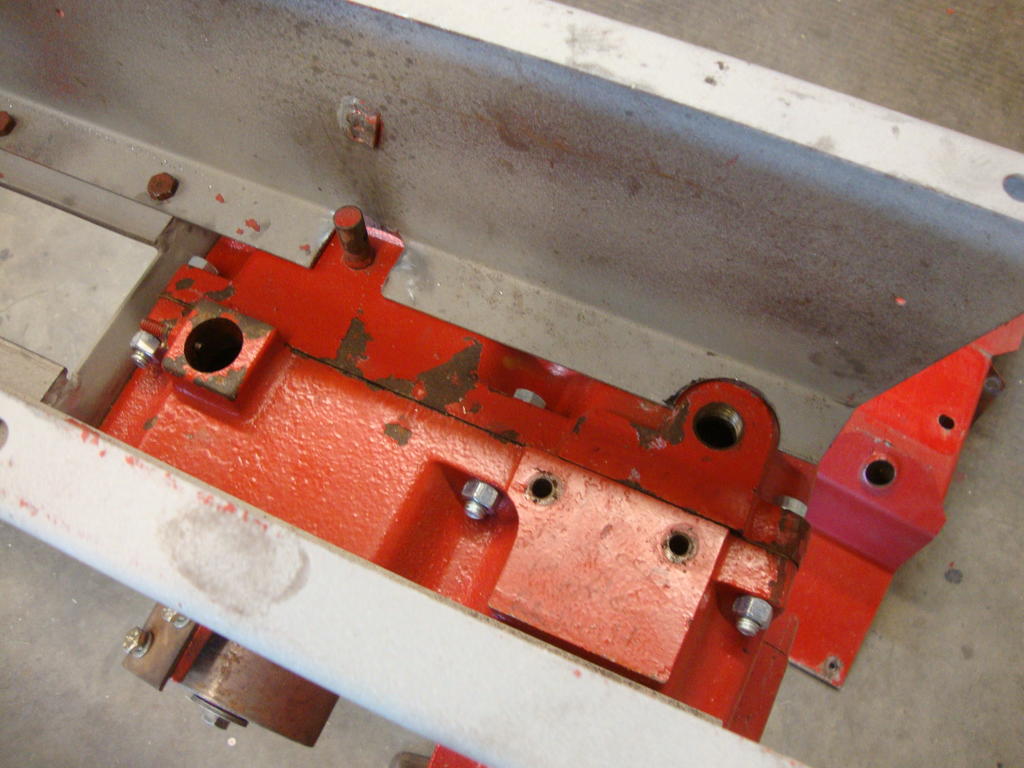

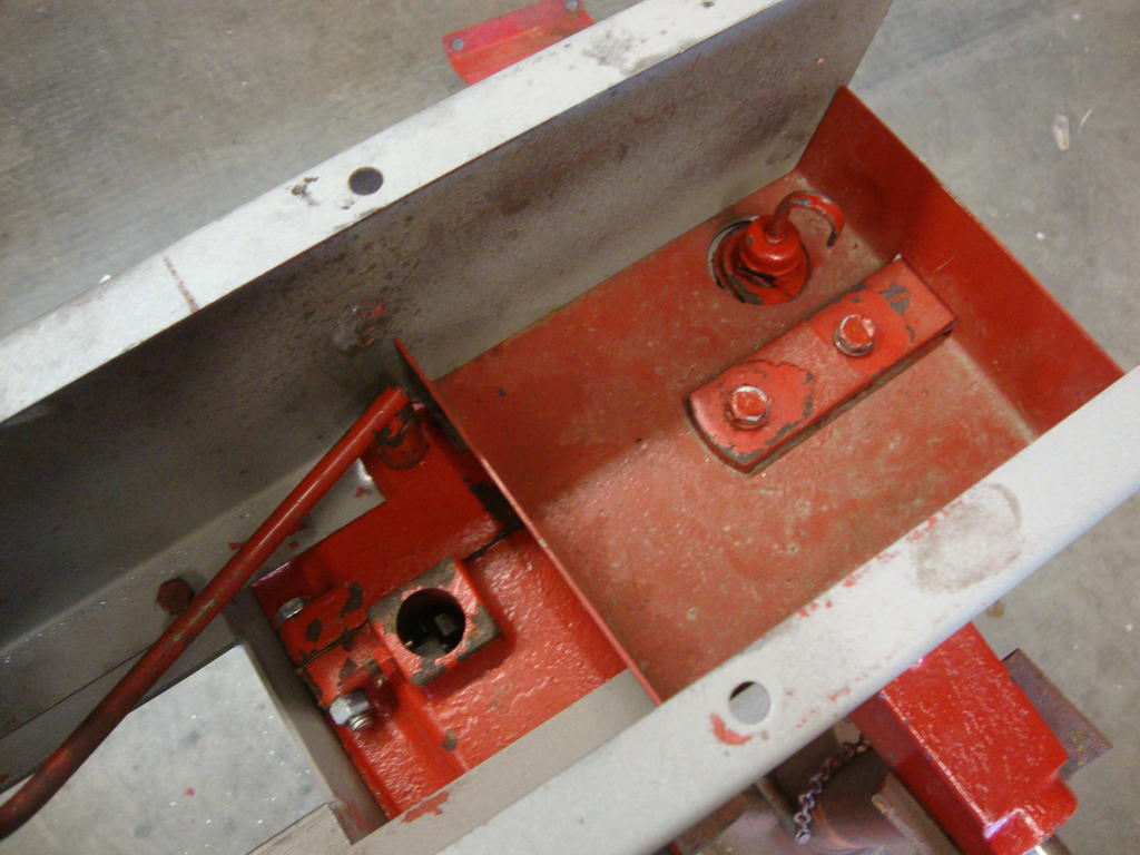

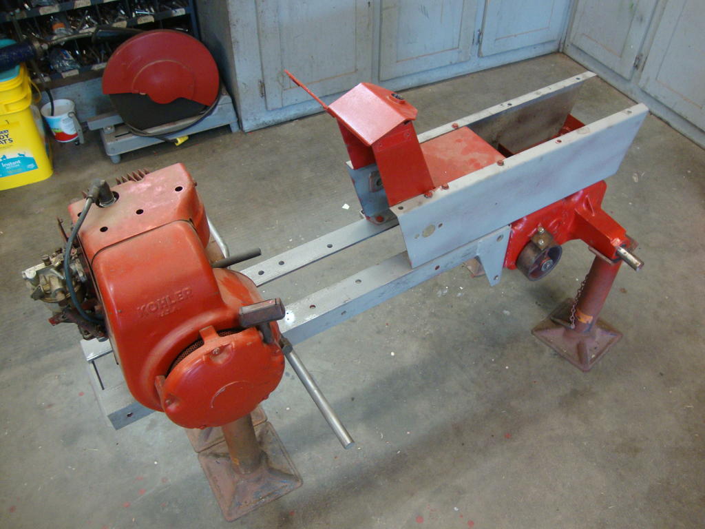

dclarke 4,113 #8 Posted June 16, 2018 I started piecing this thing back together to see what modifications I need to make before paint. I had to modify the R.H.side panel and the tool tray to clear the hi/lo shift lever and the tranny dipstick on the 8 speed. 7 Share this post Link to post Share on other sites

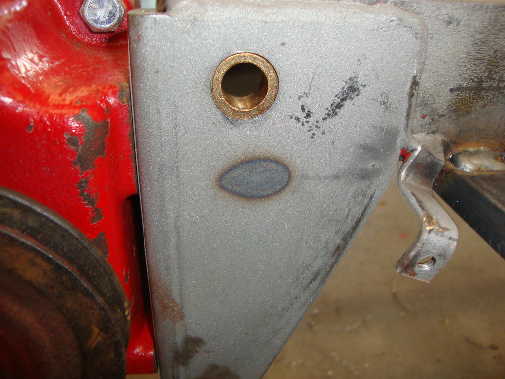

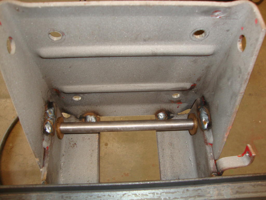

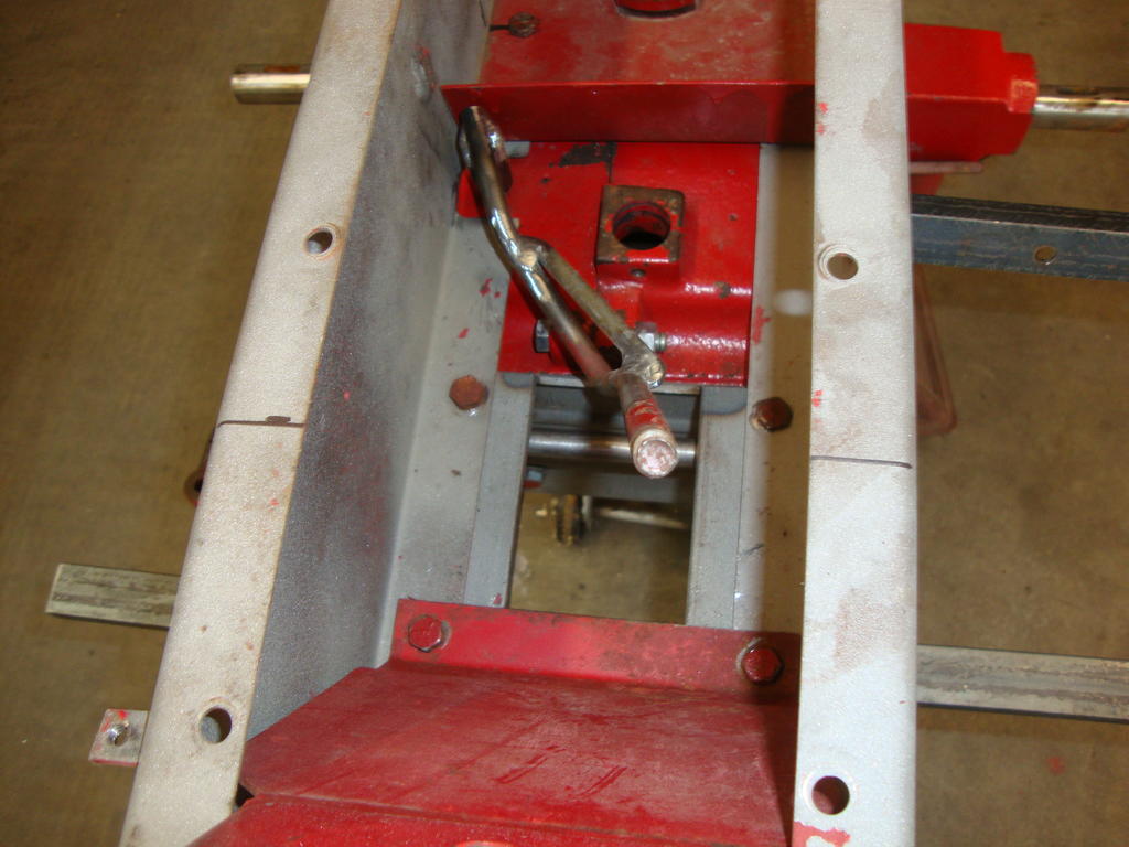

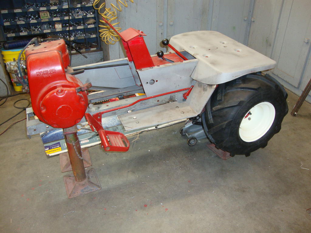

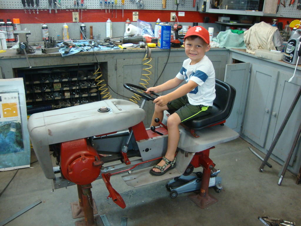

dclarke 4,113 #9 Posted June 23, 2018 I've managed to get a little more done this week. I had to shorten and bend the trans hi/lo shift lever to get it where I wanted it, I also added a brace to stiffen it some then cut a slot for it in the tunnel cover. There was some play in the frame where the drive belt idler pulley shaft goes thru it so I reamed the holes out and added bushings to fix that. Then I cut a pair of foot rests from a B series tractor down to fit this Ranger and added a couple of braces to the frame to support them. I've still got a little tweaking to do to them but I'm pretty happy with how they fit. I decided to use a different steering wheel so I need to get the seat mounted and figure out what height I want the steering wheel to be. In the pic it's mounted to the original Ranger steering shaft and I think it might be too low. 4 3 Share this post Link to post Share on other sites

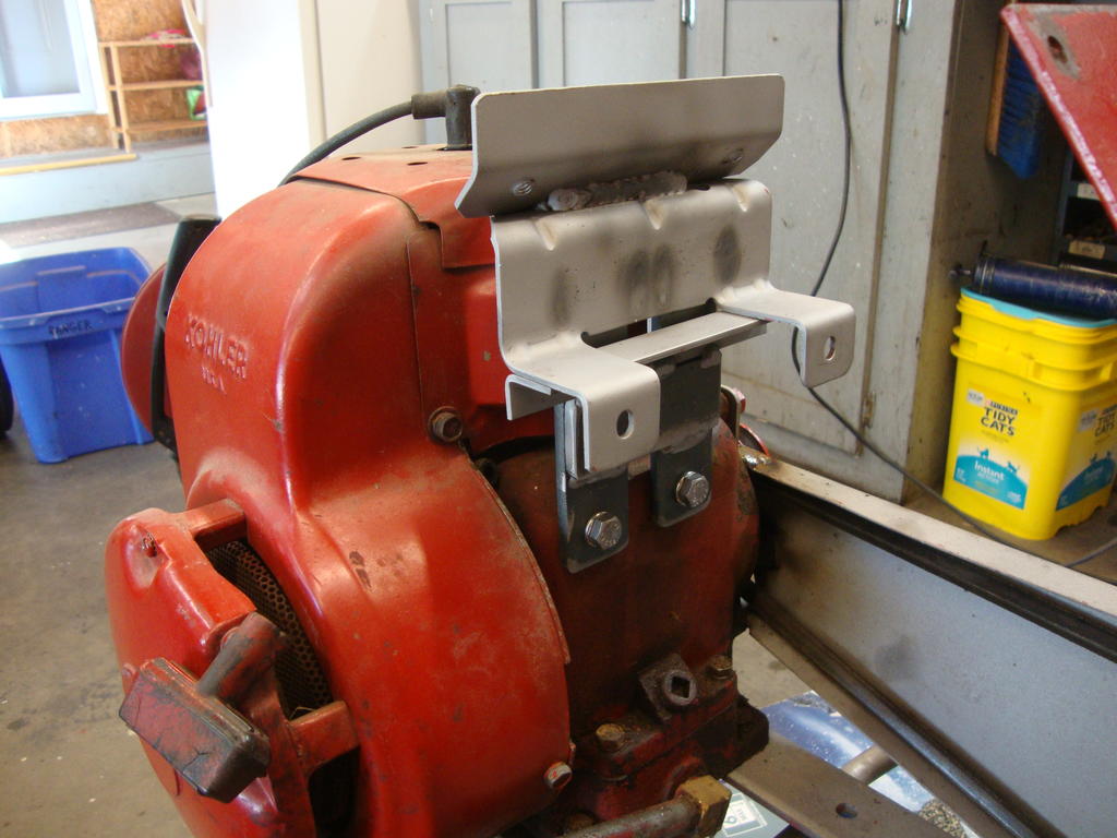

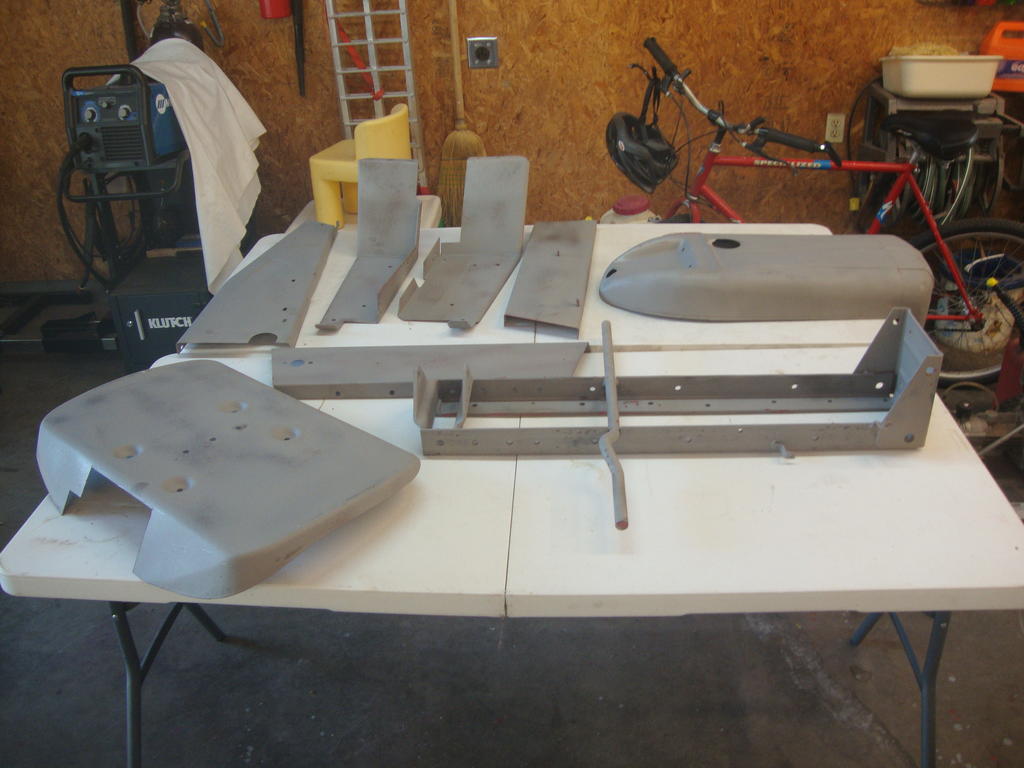

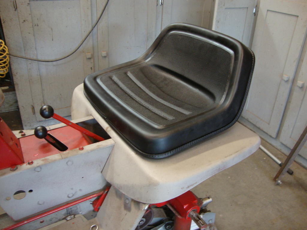

dclarke 4,113 #10 Posted June 28, 2018 (edited) This week I've had a chance to finish up the foot rests, patch the hole in the hood around the gas tank filler neck and rework the Tecky gas tank bracket to fit the Kohler and I've drilled the seat pan so I can either bolt the seat directly to it or use the flip up bracket with the seat springs. Edited June 28, 2018 by dclarke 7 4 Share this post Link to post Share on other sites

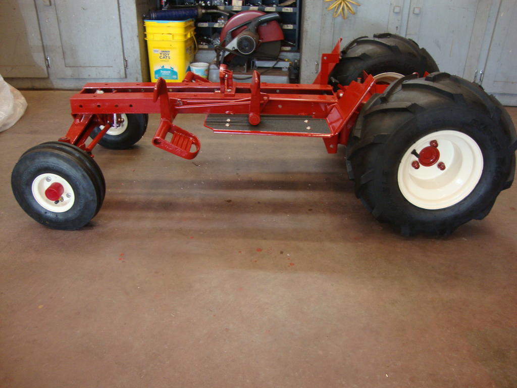

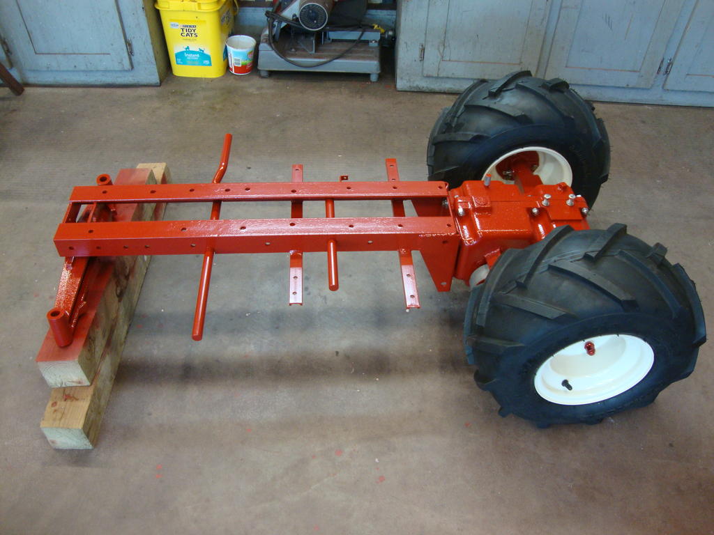

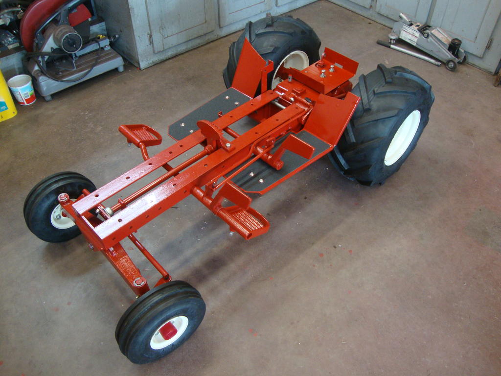

dclarke 4,113 #20 Posted July 8, 2018 I only have one pic of my progress this week. I've got the frame and several small parts painted and I disassembled the tranny in order to blast the cases and have it back together with new seals. I'm hoping to have a rolling frame in the next week or so. 6 Share this post Link to post Share on other sites

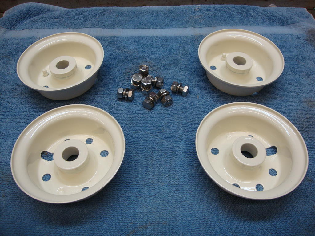

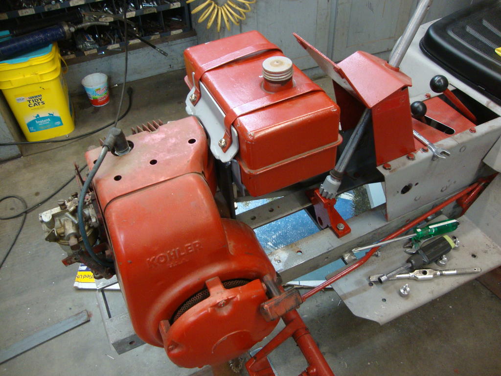

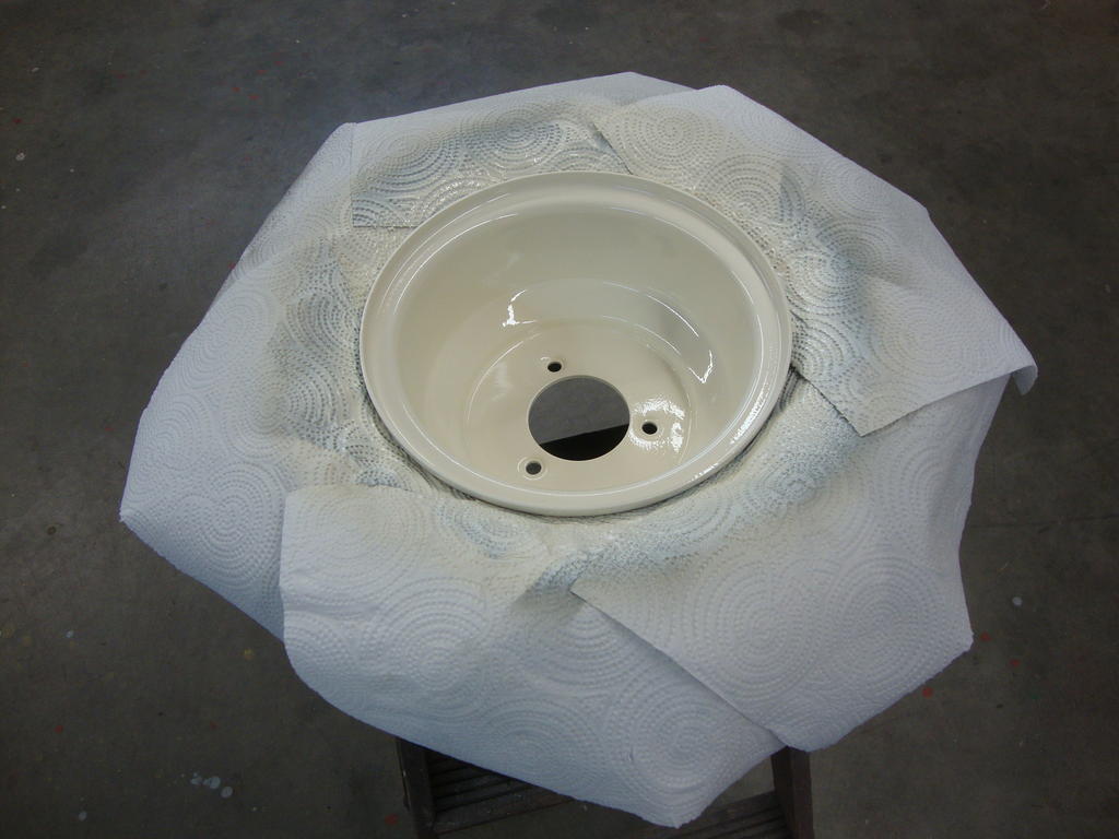

dclarke 4,113 #21 Posted July 8, 2018 Got a little bit done on a Sunday morning. 3 4 Share this post Link to post Share on other sites

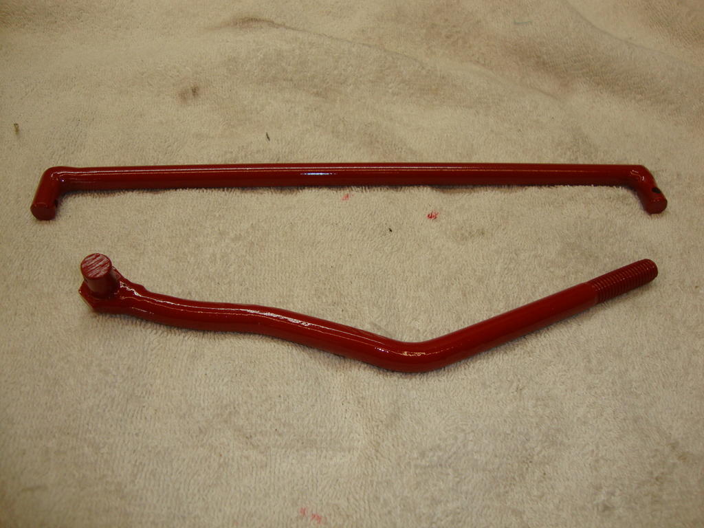

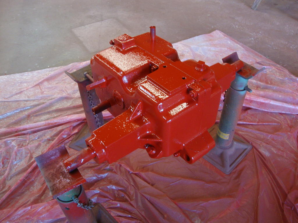

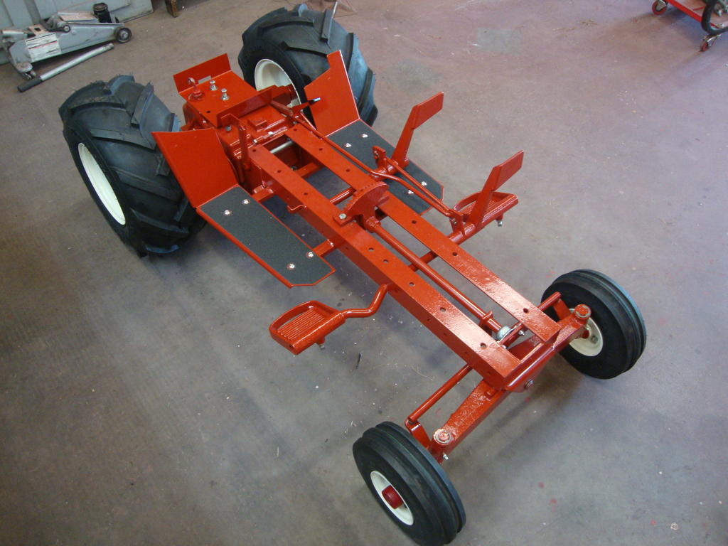

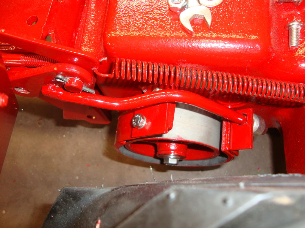

dclarke 4,113 #25 Posted July 16, 2018 The last few days I've been painting parts and have been able to get a few of them bolted on. I replaced the brake lining with a new one that I had in stock from our vendor Bob Maynard, had to reconfigure the rod that operates the brake band to get it to work and made a link to connect both pedals. Also got the front wheels on and some of the steering installed. Now it's back to watching paint dry. 6 Share this post Link to post Share on other sites
