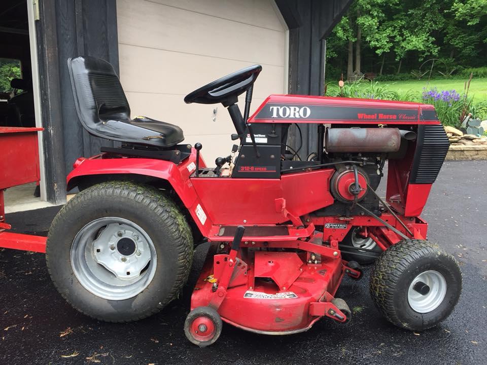

AndyK149 62 #1 Posted June 6, 2018 Hi All, I just picked up a 312-8 with 42" RD deck, plow and cart. I'm giving it a tune up with plugs, belts, filters and fluids. Going to add some LED lights to replace the old ones - should be nice in fall and winter! I also ordered the smaller drive pulley and belt to pick up the pace if needed. I never used the low range on any of the WH's before so am interested to try this out. We have a big Husqvarna zero turn which is our primary mower, but I grew up running WH's and wanted to get another mower for when my wife and I mow at the same time. The cart and plow will come in handy too! I regret getting a geared tractor over a hydro, but I feel like I got a good deal on the package. Maybe I will keep my eyes out for a hydro model for the future but for now the eight speed will do. The real reason I got it was because my little boy loves tractors and it is extremely difficult to take him for a ride on a zero turn since I need both hands to drive. We've already been on a few rides on the 312 and it was a hit!! Seems to be great information on this site so I figured I'd join. I wouldn't consider myself a real enthusiast but I have at least a few hundred hours on 3xx and 4xx series WHs and really appreciate their quality. 8 Share this post Link to post Share on other sites

jay bee 915 #7 Posted June 7, 2018 Andy to That is a sweet looking 312. My grandson loves to ride also. There's just something about a Tractor Ride!!! 1 Share this post Link to post Share on other sites

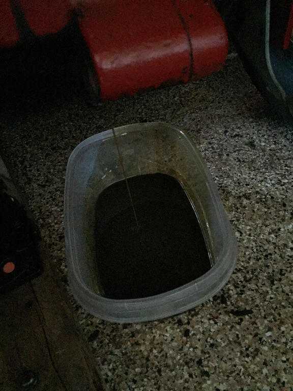

AndyK149 62 #10 Posted June 7, 2018 (edited) Thanks all for the welcome!! I already have my first stupid question! Does anyone know how big the transmission drain plug allen is? I tried a 6mm and it was very close but seemed like I need something bigger. Just wanted to check to see for sure before I strip it. Internal hex heads can be a pain! The rear discharge deck has really gunked stuff up back there. A bunch came out of the fill plug and it was chocolate milky so I want to get it changed. Shift boot had some tears so I suspect that is part of the problem. And I got a yard sweeper with the package so I will try that out. I've never used one before. A bagger for my zero turn is about $1000 alone, which is not something I can afford right now. I think a sweeper could be good to get up some of the long clippings from this rainy spring. Rest of the year I will just leave the clippings. Edited June 7, 2018 by AndyK149 1 Share this post Link to post Share on other sites
oldredrider 2,553 #11 Posted June 7, 2018 (edited) Tranny drain plug takes a 1/4" Allen wrench. Make sure plug is really clean so you get a good "seat" with the wrench before turning. Note: Unless something has been modified, all Wheel Horse nuts, bolts etc. are SAE, not metric. Edited June 7, 2018 by oldredrider 1 Share this post Link to post Share on other sites
AndyK149 62 #12 Posted June 7, 2018 Thanks for the tip. Things are flowing freely now. Fluid didn't look too bad! 1 Share this post Link to post Share on other sites

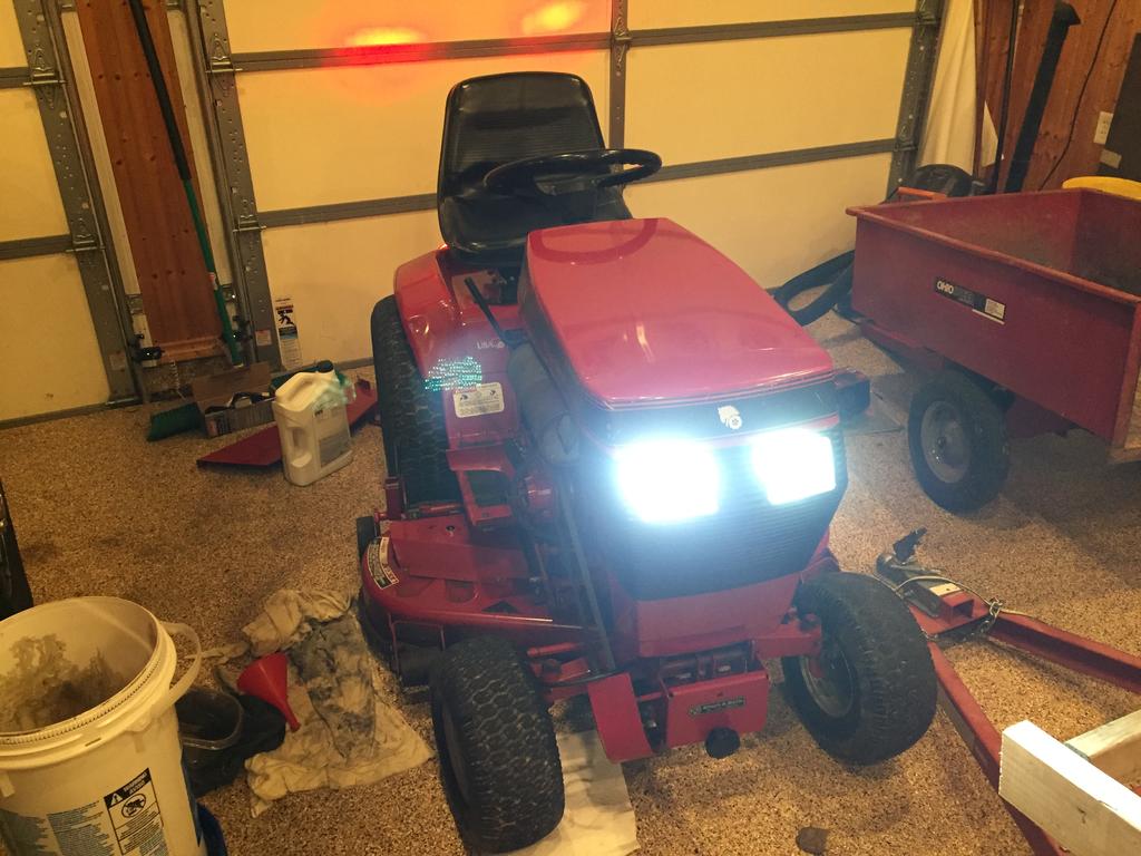

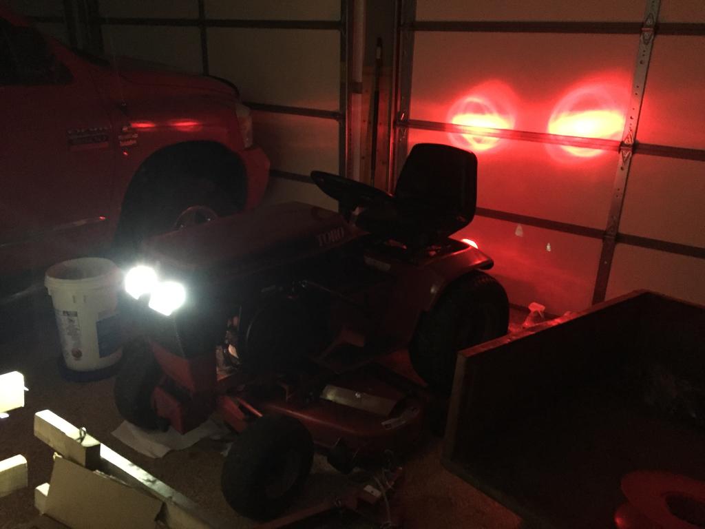

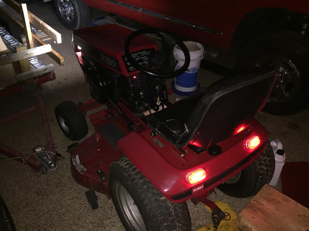

AndyK149 62 #19 Posted June 9, 2018 We finshed our tune up. Changed fluids, replaced fuel line and added in line filter, new air filter and spark plug. I replaced the broken tail lights with cheapo LEDs which look OEM to me. Added the PAR36 LEDs up front as well. I have got to say, I'm not one on fancy lighting but the PAR36s are amazing. A simple drop in replacement glass sealed unit. Super bright! 2 Share this post Link to post Share on other sites
AndyK149 62 #20 Posted June 9, 2018 Tail lights: https://www.amazon.com/gp/product/B00VT6V6N4/ref=oh_aui_detailpage_o06_s00?ie=UTF8&psc=1 Head lights: https://www.amazon.com/gp/product/B071VKXRQ3/ref=od_aui_detailpages00?ie=UTF8&psc=1 I went with one wide beam, one spot beam. 2 Share this post Link to post Share on other sites

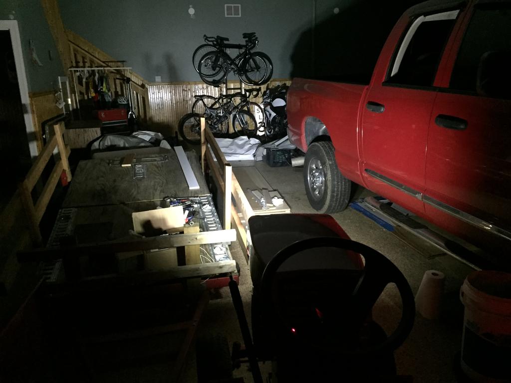

AndyK149 62 #22 Posted August 29, 2018 I have had to do some mowing in the dark recently and wanted to come back an recommend these LED lights again. They are absolutely amazing. I can't recommend them enough. I can easily mow in complete darkness now. The only challenge is seeing the deck in relation to obstacles, rocks, etc. The headlights are forward of the deck, so that should be expected. Share this post Link to post Share on other sites
WHX?? 57,810 #23 Posted August 29, 2018 Hello Andy in case I haven't done so I did a little thread on those lights awhile back. Yours seem to be much brighter! Share this post Link to post Share on other sites
AndyK149 62 #24 Posted August 30, 2018 Good thread Jim, i like your write up. I think it may be possible that LEDs are just getting better as time goes by. Some of the early ones had problems and weren't as bright - especially in the budget price range. They continue to get less expensive and better. Share this post Link to post Share on other sites
