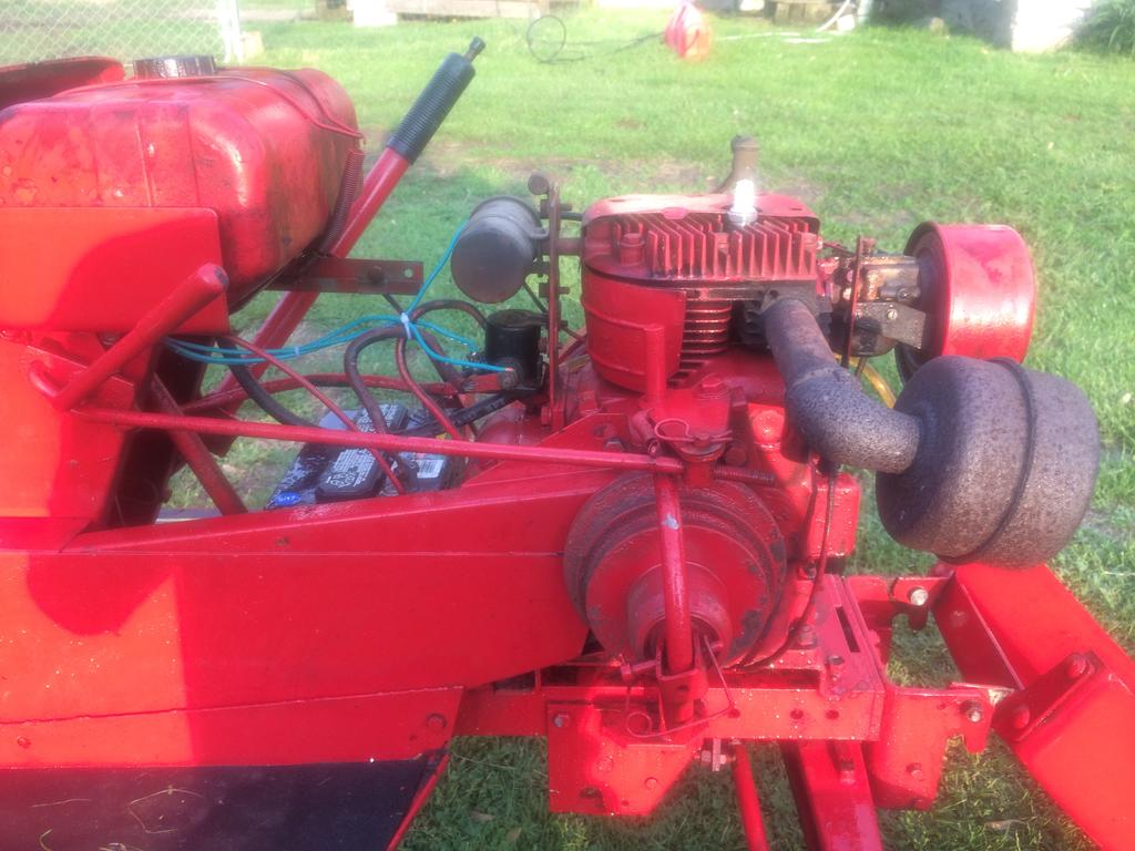

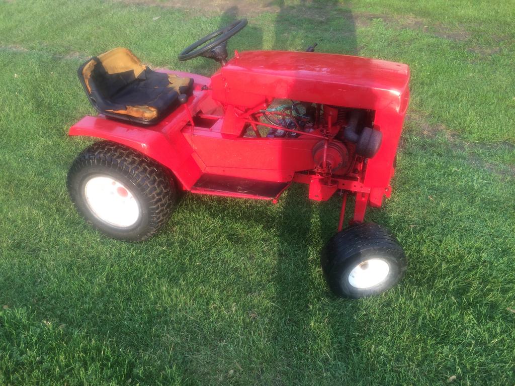

Dakota 71 #1 Posted May 22, 2018 Hello everyone I just bought a wheel horse with a Kohler 8hp and a 4 speed trans (3 forward 1 reverse) for what I thought was a great price. $100! It runs and drives, shifts through all gears, starts right up. The ONLY problem I have found so far is the belt slips when in 3rd gear which I assume is due to a worn/stretched belt. That brings me on to a few questions. First of all based on the pics what model is it? It has the Kohler 181 8hp I believe. Second what size drive belt would it have and where would I get one? Third, how good of a reputation does the Kohler 181 8hp and the 4 speed trans have? And fourth, what are the wires for come out of the back of the tractor in the 5th pic? I think it’s acually for a trailer because it hooks of perfectly to the first 2 plugs on a stadard 4-flat on a trailer, and the wires lead to a toggle switch labeled “lights”. And finally 5th, would this make a good plow tractor? And where would I find a snow blade if so? This is my first garden tractor and I don’t know much about the different models so any help would be great. Thanks! 2 1 Share this post Link to post Share on other sites
Dakota 71 #2 Posted May 22, 2018 Ok, based on the reasesrch I’ve done it doesn’t acually have a model name. It’s just called the wheel horse 8hp 4 speed. The serial number matches up too and it it’s a 1973 model. 2 Share this post Link to post Share on other sites
rjg854 13,422 #3 Posted May 22, 2018 @Dakota that's a fine tractor, it'll push a snow plow easily. Really nice looking for just a hundred bucks, especially hearing that it runs and drives good. Sounds like a real fine deal, you got. Look in the manual section for your model number and the drive belt size should be listed there. Maybe someone else might know it off the top of their head. Share this post Link to post Share on other sites
KC9KAS 4,746 #4 Posted May 22, 2018 @Dakota to I have a B-80 (same basic tractor as yours) and it is a snow pushing, garden plowing machine! I do have fluid in the tires and chains for added traction. The Kohler engines are very tough and reliable, as well as rebuildable! Share this post Link to post Share on other sites

Dakota 71 #10 Posted May 23, 2018 One more question, I was looking at the tractor and found a small metal block that was located under the dash, it has 2 wiring hanging that go to nothing. I later found out by looking at the wiring diagram that it is the rectifier, I kinda know what it’s for but not completely. Should it being disconnected be something I should worry about or try to fix? Share this post Link to post Share on other sites
Dakota 71 #11 Posted May 23, 2018 @953 nut I looked at the diagram and the rectifier in between the ignition and the coil is disconnected on mine, should it be something to be concerned about? Share this post Link to post Share on other sites
ebinmaine 81,146 #12 Posted May 23, 2018 @Dakota Quite a tractor there you've got for $100. Great find! I have a 1974 b80 that is basically the same thing that you have there. In regard to your rectifier question. Yes, you do need to fix that! In its original Factory state, the rectifier, or voltage regulator, is what changed the voltage coming out of that engine from over 30 volts ac down to approximately 13 or 15 volts DC. It's possible that someone has changed in an engine that will output the correct voltage but... It is most likely that your engine is putting out far too many volts for that battery to be absorbing safely. Share this post Link to post Share on other sites
Dakota 71 #13 Posted May 23, 2018 (edited) @ebinmaine thanks for the info! So just be sure I hook it up inbetween the coil and ignition like wiring diagram says? Edited May 23, 2018 by Dakota Share this post Link to post Share on other sites
