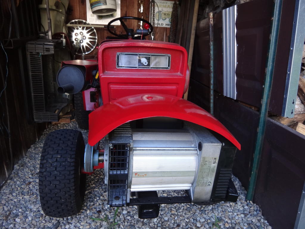

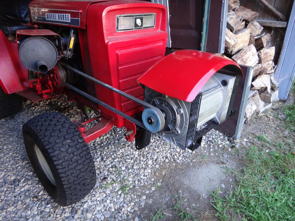

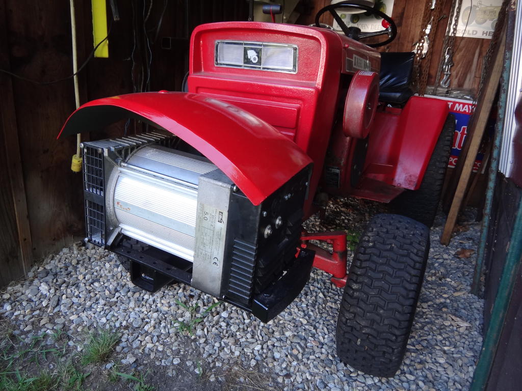

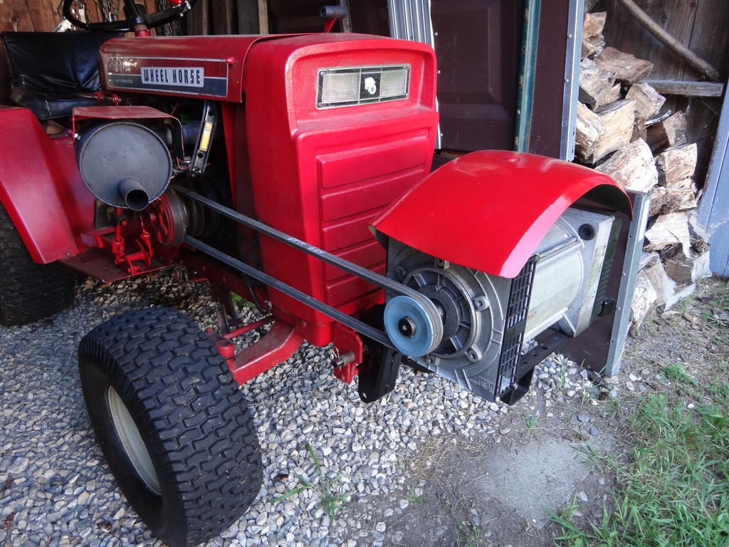

elcamino/wheelhorse 9,363 #15 Posted July 20, 2018 I have one of the 13 HP , HF generators about 3 years old. Ran for 54 hours , just stopping for fill ups, earlier this year ran like a top. No problems , no oil usage. I think my is the 7500 model. Best part it is electric start. 2 Share this post Link to post Share on other sites
