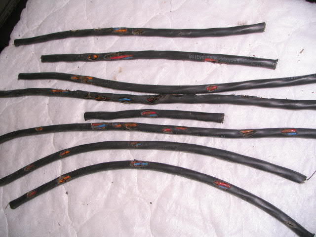

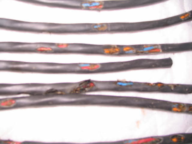

pacer 3,181 #1 Posted March 31, 2018 So I have a water well for our water source, been in service some 40+ YRS. Couple yrs ago the service pole finally rotted enough it had to be replaced, so I ask my retired licensed electrician if he'd help me freshen the underground wiring -- being the GOOD friend he is he said , sure! He had a goodly supply of various commercial grade wire and donated what he said was extra good quality stuff - mice, rodents, squirrels --- MOLES! would not touch it! Well, couple weeks ago, no water, go ck and breaker tripped reset and all good for couple days does it again-- and again... Call friend, he does his magic and says its going to ground (not being much lectric smart, I says ... um, OK!) So since the donated wire was multi strand he switched over to another two legs and -- OK! for about 10days and starts tripping breaker again. Yesterday we pulled the wire out of the ground and ---- HOLY SMOKE (literally!) see pictures. Amazing it was functioning at all. He was blown away, said he had used that wire in hundreds of applications and had never seen or heard of anything like it. There was about 35-38 feet of it buried and almost every inch of it was either nibbled on or --- worse, as can be seen at the charred places!! We replaced it with wire in conduit!! The well - and my bride, and me - are much happier now! 7 4 Share this post Link to post Share on other sites

953 nut 69,914 #4 Posted March 31, 2018 Glad I put mine in conduit when I built the house. 3 Share this post Link to post Share on other sites

Sarge 3,473 #6 Posted April 1, 2018 (edited) I've seen craters around areas where moles have gotten into the local Utilty's underground primary, usually right near a transformer. Never much left of them but a horrible odor and sometimes a tooth or two. At the required 24" depth, lines are a problem with rodents that dig, they should always be in metal conduit. Moles are also known for going after copper and fiber phone lines, lot of splicing around here that has degraded signal quality and cost the utilities a fortune. I enjoy watching the various videos of folks blowing the critters up with flammable gases such as propane, but it makes a mess of the yard. Had good success with the spike traps here, killed 4 moles last year and I see new ones are coming in from across the street again. Another hunting season when the weather warms up... Sarge Edited April 1, 2018 by Sarge dumb tablet Share this post Link to post Share on other sites

pacer 3,181 #8 Posted April 1, 2018 Oddly enough, we did not see any crispy critters. Reason we can strongly suspect moles is the presence of their runs all around the area. When re-digging the trench for the wire/conduit we found there were quite a few grubs, which are a favorite of moles. Its full blown Spring down here and the critters are active! Sarge, I have one of the spike traps (impalers!) and will watch that area for fresh runs and see if I cant get a couple - I never had any lick with the poisons. Share this post Link to post Share on other sites

WHX?? 58,308 #14 Posted April 5, 2018 I've seen that problem before Pacer. Many types of wire have a compound in them that rodents like to chew on. Must be like some kind of vitamin for them. Any underground wire used should be of the UF type which is supposed to be rodent "resistant" for what that means. I use the spike traps with some success. Never tried it but hear tell you take a stick of Juicy Fruit chewing gum and put in in the runways. They are supposed to love it but can't digest it and it kills them. Best times to get them buggers with the shovel is very early morning as that's when they are most active. Share this post Link to post Share on other sites
