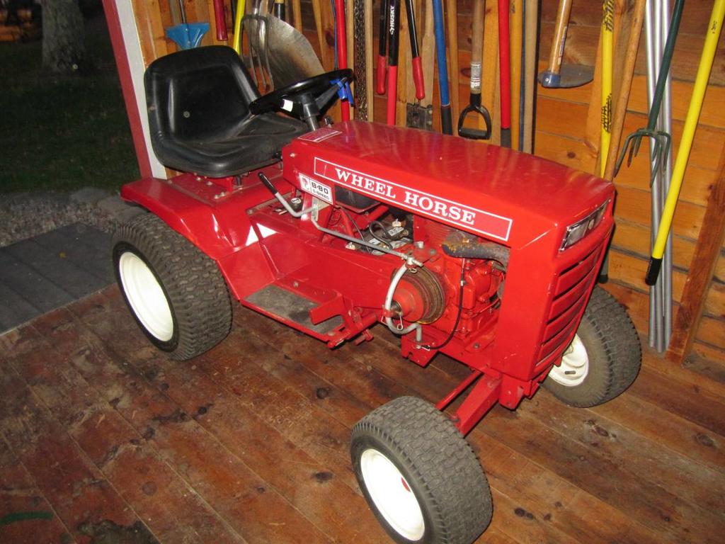

Hello
When we try to push the machine with out it running or in gear. The rear wheels are locking up. Is there a release valve? I have to push it from the storage area to the shop, the motor is rapping.
Thank you
