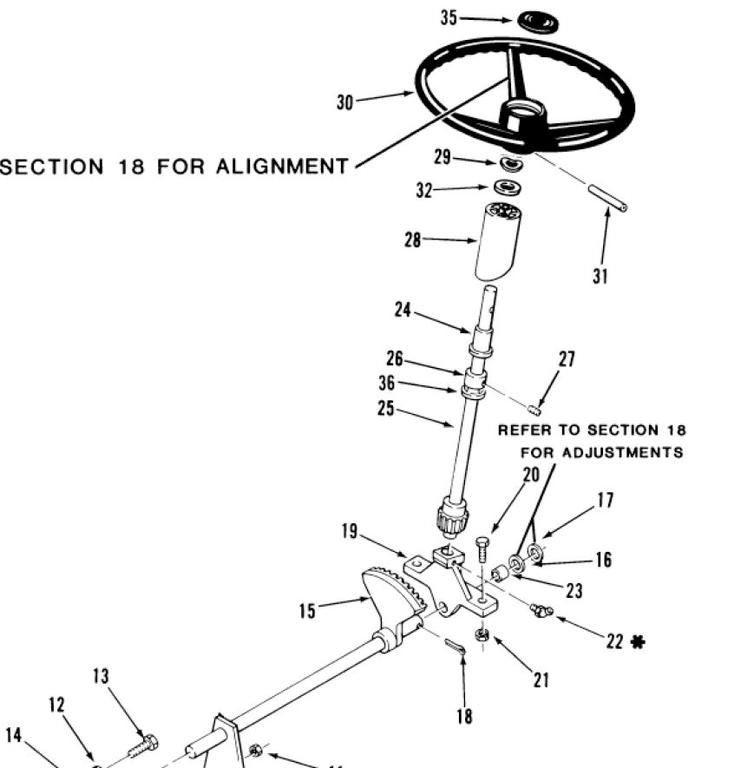

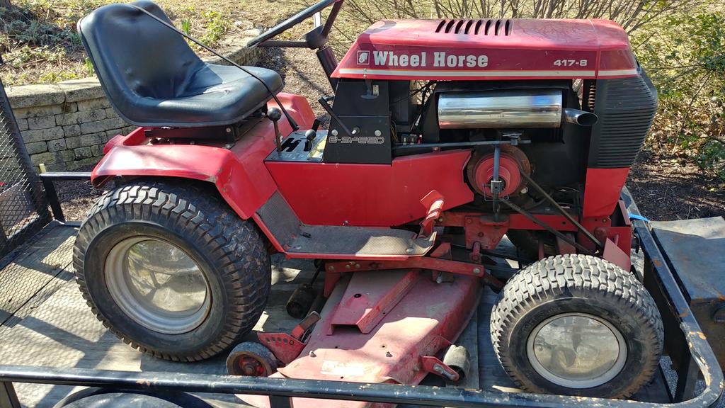

Big_Red_Fred 1,548 #1 Posted March 11, 2018 I cant print the Paper work provided on line here so i have to ask, i bought this 417-8 Saturday March 10, yesterday, It was barely running, gas smelled like turpintine, 2 different spark plugs, 1 wasnt even seated due to is was to big, i forgot to check electric lift tho it was down when i was looking at it, he put it up to limp up on trailer. But my question is i grabed the steering wheel & pulled up through dash, other then the bushing, what holds it at lower gear ? Cotter pin or a split pin ? Any help will get er up & rolling at Big Show, i will Wax it & shine the hub caps 1 Share this post Link to post Share on other sites
pfrederi 21,307 #2 Posted March 11, 2018 (edited) Should be a 3/4" shaft collar just below the bushing Edited March 11, 2018 by pfrederi Share this post Link to post Share on other sites
Big_Red_Fred 1,548 #3 Posted March 11, 2018 I seen a snap ring below it, i dont have mine handy due to my son taking all my tools, yes i let him , so ill push the bushing in place into the space provided in dash, then move the snap ring in place. You think that piece should have been pinned ? From my observation working on Diesels Share this post Link to post Share on other sites
953 nut 70,343 #4 Posted March 11, 2018 That should do it. Share this post Link to post Share on other sites

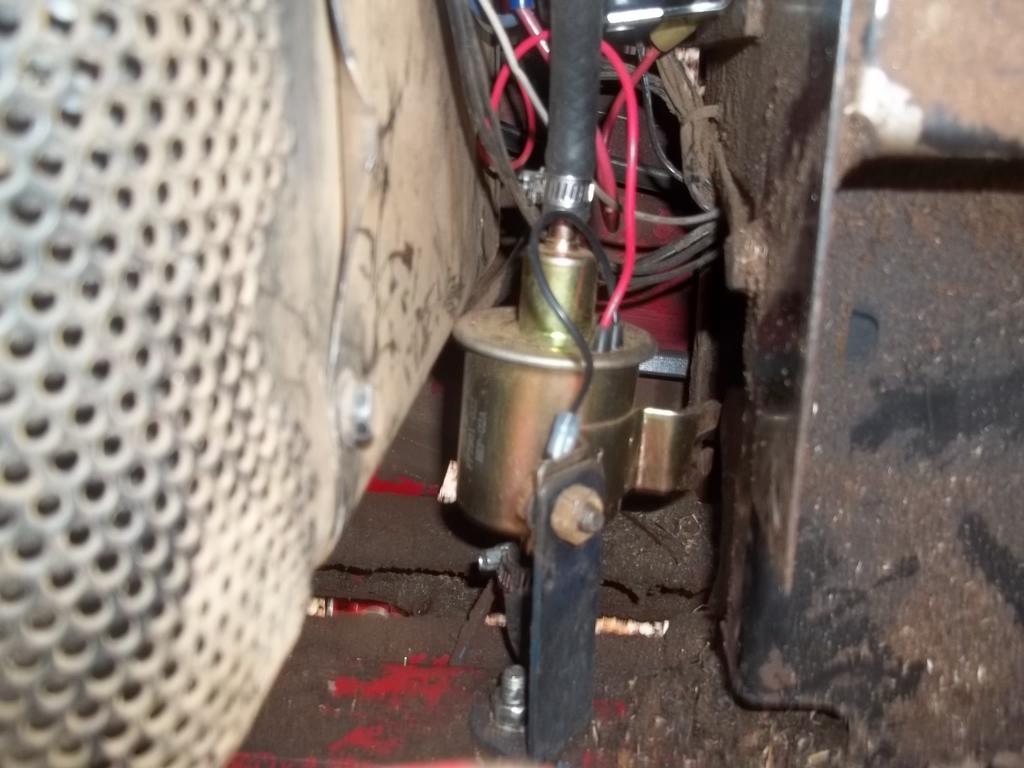

Big_Red_Fred 1,548 #5 Posted March 11, 2018 @953 nut Now the fuel pump stoped LOL, ordering Electric now 1 Share this post Link to post Share on other sites
953 nut 70,343 #6 Posted March 11, 2018 Easy to do and makes it start a lot better. 2 Share this post Link to post Share on other sites
Big_Red_Fred 1,548 #7 Posted March 11, 2018 I have 1 Left at Alex's, hes at Drill today, get this evening @953 nut You turned me on to them Dick, ordering 3 more, The D runs off 1 of them & 1054, Hook to Coil Share this post Link to post Share on other sites

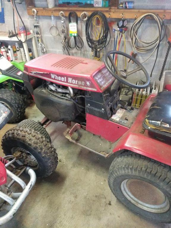

Big_Red_Fred 1,548 #14 Posted March 14, 2018 Here it is Richy, Hey Don LOL dont get mad 2 Share this post Link to post Share on other sites
19richie66 17,950 #15 Posted March 14, 2018 Looks just like mine 👍 Share this post Link to post Share on other sites
Big_Red_Fred 1,548 #16 Posted March 14, 2018 3 hours ago, 19richie66 said: Looks just like mine 👍 400 out the Door, no smoke, eaton 1100 tip top shape, no attachments tho, He's Firm with price. What do you think ? Share this post Link to post Share on other sites
19richie66 17,950 #17 Posted March 14, 2018 If it is that good of shape mechanically, here I would pay $400 for it(if I had it ). Looks like it needs a good cleaning. They are little beasts in a nice size package. Your money though. 1 1 Share this post Link to post Share on other sites
Big_Red_Fred 1,548 #18 Posted March 15, 2018 17 minutes ago, 19richie66 said: If it is that good of shape mechanically, here I would pay $400 for it(if I had it ). Looks like it needs a good cleaning. They are little beasts in a nice size package. Your money though. @WVHillbilly520H Jeff said its worth it to, how should i check the Hydro ? With a Tree & chain ? Share this post Link to post Share on other sites
WVHillbilly520H 10,379 #19 Posted March 15, 2018 1 minute ago, Big_Red_Fred said: @WVHillbilly520H Jeff said its worth it to, how should i check the Hydro ? With a Tree & chain ? Get it warmed up 5-10 min then yes chain it to tree to see if it will break traction/spin the tires, find a tall curb to push against same deal break traction/spin. 2 Share this post Link to post Share on other sites
Big_Red_Fred 1,548 #20 Posted March 15, 2018 Just now, WVHillbilly520H said: Get it warmed up 5-10 min then yes chain it to tree to see if it will break traction/spin the tires, find a tall curb to push against same deal break traction/spin. Pm sent, took him a Day before 1 Share this post Link to post Share on other sites
19richie66 17,950 #21 Posted March 15, 2018 If it has a hitch, hook a chain to your truck hitch and try pulling it with the tractor in dirt. Then you can see if it will spin the tires or not. Seller is probably not going to let you push on anything with the fear of you trashing the hood, fenders or something. Then you would own it 1 Share this post Link to post Share on other sites
Big_Red_Fred 1,548 #22 Posted March 15, 2018 The 520 sold from my other post, but the 418 didnt, hes holding for me, said Hydro is strong, another 1 for BRF Stable, get pics out when home Share this post Link to post Share on other sites
Horse Newbie 7,405 #23 Posted March 15, 2018 On 3/11/2018 at 4:15 PM, 953 nut said: Easy to do and makes it start a lot better. 953nut... should I put an electric fuel pump on my 1994 520H when I start putting it back together ? Share this post Link to post Share on other sites
Horse Newbie 7,405 #24 Posted March 15, 2018 Just now, Horse Newbie said: 953nut... should I put an electric fuel pump on my 1994 520H when I start putting it back together ? Share this post Link to post Share on other sites
953 nut 70,343 #25 Posted March 17, 2018 On 3/14/2018 at 11:23 PM, Horse Newbie said: I will put an electric fuel pump on any that is not being restored to or kept in original condition. 2 Share this post Link to post Share on other sites
