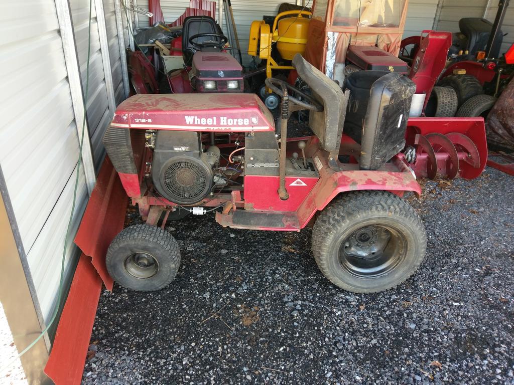

Big_Red_Fred 1,548 #1 Posted March 10, 2018 I requested reinstated to my account, Karl brought me back, I wont Joke around. I bought a 417-8 today over the phone, he said it was mint, well it wasnt, steering column pulled out from dash, engine running on turpentine, & a List of more things, Ericj ripped my rear today TWICE saying theres some times you have to walk away, well i didnt & im out 600 bucks for a Non running 417-8, so i need your help, i called 19richy66 and he is gonna send me some info after his work. Hers 1 pic before sale, its what caught my eye for being a deal. Thanks for Letting me come back Karl, oh boy, im sure i will get the texts now 8 Share this post Link to post Share on other sites

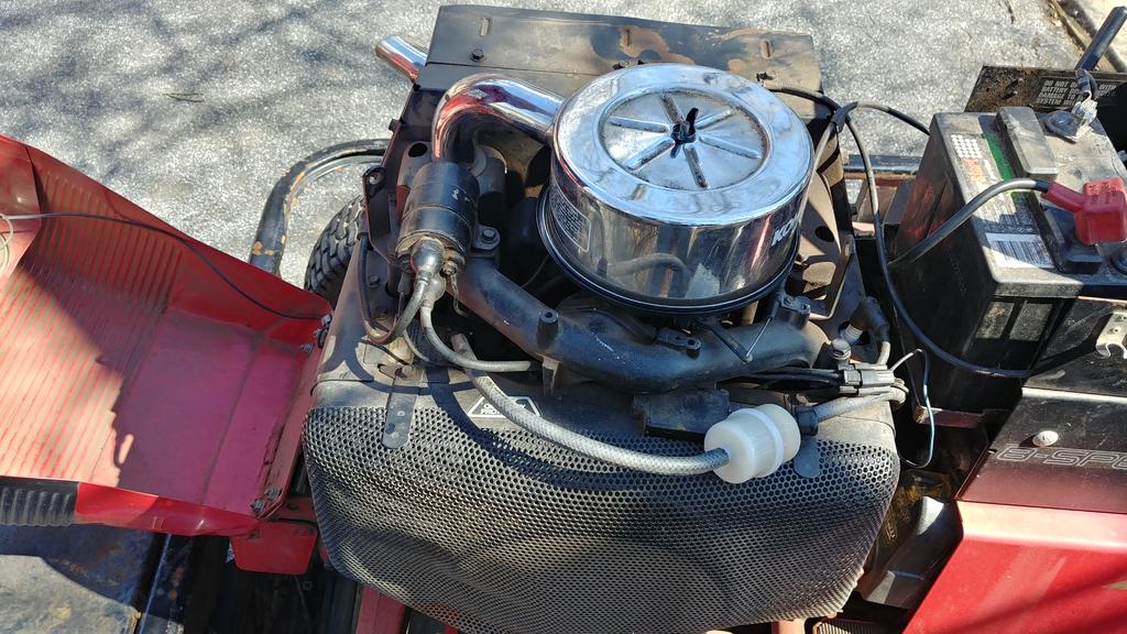

The Gman 476 #11 Posted March 10, 2018 Put a 17 II I rebuilt in my 312-8, love it. I did change out the oil sentry switch for an electric oil guage. Do not like the champion rv plugs. Data sheet calls for resistence value of 6k - 15k. Mine were both over 180k and built up carbon overnite. . Went thru. a bunch of nos to find good ones. Still looking for non resistor replacements with the right heat range. Wish I had a nice chrome housing with the heat tube like yours. When you get to it....... what's the cylinder compressions? Share this post Link to post Share on other sites

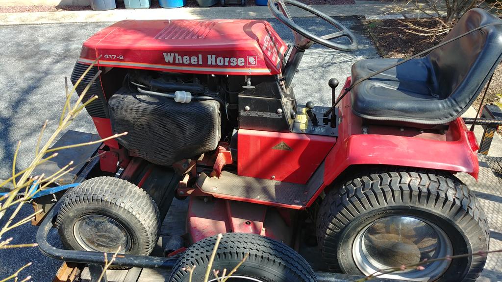

Big_Red_Fred 1,548 #13 Posted March 10, 2018 Another side view 3 Share this post Link to post Share on other sites
