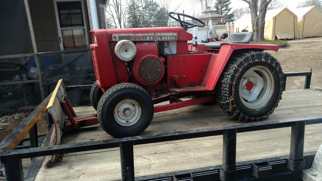

Chris T

No Spark...does it have a  the breakerless igntion???
Hope the PO didn't fry it with his hacked wiring job.

Chris T
Does not have a set of points, so that would be breakerless correct?

pfrederi
Yes and they are easily fried or just fail.  Look at the Kohler manual there are specific tests for breakerless.

Chris T
More then likely fried. Can't get replacements anymore either correct?

pfrederi
You can get used parts from ebay but if thy work they are pricey.  Not too hard/expensive to convert to coil and points system....

Chris T
More then likely it seems like I'll have to convert it. Get plunger, set of points, condenser, coil, and new ignition switch. Currently the ignition is only a 4 post as well

pfrederi
You should test the trigger and the coil...One or the other may still be OK.  if so selling it can help with your conversion cost.

Chris T
I have coils and other style ignition switch here, and I just found a junk 8 horse k181 I can pull all of the parts off

pfrederi
If you do not want to test the coil and trigger would you sell them???

Chris T
Looking to see who else has done conversion and if I need to replace stator as well
Howie
You can use the stator on there. Just have to isolate or remove wire going to breakerless ignition. My 69 Raider 12 since the early 80's.

953 nut
:text-coolphotos:
Check out this thread by @Aldon. Also, Brian Miller's web site has good information you can use.

Chris T
1 hour ago, 953 nut said:
:text-coolphotos:
Thank you @953 nut , very resourceful post. I will be doing that conversion shortly. Need to finish up my resto on my C-145 first.

richmondred01
Years back I purchased several nos triggers. I keep them only for the purest who wants a 100% original engine. All others I convert to the point system. Very reliable. Not that the triggers were bad. They weren’t. Just a high dollar part now.  Miller is a talented guy with good parts. If you don’t convert to points I would recommend you talk to him.

R. L. Addison
I have as complete breaker-less ignition set-up I removed from a 12 horse, didn't test anything, just replaced stator, flywheel, coil, & exciter. Do not know condition, I wanted 15 amp system, so I changed everything but blower shroud & spec number.    Ron

Chris T
What is original stator rated for?

953 nut
They were 10 Amp.

Chris T
Okay so my thought is to leave that stator. Run those 2 wires from stator to rectifier, rewire machine to run points, condenser and coil. Just remove the coil and magneto from behind flywheel as well. Just need to remove the plug, install parts, gap points, rewire and done

elliot ness
Looks like a 1969 model with the two arm steering wheel, Nice score. :happy-jumpeveryone:
Chris T
Thank you, this one is gonna stick around a little while! Wash it up, go through it mechanically, paint wheels and put it to work
