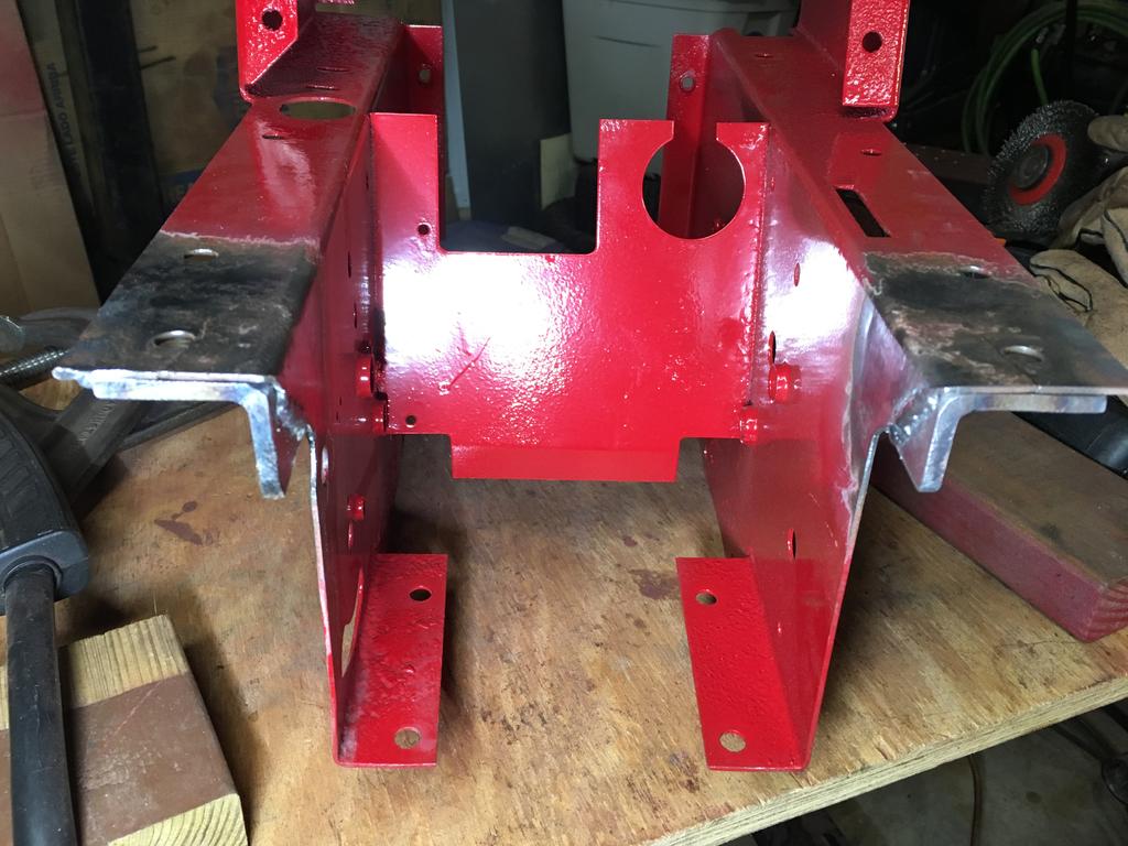

classiccat
3/16 angle oughta hold my saddle in place.
Ignore my bubblegum welds for a moment and notice the right side is about 1/4” shorter to clear the swinging clutch switch tab.

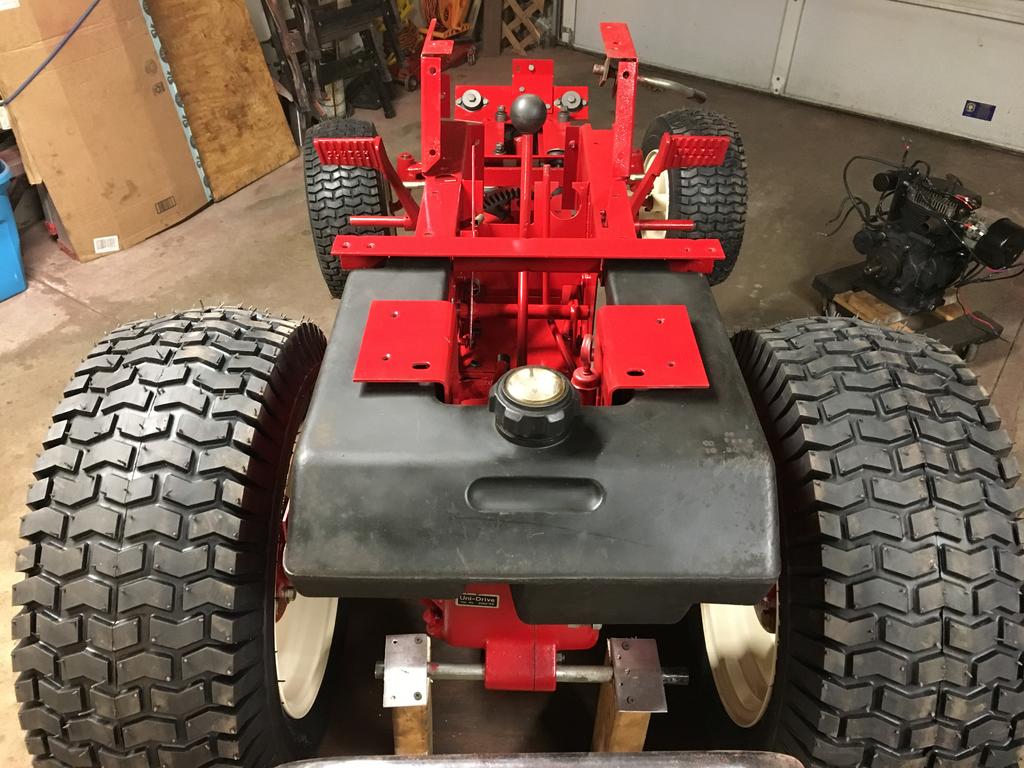

classiccat

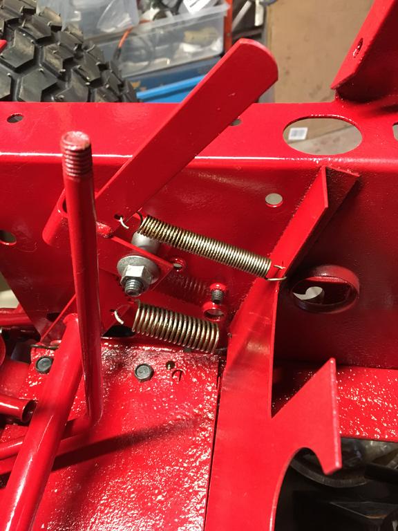

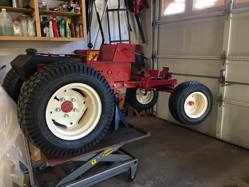

The short list is shrinking!
The body is installed and I was able to hook-up the brake linkage.
For the springs; I wanted to keep shiny, I addressed the rust and old paint with wire wheel, tumbler and evaporust...and instead of parkerizing, I sprayed with a coat of Amsoil MP (metal protectant).
Front wheels and motor mount.
Motor wanting to jump on her refreshed mount (I'm repainting the block this week).
Up Next: rear fender pan and shift plates.

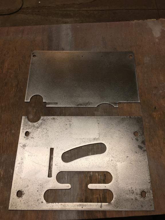

bds1984
You could always make new shift plates like I did for my C165.
  • Like 3
  • Excellent 1
ebinmaine
That's puurrttyy

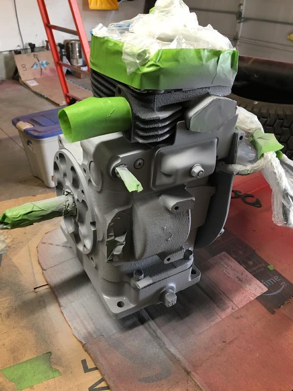

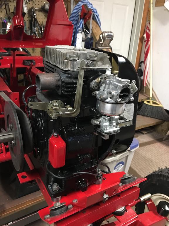

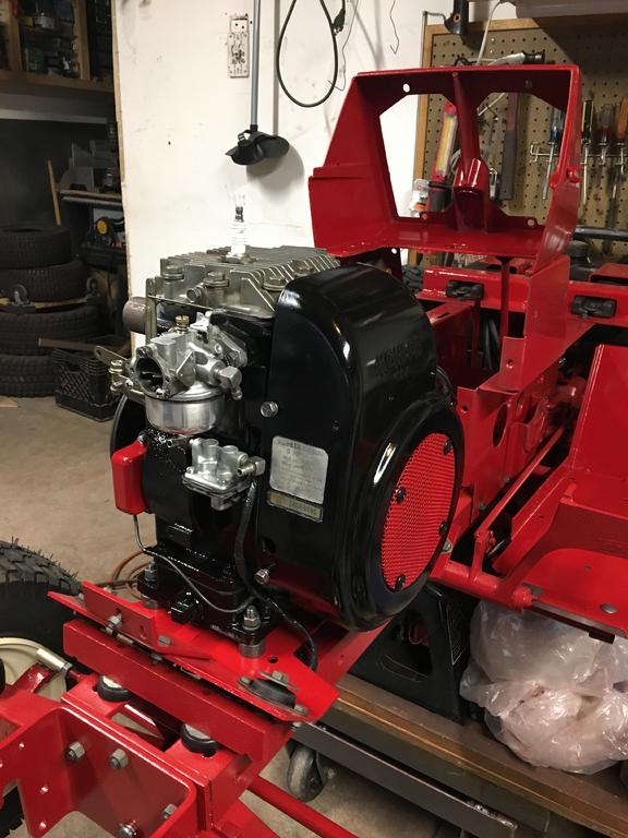

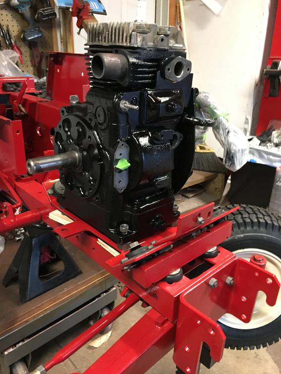

We're almost finished with the engine restoration...
I stripped and repainted the block (wasn't a fan of the flat/satin engine paint...nor did I like the paint on the individual components).
paint on the carb, fuel pump and governor components was removed and polished the float bowl.  The governor was treated with Amsoil metal protectant (gold tint)
^^ I'm in the process of repainting the console... some paint edges needed to be feathered.

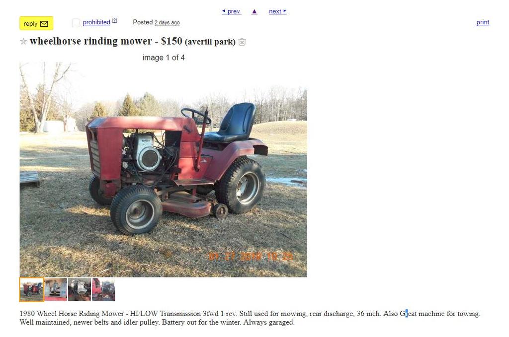

Thank you so much MtM!  I credit the previous owner for actually saving her from the scrap pile; he said that it was rotting away outside of a local service station.  His son had fun with it for a few years (racing stripes say it all!).
Here's the original ad:

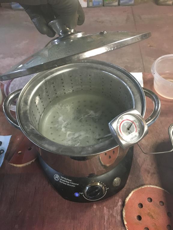

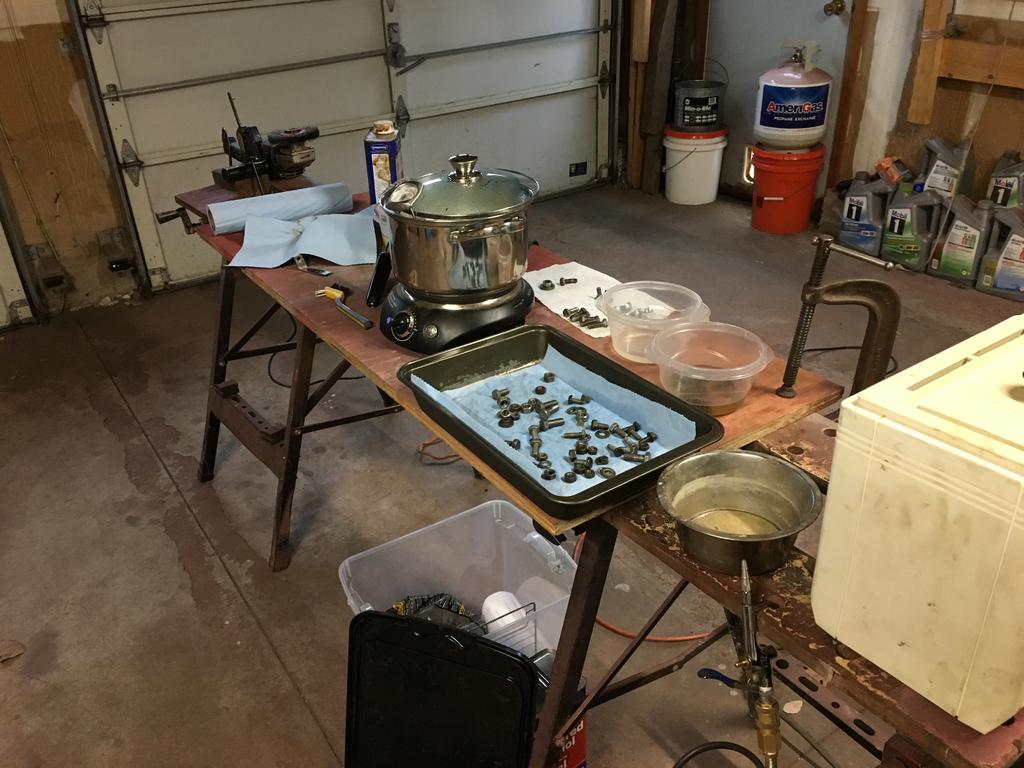

A little update on things around the garage.

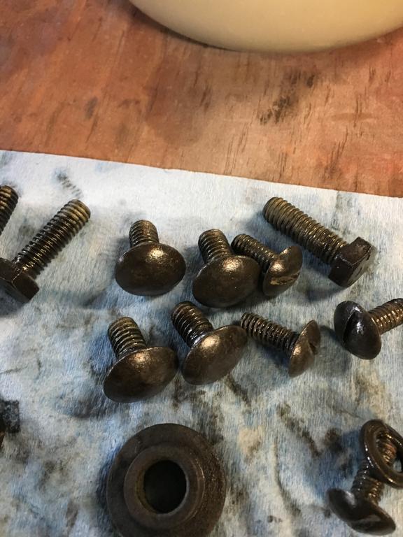

some tweaks were made to the Parkerizing system.
57573994286__63D828A5-AC5D-49A9-9B0F-566E1A67A533.JPG.7928474cd7c7f6b4d5c109877816a402.JPG

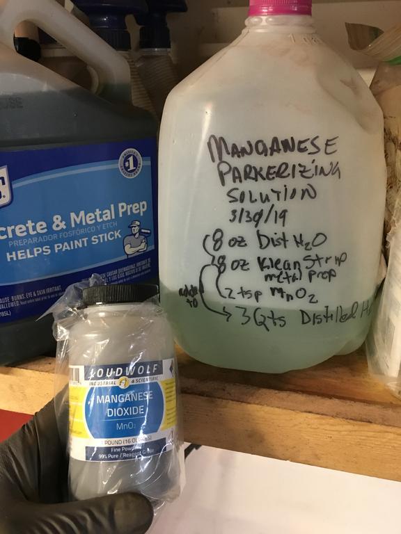

I'm using a pot with a strainer...makes "retrieval" a cinch.  I've also ditched the white-gas coleman 533 stove for an electric hotplate...much better temperature control.
Lastly, I've gone with  DIY homebrew using a mixture of Klean Strip Metal Prep : Manganese dioxide : distilled water (I think tap water may have ruined my commercial brew).
I followed this guy's recipe to the "T"
  • Excellent 1

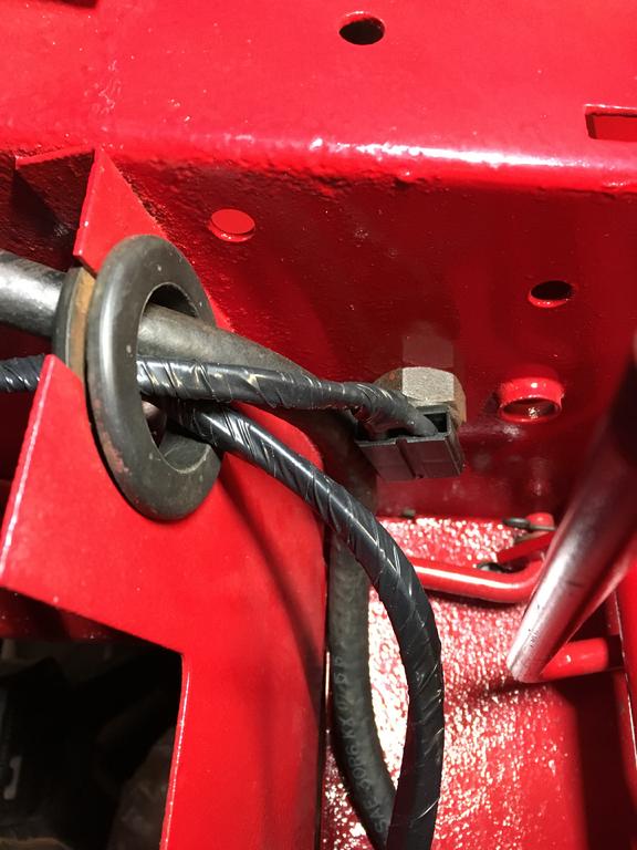

work on the tractor is progressing.

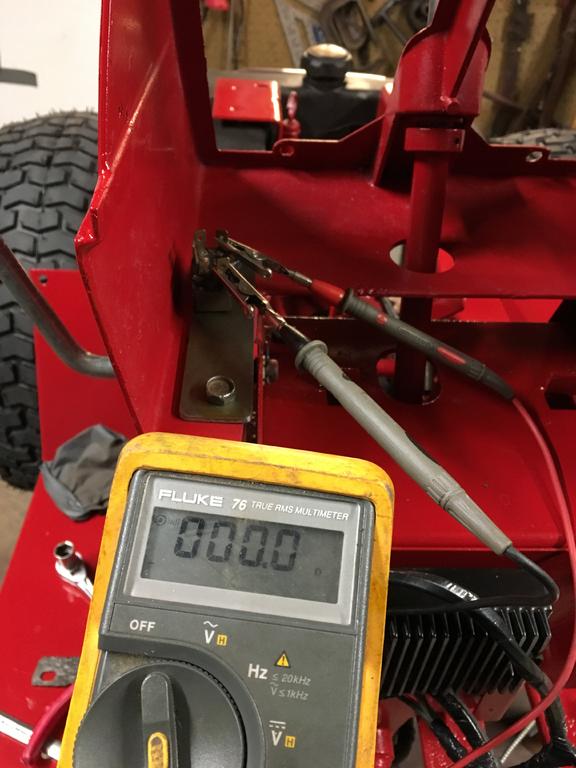

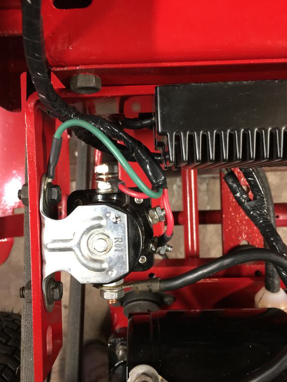

Solenoid and regulator installed with dedicated grounds.

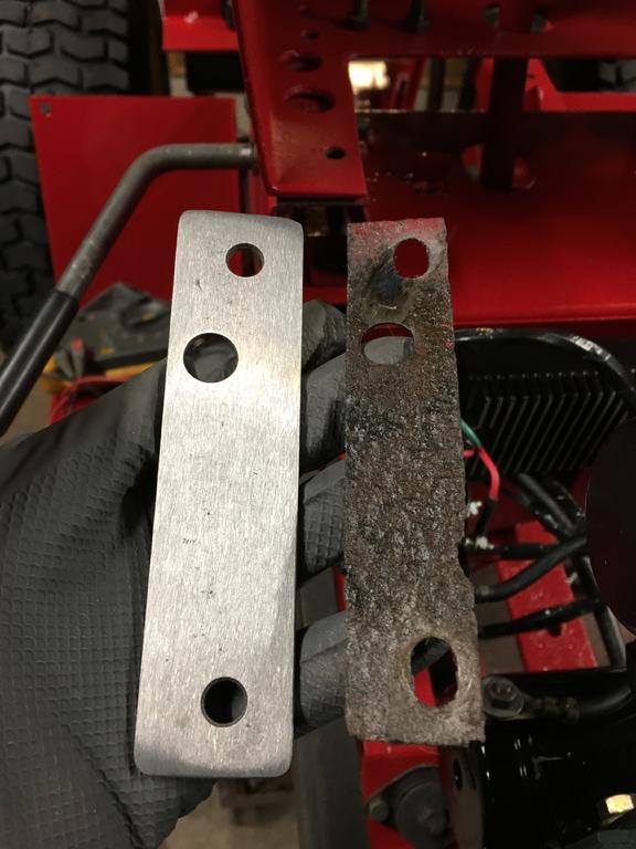

The PTO limit switch bracket was roached...so I fabbed-up a new one out of flat stock.  Gave it some "texture" on the belt sander then coated with amsoil MP HD.  DVM to verify that the additional thickness didn't put the switch too far from the actuator.

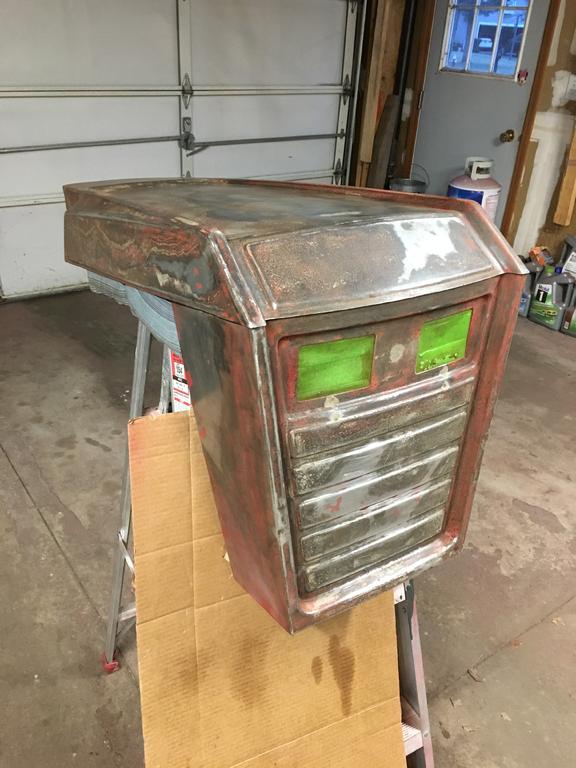

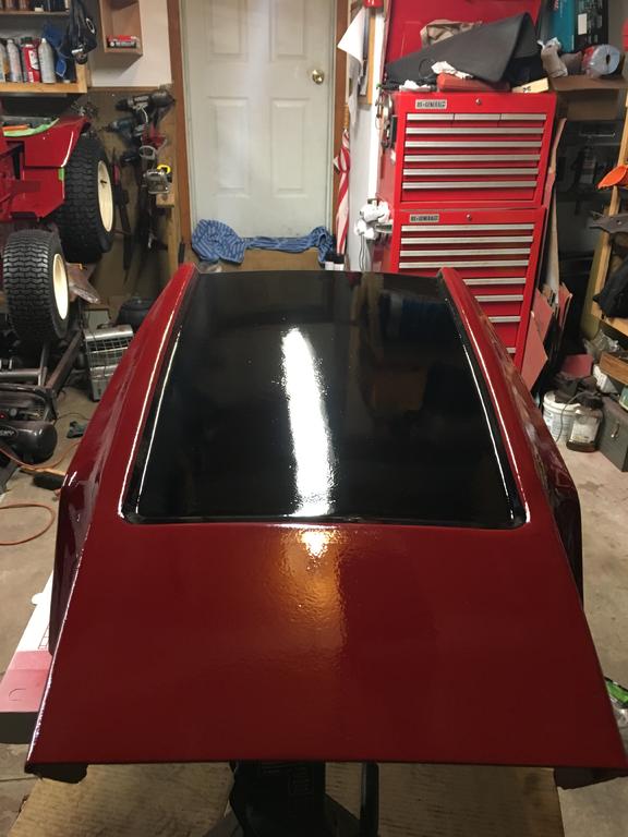

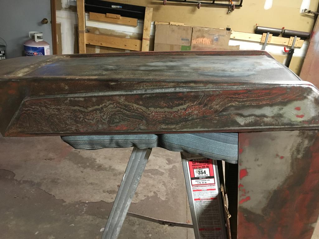

After alot of JBWeld (extra holes, rust pits, etc.) & sanding, the hood is ready for lipstick.
flying-hood and flying-tractor face off...hopefully reunited really soon!

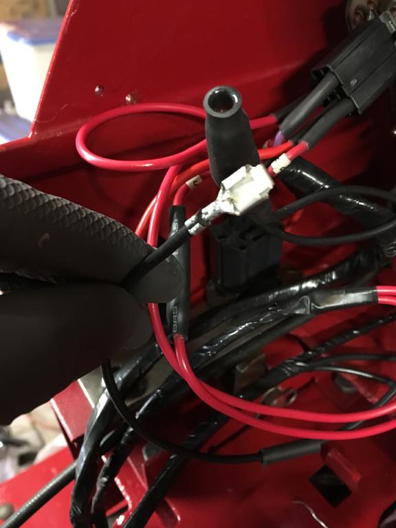

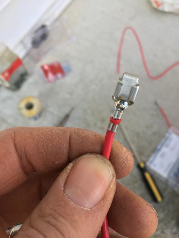

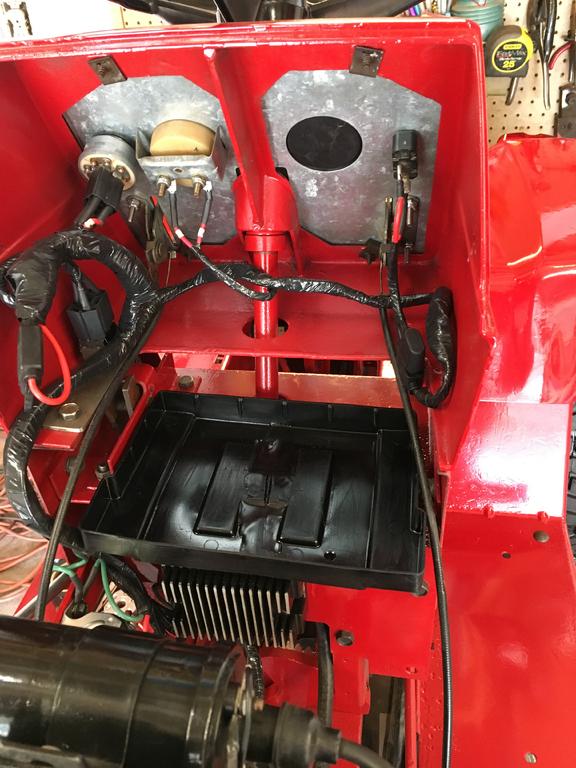

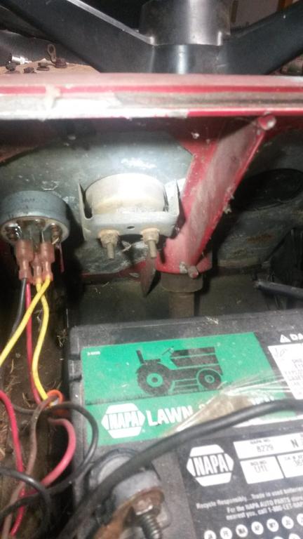

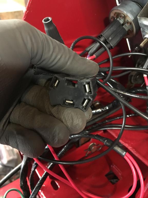

Electrical should be about wrapped-up for this bad boy.

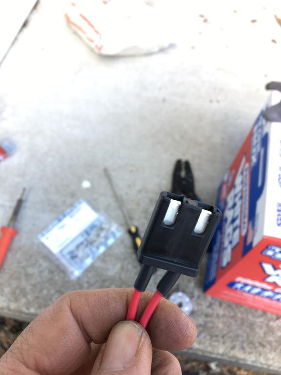

All of the connectors were missing but they weren't too hard to find.
The clutch switch came-up in a thread a few weeks back...that helped alot!
The Packard 56 series female terminals (for 14-16 wire) get the double crimp followed by solder
then some marine grade heat-shrink.  The connector came from amazon.
The PTO and ignition switch (and regulator) get the same terminals.  If you go this route, I recommend getting one of these crimp tools as well as a terminal removal tool.
We'll tidy-up in here once I run the machine a few times; Initial checks passed w/ flying colors.

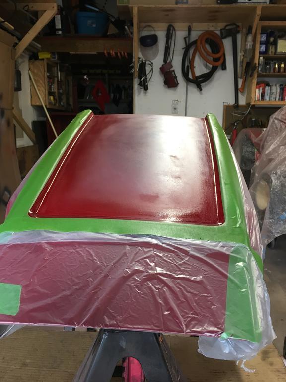

classiccat

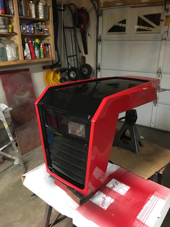

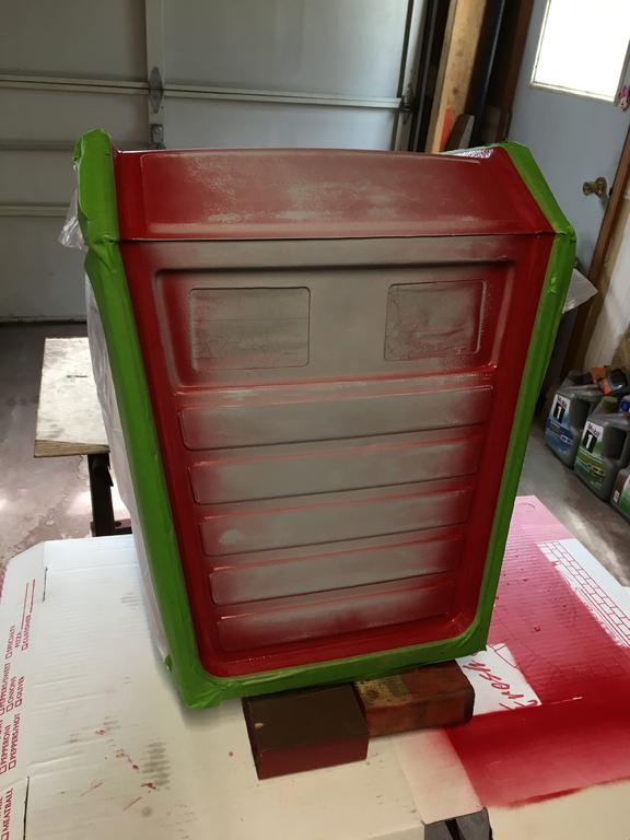

Hood painting continued this morning.
The inside as well as the outside-red were completed a few days back.
Once taped-off, I scuffed the red overspray then wet-sanded upto 1000g.
And now we finally have a Black Hood!  :ph34r:
^^^ I need to touch-up the red on those 2 side rails where the frog-tape didn't cover properly.

953 nut
:text-coolphotos:              First class job on the wiring. Having dedicated grounds on a freshly painted tractor is a great idea.      :techie-idea:       . Paint is a very poor conductor of electricity!

classiccat
thanks *nut!   Generally I avoid using the vehicle as a conductor.  Strictly forbidden on aluminum boats.

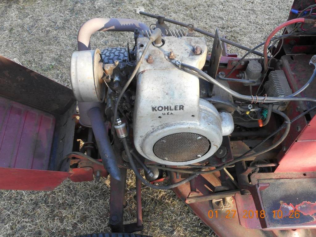

this is what we drug home:

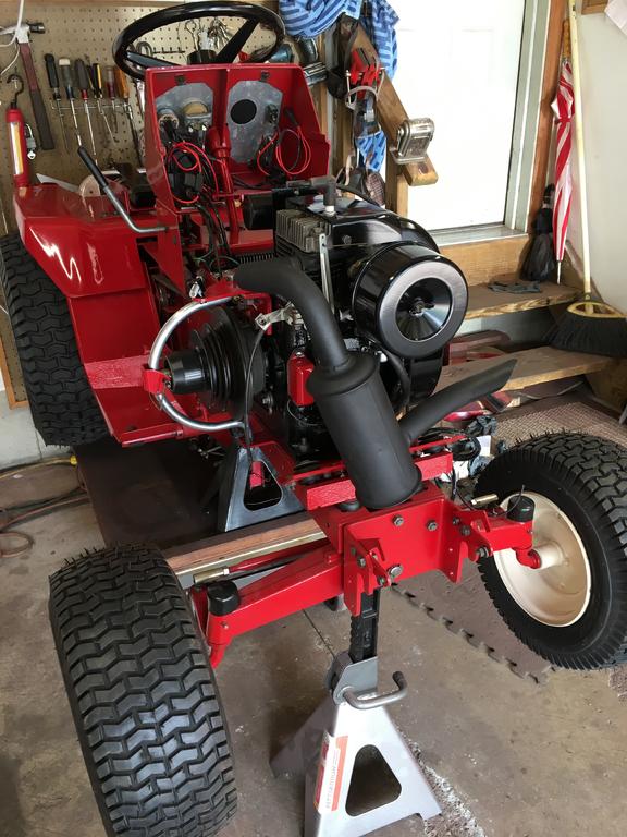

classiccat
Gave the muffler a little love (VHT flameproof).
gave the PTO hoop a little shine (sanded to 1000g & polished & sealed with sharkhyde)

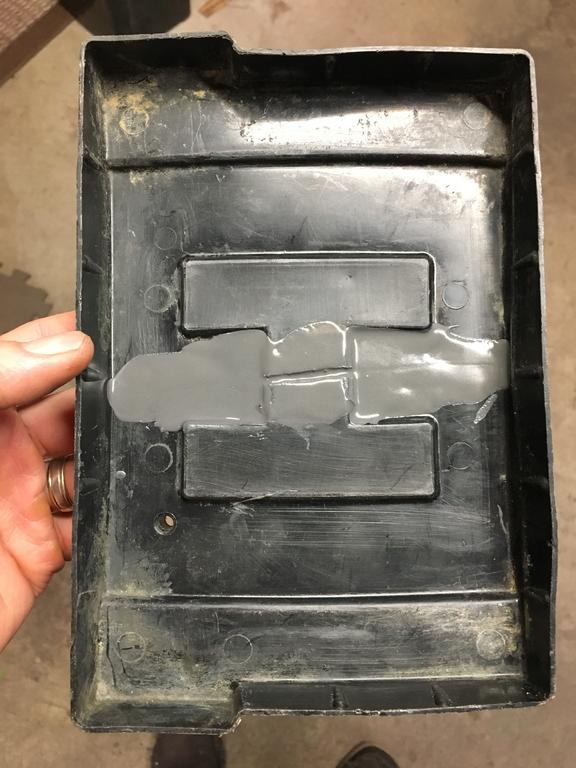

found a cracked :wh: battery tray off of fleabay for 3 bucks + shipping.  We have just the cure for that sort of thing.
after a few coats of VHT vinyl dye...like a glove:
Time to leave the nest
