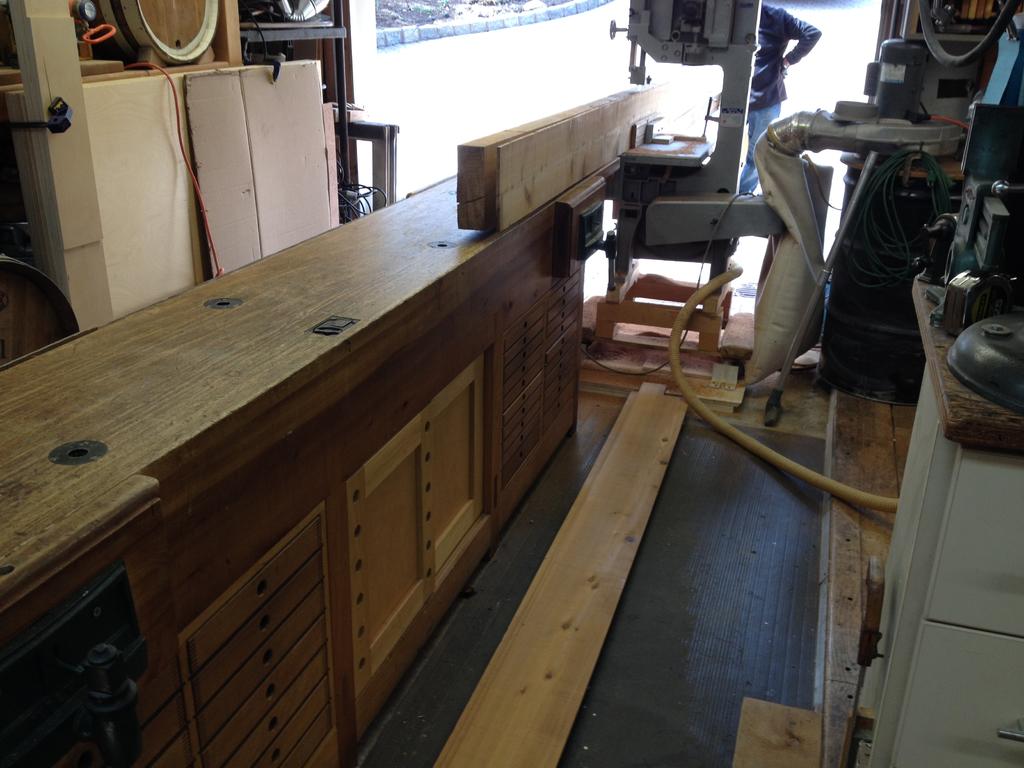

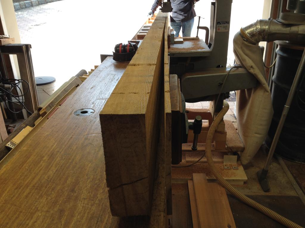

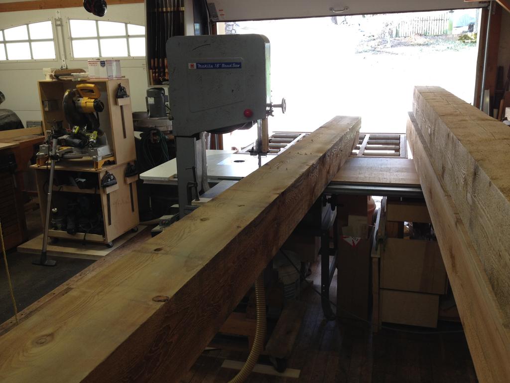

formariz 12,381 #11 Posted February 13, 2018 (edited) 3 hours ago, jellyghost said: If I helped him harvest the wood, is there a way we should log the trunks so as to preserve possible boards? Apple trees from an orchard are going to yield relatively short logs and probably not more than 12" in diameter. When you cut the trees and look at the top and bottom of log you can first determine if it has heart rot which is very common . If it doesn't it will probably have some decent board material in it. I would right away paint the ends on them with a couple of coats of any paint you have laying around to prevent checking enamel paint preferably.I use paraffin but not everyone has that around. It should then be milled as soon as possible. 6/4 or 8/4 would be ideal for initial drying. There is going to be a lot of waste since apple will warp and twist like no other. Even if it has heart rot it will have great pieces that can be used to turn small items such as furniture knobs and small bowls. Since logs will be short and not too thick it can be milled with a re saw band saw if available.One would have to devise a cradle to mill the round log.I use a vintage Makita with a 3" blade. Edited February 13, 2018 by formariz 4 1 Share this post Link to post Share on other sites
