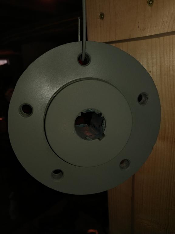

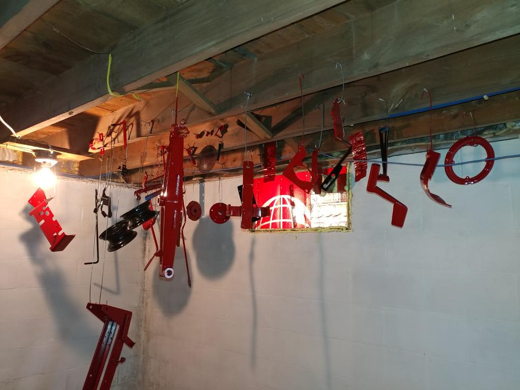

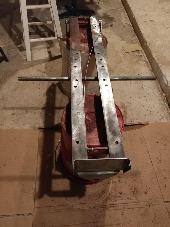

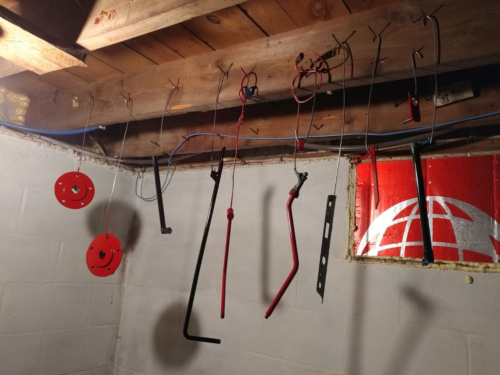

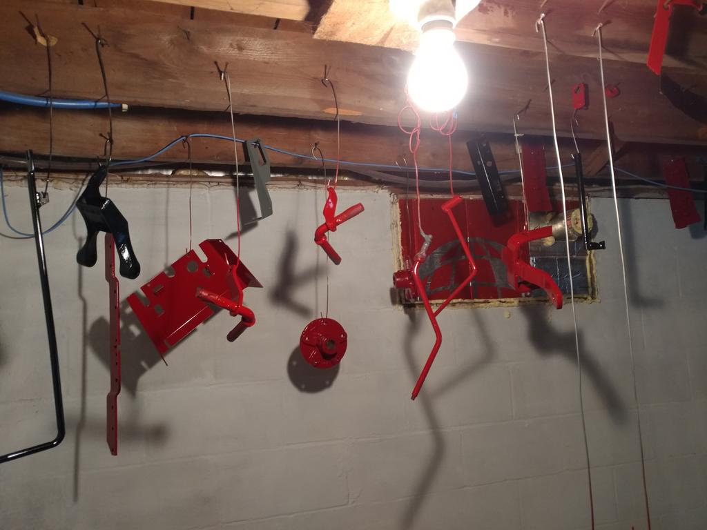

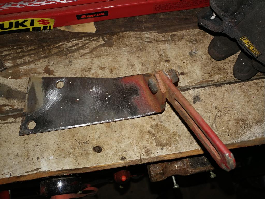

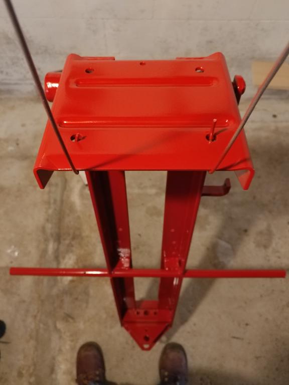

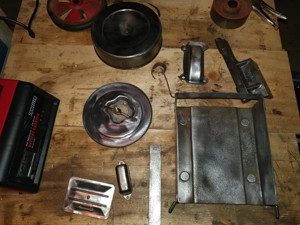

Joshn569 273 #32 Posted February 15, 2018 Progress report. Got a few small parts stripped, primed, painted, and cleared. Super happy with the regal red. Hope to have the frame done in the next couple days. 3 Share this post Link to post Share on other sites

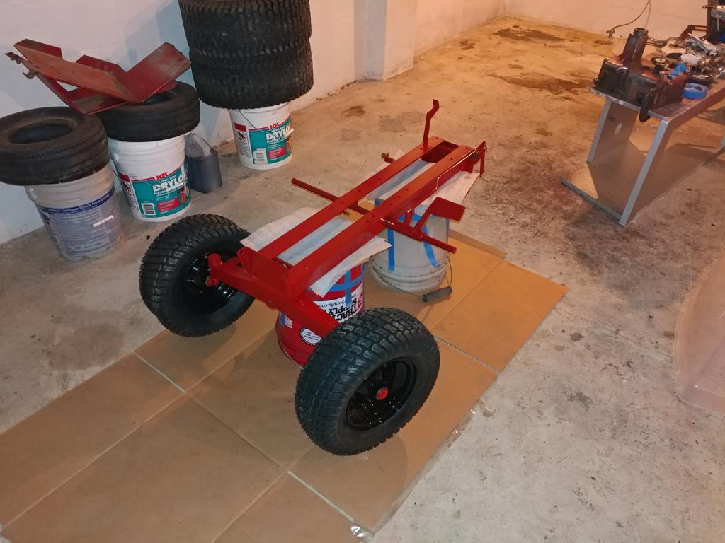

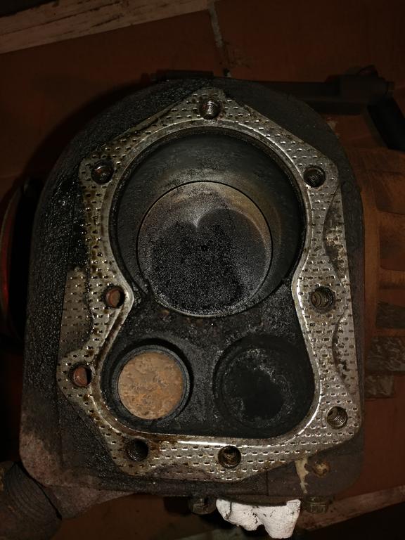

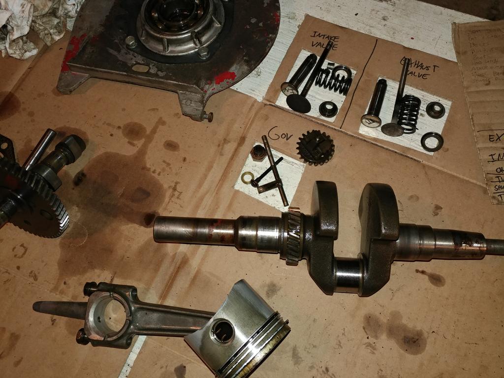

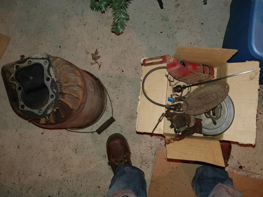

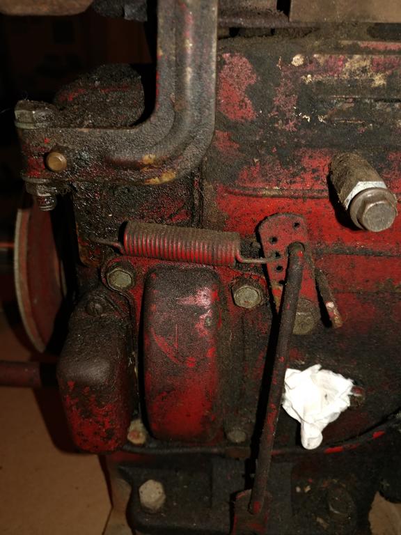

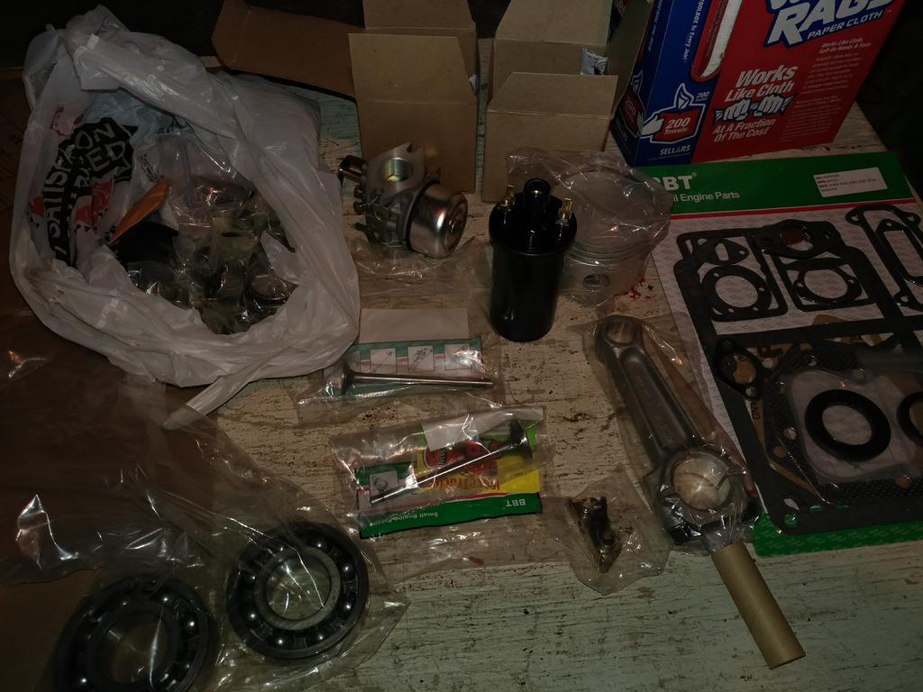

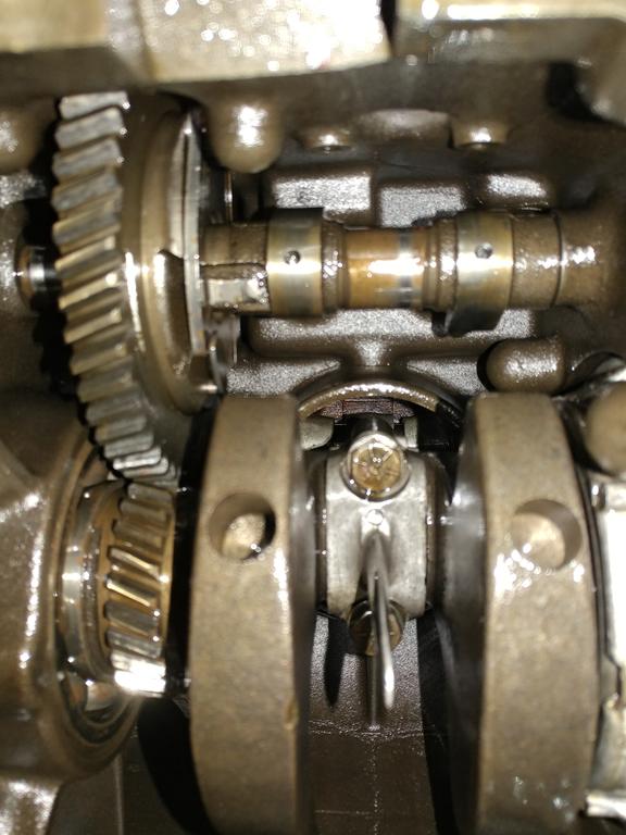

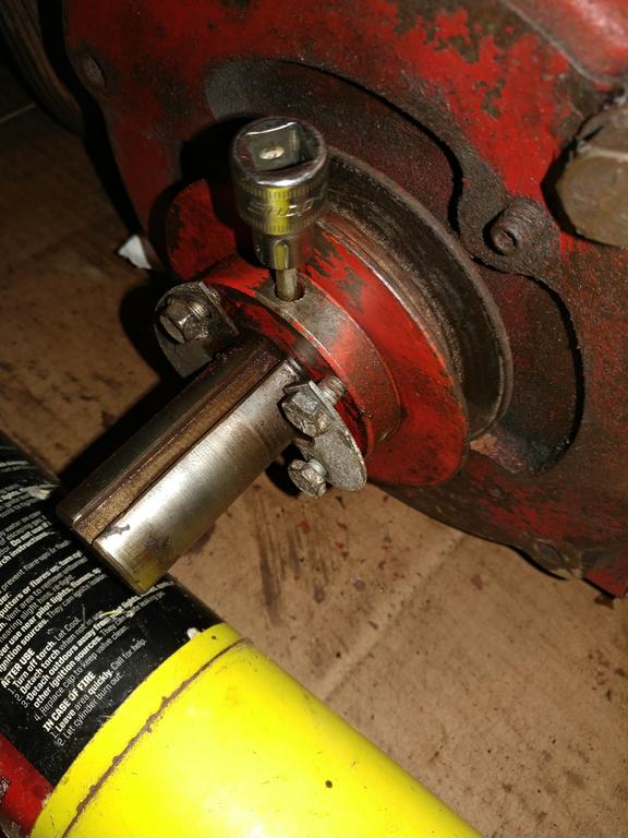

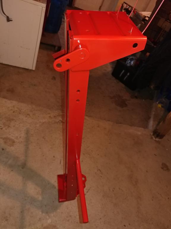

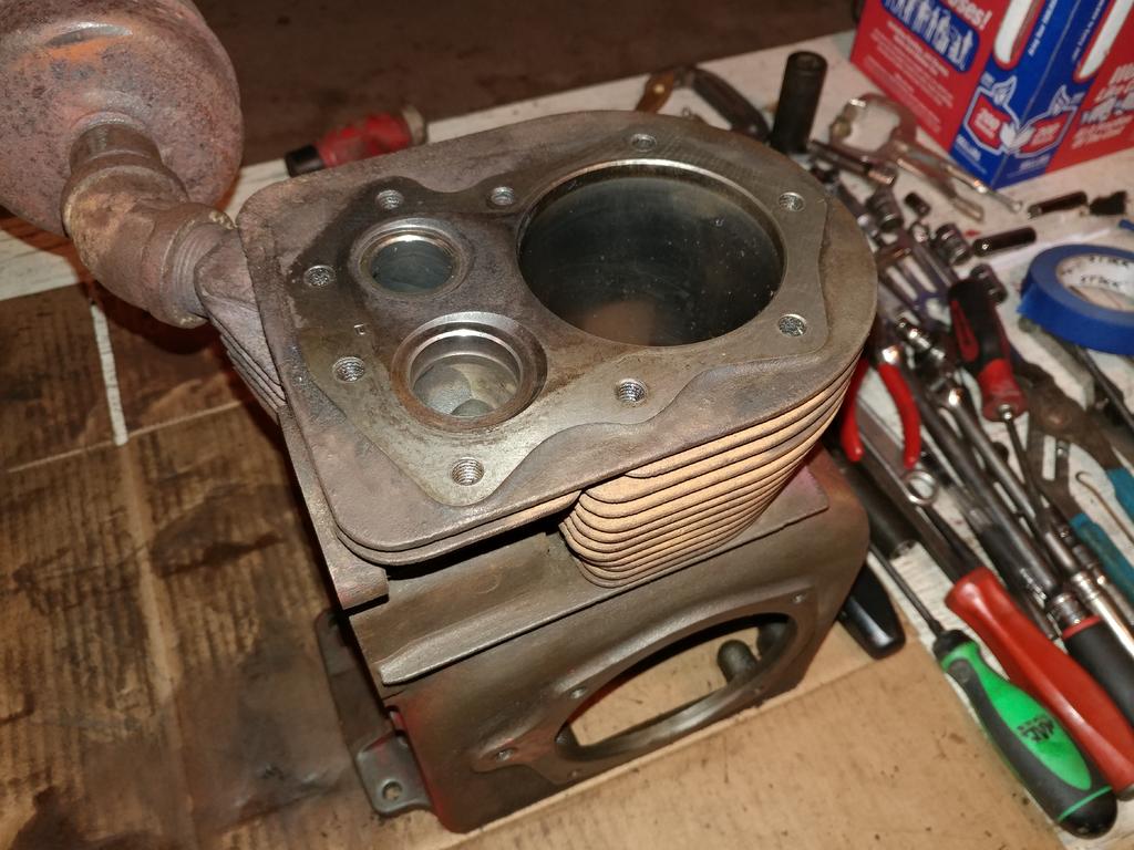

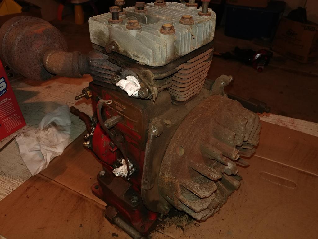

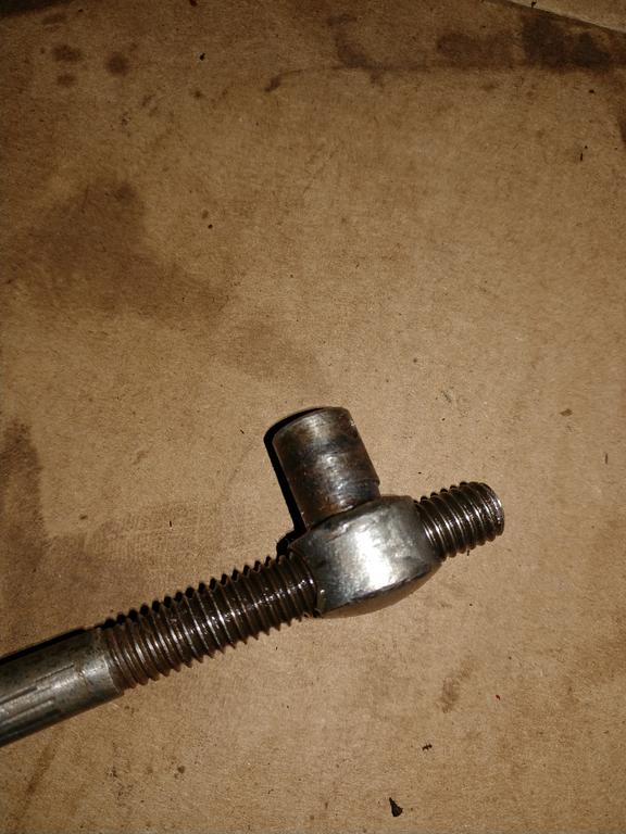

Joshn569 273 #33 Posted February 21, 2018 Got some more stuff painted including the frame! Looks real nice too. Started on the engine. The set screws in the drive pulley took some doing but i got them backed out just enough to remove it. It was scarey. Piston has a B stamped into it. From what i have read that is the bigger std bore? I dont have the tools to measure the cylinder at the moment. Once i get it measured im thinking about getting the complete engine overhaul kit from isavetractors... 4 3 Share this post Link to post Share on other sites
The Gman 476 #34 Posted February 21, 2018 Very nice John Gonna follow this. 1 Share this post Link to post Share on other sites

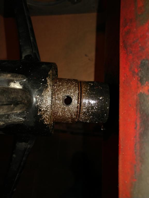

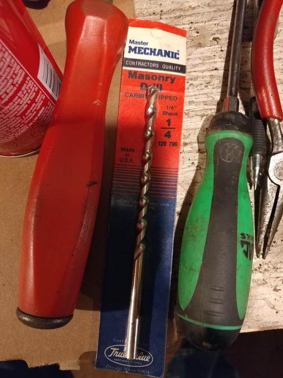

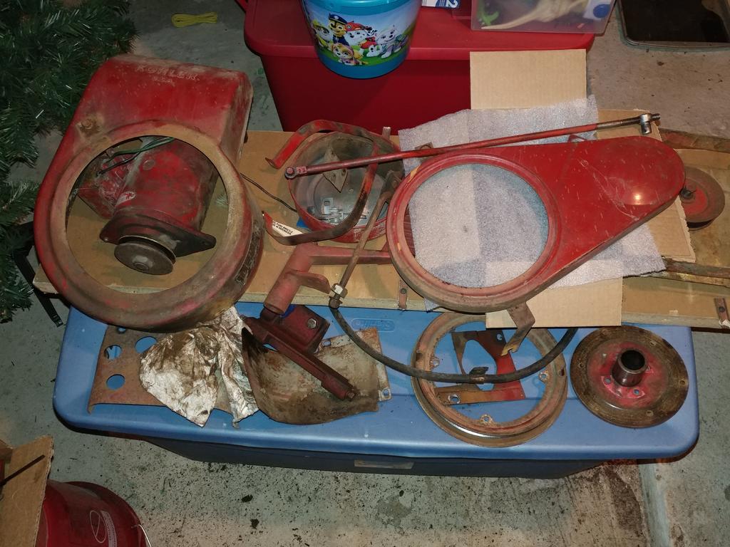

Joshn569 273 #35 Posted February 25, 2018 (edited) Shout out to @Achto I picked up a masonry drill bit and got the roll pin drilled out of my steering shaft. Thats half the battle anyway. Got it soaking in some pb blast now. Ill give it a few days and have a go at getting the wheel off. Got the brake shaft adjuster freed up and exhaust off. Getting ready to deal with front wheels also. Got all kinds of parts orderd up too. shout out to the guys wheelhorseparthorsepartsandmore @wheelhorseman And oh ya, got my decal kit orderd! Cant wait for those (even tho im a long ways from that point) thanks to the guys at redoyourhorse ! @Vinylguy Stay tuned, should start going back together soon. Edited February 25, 2018 by Joshn569 Dont mind my terrible spelling 5 5 Share this post Link to post Share on other sites

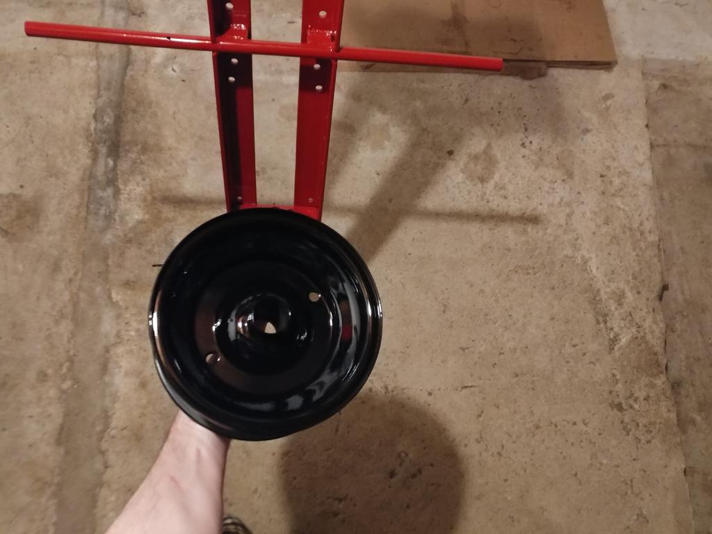

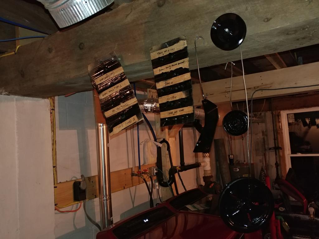

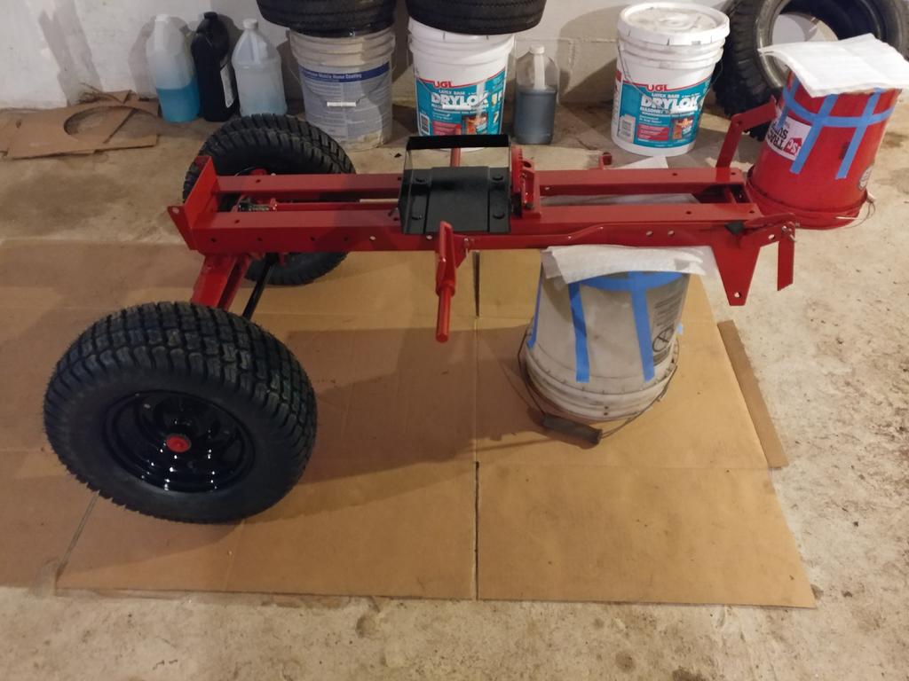

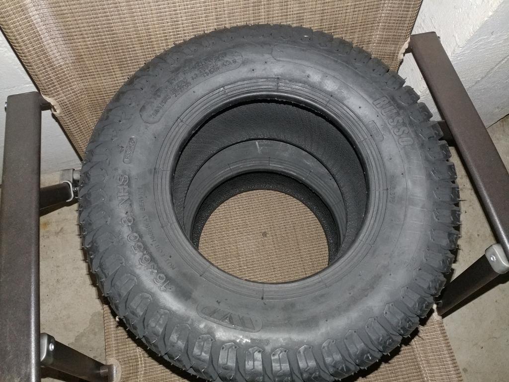

Joshn569 273 #36 Posted March 5, 2018 Got some parts in and a few more small things painted / prepped and ready for paint. Decided to go with black for the rims. 4 Share this post Link to post Share on other sites
Achto 32,141 #38 Posted March 5, 2018 That cleaned up really nice! 1 Share this post Link to post Share on other sites
WHX?? 57,585 #39 Posted March 5, 2018 Just something about black rims....must have something to do with early RJs 1 Share this post Link to post Share on other sites

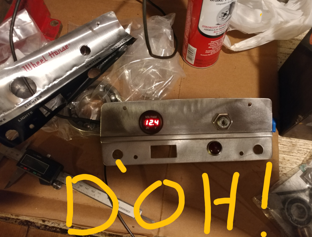

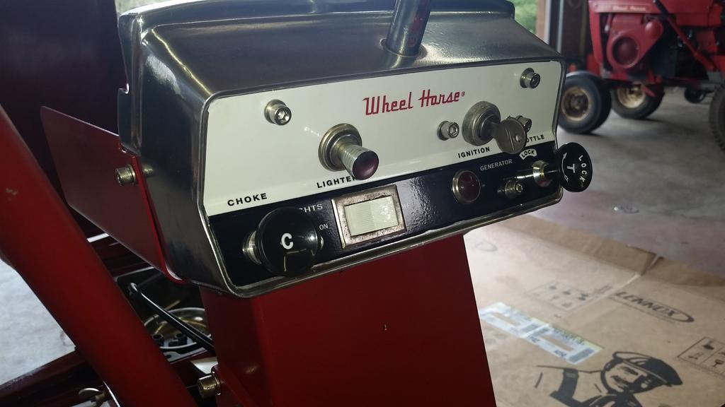

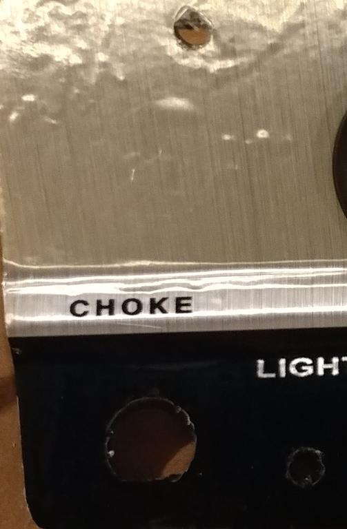

Joshn569 273 #40 Posted March 6, 2018 Welp, I replaced the old cigarette lighter socket (since i dont smoke ) with a hi tech (for 1968 lol) digital battery voltage gauge. Then I was feeling ambitious and tried to put the dash decal on... And it was a complete failure! I sanded it down and cleaned the metal off with rub alcohol. I then used soapy water in a spray bottle and sprayed the decal. It stuck is some places but not around the edges or the rib crease down the center of the dash. Got the wifes hair dryer out but it didnt work out for me. So then i did a real dumb thing and tried some super glue and it just bubbled up ruined the decal. I orderd a new decal. Any advice for next time? Im thinking i will not use soap and water. Also, the shift fork i orderd online was back orderd for a unknown amount of time so i cancelled it. Good news is somebody on facebook (wheel horse junkies) sent me a link to one on ebay and for a third of the price. 👍 2 Share this post Link to post Share on other sites
AMC RULES 37,259 #41 Posted March 6, 2018 (edited) https://www.redoyourhorse.com/installation-tips/ Edited March 6, 2018 by AMC RULES 2 Share this post Link to post Share on other sites
WHX?? 57,585 #42 Posted March 6, 2018 They can be a pain to put on and good thing Terry is good about sending out another but yes no bare metal. I layed down a base coat of self etching primer with a couple of top coats to fill in imperfections with some sanding. Pretty much then like Terry showed in his thread. Another word of caution when reinstalling the choke and throttle cables DO NOT rely on the D shaped holes to keep the bases from spinning. If they spin while tightening the backside nuts it will wrinkle the decal. Same goes for even the dash screws ...use a small fiber washer he mentioned. 3 1 2 Share this post Link to post Share on other sites
WHX?? 57,585 #43 Posted March 6, 2018 Oh BTW on the volt gauge Care to share your source on those? ! Share this post Link to post Share on other sites
Joshn569 273 #44 Posted March 6, 2018 2 hours ago, WHX14 said: Oh BTW on the volt gauge Care to share your source on those? ! I got it from ebay. You can get it in different colors also. https://rover.ebay.com/rover/0/0/0?mpre=https%3A%2F%2Fwww.ebay.com%2Fulk%2Fitm%2F32213754984 I had the dang dash piece painted 👿 Lesson learned lol. 1 1 Share this post Link to post Share on other sites

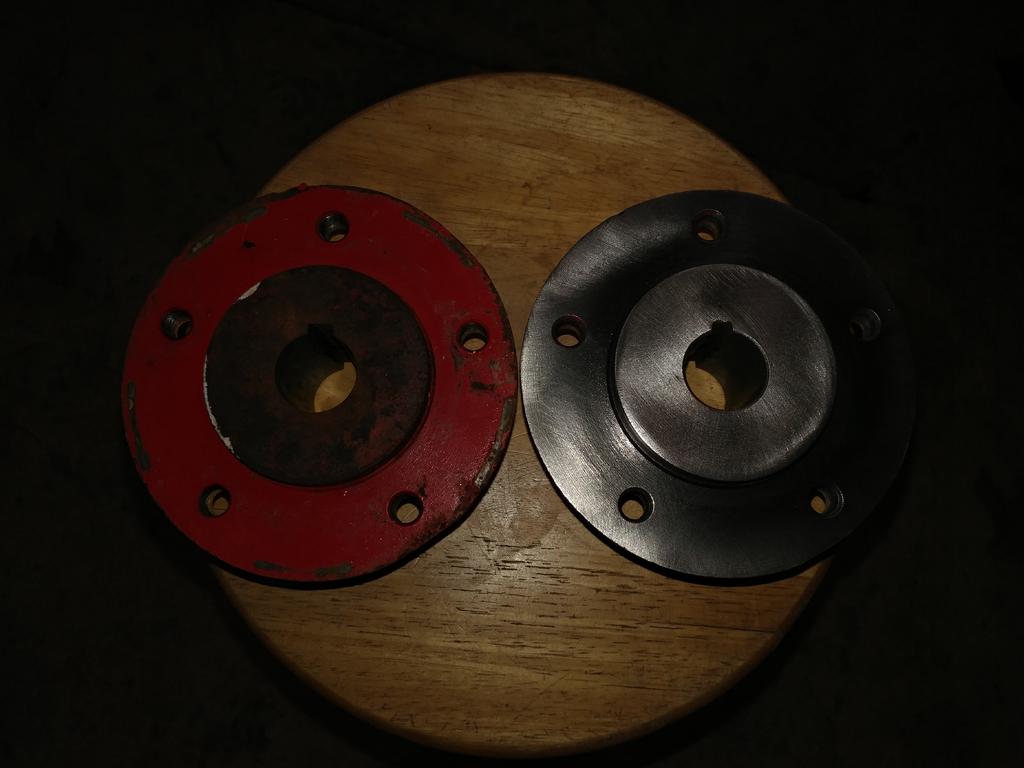

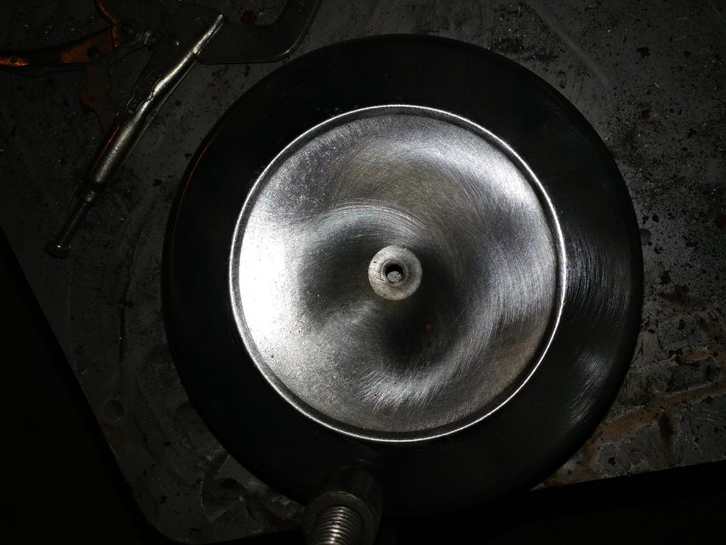

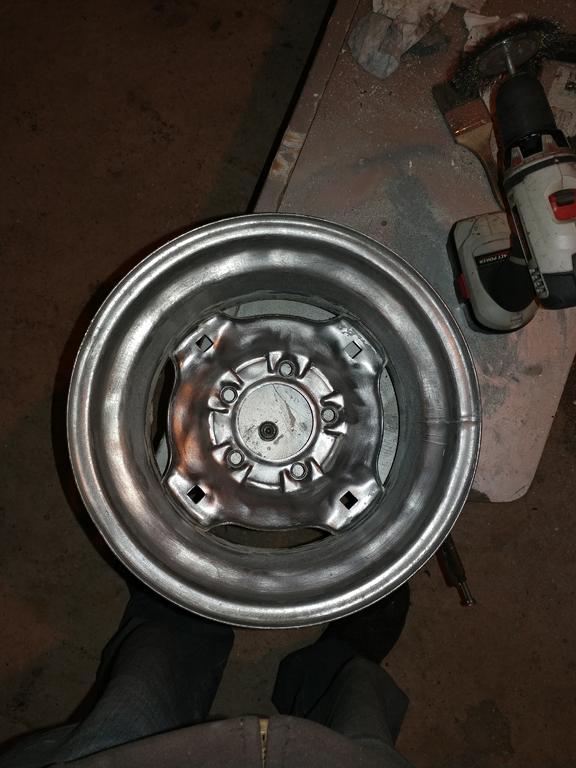

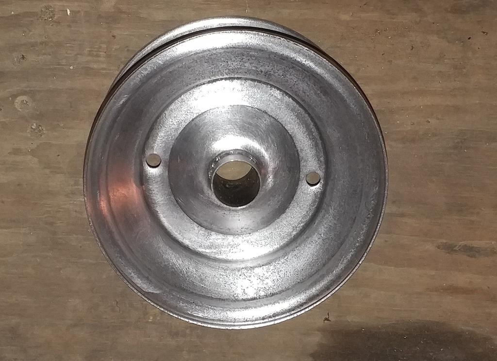

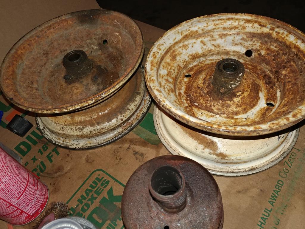

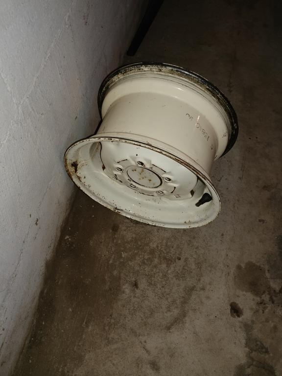

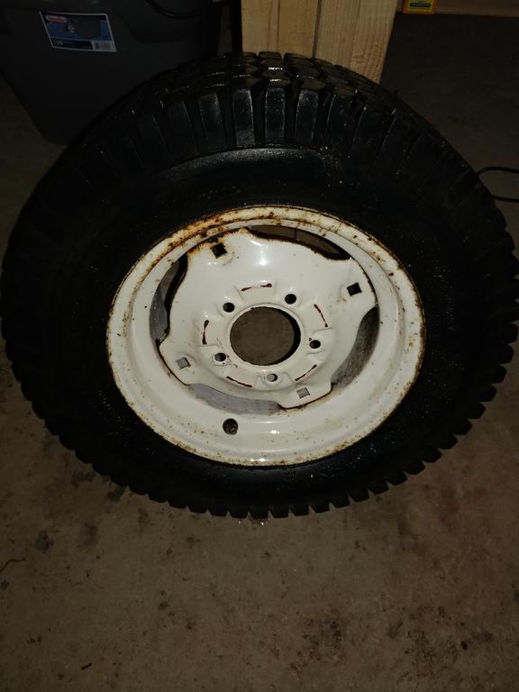

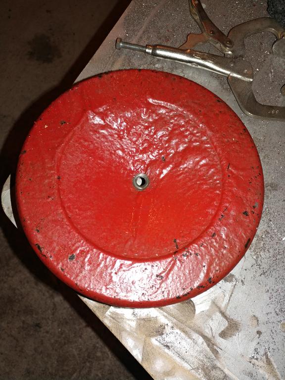

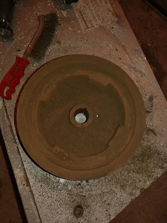

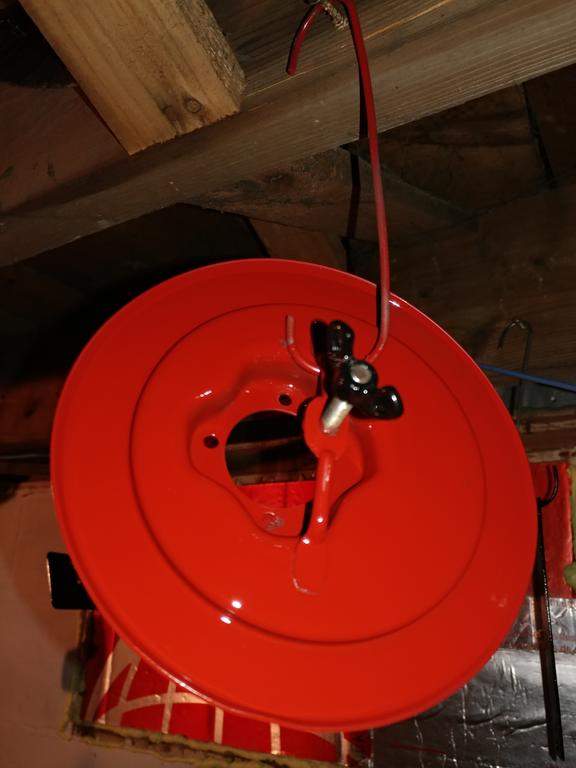

Joshn569 273 #46 Posted March 10, 2018 Some more progress. Lots of time and effort into that rear wheel, and i mean lots! I dont think i got it in me to do the other one by hand. All the small stuff is just about done and painted so i think im going to find someone local and get me hood and fenders and wheel blasted. Do any of you have any pointers on painting the rear wheels with spray cans? It has such a deep dish im sort of concerned about getting good even paint coverage inside. 6 Share this post Link to post Share on other sites
Sarge 3,473 #47 Posted March 10, 2018 (edited) The last set of wheels I painted were done on a pair of feed rollers for a table saw - this way I could just roll the wheel while holding the gun in one position. That's the best coverage and results I've gotten so far. Sarge Edited March 10, 2018 by Sarge possessed tablet 4 2 Share this post Link to post Share on other sites
oldredrider 2,553 #48 Posted March 12, 2018 Patience. Light coats. Give all coats time to dry as per instructions on the can. Lots and lots of patience. You'll be rewarded in the end. Remember, light coats, 1 at a time. 2 Share this post Link to post Share on other sites
WHX?? 57,585 #49 Posted March 12, 2018 I always like the black contrast with the red. I t just makes the whole tractor pop a little more and forces one to see detail work more. @JPWH, myself and @Achto is doing one with some black trim and no matter how you do it you can never be wrong. Next non original I do will get the same treatment. Looking good .. get that tranny together and you'll have a fine roller! 5 1 Share this post Link to post Share on other sites
Achto 32,141 #50 Posted March 12, 2018 On 3/9/2018 at 10:55 PM, Joshn569 said: Do any of you have any pointers on painting the rear wheels with spray cans? It has such a deep dish im sort of concerned about getting good even paint coverage inside. I set two pipes or pieces of angle iron on some horses to set the rims on. This leaves minimum contact on the rim. I paint the back first then I grab the rim on the inside (this will be covered by the tire any way) and flip them over to paint the front side. Before the next coat flip the rims over to start with the back again. Always end with the front getting the last coat. I've had my best luck with this method. At worst you will have 4 small spots to touch up on the back of each rim. Most times these spots are not noticeable though. 3 1 Share this post Link to post Share on other sites
